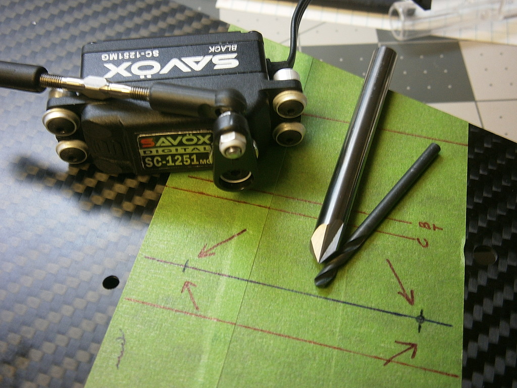

XLR8 wrote: Thu Apr 19, 2018 8:32 pm Actually, I was curious about the two holes in the shock mounting blocks.
Are these blocks also used somewhere else perhaps?
Nomad nailed it, those are for cutting the contour as well as the drill jig

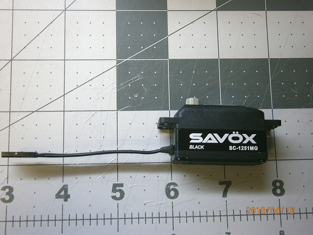

Lonestar wrote: Fri Apr 20, 2018 9:26 am That's lovely!
Regarding black wire - I know this might not be up to your standards, but a black sharpie does the job very well... and cheap... and without requiring midget-handed soldering skills :)
(does the pic show?)
The pic doesn't show but I get where your coming from :wink:

Updated Information on the SAXOX servo: I bought it direct from SAVOX USA. I'm on the mailing list from them (sign up, it's free) and took advantage of a 15 percent off coupon they had sent me via email. That deal resulted in a cost of 52 bucks and change, free shipping included.
The last two black editions I bought had long, thick sheathed servo lead wires. I replaced them with black TQ Wire leads. This time, it came with a short 3"/75mm lead already installed. Maybe, buying direct, I got the newest version?

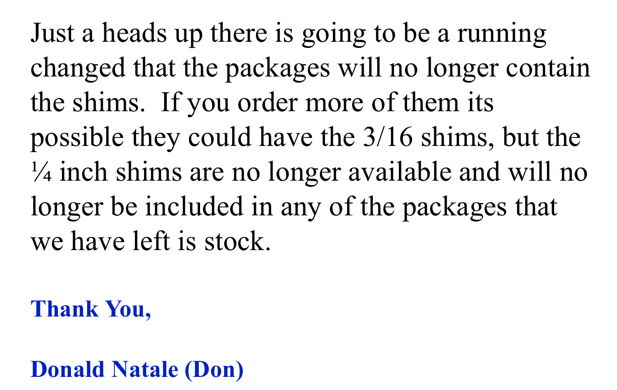

NomadRacer wrote: Thu Apr 12, 2018 12:50 pm The CVA kit will cause you to scratch you head a bit. It comes with shims and roll pin for the 3/16" CVA's! Come on Associated, get your act together. :roll: So, get you some 1/4" shims and a pack of ASC6375 roll pins and you'll be good to go.
Pretty disappointed in associated once again. Friday I got my 7th set of these that came with the wrong shims and pins. Don replied to my request for replacements:

No worries on the shims as long as the correct roll pin is in the package. :|
For shims, I use 0.015" thick from CRC and 0.005" from the AE RC12R5.2.

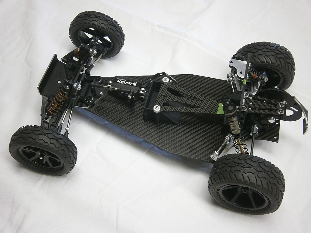

The steering servo has been mounted and the buggy re-assembled. I dyed the battery cup last night, simmered in RIT Dyemore and left to soak overnight. The Shapeways/CPD white parts take to dye very quickly.
I have some electronics inbound; ESC, RX, and a brushless motor. I'll probably be able to get into doing some installation this coming weekend.

Wow, looks amazing! :shock:
XLR8
Posts: 3318
Has thanked: 1684 times
Been thanked: 1180 times
Re: Factory Works C2 Carbon Fiber
Post by XLR8 »
I agree, it does look amazing. Curious to hear your feedback on those tires; on what surfaces do they work best, etc.

Wow that turned out great!

Are you going to do some kind or brace of the nose?
NomadRacer
Posts: 1467
Has thanked: 81 times
Been thanked: 79 times
Post by NomadRacer »
mikea96 wrote: Tue Apr 24, 2018 5:18 pm Are you going to do some kind or brace of the nose?
You know, I was looking at just that this morning! There are some open holes that could be used :wink:

For a shelfer, it's a who-cares, but for a runner, a nose brace or braces is pretty much a requirement.
