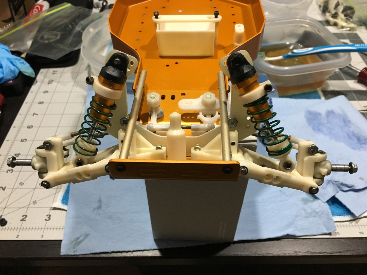

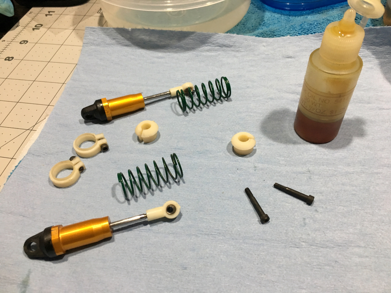

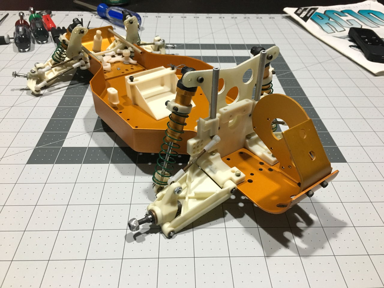

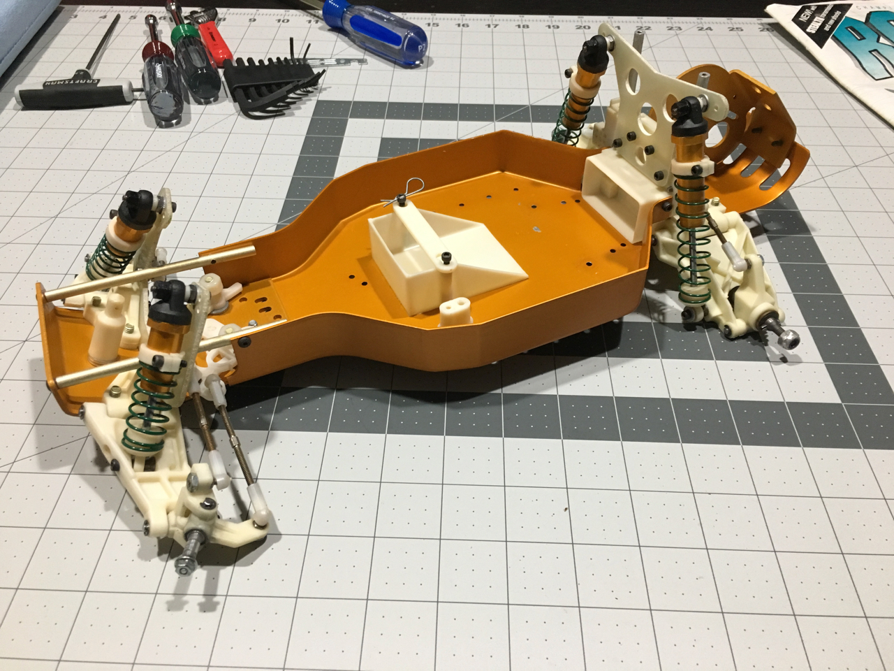

Thanks for help-
I got a complete set of bearings on order (including for the Stealth transmission).
While I'm waiting for those I have made some more progress:

Very nice. You're almost finished.
Have you decided which body/paint scheme you're going with?
