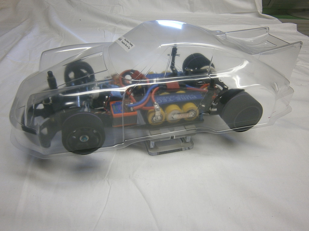

I've nearly got the wiring done now. All that's left is the big cap for the ESC. Sabula Tech has come thru with a Porsche 930 LeMan's body! I got the first one from the new batch so a second body (error) was included! :mrgreen:

Totally gnarly dude! Your soldering skills are very good! You would pass NASA certifications! Looking forward to see it painted up. :D

I made a rear body mount in the shape of a boomerang out of 1/16" thick blue G10 this morning. It uses the mounting holes for the rear body mounts. I added some 1/8" aluminum standoffs and it looks pretty good. I used the molded in body mount hole on the Porsche body. I also installed the ESC cap by splicing it in the + _ wires and installed some shrink wrap on it.

I've gotten the body mounted this morning. I have 3 stacked AE #8 washers on the rear body post. I'll machine a one piece spacer later on today. I have the exact wheel wells marked with a sharpie pen. Next is to get them marked out for clearance in a "Porsche" looking way.

Wow, great looking build. I can tell you've done this a time or two!
How did you get the rings spaced so well on the aluminum support for the front end? Do you have a late, or are you a Jedi master with a Dremel too? :D

Hey ChuckW. This was my first time building a 12th scale. Though I consider myself pretty handy with a Dremel tool, I do have an old Taig brand micro lathe.
