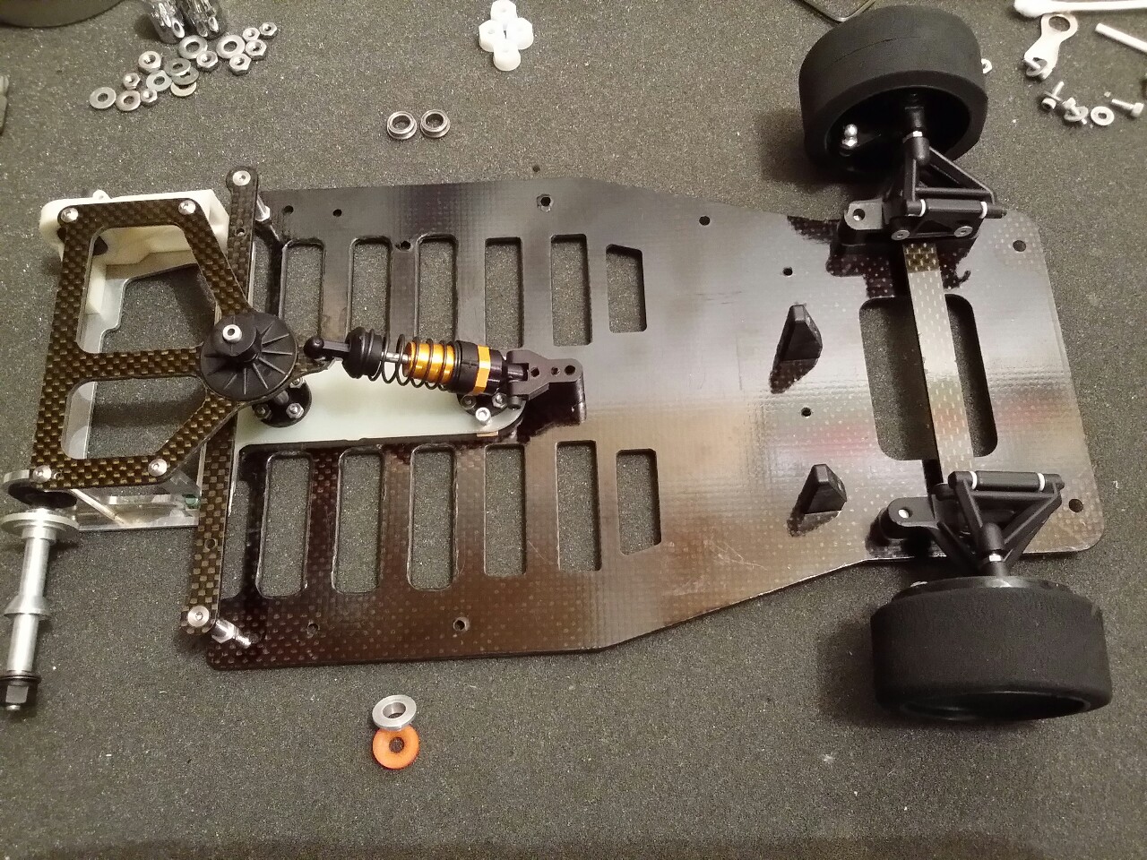

This is the LS wide car that I am building alongside the LSO. I have enough spare parts to complete another car. I thought building it may result in clearing up my storage bins a bit more.
I have a few ideas on body and paint for each car. A modern body with a well known 80s race car theme.

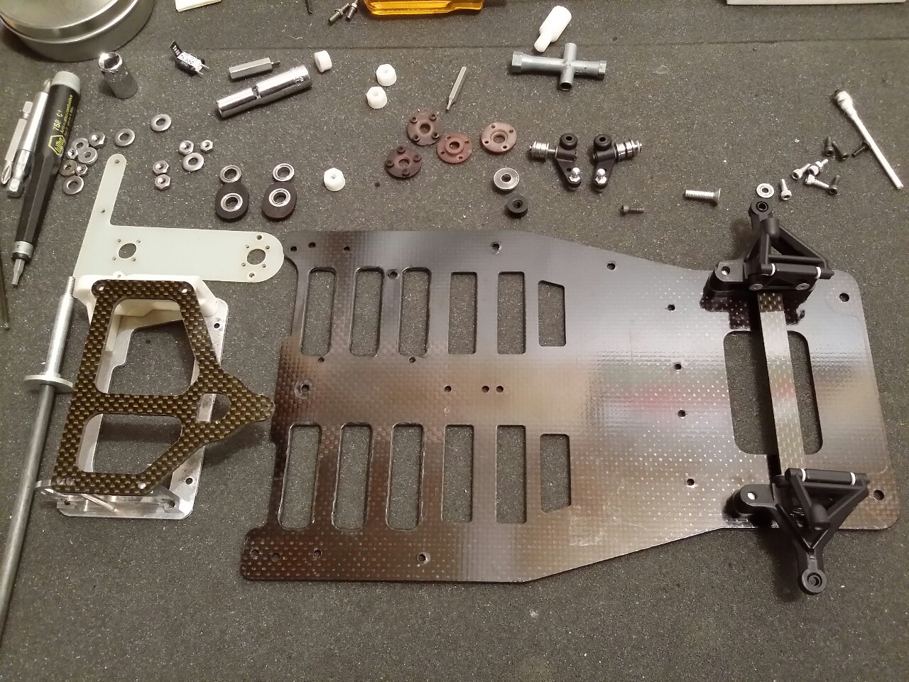

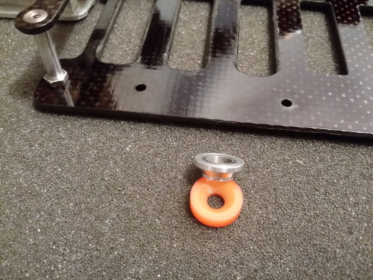

The LSO has been put on hold till my order of silicon wire comes in. In the meantime, I worked a bit more on the parts bin LS build. One thing I came across is what I think is several Bud's diff cones and washers. I am not sure if these are any better than the Associated diff thrust cone assembly or not. I don't know if the Buds cone is missing the belleville washers or not. I don't have the instructions for the Buds kit so I am confused how they should be put together.

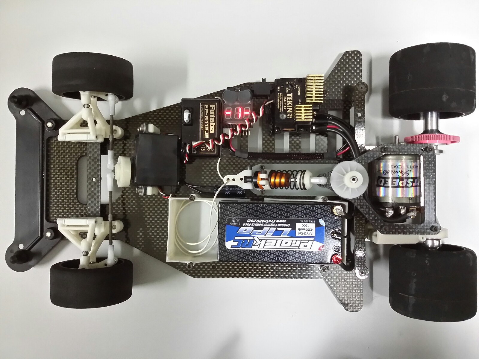

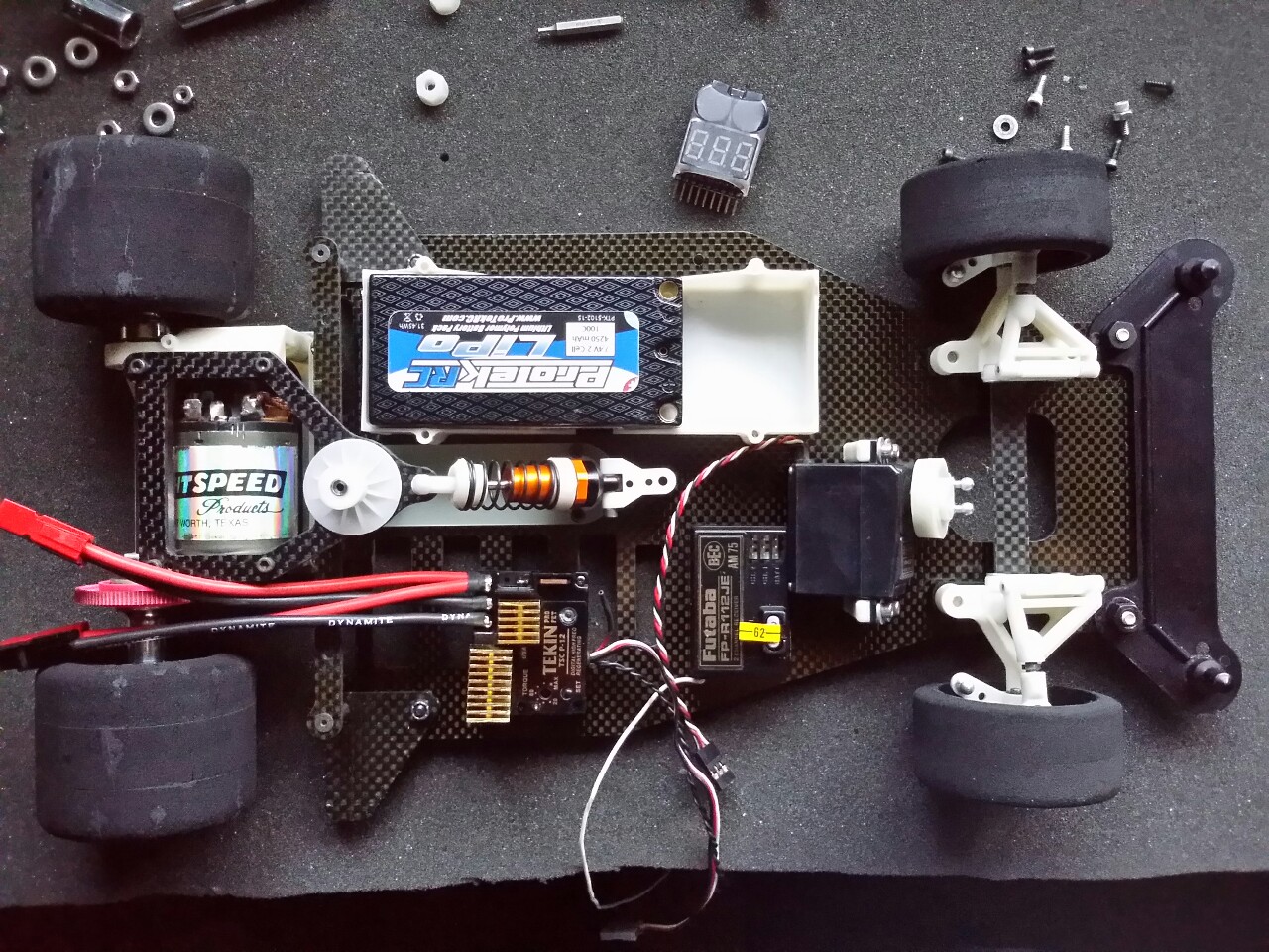

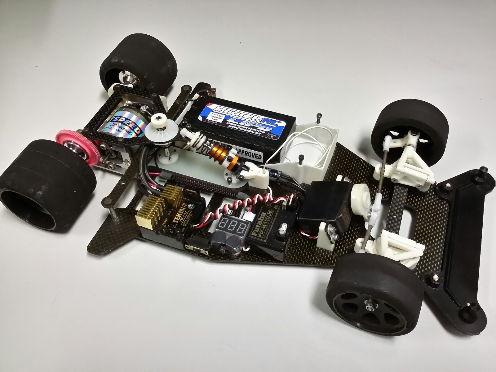

My SuperWorm wire arrived and I was able to finish the LSO soldering and finalize the parts layout. The low voltage alarm displays the correct voltage for each cell after swapping the two positive leads. It is very loud! I jumped a bit when I first plugged it in!
The Tekin ESC had an intermittent power switch so I had to pry it open and clean the contacts. The vintage Futaba servo works quite well considering how old it is along with the receiver. The steering ball cups were too tight. So I took off the ball ends and chucked them into a hand drill. I applied some toothpaste on the ball and snapped on the cup and turned them with the drill. Then cleaned them up and no more binding. The lightspeed motor roared to life when lipo power was applied! The car left/right weight distribution is balanced suprisingly well and not much tweak will be needed. Now I must decide on what body to choose and get it painted.

If looks could kill!
Really nice man, fine work and attention to detail.

That's so good looking... but I just want to put a nice 6-cell side-by-side back there.

That is what my parts bin LS is for.....
Thanks! - the LSO has been a fun project so far. The lipo will certainly breathe some new life into it!
