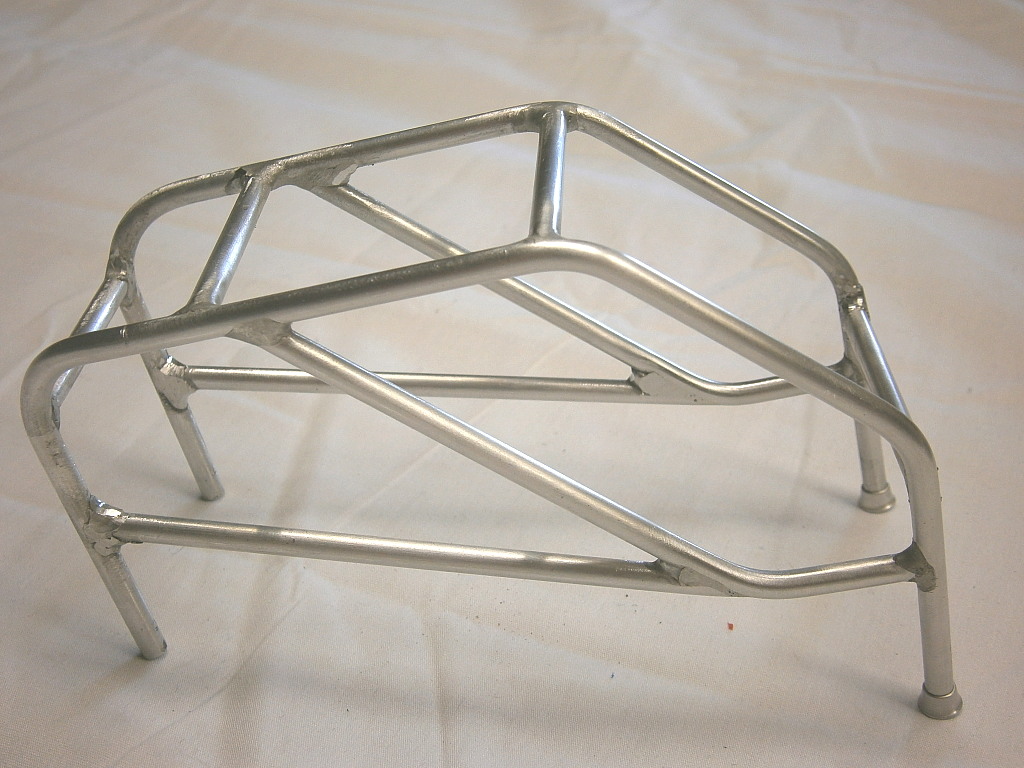

Back to the welding shop this morning, got a lot of work done. The cage has really stiffened up now. The weight is 49.1 grams. Next is to continue working with the files on the joints and figure out the shock mounts. I have a couple of ideas for that!

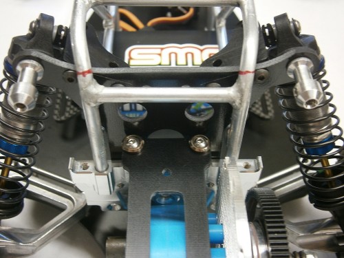

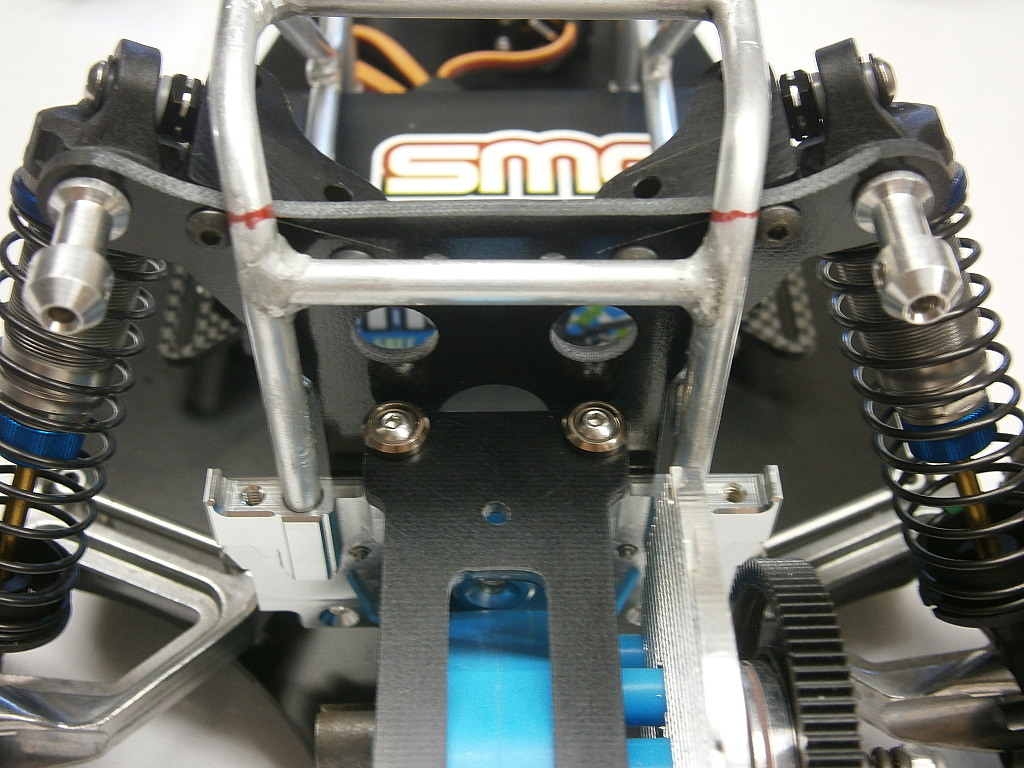

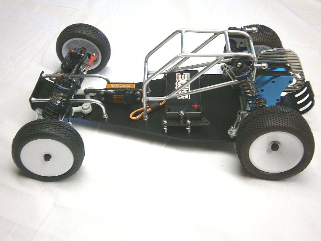

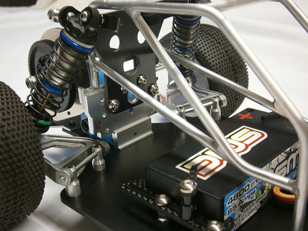

Well, you guys (and me
) deserve a look at the "Tuber" as it stands right now.
I've modified the Factory Works rear shock tower by narrowing it and removing some material from the top. This let's it fit between the two cage members. I have to massage the top of the cage in the rear just a tiny bit. The rear bulkhead is a DHAWK alum. alloy from eBay, I'm not using the batter cup portion, don't need it.
Lot's of work to do... file/smooth joints on the cage, file the bottom corners from the bulkhead, etc. I'm going to attempt a rear motor guard cage. I have a couple of ideas to make it work out like XLR8's pictures showed.

Looks good Nomad. To be honest, I was a bit skeptical when you posted yesterday's pic of the completed cage but now seeing it assembled on the car, it looks perfect.
With the benefit of hindsight, do you think it would have been better to use solid aluminum rod rather than tube (i.e. easier to bend tighter radii, weld, notch, thread for screws, etc.)? Was the tube difficult to weld?

I'm real pleased with how it looks. The shorty lipo slides in and out with no trouble at all. If I can do as good a job on the rear motor guard and the nerf bars, It will be a big success.XLR8 wrote: ↑Thu Aug 30, 2018 3:23 pm Looks good Nomad. To be honest, I was a bit skeptical when you posted yesterday's pic of the completed cage but now seeing it assembled on the car, it looks perfect.
Yes, in hind sight, there was a few times it would have been better to use solid 3/16" rod. I had no problem notching the tube, especially when I got those chainsaw files. I got those in just a few days from Amazon for 12 bucks and some change.
It was real easy (for me) to weld the tubing. I did make a mess of it!

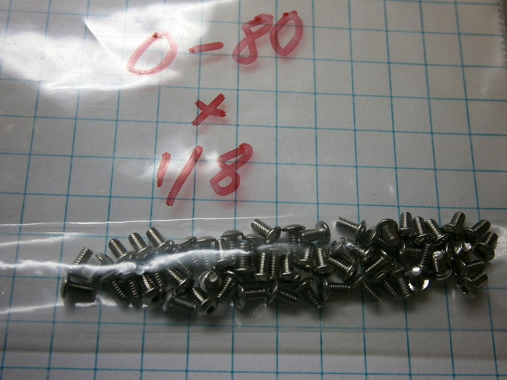

I got some button head cap screws today from Las Vegas, NV, 0-80NF stainless steel. I'm going to use them on the roof panel and a few side panels.

0-80? Oh my, that's tiny. Do you have a tap or will you just drill the hole slightly undersize and let the screw form the treads (that's probably what I'd do).

Oh yeah, got the taps, tap drill and clearance drill bits.
