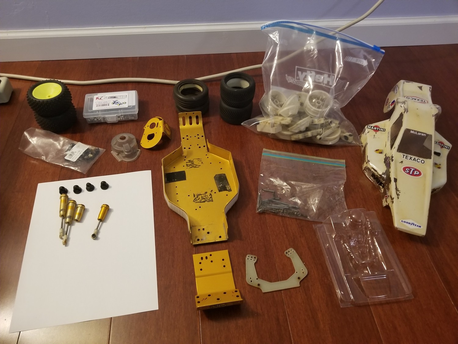

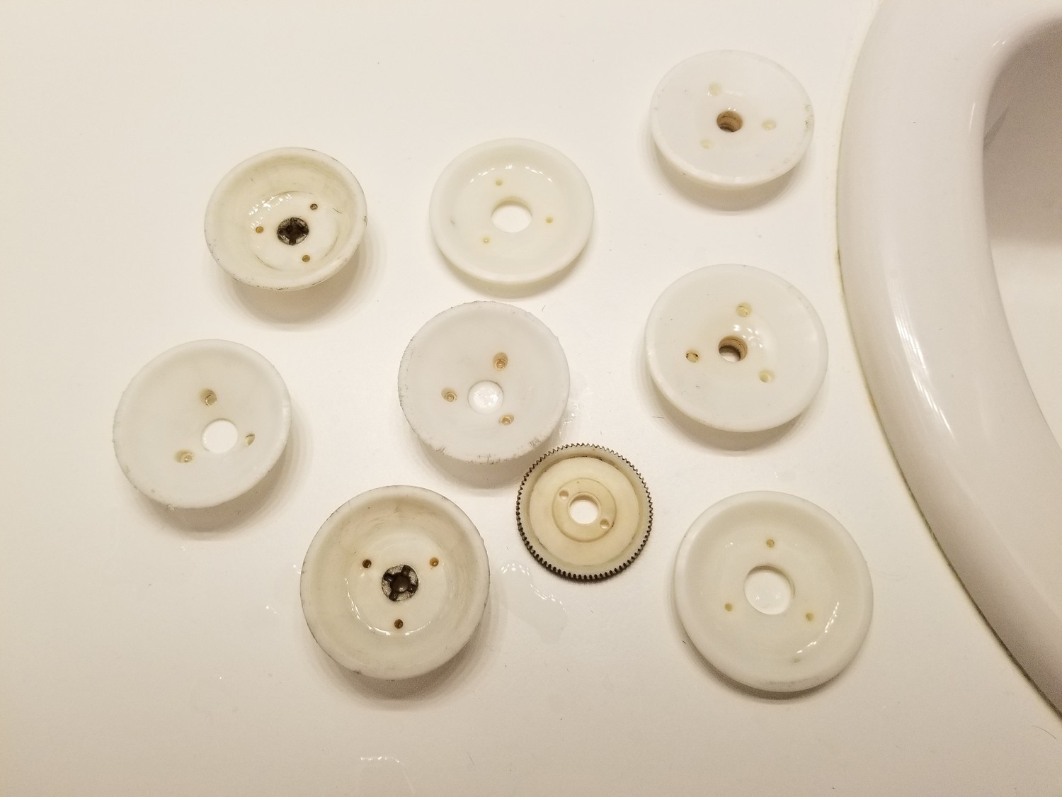

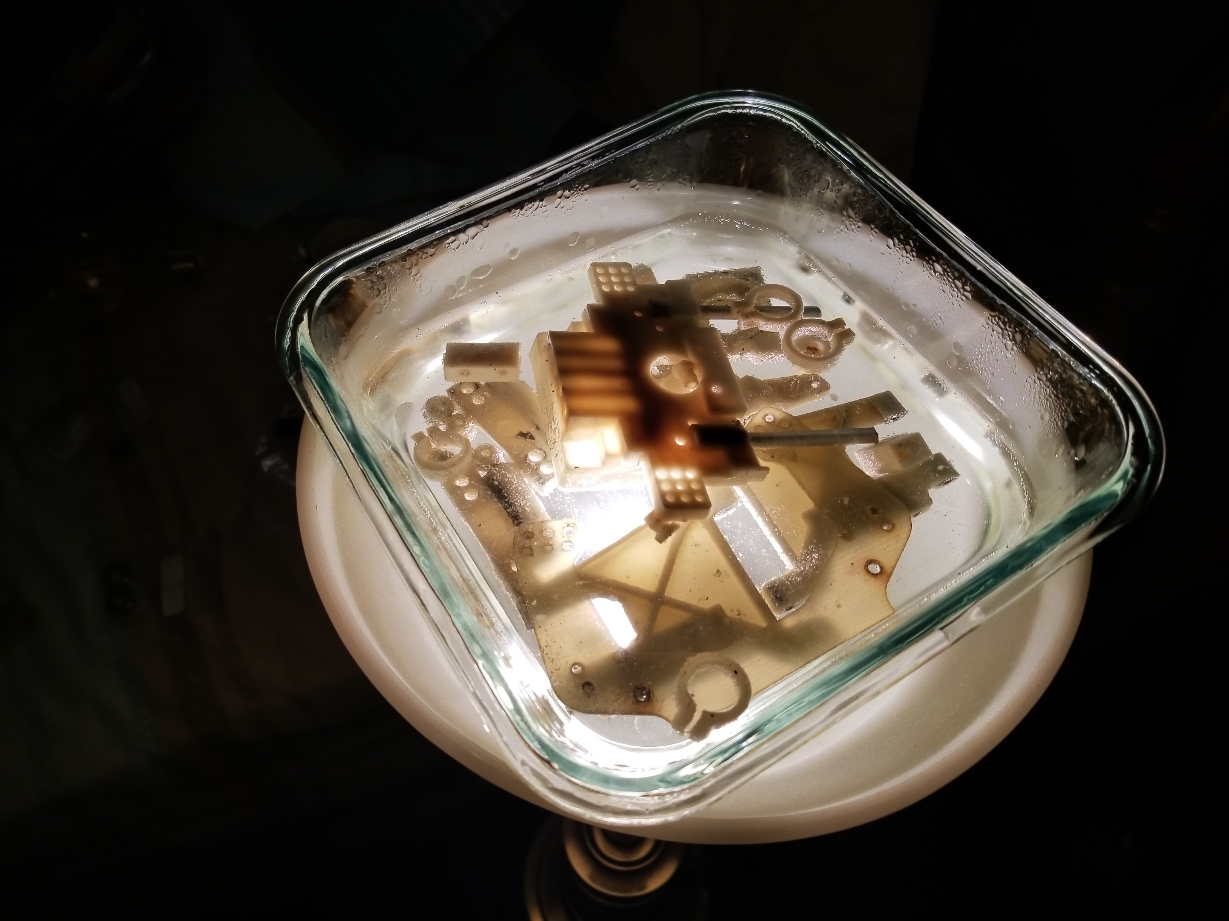

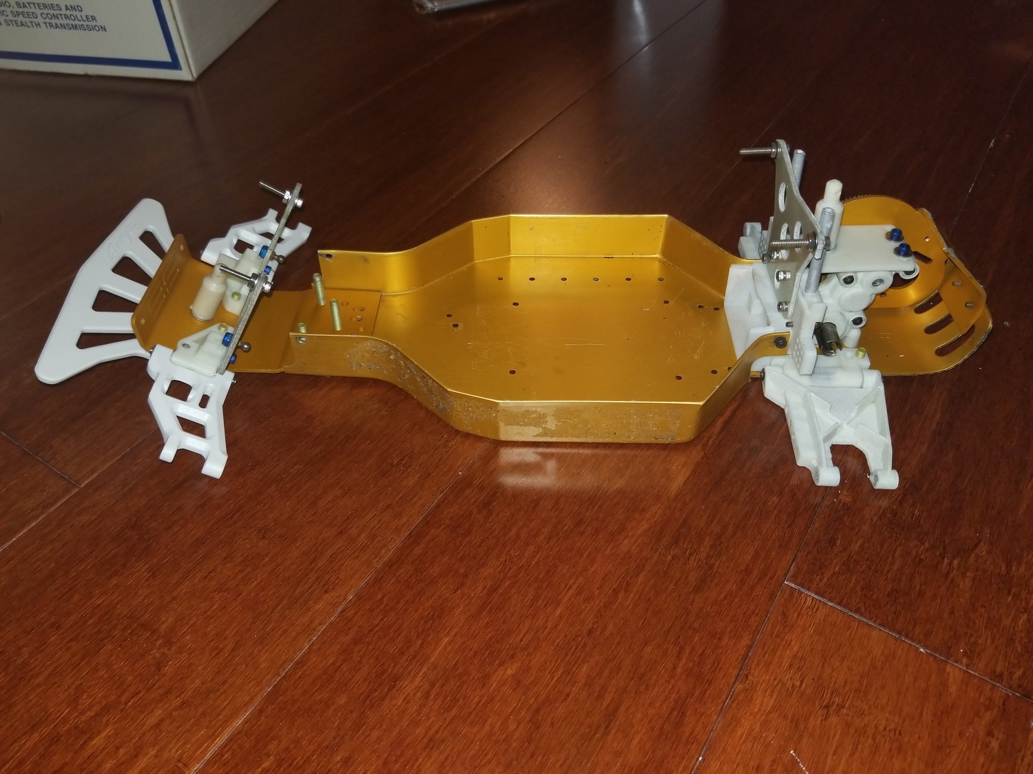

I didn't take a pic of it in condition I left it as a 14 year old, but here it is all torn down. The white nylon pieces are segregated since I did the UV lamp / peroxide trick with them. That seemed to have worked well:
The spur gear was not whitened and shows the before / after.
Starting to come together...with some NOS Andy's parts I bought.

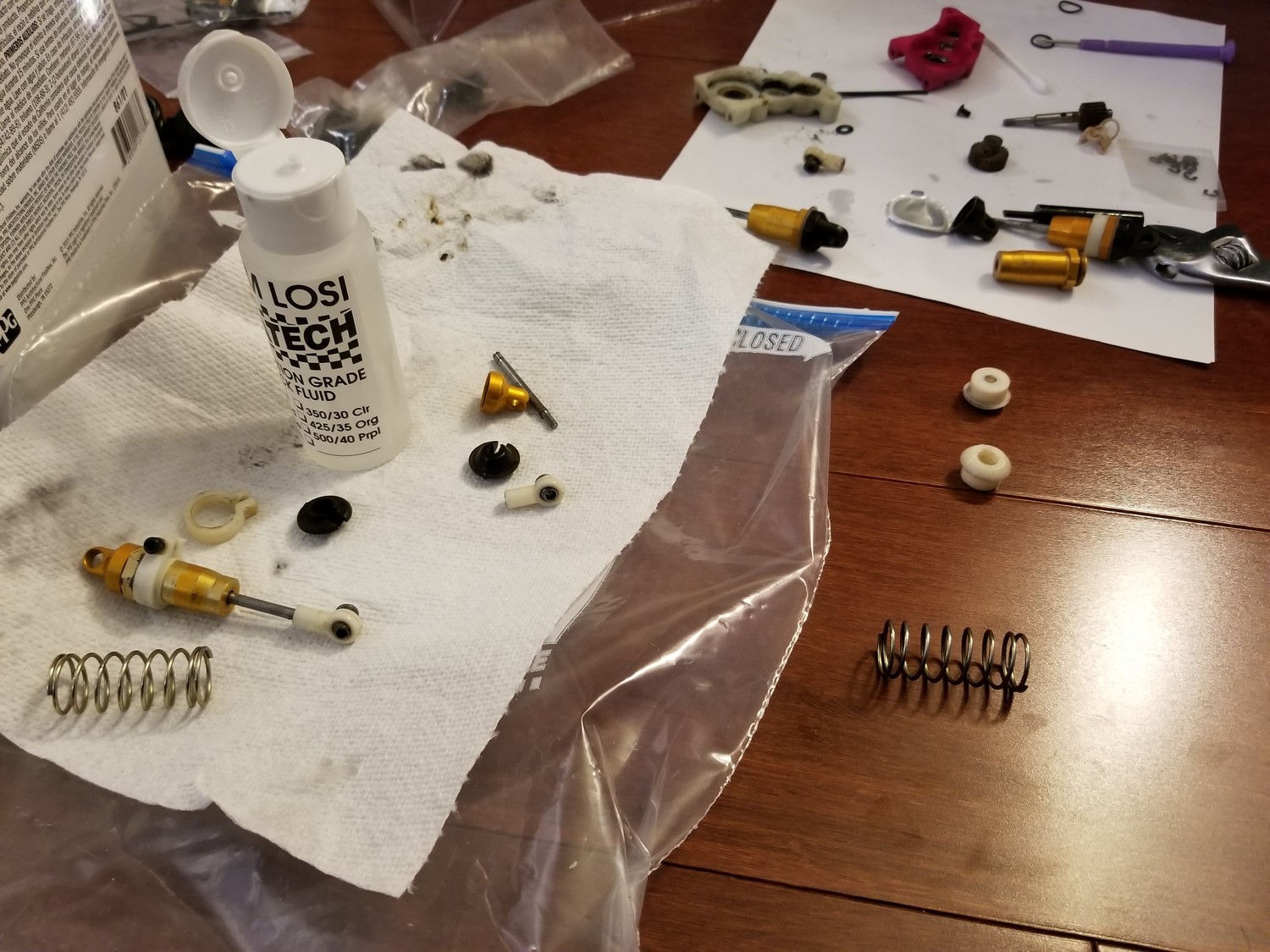

Rebuilt the shocks

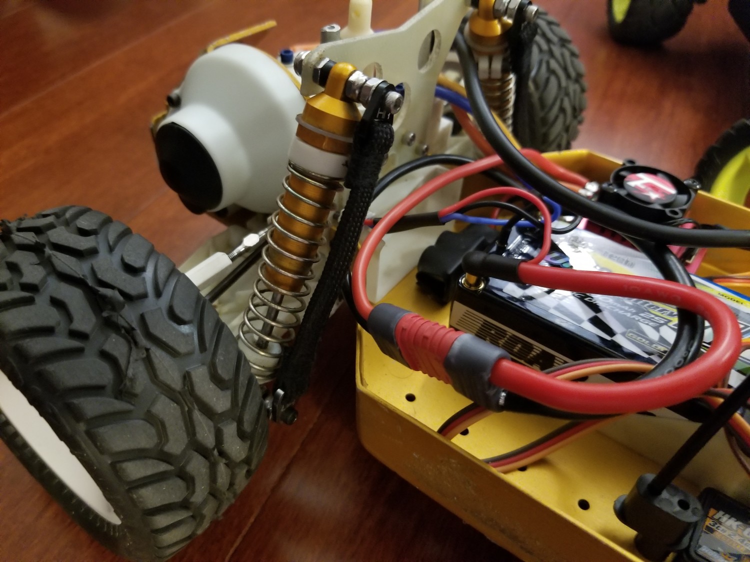

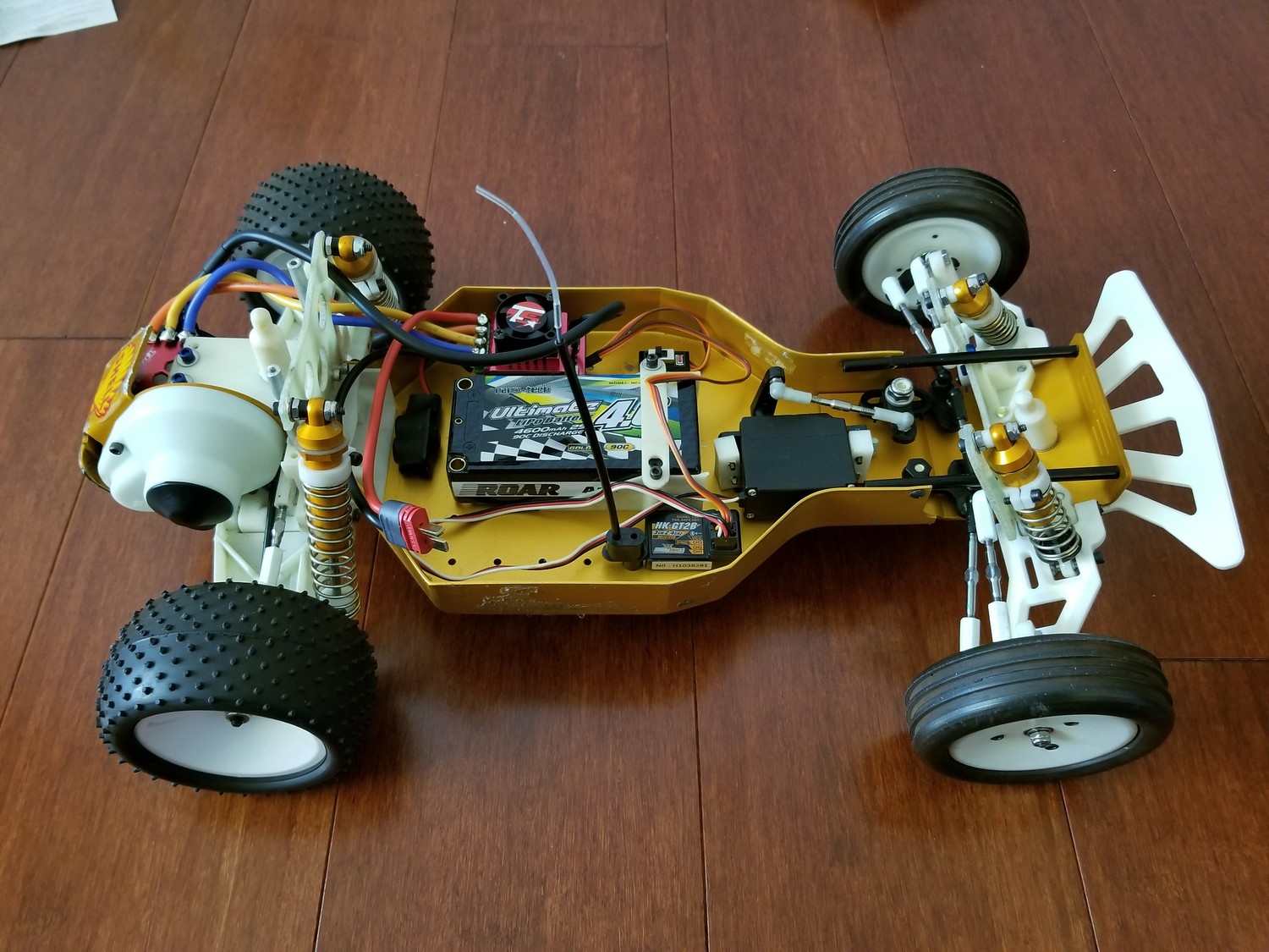

I dived into the world of modern electronics and got it a 13.5T motor and lipo batteries with the help of this forum. In looking for parts I stumbled across a relatively cheap and complete Worlds Car and bought that.
CE Running!
Only to find that the 3/16" CVA's (since I lost the original dogbones apparently) are short and the axles pop out. So instead of putting spacers in the shocks, I thought that some limiting straps might be fun:

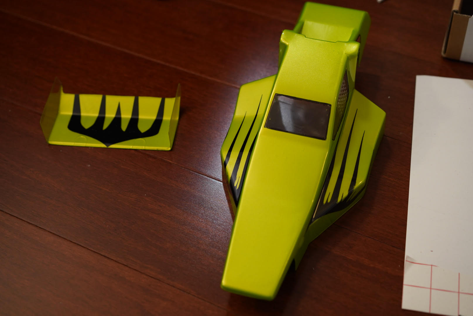

And finally I painted up a body using an airbrush and parma key lime pearl:
Rebuilt the shocks
CE Running!

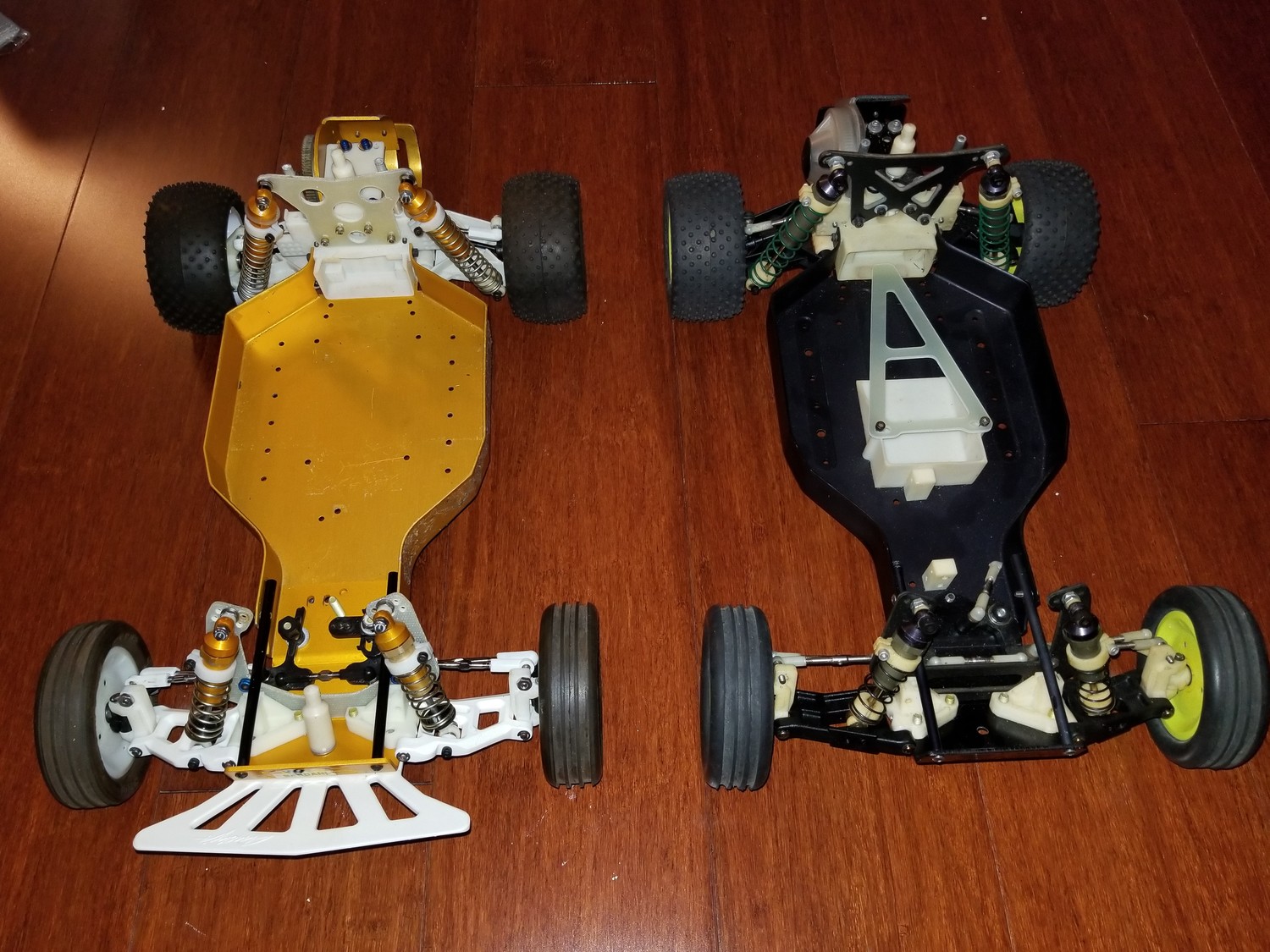

Well, got both cars running, but this weekend the CE lunched it's original idle and diff gears. I ordered the dhawk aluminum gears to see if that will help. Wondering if trying to run vintage cars will work out for me in the end...new motors have too much power maybe? I also got the tuning box for the ESC to see if I can make it so even if I don't feather the throttle well enough, it won't go to 100% power off the bat. I did have the slipper clutch tuned in - even to the point of slipping too much maybe - it wouldn't lift the front end when hitting the throttle holding the rear wheels down.
I'm also wondering if the 9.5T motor I got to convert my vintage HPI RS4 would be better for the old RC10s since from what I've read about low turn motors, they have less torque.

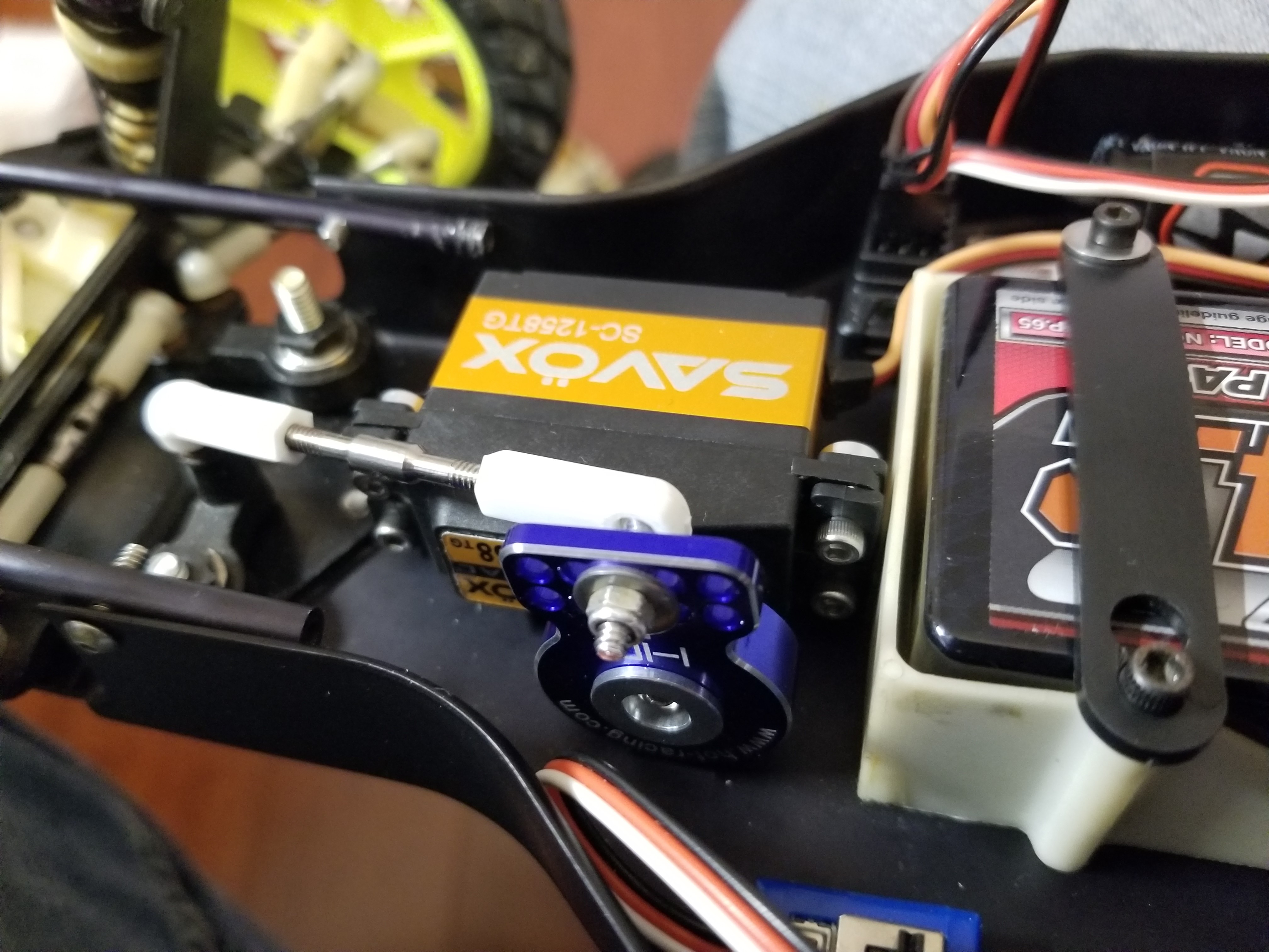

For the World's car, I took it to the local track and got schooled - on servo savers and clay. With the Traxxas Anaconda tires - the only non-pavement tires I have for the 1/4" rear axles it has, it was on ice. I slammed into the wall and broke my new but cheap $13 hitec servo. Sigh. Ordered two servo savers, one for each car, and will get Pro-line electron tires for the JC 5 spoke tires I ordered. It also managed to blow out both front shocks and make the front A-arms all nice and shiny.

I think the limiting straps are a neat solution. This idea has crossed my mind in the past, but too lazy to try it out. Not sure how effective they will be vs. internal shock limiters. But sound in theory.

regarding steering - if you are going to do anything more than burn outs in the driveway, ditch the $13 cheapie servos, and put $50 in a proper piece of gear. And you don't need a servo saver, really, it only adds noise in the system. If you do want one, pick a Kimbrough above all things. Nothing else will do.

For the steering servo, too late, ha. The Worlds car got the Savox with a saver and the CE has an old Futaba with a saver. Springs are pretty stiff, hopefully not to much play. With my level of driving skill at the track, likely doesn't matter much
