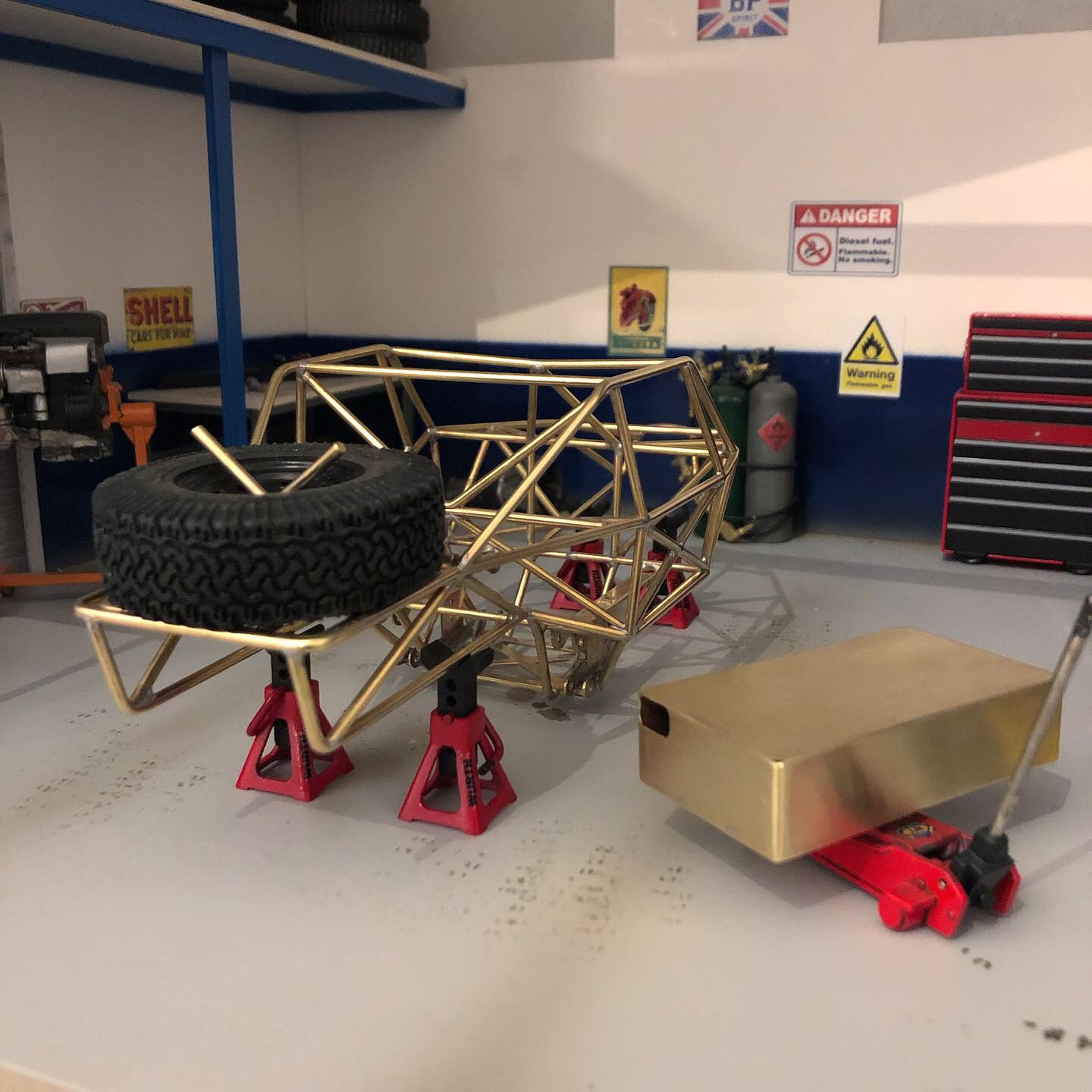

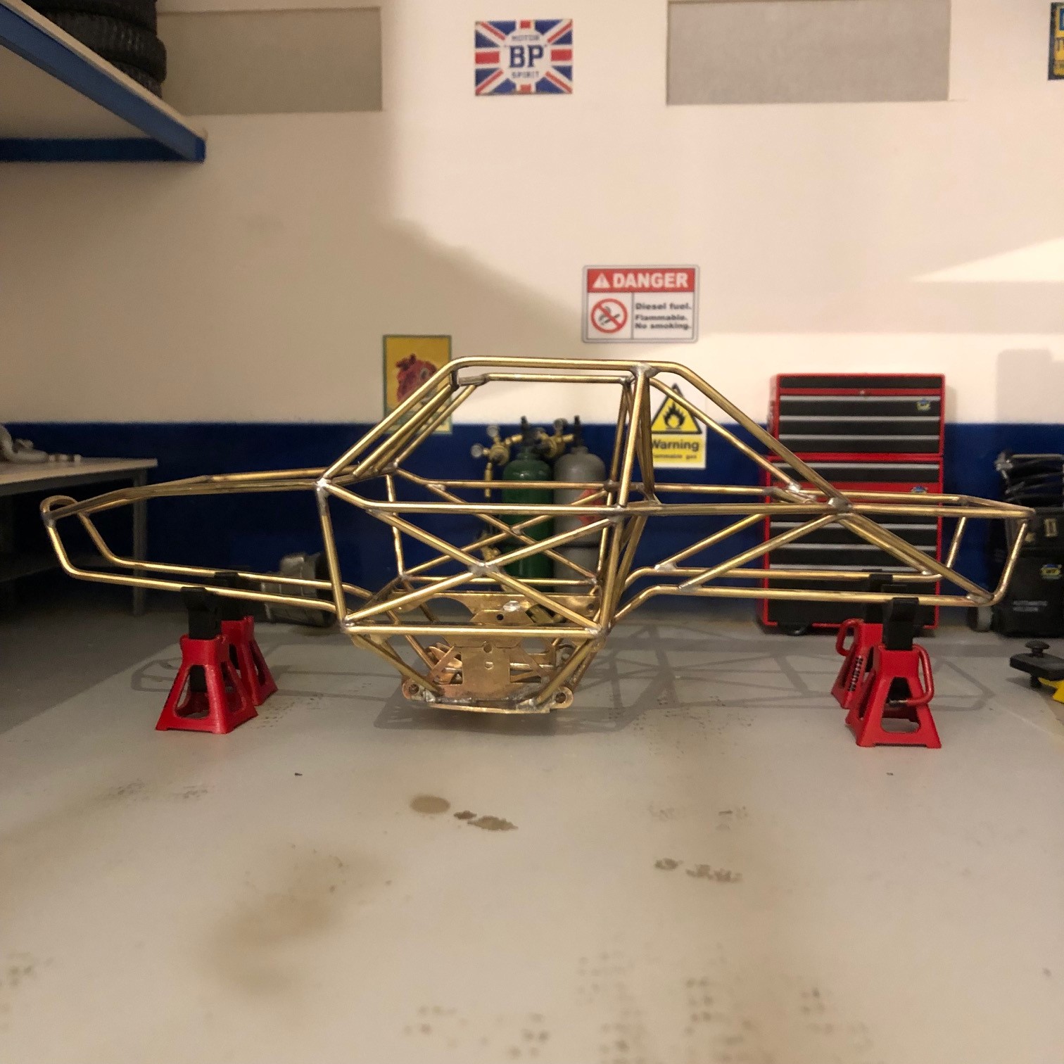

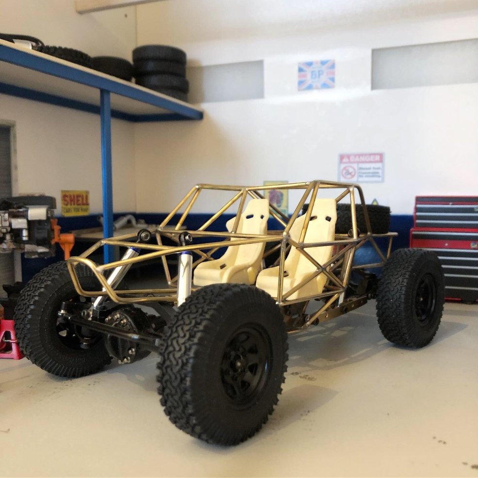

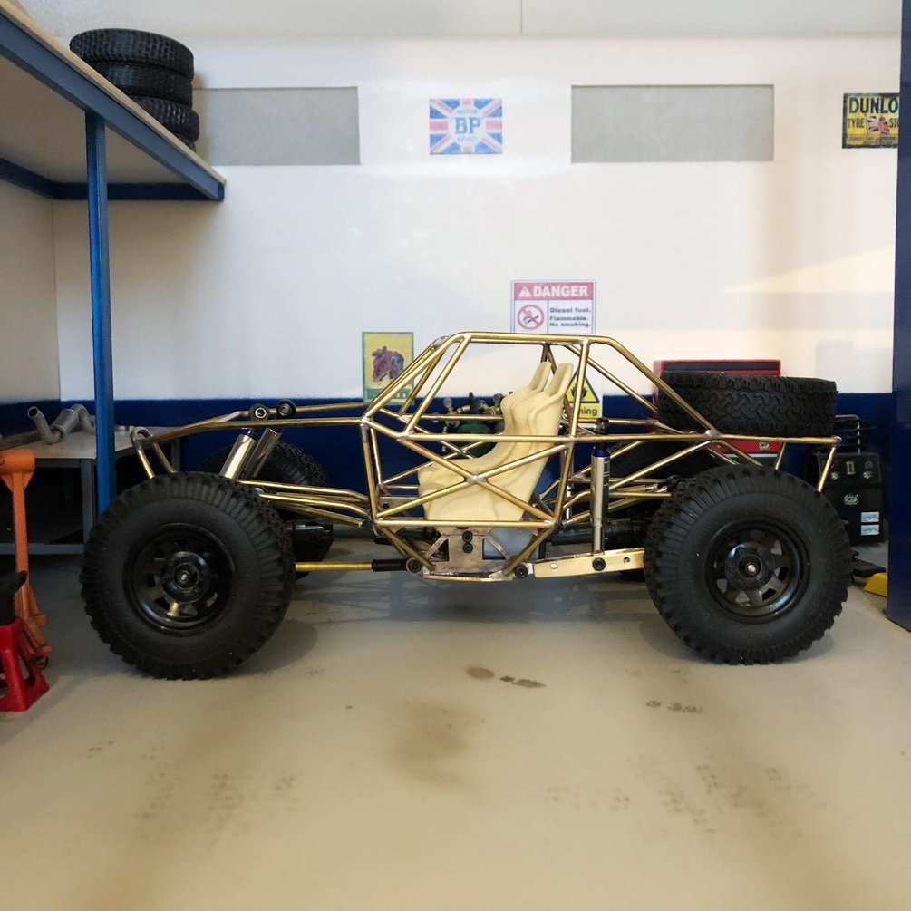

Thanks guys,
Yes it's 2 mm brass rods and I use 3% silver solder and a small butane torch. Once you get a hang of it it's super fun.
The tricky part now is how to solve the steering servo and puch rod layout to maintain full articulation in the front and location of shock top mounts.
I've ordered a set of 1/24 Carisma MSA-1E aluminum oil shocks to go with the modified Losi micro crawler shocks loosely installed in below pics

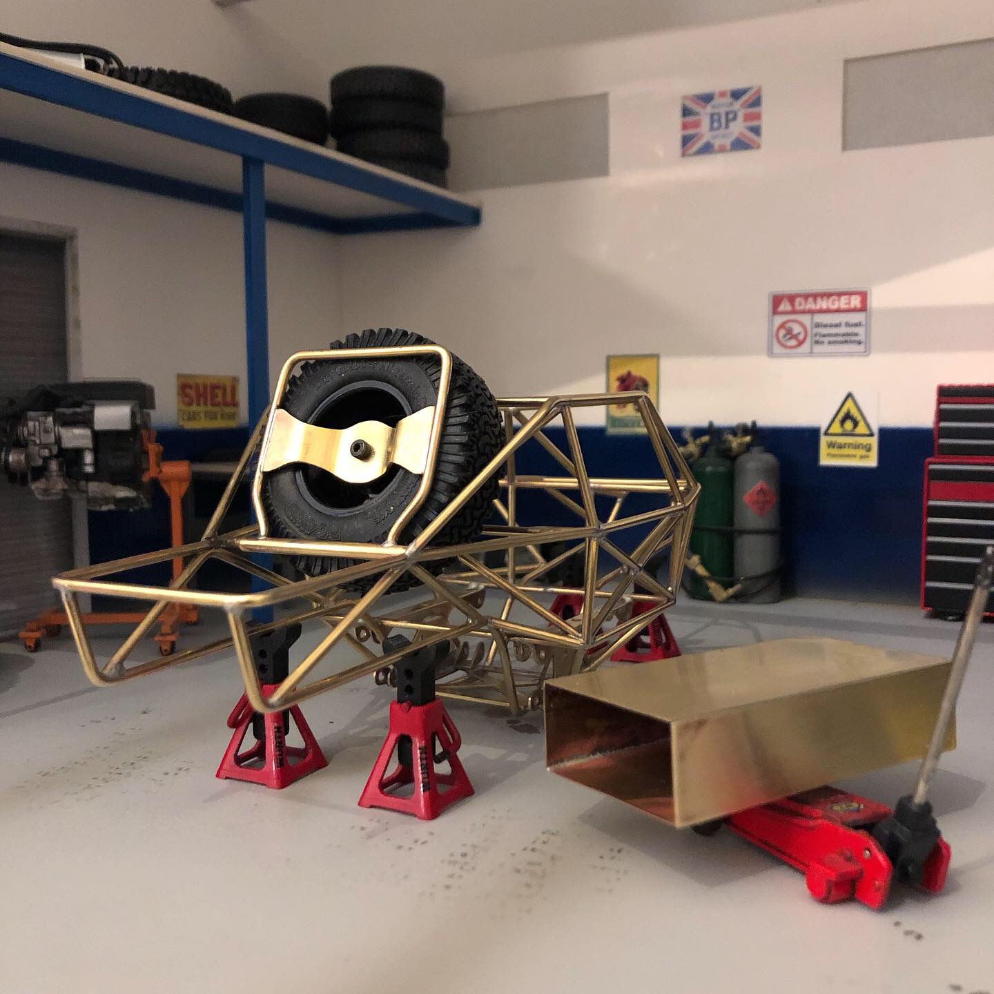

Thank you so much guys,
Here is a small clip just to show the size of the build.
Brazing is such fun. sure it takes time, but just love it when all comes together.
Made a fuel tank/storage = battery compartment and a spare tire hold down yesterday.
