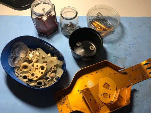

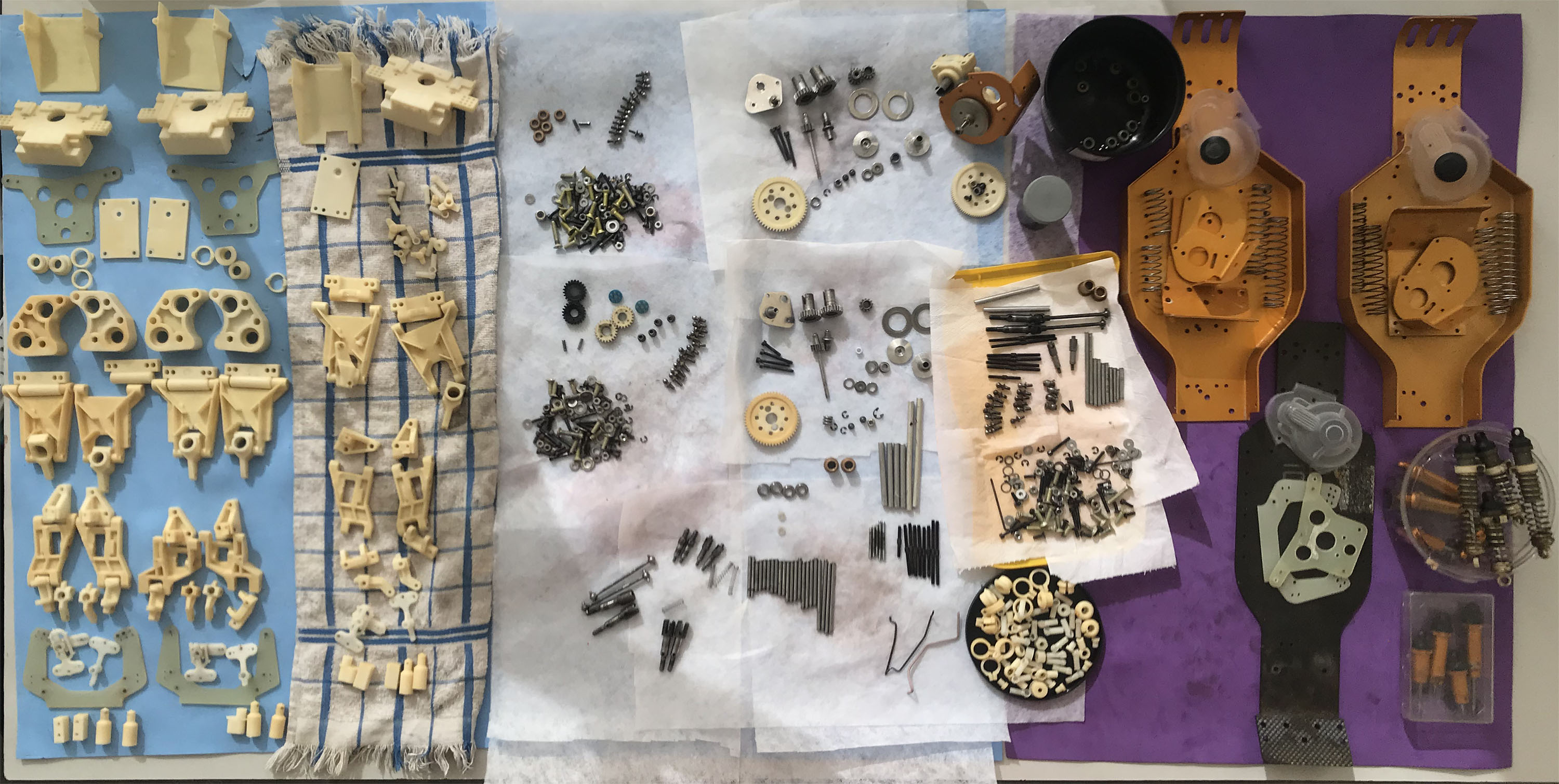

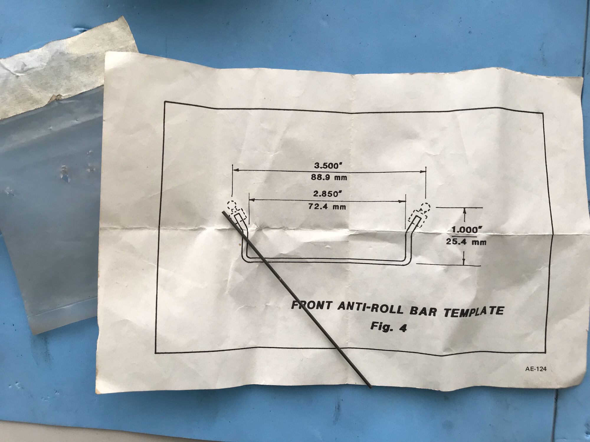

Ok, so every screw and e-clip (OMG) has been removed and the car is disassembled down to the last piece; except for the infamous 0.035” screws in the idler gears, and the shocks which will be a separate job.
The metal parts have already been through a soak in kerosene, but tomorrow will be a scrub and degrease day for the plastics and tub.
Finally found out what this spare is; an anti roll bar.

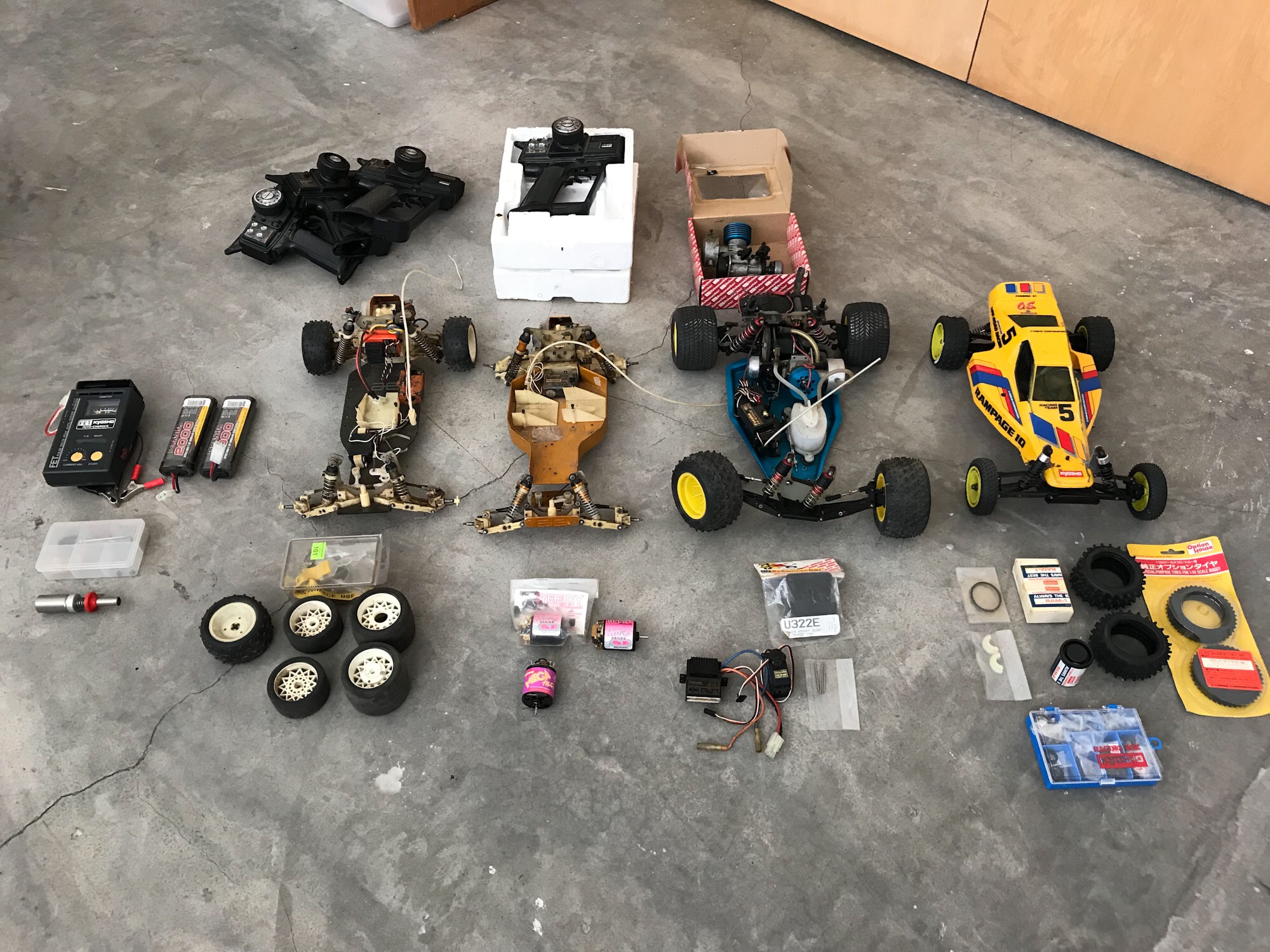

And I happend upon a lot of spares!
Amongst the “spares” is an almost complete Graphite Team Car in excellent condition, and a fairly complete Championship Edition in pretty poor shape, with six gear transmission, almost full ball bearings, and no wheels. Neither has a body.
The CE is going to combine into the car I’m already restoring. In fact I’m already halfway stripping it down. The Graphite is a future project.
Also in the box was a kyosho Rampage GP 10 in excellent condition. It barely looks to have been run, and it came with loads of spares. It’s complete except it doesn’t have an engine. So now I need two O.S. CZ replacements; one for my Stinger and now one for the Rampage.
The last car in the lot is a Schumacher Nitro 10 truck which is missing the steering assembly and, even though it came with a replacement bracket, the original front end has been cracked. The R10 CE front had been grafted onto it in the worst way.
I’m trying to figure out if the Irvine 15R engine in it can be adapted to fit the Rampage.

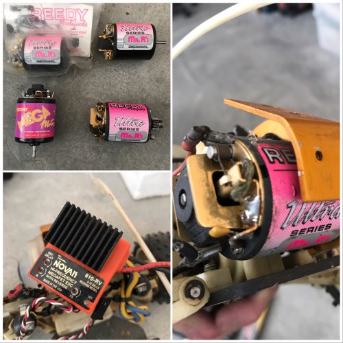

I also got five motors in the bundle: 4 Reedy Mr R’s, and a Kyosho mega something.
Sorry about the extensive post, but I had to share (and my wife doesn’t get it).

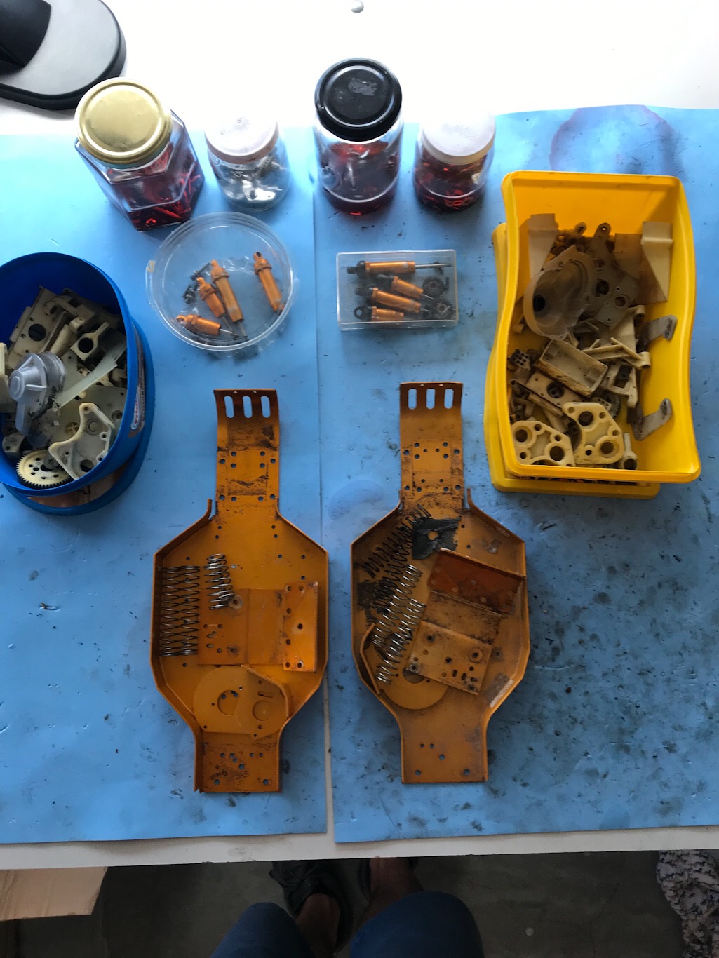

Here are both cars fully disassembled. Chassis, plastics, metal parts, shocks and transmission elements in separate containers.

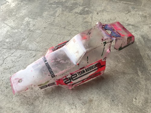

Currently have one of the bodies soaking in nitro fuel to see if I can remove the paint. Tried brake fluid over the weekend with non luck. It may have been old.

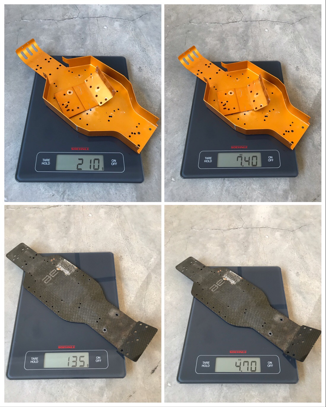

Re: RC10 Cadillac A-Stamp Restore Attempt
Weighed the gold chassis vs the graphite chassis. There is a substantial difference. It won’t make much of a difference to me, but I’m definitely going to be building the graphite for other reasons. Grams on the left, ounces on the right. I’ve never built an RC10 before, so let me know if I’m missing some part to make the match even.

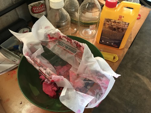

Trying to strip the paint off the body has been giving me some trouble. Tried various old dot4 brake fluids last weekend, with no luck. Maybe they were just old.
Then I found a bottle of whiskey marked “thinner” in my dad’s barn, and since I figured it was most likely marked “thinner” just so no one would drink the whiskey, I decided to try it on the wing which was already fairly broken. Well, that was the end of the wing, so I made a mental note to not strip paint or drink from anything marked “thinner”.
Currently getting much better results using 16% nitro fuel. But it still needs work.
