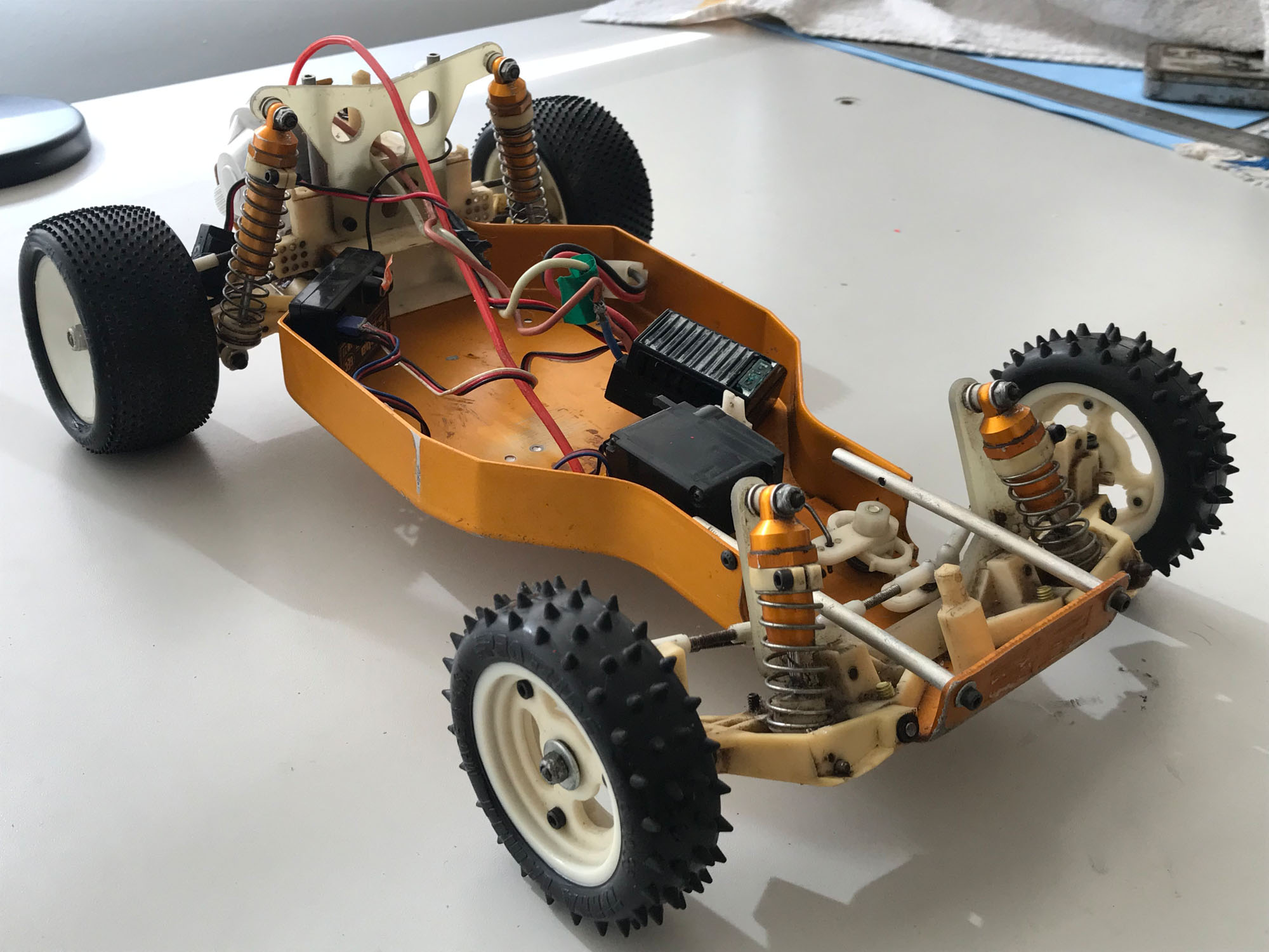

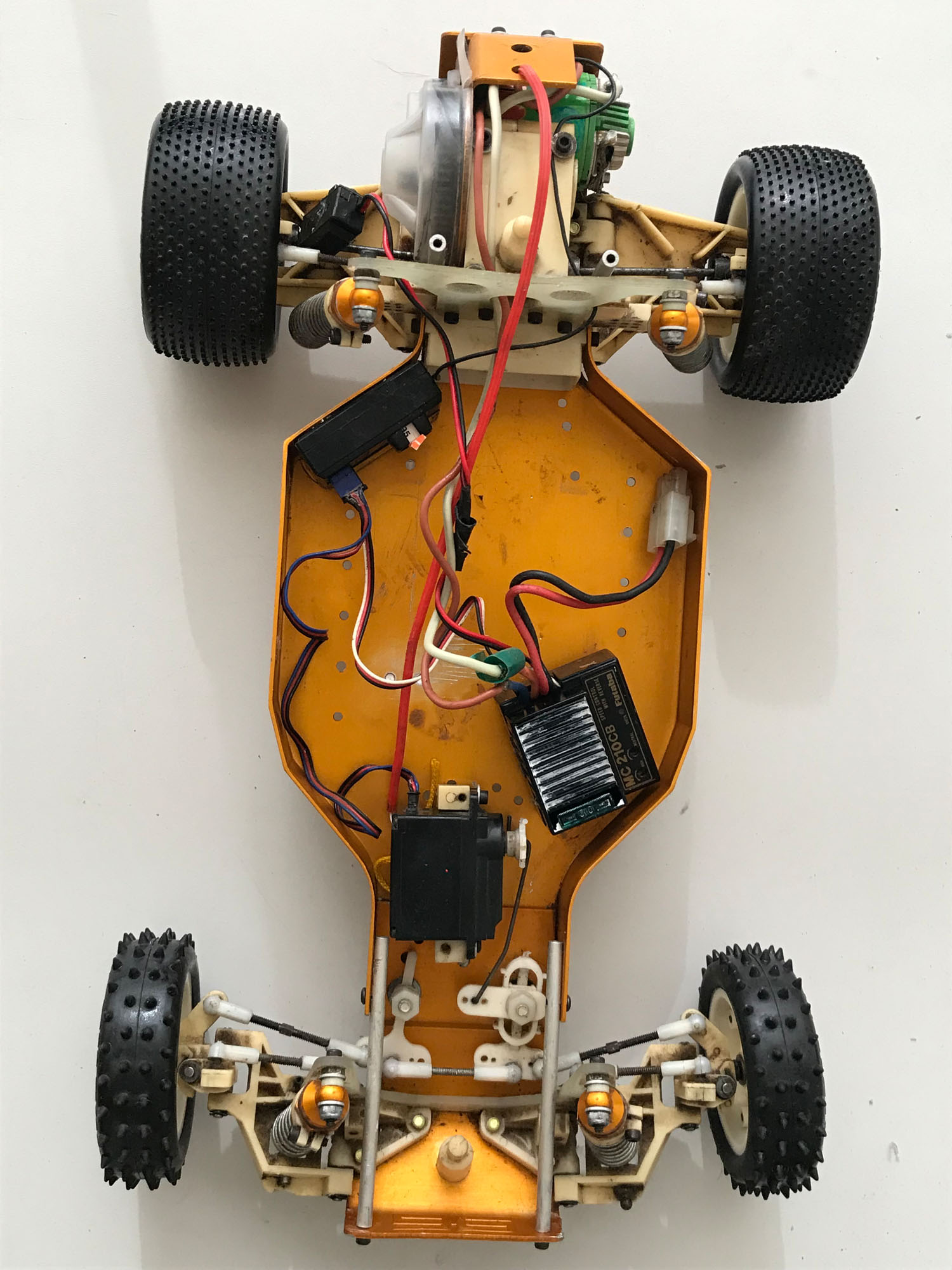

I thought I'd start a new thread for this attempt restoration project. I'm only expecting a runner/basher out of this car.
I picked it up yesterday and gave quick description of what I found in the box here

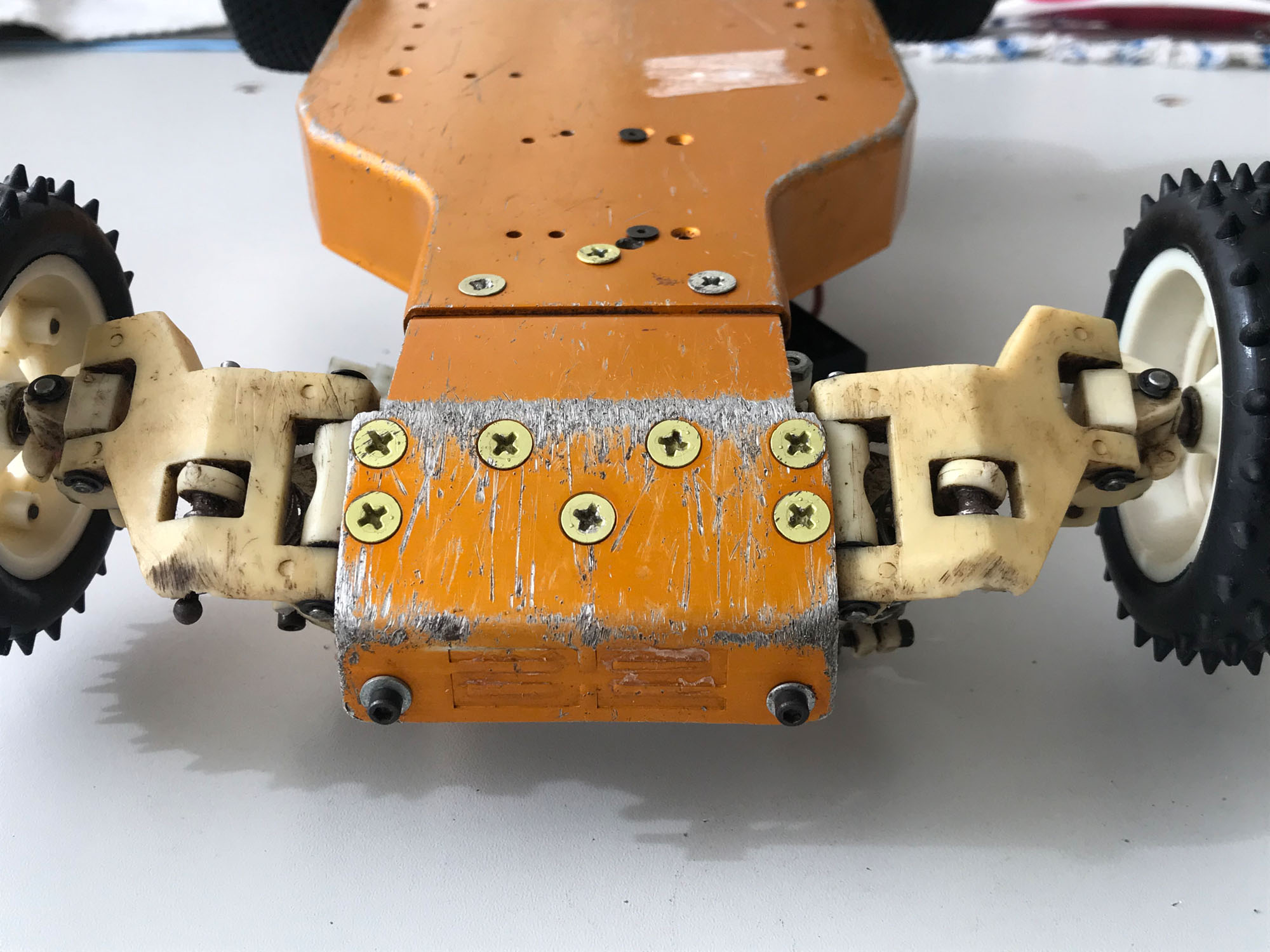

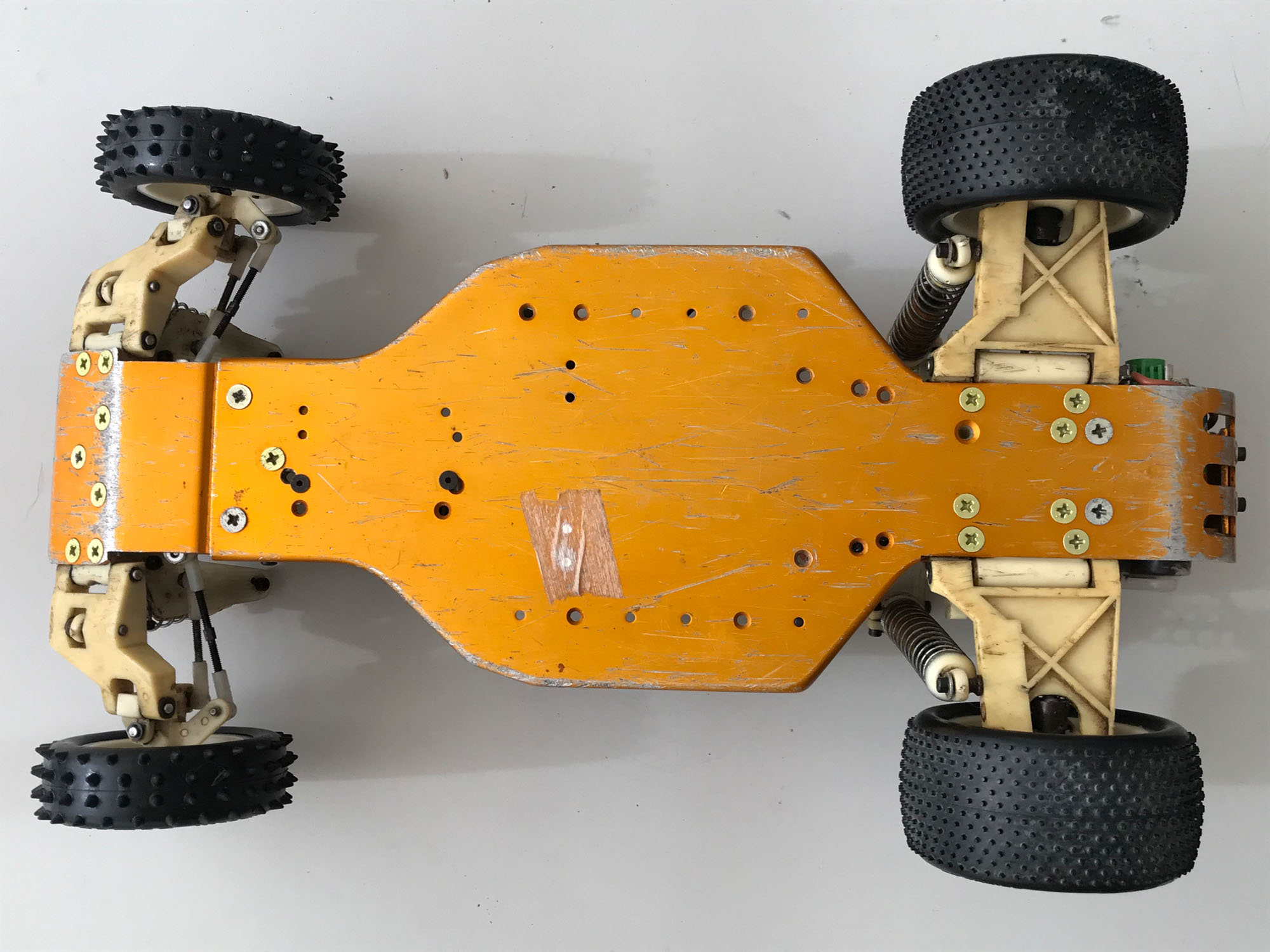

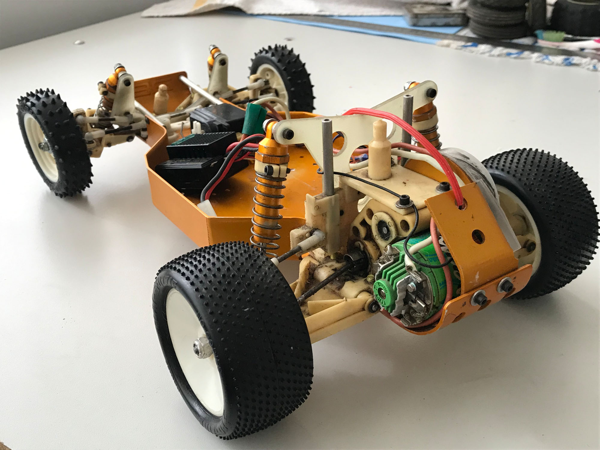

Here are some further photos in better light:
Nice set of tires!
The servo saver and rod ends are much whiter than the other parts. They have obviously been replaced.
The front end is pretty beat-up. There is about 0.5mm play at the suspension mount on either side. The new cars I can compare to have none. But maybe it's OK?

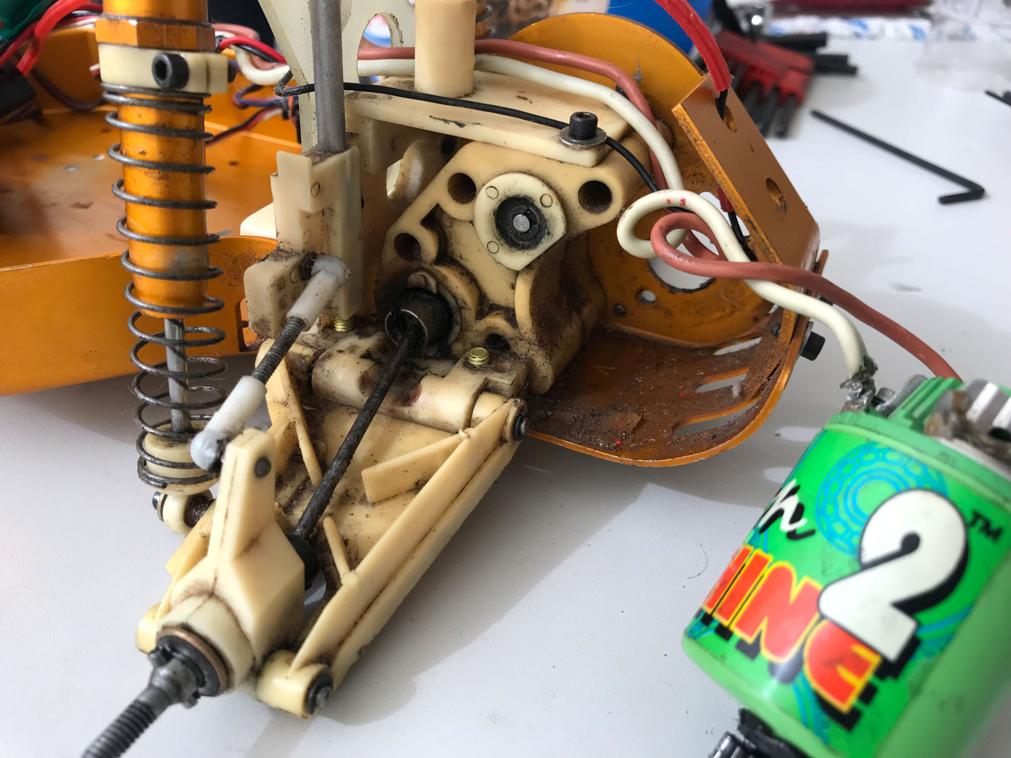

Grease Lightning!
There also some play at the outdrive hubs. I'm dying to get into the transmission. So I'm going to start tearing this car down and post here with updates.

the ball cups and steering parts are a plastic blend, not just nylon, (or glass filled nylon), so they always look different.
that's a nice car to use as a runner. definitely break that down and rebuild as necessary, especially all that ugly gear grease.
looks like bushings, hopefully all the axles are not worn down.

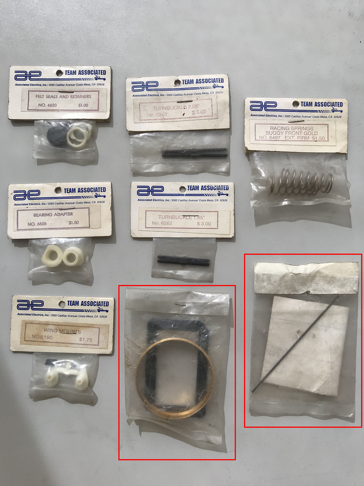

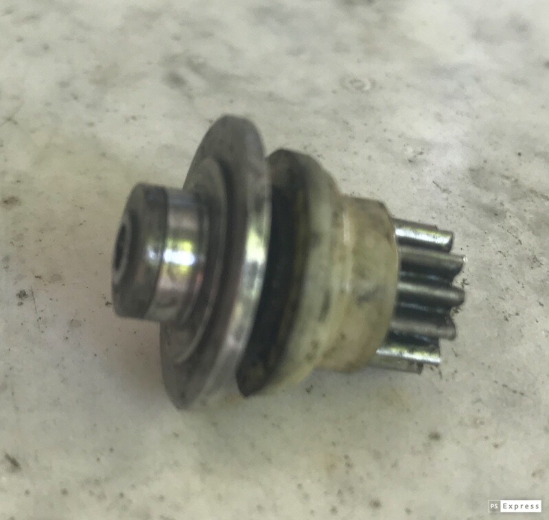

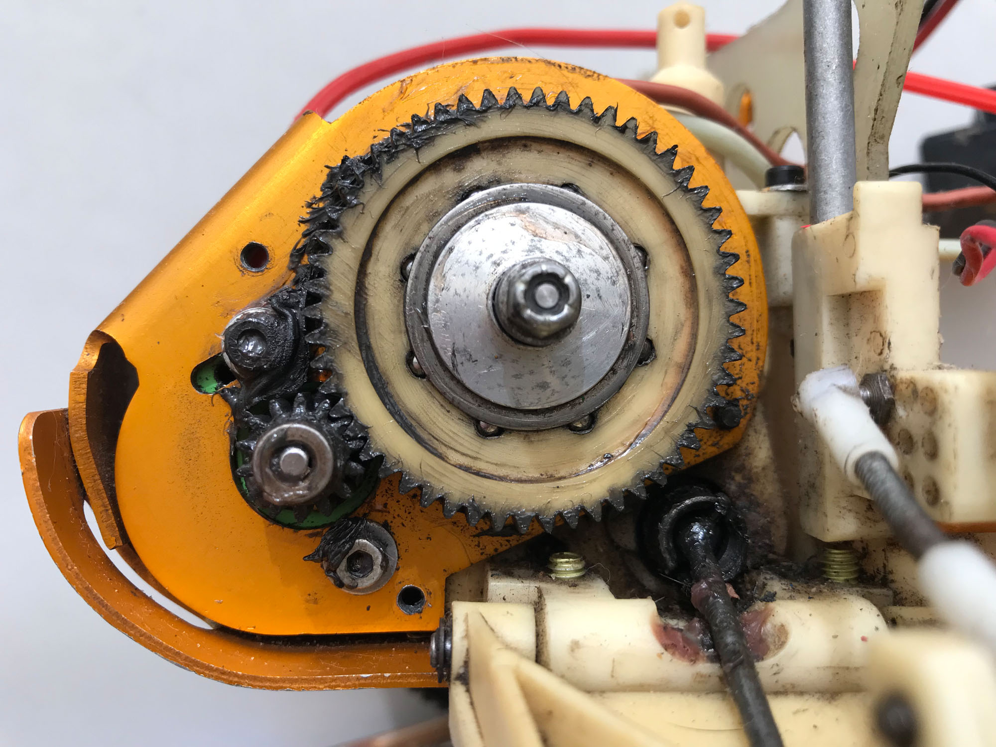

I pulled the transmission apart today. It looked OK inside, no stripped or worn cogs. I did find a missing pin in the drive gear pivot, and a missing Teflon bushing.
There are a few transmission spare parts which came with the car, which is handy (epecially the felt seals).
There’s a couple of spares which I cannot ID. Anyone have a clue what the two marked in red below are? One bag has a gold anodized aluminum ring and two felt gaskets, the other has a very thin (metal?) rod and some folded instructions ( I guess I should just open that one).

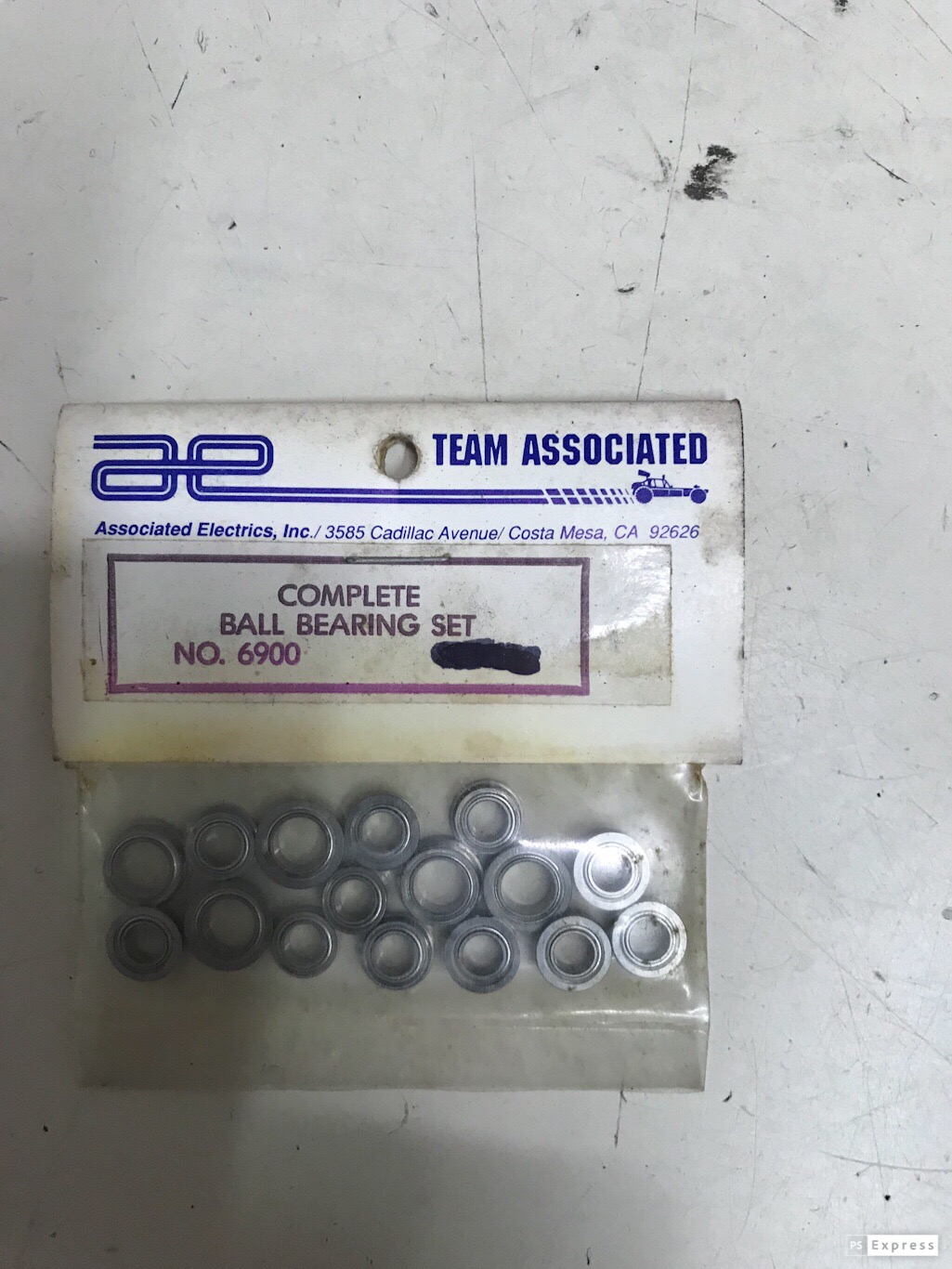

I’m also thinking of leaving the bushings that came with the car in there for the time being. The hobby store that has some remaining RC10 spares is asking US$ 57 for the compete bearing kit for this car (see photo below). That’s just short of what I paid for the car itself. My wife will be traveling in a couple of months, so I could have her bring me a more reasonably priced kit, along with a few other spares and upgrades. The bearings are $16 + $5 shipping in the US from Avid.

That's a nice collection of spares although I have no idea what's in the two mystery bags.
Seeing that bag of bearings brings back memories. I recall that AE bearing sets were always very expensive. Today, I buy bearings from Avid.
You're about to embark on a pass-time that I've grown to enjoy. I like to buy old derelict RC10's (diamonds in the rough actually), pull them apart, scrub the nylon parts (warm water and dish soap) and get them soaking while going through the rest of the metal parts, sorting out what to keep and what will need to be replaced.
...and remember the good ole days.
After they're rebuilt, the nicer ones go on the shelf and and the others become new runners. I never seem to tire of rebuilding and running them. It's such a great car!

If you’re not worried about the bearings quality the Avids will do great, I have 2 types of Avids that are great but my old ass original associated bearings can smoke them.
The price is about correct for that bag of bearings I would jump on it.

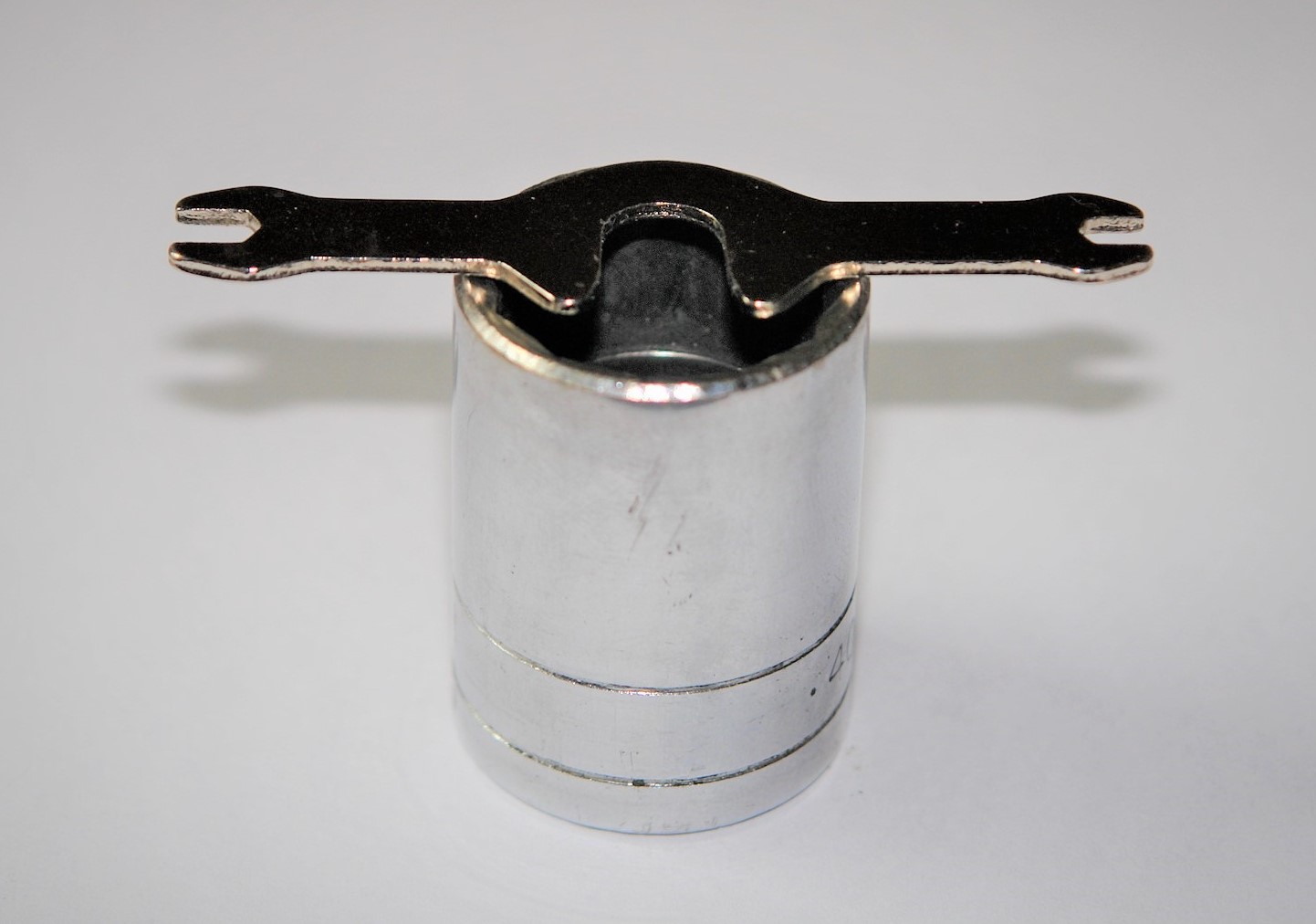

Can anyone suggest how I should remove the “diff gear” from the “ diff shaft”?
The manual indicates the gear is simple press-fit onto the shaft.
EDIT: sorry just found this thread. This should have the answer in it.
https://www.rc10talk.com/viewtopic.php?t=28674

I have always used two flat blade screwdrivers to pop the two apart, but you have to be gentle. It’s not on there all that tight.

This is what I use
Slip u-shaped part of wrench between bearing holder and diff tube.
Remove nylon bushing opposite the gear
Place gear end down.
Take blunt end of drill bit and tap the tube out
Chuck
