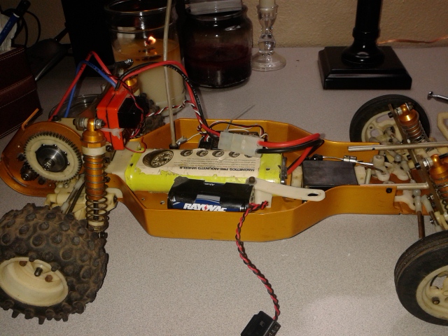

okay so i have just got my 2nd rc10 buggy . this one is an old one its an A stamp and has a few of the older parts from the early models but i think its a Cadillac . maybe some one can tell me exactly what it is. i want to have fun with this classic car looking not to spend more than 120 on replacement parts . so one question i had . i charged the battery for 4 hours to give her a run. well it ran but it was super slow also the battery died in 5 minutes . i cant tell if thats a gearing ratio for the motor or if its the battery. also i am looking for street/dirt tires not the giant vintage nubies .
so this is the car .  i plan on racing and bashing this guy .

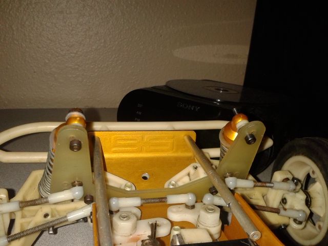

so my first question is  what should i do for a sharper turn  . the turning on this is extremely week  and i would like to make tight turns.   i was thinking the J concepts but i dont know if thats all i would need

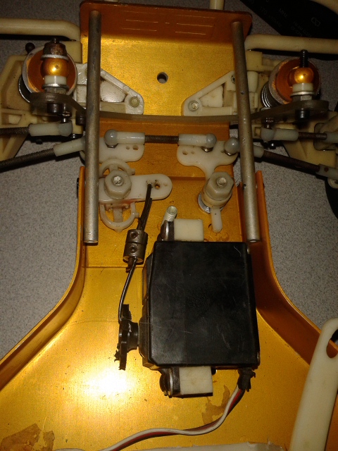

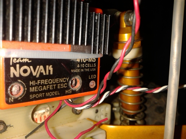

next question this esc i need to replace this guy   it has no reverse and for obvious reasons  i need to find one that A: is brush-less and water proof or depending on the response to my later questions  one that B: would be good for  speed and a little torque

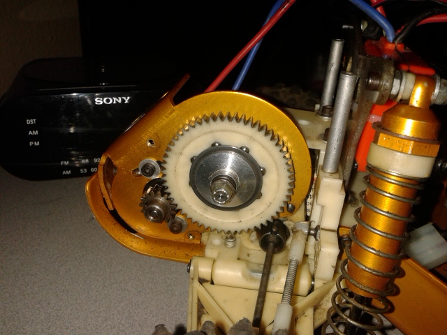

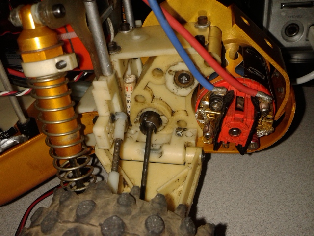

the next two pics are of the transmission and big gear  this is one of the things i would like to know   should i get the stealth  or is the 6 gear  good to role for a while ?     also  the big gear makes me think its an older model than a Cadillac because of the bearings imbedded in the cog.

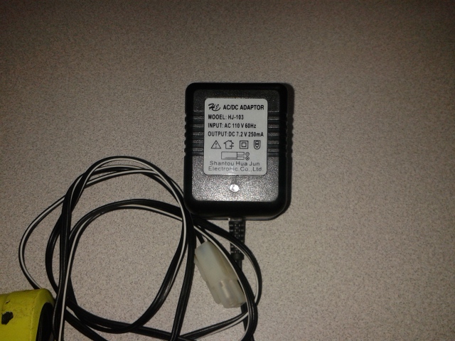

i charged the battery with the charger below it.  will this charger be sufficient for the battery  or  is the battery toast?   next   if i go lipo  batt    what would be comparable  and or give me the fastest longest run time ?

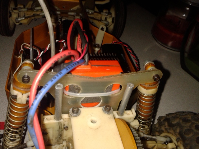

these two pics  have me confused as well   these are stock shock towers  but  there is only one hole drilled in them    i was under the impression  there should be more holes in them ?

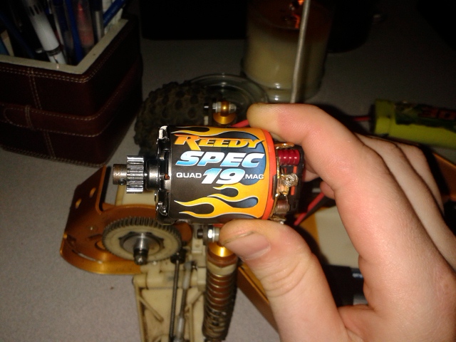

next  this motor came with the car when i got it .   will this motor be good for this build im looking at  ? or  should i go brush-less   in that cast  what  would be a great brush-less motor and pinion   to  work  for  what i want to do ?

Pic 1, Looks like a great start.
Pic 2, Put small cable ties around the steering on the left, the one with the big nut to stop it
expanding or you can convert to Worlds Steering.

Pic 3, Vintage Electronics will usually be o.k but a new brushless system will be a lot less
maintenance.
Pic 4 & 5, A 6 Gear will be fine for a while, do you have a manual :?: It would pay to give it a
freshen up.

Pic 7, Poor quality charger, research the link I gave you and invest in a better one.
Pic 8 & 9, Early towers less adjustment.

Hold the front wheels, try to move the servo arm, the part on the left is a built in servo saver it
will expand, that is the place to put the cable ties, one in front of the nut and one behind.
Worlds steering is better :!:

That's a pretty average price, but I think a 9T/60A ESC combo is a lot of power for a vintage RC10. If it were me, I'd probably go no lower than 13.5T. The 17.5T Dave suggested is a reasonable choice. The XERUN systems are sensored, hence they're more expensive, but their sensorless EZRUN systems work very well on a budget.

thanks for the reply guys :) i got the whole kit set up now .. 4370kc brush less . 5500mah 2 cell lipo . charger is on the way . new esc . skyfly radio . worlds steering , ( problem was not what i thought , but turned out i just needed to get a new servo arm) car runs like a charm i have a body in the mail as well.... one problem persists. where can i get a metal spur for this car .... mine melted after 3 minutes it no longer works. 55 tooth preferably. is it possible to get one that wont rub between two plates ? and i was asked if the car had bearings. where and no not at all . why do i need them and how do i apply them lol :)

Sounds like you roasted the differential. It may have been set too loose or just overpowered. In any case, it was slipping too much. Without correcting that, a metal spur gear would allow the heat to travel further into the transmission, melting different parts.
If you snoop around the site, you should be able to get squared away on ball differential basics and adjustment.

stoggie388 wrote:thanks for the reply guys :) i got the whole kit set up now .. 4370kc brush less . 5500mah 2 cell lipo . one problem persists. where can i get a metal spur for this car .... mine melted after 3 minutes it no longer works. 55 tooth preferably.
You put nearly 37,000 RPM through that transmission (4370 kV * 8.4V); I'm not surprised you fried the spur gear...good thing you didn't cause more damage. As I said previously, I wouldn't have gone lower than 13.5T (in the neighborhood of 3000 kV) to be on the safe side. :wink:
