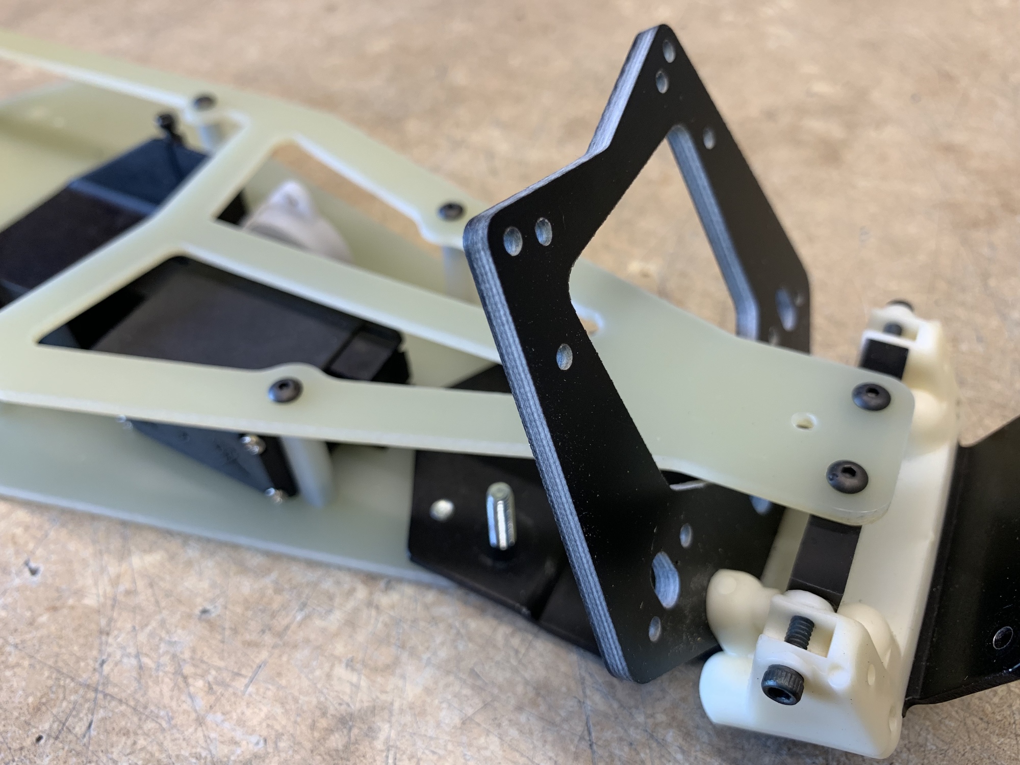

If these are done with a bolt on nose plate I can help with cutting them, but without a brace up top you will find yourself bending noseplates. Maybe a upper like the ones we use on the CC style kits would help. It would need to be designed for the nix chassis tho

I don't mind the fiberglass construction,as long as it's Black...lol. I like the upper chassis brace...if it's large enough for a full length lipo? Otherwise I'll have to get new batteries (not a big deal).Please send me a PM for the price on 6.

pic was shown for concept only. That upper brace wouldn’t fit anything but the chassis it is on. Best to get with Niki and see if he wants to draw up a chassis set with upper chassis. I’m sure he will chime in
