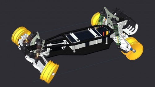

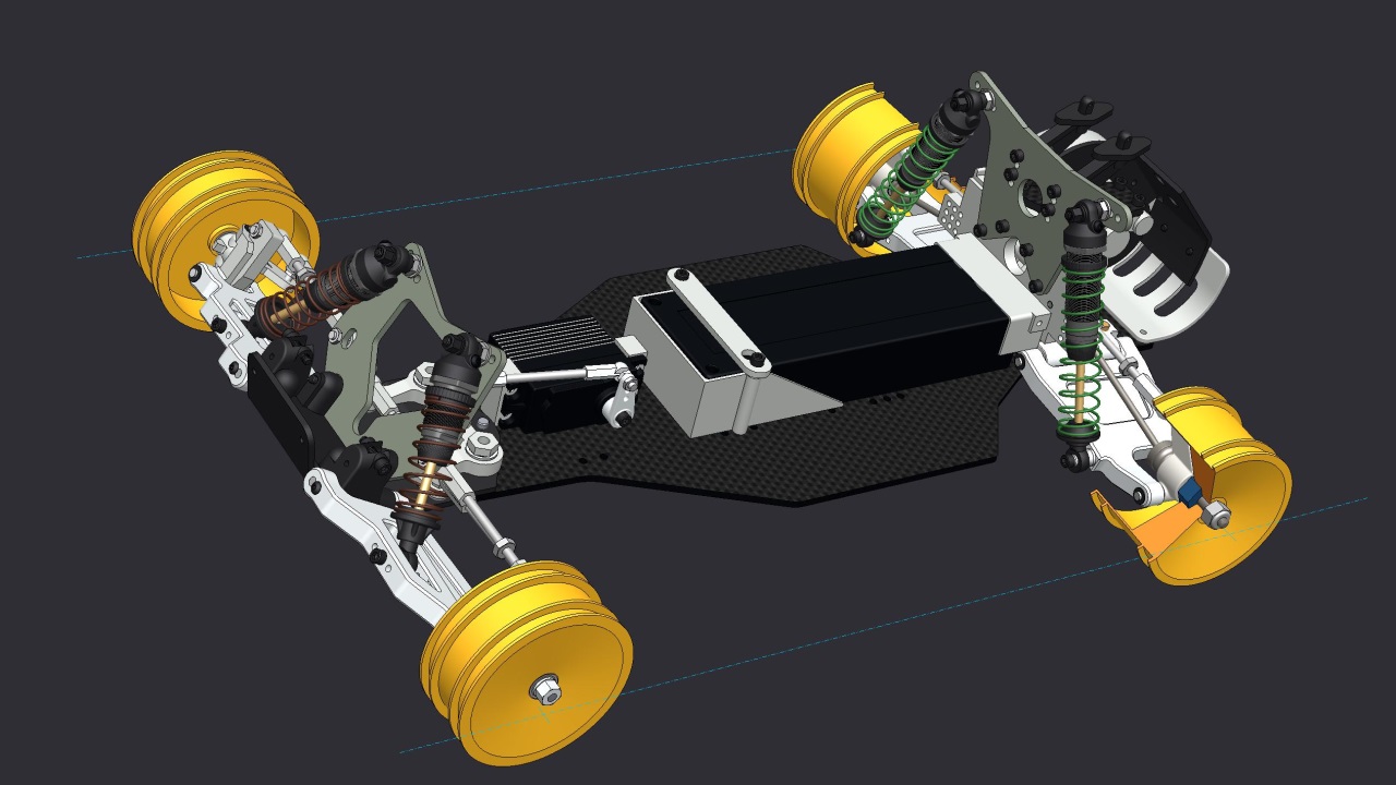

Wheelbase is now 275mm. Should we make it longer?
Next step is to design the upper deck. Probably rather traditional design coming up...

Re: Quadra-symmetric RC10
This chassis is not in any way "Quadra specific". It will work with any arms that suits 10T nose setup.
Chassis lower deck number is NIX63057 and upper deck is NIX63058. I will send the drawings to GoMachV.
4pcs 1" standoffs and one upper deck front end mounting part needed to complete the design. Upper deck front end mounting screws are 20mm apart.
