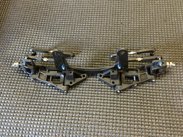

So the plastics had a wash and a bath in the rit dye and made a start on the front end (B4 c hubs/hubs)
I’m going with a black/blue theme
If in doubt go flat out!

Are the B4 parts a direct fit to the vintage arms? No modification required?
jwscab
Posts: 6580
Location: Chalfont, PA
Been thanked: 505 times
Re: It’s starting again! RC10 Build number 4!
Post by jwscab »
lower hinge pin hole needs to be opened up to 1/8"
XLR8
Posts: 3318
Has thanked: 1684 times
Been thanked: 1180 times
Post by XLR8 »
Thanks Joe. That's not so difficult to do. So I guess width is the same (or close enough).
I'm always looking for cheap replacement parts for my runners.
radioactivity
Posts: 856
Location: Dripping Springs Tx
Has thanked: 384 times
Been thanked: 618 times
Post by radioactivity »
You should gain appx. 3mm per side with the B4 front 9580 Caster block 25˚. With modern wheels and tires and long front arms this should put the overall width quite close to the max 250mm width.
This would be the same setup I have on several cars.
I use the 25˚blocks to keep the 30˚ angle of the stock RC10 suspension. B4 is based on 25˚ kickup.
In other words, the hinge pin on the 9580 is perpendiculr to the axel and will impart no additional "lean" to the Rc10 suspension.
Chuck
