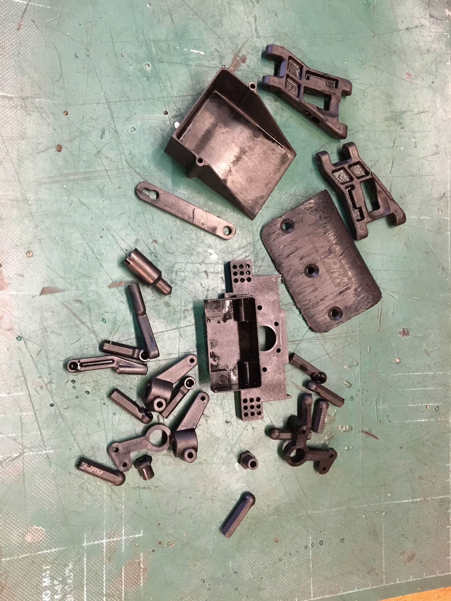

Had this old chassis from a 10t hung on the garage wall and thought what the hell let’s build another one!
Some of the bits are getting hard to come by but we will plow on and have a go!!
Chassis is going off to be vapour blasted as it’s covered in crap and old superglue and the plastics are going to be dyed black

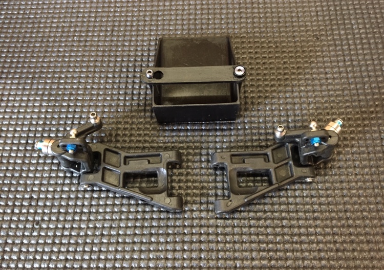

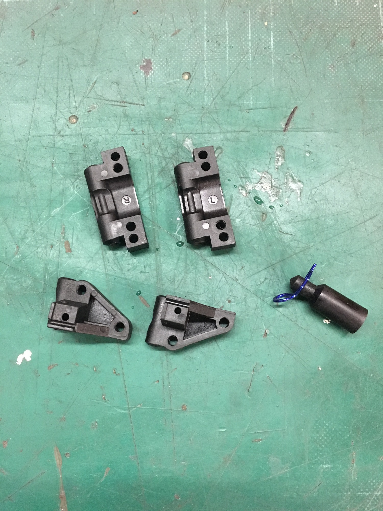

So the plastics had a wash and a bath in the rit dye and made a start on the front end (B4 c hubs/hubs)
I’m going with a black/blue theme

Are the B4 parts a direct fit to the vintage arms? No modification required?
jwscab
Posts: 6580
Location: Chalfont, PA
Been thanked: 505 times
Re: It’s starting again! RC10 Build number 4!
Post by jwscab »
lower hinge pin hole needs to be opened up to 1/8"
XLR8
Posts: 3318
Has thanked: 1684 times
Been thanked: 1180 times
Post by XLR8 »
Thanks Joe. That's not so difficult to do. So I guess width is the same (or close enough).
I'm always looking for cheap replacement parts for my runners.
radioactivity
Posts: 856
Location: Dripping Springs Tx
Has thanked: 384 times
Been thanked: 618 times
Post by radioactivity »
You should gain appx. 3mm per side with the B4 front 9580 Caster block 25˚. With modern wheels and tires and long front arms this should put the overall width quite close to the max 250mm width.
This would be the same setup I have on several cars.
I use the 25˚blocks to keep the 30˚ angle of the stock RC10 suspension. B4 is based on 25˚ kickup.
In other words, the hinge pin on the 9580 is perpendiculr to the axel and will impart no additional "lean" to the Rc10 suspension.
Chuck

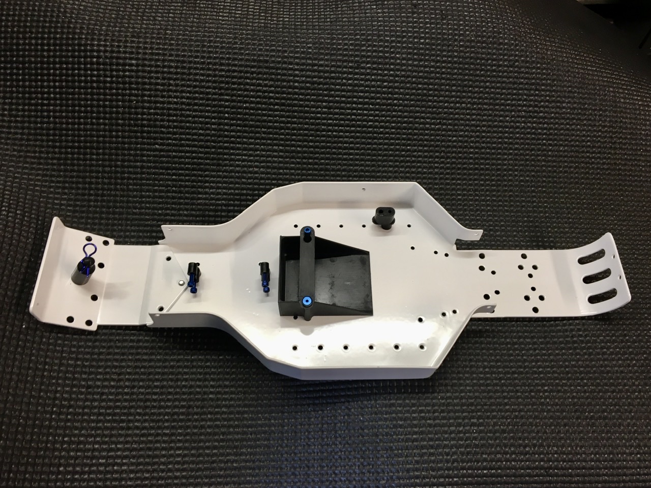

So my chassis has been vapour blasted and powder coated in gloss white

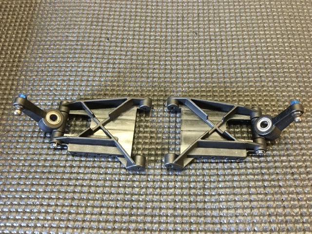

Steering completed
