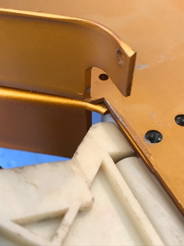

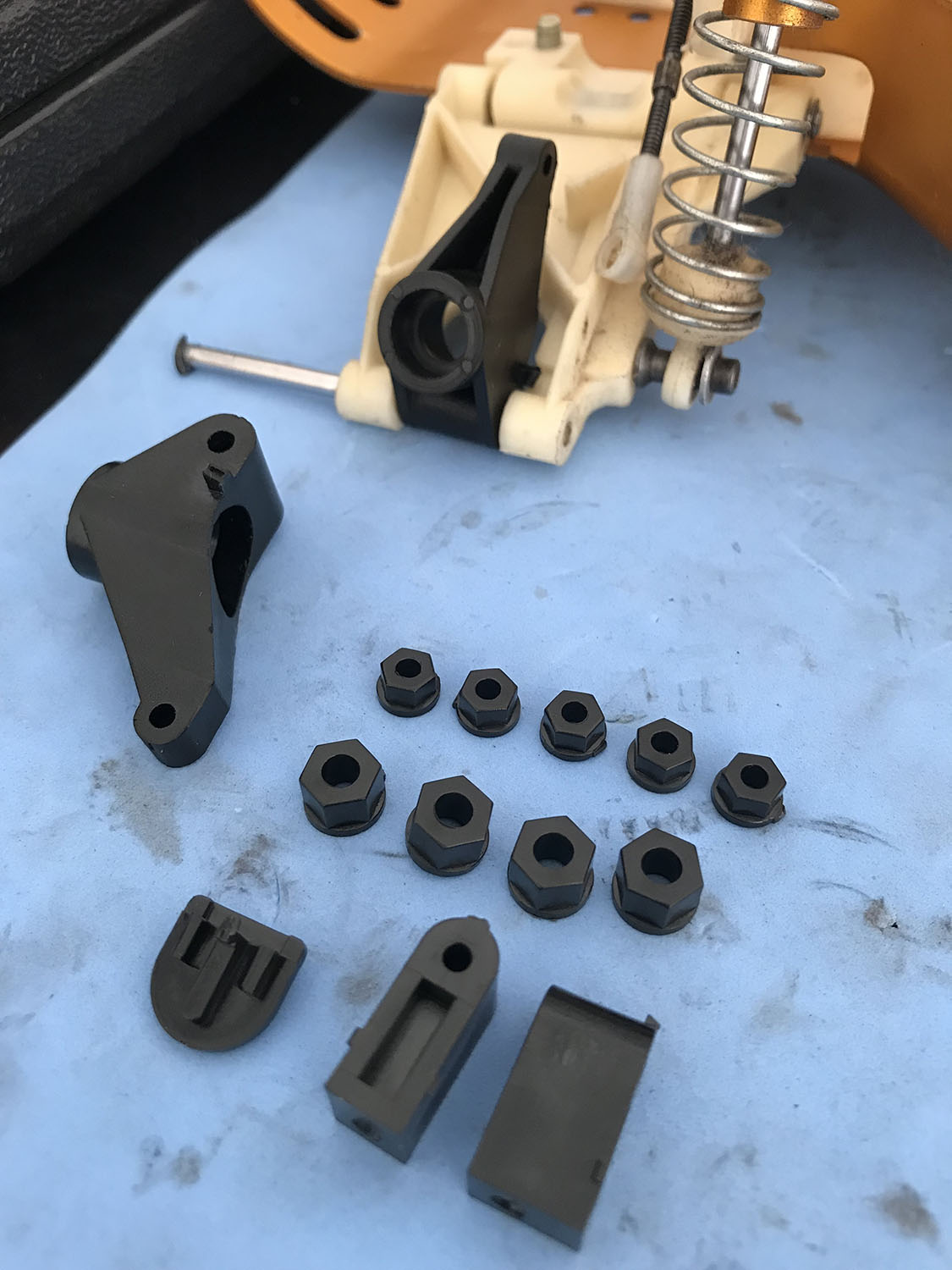

Pulled the transmission from the chassis and was happy to find that the gear box itself spins very freely. So I don't have to go in there.
Next problem is the axles. I'm pretty sure most of the drag is coming from here, and not only when the suspension is in full drop.
First thing is, I mounted the suspension mounts in the rearmost position (that is, I used the two holes which position the mount closest to the rear, and therefore extend the wheelbase).
I didn't do this for any other reason than that the chassis plate I'm using has a little extra material which does not allow for the A arm to move freely if the mounts were installed forward (See picture in next post).
This makes the dogbone axles always be at an angle from the gearbox to the hub. Should I file the chassis plate down so that I can fit the mounts forward?
I've checked a couple of manuals and none mention which position to mount at, as if there were only one set of holes in the mount.

Here’s the picture of that extra lip on the chassis plate which touches the A arm when the suspension mount is installed in the forward set of holes.
Bottom chassis in photo is the A-stamp I’m using, top is a B-stamp.

yeah the A stamp chassis should be trimmed if you plan to use the forward mounting position. That was a running change from A to AB to B. the car should still be OK in the rear position, as it was run that way with the 6 gear as shown in the manual.

Axle friction
I've narrowed down the source of friction to the rear axles.
I had hoped to get away with using the worn bushings and axles that came with this car, but the wheels wobble and bind rather than spin freely. So I'm already replacing the bushings with a set of bearings I had set aside for another build.
But I'm also getting some binding in the slots where the dog bones engage the axle. The slots are a little rough, so I'm going to file down the edges and make them as smooth as possible.
On a side note. Can anyone ID these hub carriers? They fit the A arm space perfectly and have all the holes in the right places, which makes me think they are intended for an RC10.
The bearing space in these is 10mm, which might make it easier for me to get bearings for them. I would need a new metric axle too; maybe for hex hub? Wheel clearance might be an issue.
Curiously, the hinge pin hole is smaller then the RC10 pin, so I would need to enlarge that too.
Not sure what some of the other parts are. Too short and too few holes to be servo or aerial mounts.

Those are all Ultima parts (not rere). The rectangles are servo mounts (kyosho didn’t use 4 screws per servo just two) and the shield shaped part is an access cover for the ultimas gearbox.

Thanks. There was a Kyosho Rampage gp 10 in the lot, but the hub mounts are different.
I’ll put them aside for now.
