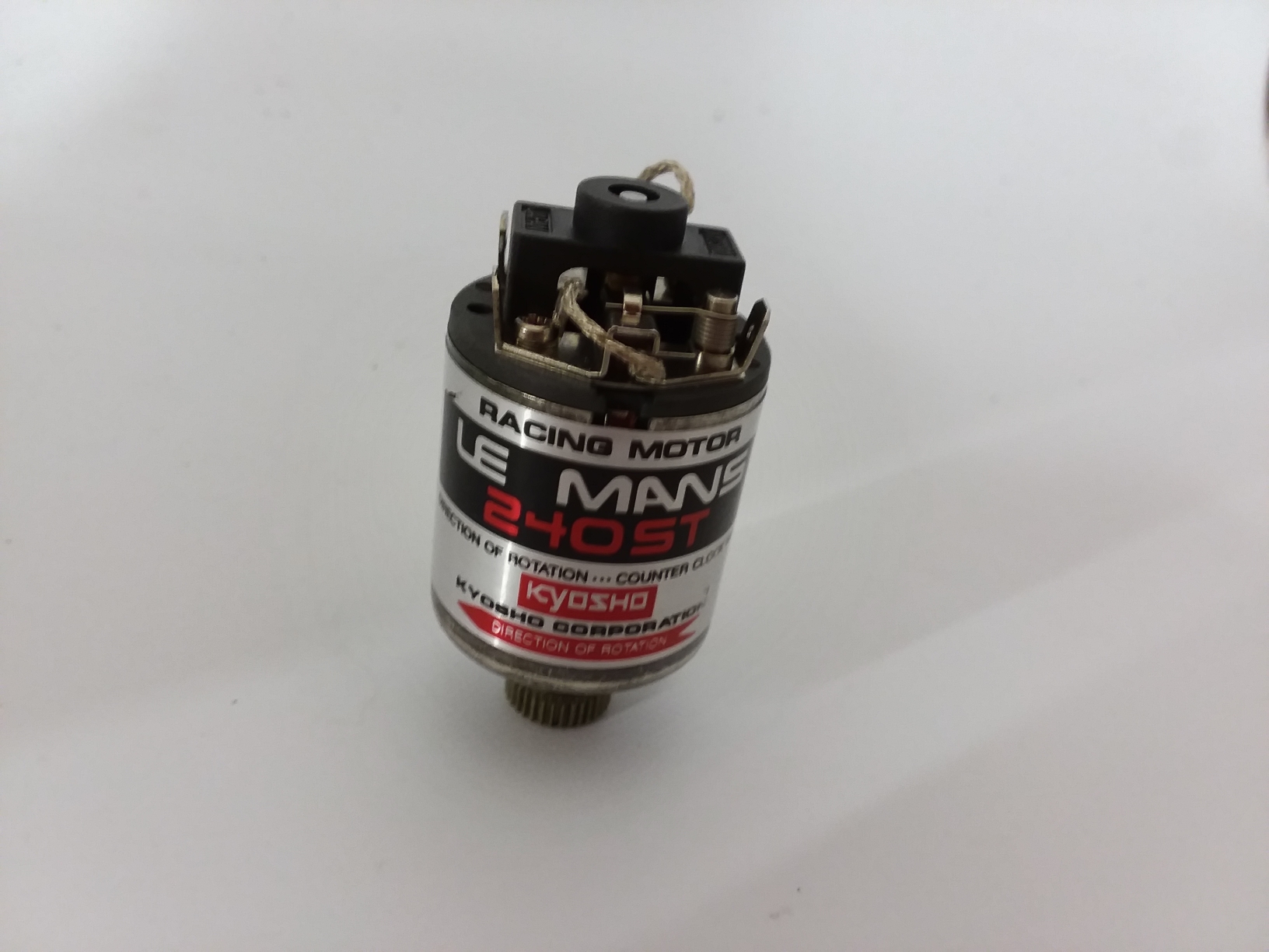

Couple more restos:
240s 26,000rpm @ 0 degrees 7.2v
480spa 20,500rpm @ 0 degrees 7.2v

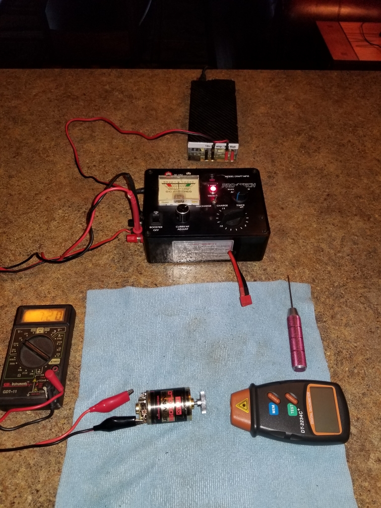

I will get a pic of my setup tommorrow as i am doing a "holy grail" 360 Gold!

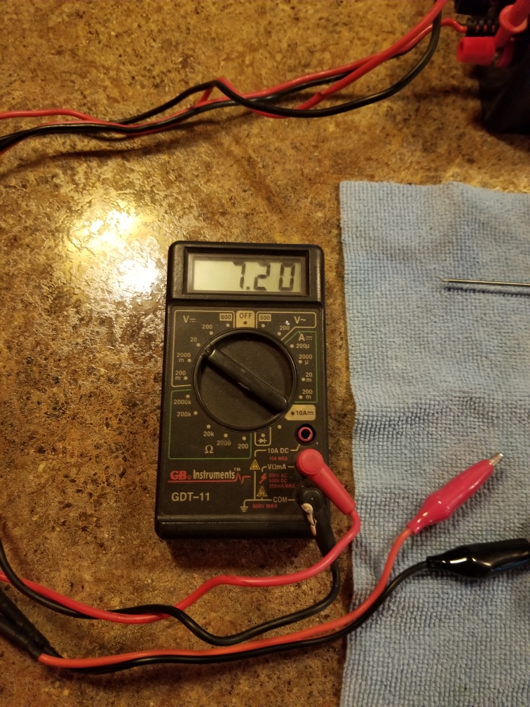

The vintage ProTech charger was bought on ebay for less than $20 shipped. I ripped all the guts out except timer, ammeter,....added a 12v rheostat off ebay to control voltage. Operates off 12v power supply. rpm is read off infrared meter, pick up is pinion with refelctive tape. I built a load meter in it using another 40amp rheostat driving a slave motor in reverse at a lower voltage but was too hard on the motors. All motors tested at 7.2v running, 0 degrees timing on the can (using the arrows and marks on decals)

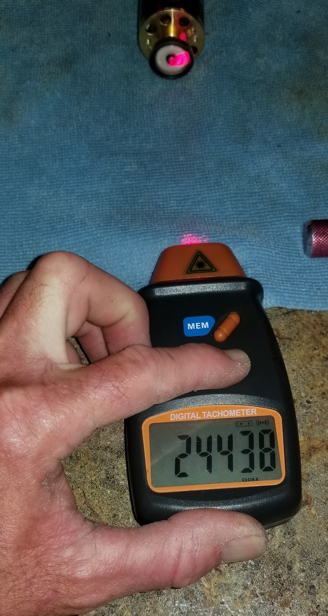

My latest resto, "Holy Grail" 360Gold. Havent replaced decal yet, waitn in shipment from MCI. This puppy turned 21,xxx rpm as delivered. After rebuild, 24,xxx rpm.
