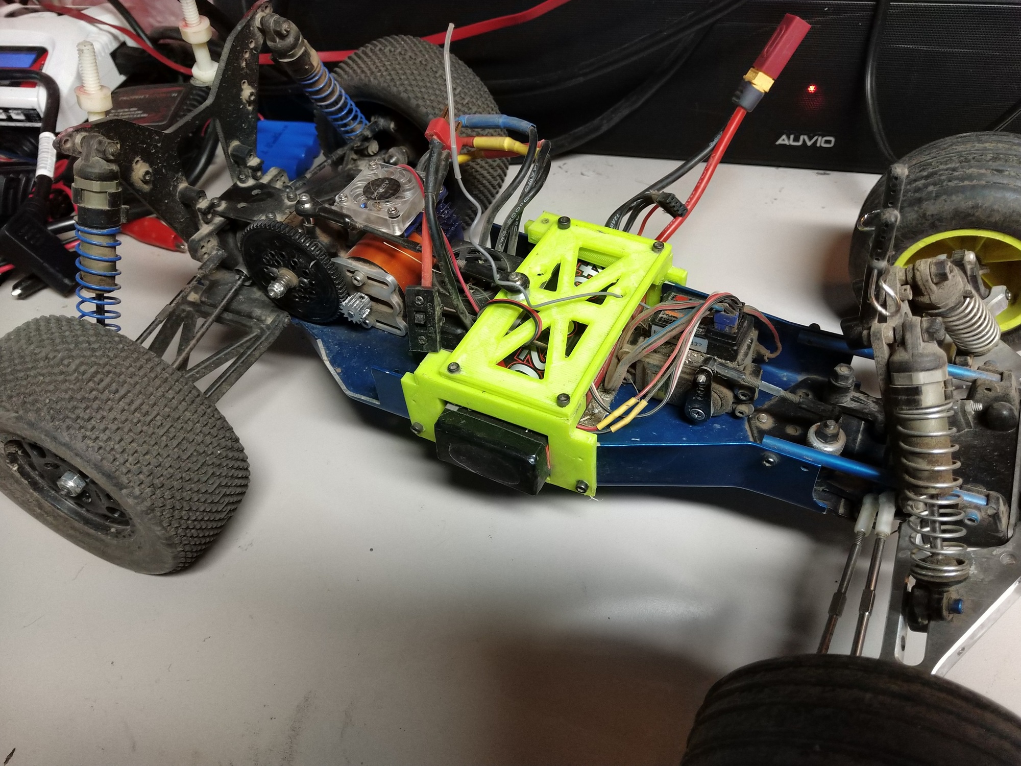

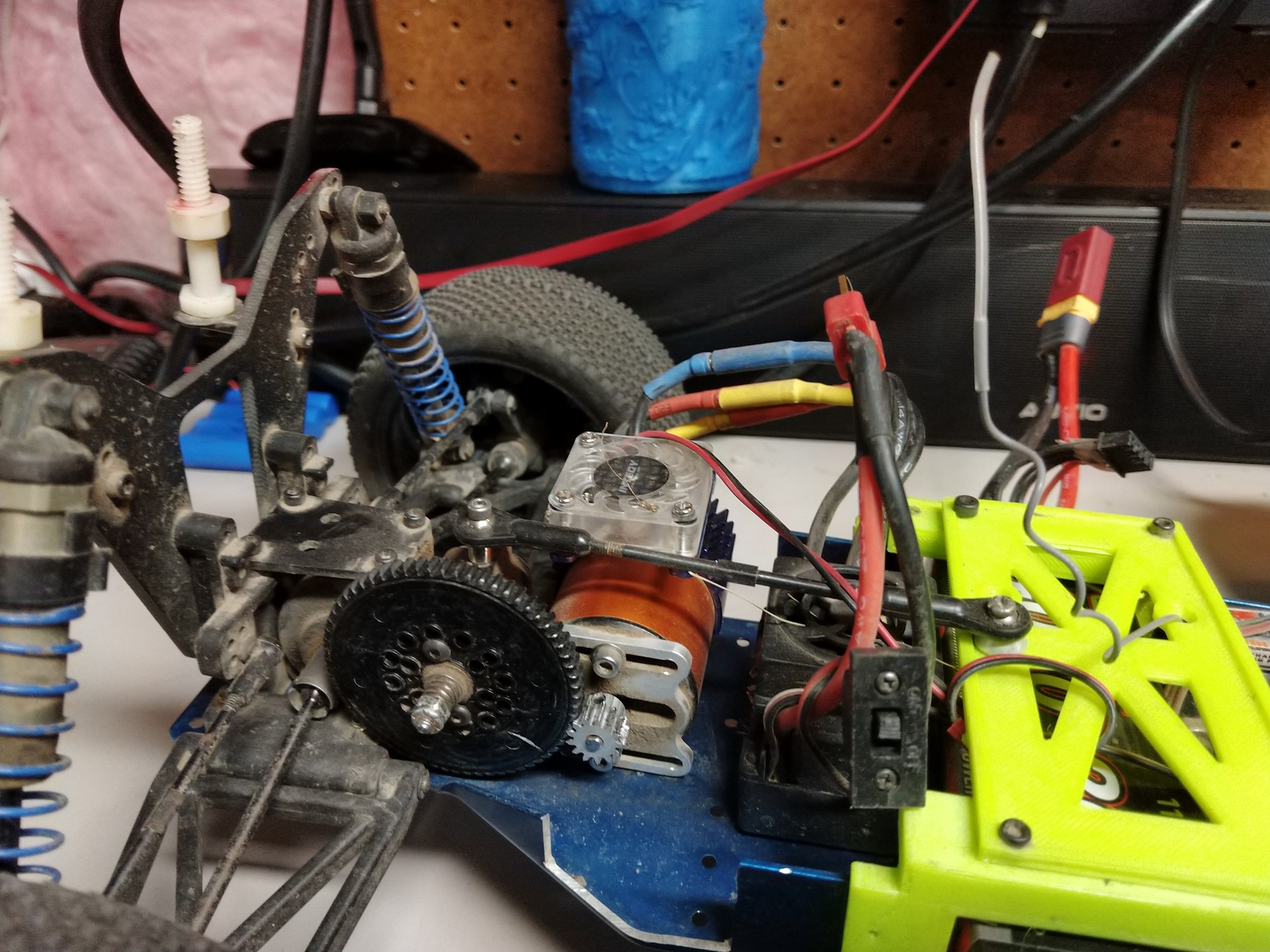

yup motor plate is cheap and easy .and as far as setup you can either run a shorty lipo pack , or do some custom 3d printing and use full size packs lol. here is one of my e converted gts

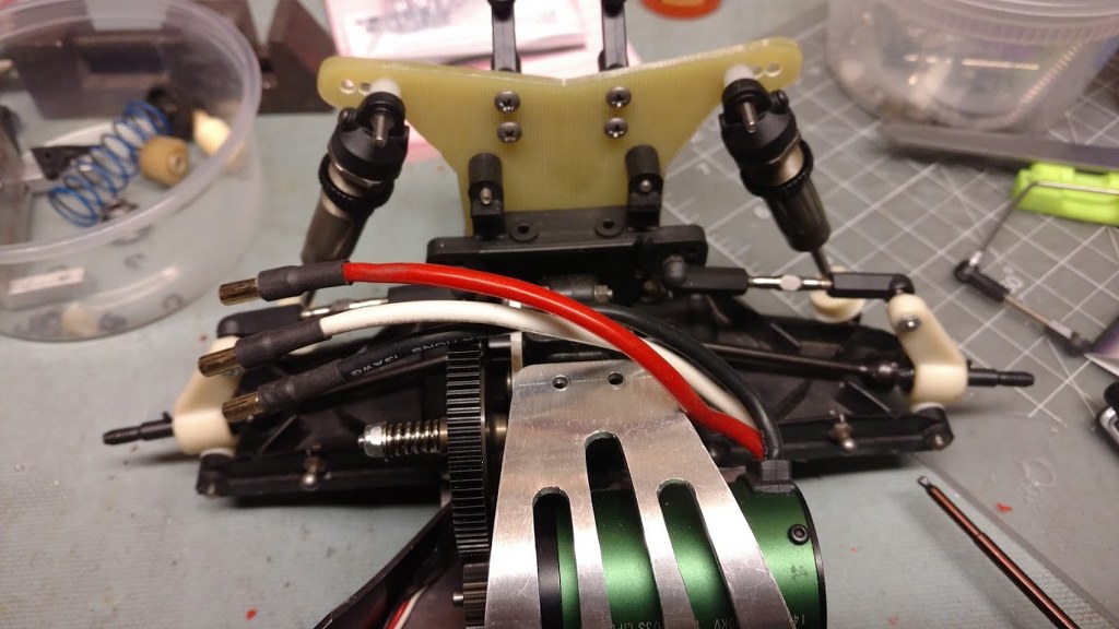

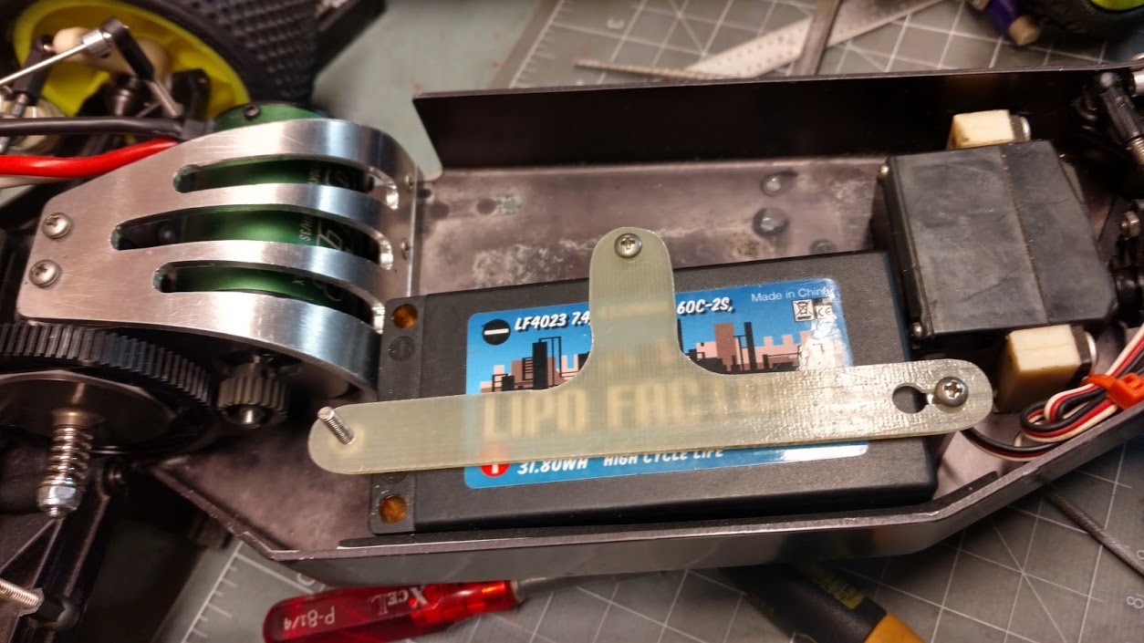

Loved the way this conversion looks with use of the b5m waterfall mount integrated into the battery strap.
https://www.rc10talk.com/download/file.php?id=111080&mode=view
Thinking of doing the same on mine.

I like he clean look but it seems to take up some extra space. But, I wondered about chassis bracing while looking at the motor mount.Souptheword wrote: ↑Wed Apr 22, 2020 2:39 pm Loved the way this conversion looks with use of the b5m waterfall mount integrated into the battery strap.

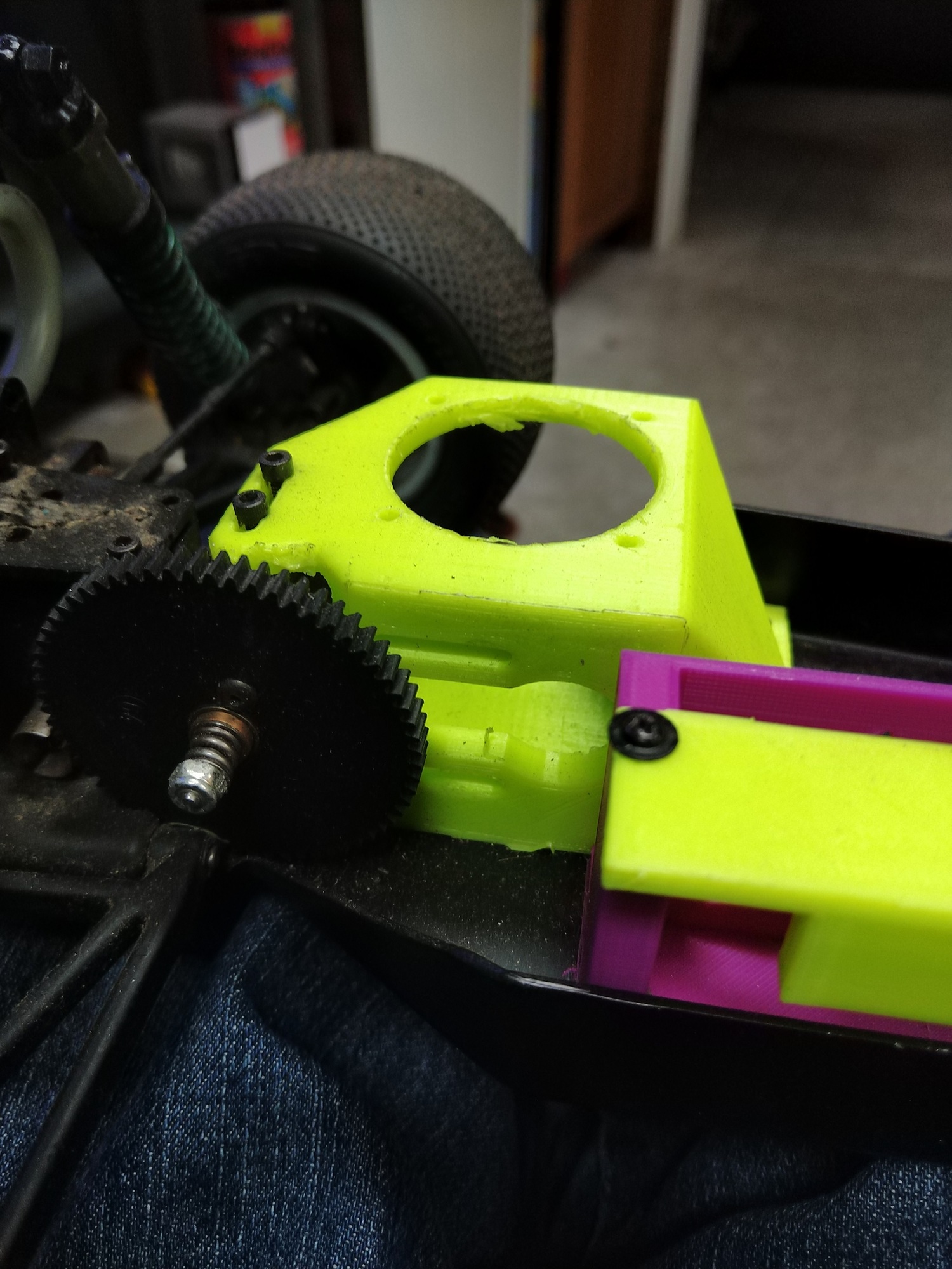

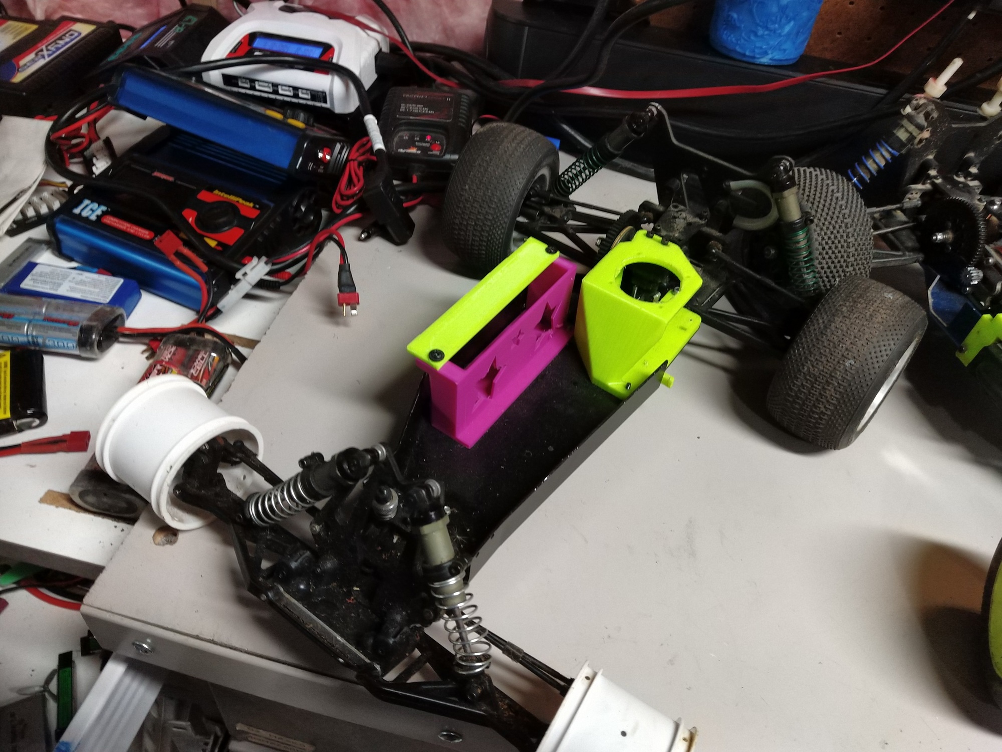

this design fixes the flex /brace problems with the black pans . but it needs to be printed in a high temp plastic and even then if your. motor gets to hot you risk warping . its up on thingiverse . would love to have one made on a cnc out of aluminum
