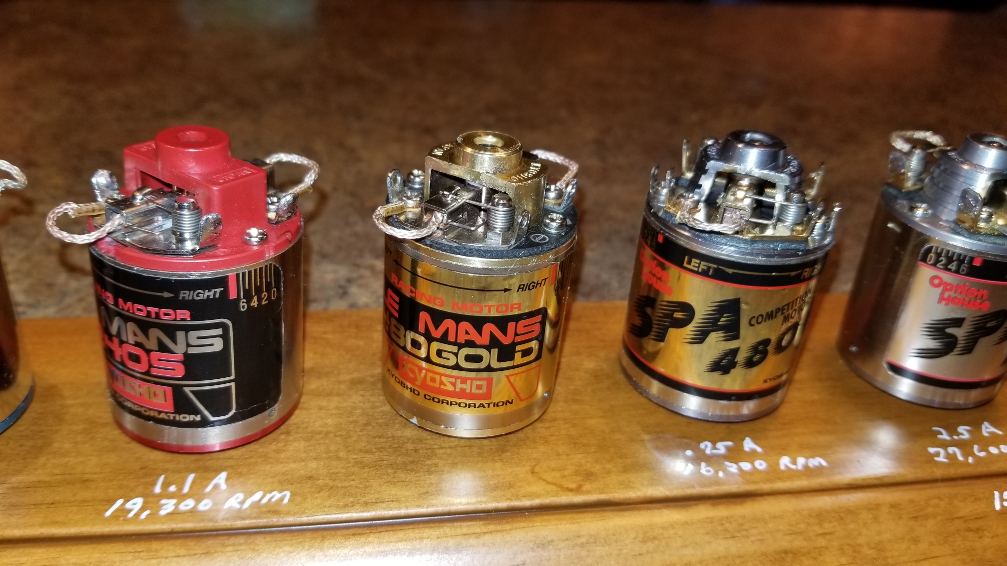

Finally got the 480 gold done
Hopin to score a 240sb in a motor lot on ebay in a day or 2.....HUGE money tho☹

Got another 240s to put in Turbo Optima rere if i ever get it built. Motor on left is the one i just got and restored....sum bich turns 28500rpm....2k more than the other. Ignore #'s under motors....notice decal difference....right is mci....left is decal that comes with TO rere

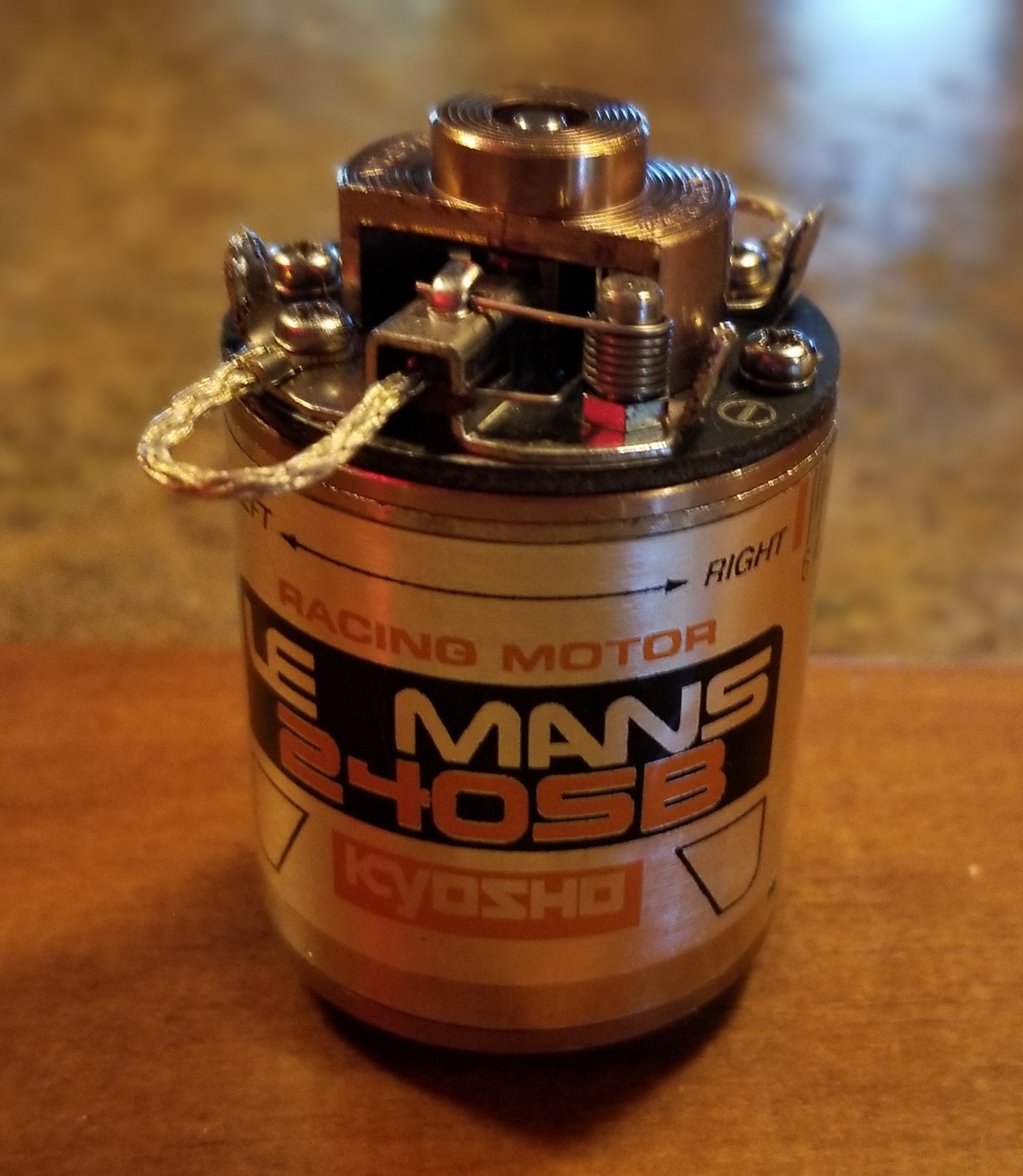

This ended up being a real nice example but i paid a shitload for it....usual restoration stuff...cut comm, bearings, brushes and decal. It doesnt turn what the original publication claims of 29 to 30k...i am only getn 26,500rpm. Its an 18 double and armature is correct. It sounds just like a 240s when running. I ordered some ceramic bearings for it to try and squeeze a little more. But its a cool motor and i dig it
