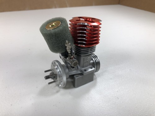

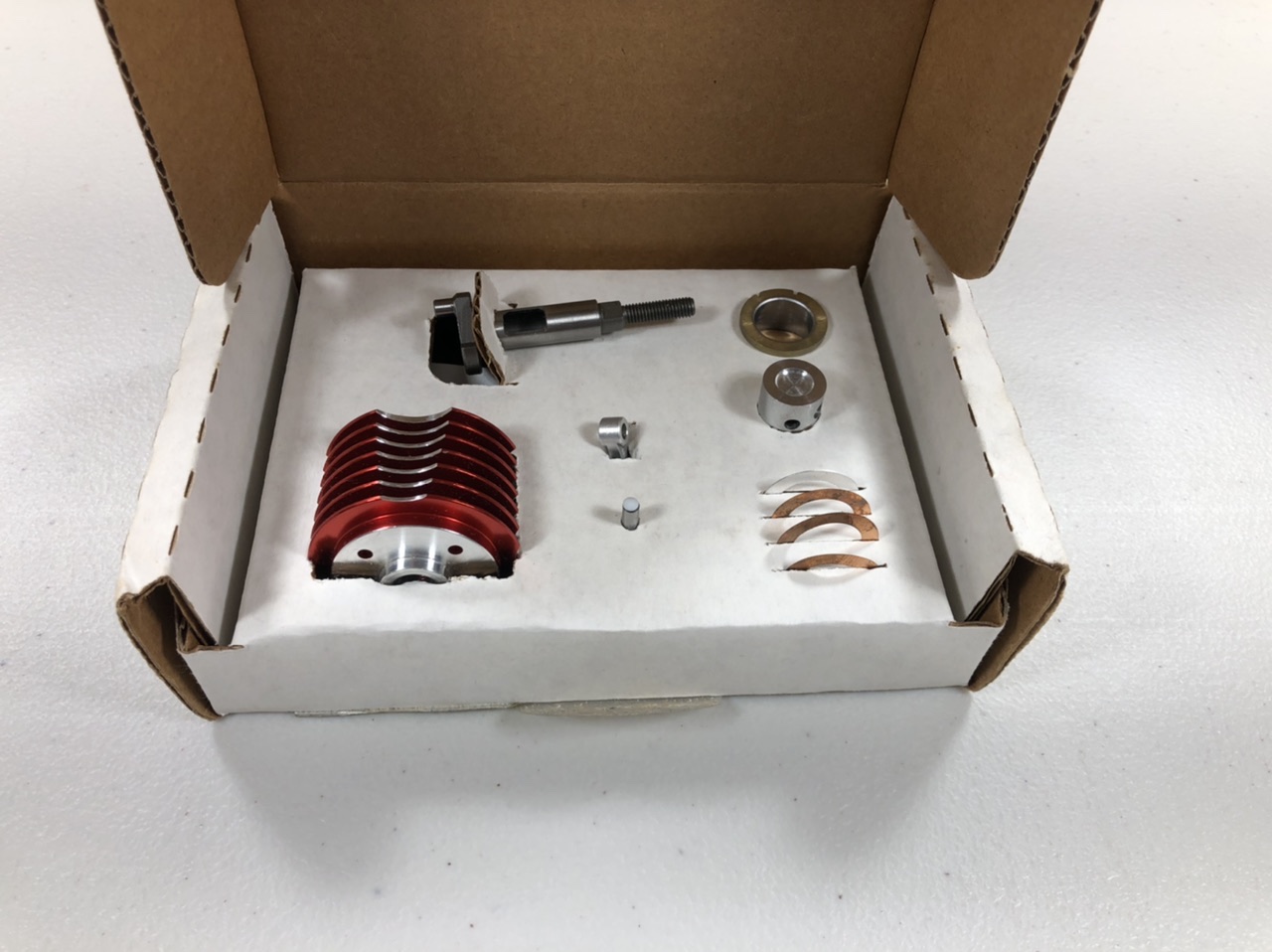

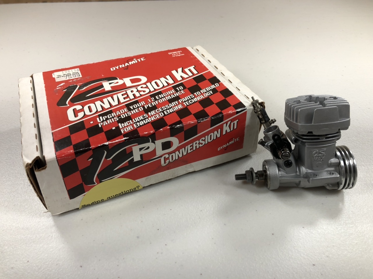

First off. Big thanks to Alex, LoboNYC for parting with one of his super cool Paris dish O.S. conversion kits. Always hooking me up!!!

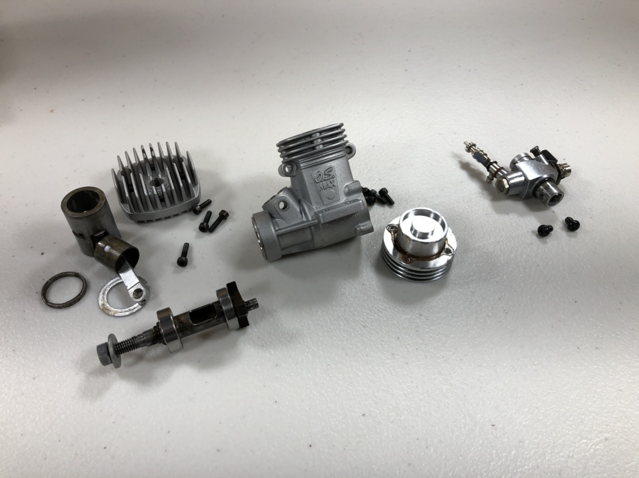

Started of with a good little CZ11, and the donated conversion kit
Everything you need to rebuild an engine minus bearings. I replaced the front bearing with a dynamite super seal. Forgot to stick it in the picture.

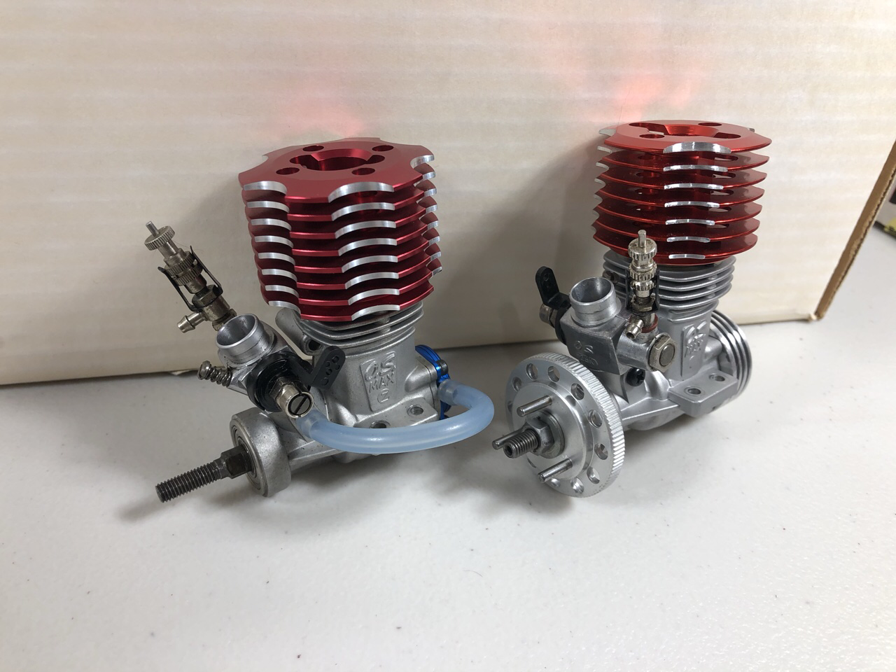

Everything came apart decent. And cleaned up decent enough. Wish I would’ve had some pipe cleaners. But in reality to sit in a box or on a chassis someday it came out clean enough.

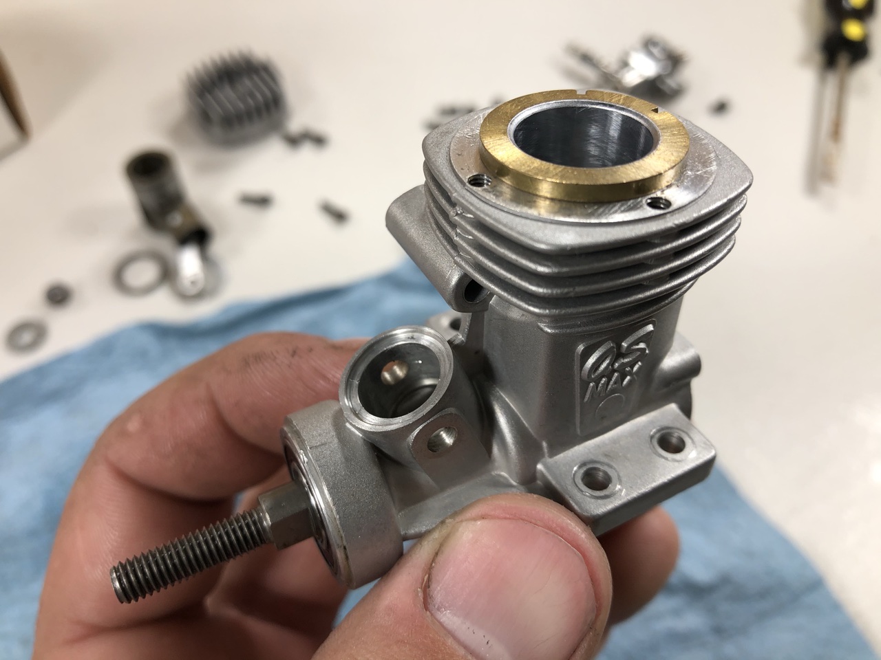

Check out the cross hatch on the cyl liner. Never noticed that before.
I had a lightweight 3 shoe Duratrax flywheel so it went in for the heck of it. A big part of what I enjoy about nitro stadium trucks is how cool the engines themselves look. I need to figure out a way to display all of my engines. I enjoy looking at a clean engine as much as a complete car sometimes.

Holy smokes Todd...that engine looks very nice all by itself!
Super glad you put that kit to good use...
That back plate and flywheel are a sweet touch to the engine.
Eye Candy all the way!!!

That back plate on the engine is the icing on the cake in my opinion. Two thumbs up.

Wow, I didn't know such a kit existed. Sometime in the next year I plan on rebuilding/modding a .12 CZ-R engine, and have been collecting parts. I've been trying to find a red heatsink such as the one that came in that kit. I bought a NIB one I thought might fit but it arrived damaged.
Anyway, it came out looking great!

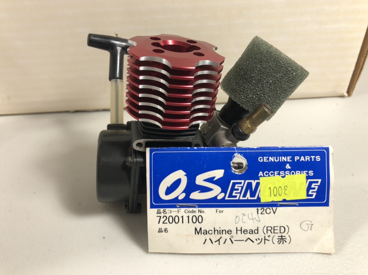

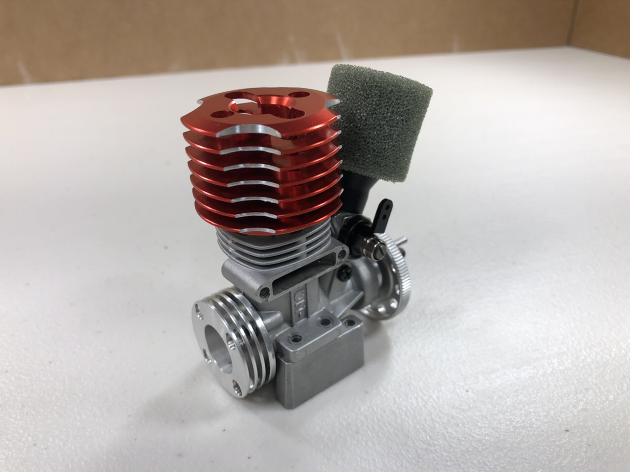

Been meaning to get to this but kept forgetting when I wasn’t busy.Lowgear wrote: ↑Thu Jan 07, 2021 2:30 am Wow, I didn't know such a kit existed. Sometime in the next year I plan on rebuilding/modding a .12 CZ-R engine, and have been collecting parts. I've been trying to find a red heatsink such as the one that came in that kit. I bought a NIB one I thought might fit but it arrived damaged.Anyway, it came out looking great!
Labeled as a CV part but looks the same as a CZ in the combustion part. The CV bolt pattern is rotated 45° From a CZ but it still has plenty of clearance for a filter. Dropped it on a spare CZ for demonstration.
