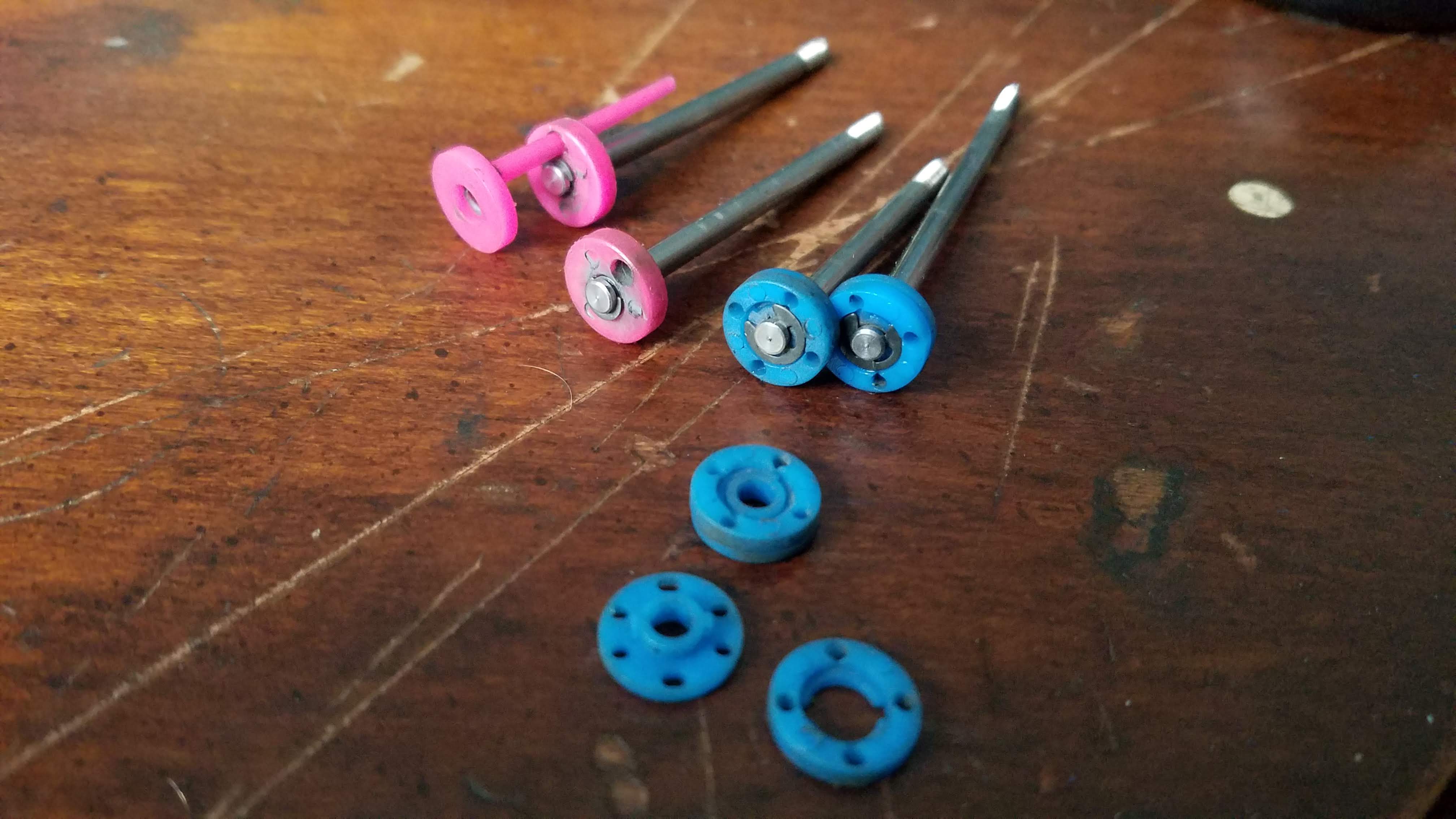

Ok, Thanks guys. I found these in a few shocks. Obviously aftermarket. Anyone know what these are?
Posts: 3536
Has thanked: 269 times
Been thanked: 2094 times
Re: Shocks, pistons, and oil. Oh my.
I don't know, but I have a set of the pink ones.
Posts: 12336
Been thanked: 3918 times
Looks like rpm two stage shock pistons.
Faux4x4
Posts: 34
Joined: Fri Jun 12, 2020 3:33 am
Has thanked: 5 times
Post by Faux4x4 »
GoMachV wrote: Wed Mar 03, 2021 3:29 pm Looks like rpm two stage shock pistons.
The blue ones look like RPM but the pink ones look different. Is the pin tapered, and does it fully seat when the shock compresses?
Posts: 3536
Faux4x4 wrote: Wed Mar 03, 2021 4:47 pm
Yes, and yes.
jwscab
Posts: 6580
Location: Chalfont, PA
Been thanked: 505 times
Post by jwscab »
Jump jets! Those were known as jump jets.
Posts: 12336
Yup, jump jets. I didn’t even notice those pink ones.
jwscab
Posts: 6580
Post by jwscab »
Nah, it's cool. Ya gotta throw me a bone once in a while and let me get one right :lol: :lol: :mrgreen: 8)
K-TOWN-KITT

K-TOWN-KITT
Posts: 199
Joined: Wed Mar 27, 2013 9:26 pm
Location: Buffalo, NY
Post by K-TOWN-KITT »
I get the idea in theory just not in the application. I would think it would get jammed, float around, or break in the shock. Got to love the early ideas and mods. Are the RPM pistons worth trying out? Better for a buggy or truck.
