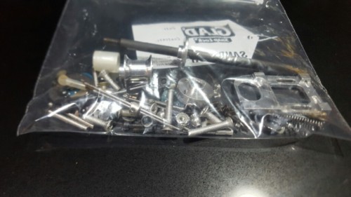

Ì received this 12L the other day from LurkingCAT which was in pretty good shape for its age. It will be a tennis court runner since that's about the only place that I'll be able to use it. The surface of the moon is smoother than Astralian parking lots and roads.
I will likely do an 80's themed stock car complete with vintage radio and fiberglass roll over antenna to compliment the vintage theme. I'm actually really looking forward to it......
Here's how I received it.

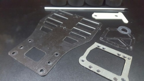

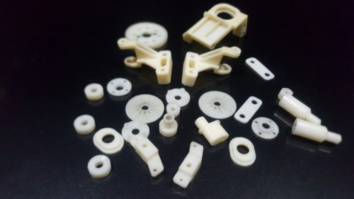

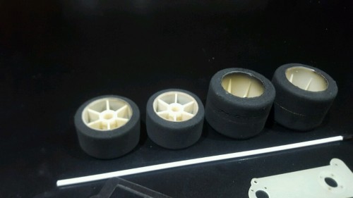

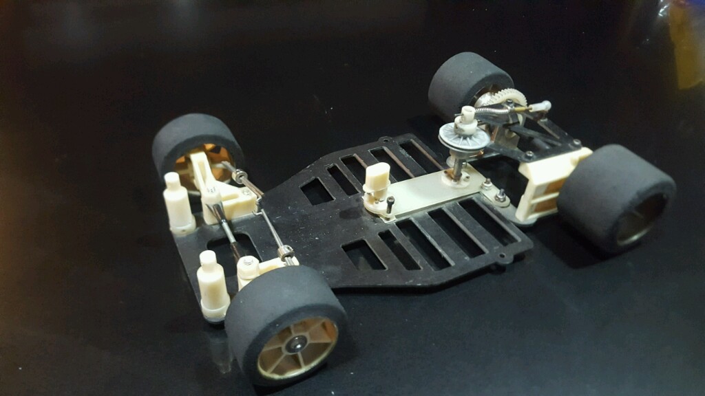

I couldn't help myself
Nearly ready for reassembly already

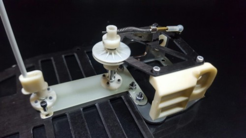

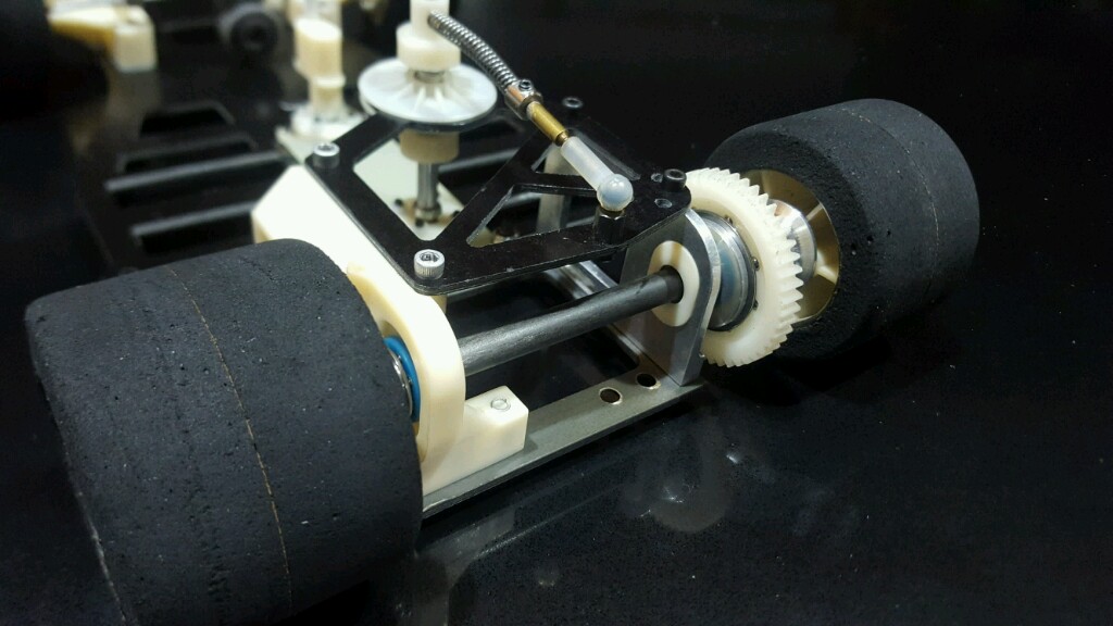

Assembly has begun !!!

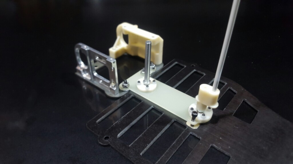

So far so good and coming together nicely. The little tweak screw plate was interesting to make out of a tin can but a great idea, wonder why AE never supplied one ?

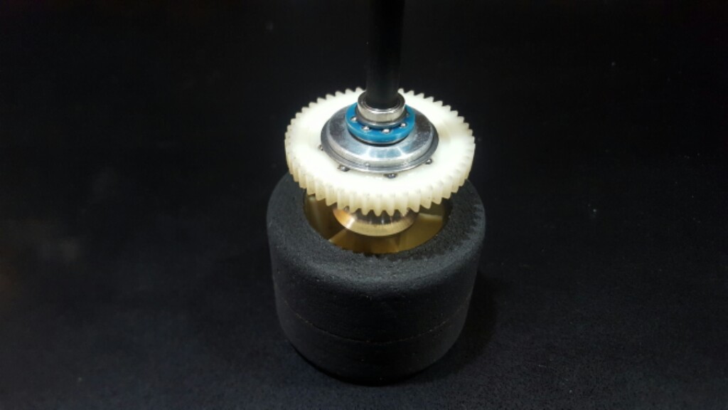

Shock spring thing and damper washers all assembled, a tiny tiny amount of the diff grease on the washers and the whole pod moves smooth as butter.
Diff put together, I like the original idea of thrust bearings on the axle, saves side loading the bearings. Just like new.
Rear axle installed
Rear axle installed

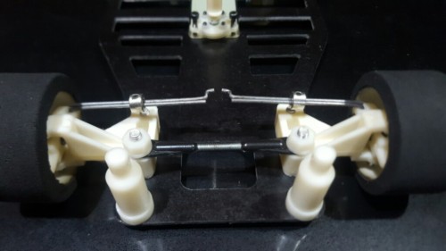

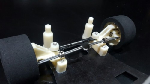

Not that there's much exciting about the front end of a 12L but here it is assembled on the car..... complete with high performance spring steel turnbuckles

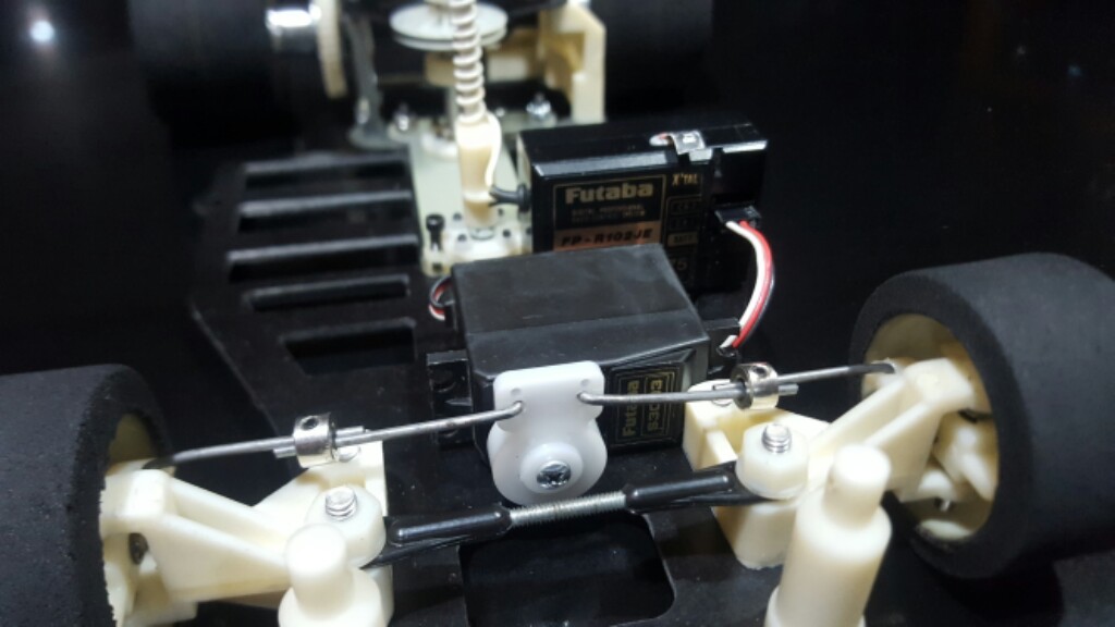

Servo and receiver in place, tested and all working ok..... I shortened the servo wire a fair bit but may shorten it even furthet once I work out esc placement.
