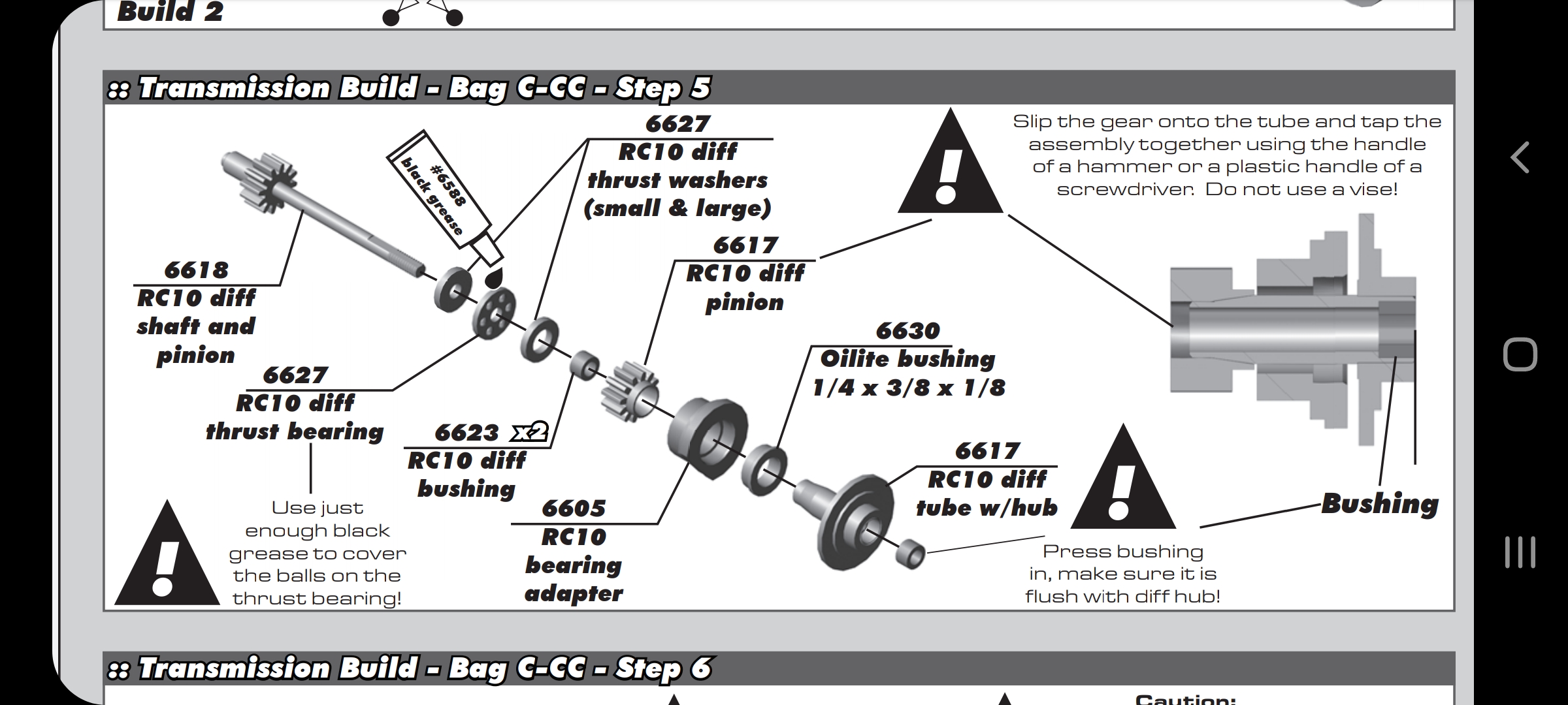

I haven't rebuilt a 6-gear in three decades, so while going through my old one "by the book" I noticed the manual does not call for any lubrication on the diff thrust bearing or washers. Is that correct?? Surely it's an omission from the manual...I've never heard of such sorcery.

https://img2.associatedelectrics.com/pdf/cars_and_trucks/RC10_Classic/RC10_Classic_Kit/manual_RC10Classic_2013.pdf

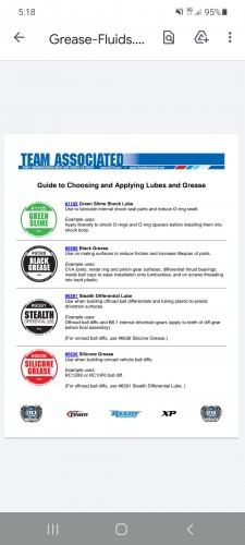

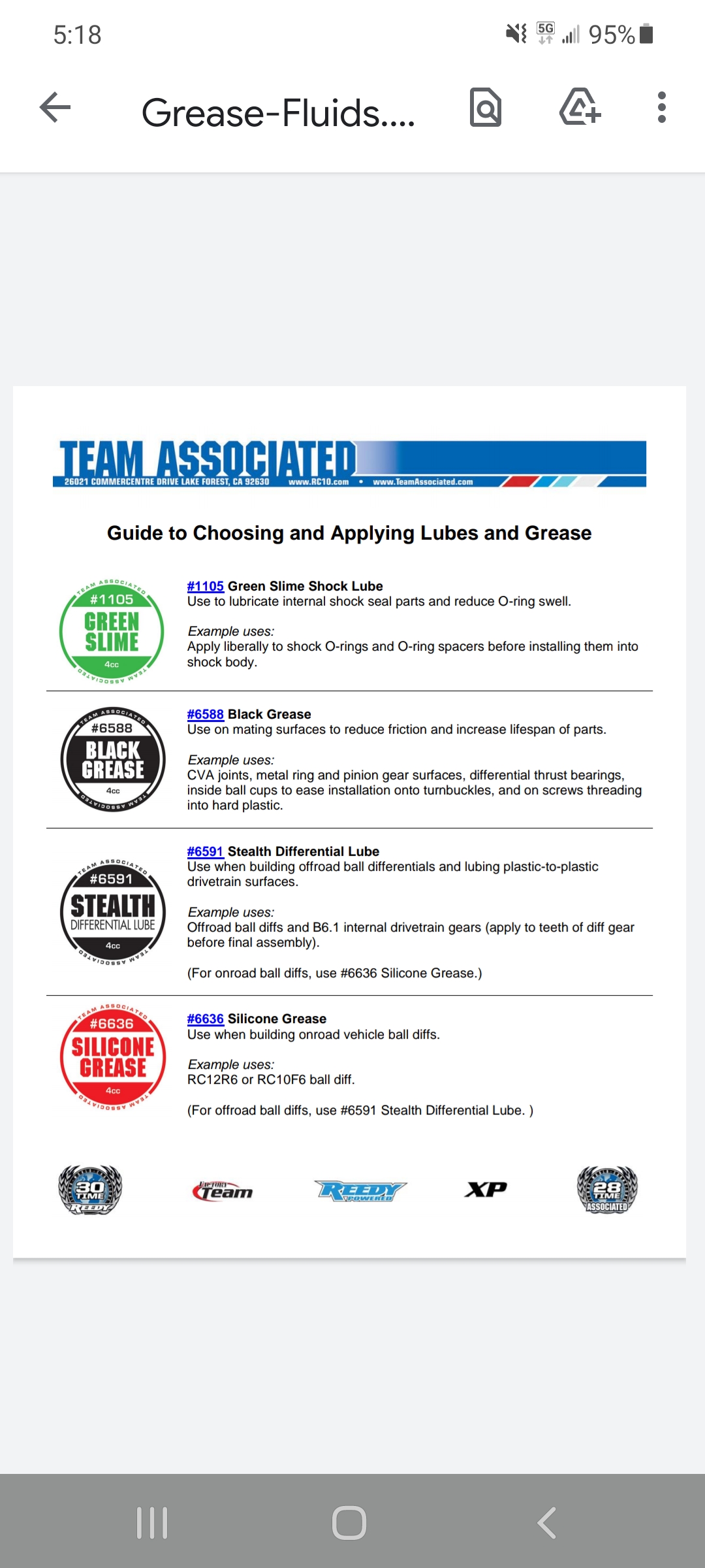

For the thrust bearing, I use whatever general purpose grease I have handy, usually something for a fishing reel.
For the diff, whatever ball diff grease I have. The last couple I did, I used Tamiya ball diff grease on.

Interesting that the re-re manual says to lube it while the original does not. The original manual also indicates grease should be used on the inner hub of the spur gear, I see that is omitted from the re-re version.
I’m tempted to believe the guys who designed the car as opposed to whoever wrote the new manual.

The thrust bearing should get a moly grease. The diff balls should have a silicone based lubricant. No matter the brand of diff. Never run them dry.

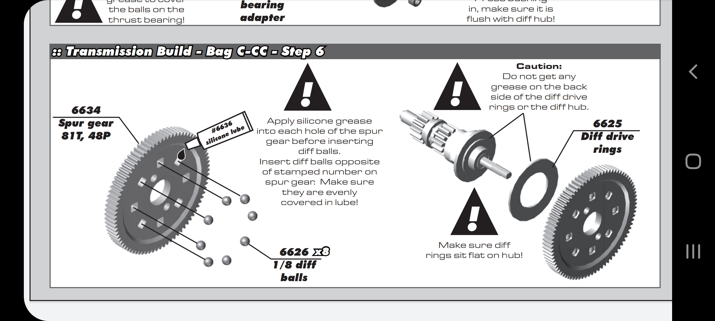

Just for clarity, that's step 74 from the original manual and it is referring to the spur gear balls, not the diff thrust bearing balls.radioactivity wrote: ↑Wed Jul 14, 2021 6:07 pm flatspunout
rc10resto found an excerpt from the original manual.
"The following copied from AE RC10 Classic Manual:
VariLok Diff Adjustment Tips:
Be sure to only use Associated diff lube #6636, and apply a small
amount on both sides of the diff balls. Do not use this diff grease
anywhere else on the vehicle! It is not intended as a lubricant (Use only
Associated diff lube as it has special additives to ensure the balls roll
instead of slide)."
I believe that the 6636 lube has some "grit" to it that makes it quite different than other lubes.
Chuck

As pointed out above the og manual doesn't state that you need to put any grease on the thrust. I never used any bitd , nor did any racers I know. It's also worth noting that the Losi hydradrive used a similar thrust that was exposed, and it too did not require grease.

I ran my 6 gears thrust dry back in the day simply from not knowing better. These days I definitely would. Excess will fling off anyway so just a super light coating is all it needs.
As a side note, our power clutch thrust called for grease.
