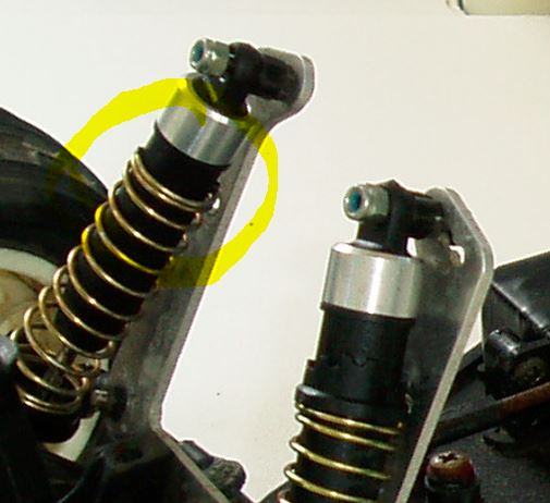

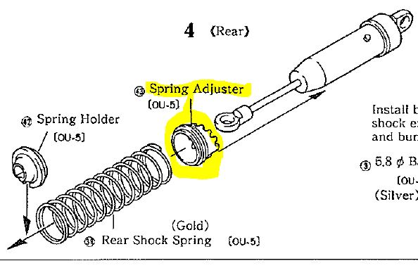

The servo works and the motor runs. Not sure of the motor's brand since it's missing the can label and there are no markings of any kind on the armature. It's definitely a modified motor (adjustable timing and ball bearings) and it's a double wind but the actual wind count is a mystery.
I've finished cleaning the wheels and all the remaining plastic parts. The wheels sat in a acetone vapor bath overnight to loosen the CA glue and bits of old tires (probably remnants of the original kit tires since the AE ones weren't glued). Anyway, apparently I'm missing one of the shock spring preload adjusters. I've looked everywhere for it then went back to my photos and found that it was in fact missing when the truck arrived yesterday.
I've read that it's routine practice to slice off the adjuster's pins that project from the plastic shock body and replace it with ordinary preload clips but I'd very much prefer to keep the truck as original as possible. If anyone has an adjuster that they would consider parting with, please send me a PM?
Posts: 12336
Been thanked: 3917 times
Re: Outlaw Ultima truck purchase – my very first ST
I’m sure I have one kicking around. I’ll shoot you a message if I find one

I have been misinformed - this is the first set of vintage Kyosho plastic shocks for me. I recalled reading somewhere that they're not rebuildable so I guessed that the o-rings were co-molded within the shock body. Maybe that discussion was about a different Kyosho plastic shock.
Anyway, having a close look at the cross-section in the manual, it does look like they are top-loaded. Thanks for setting us straight on that.

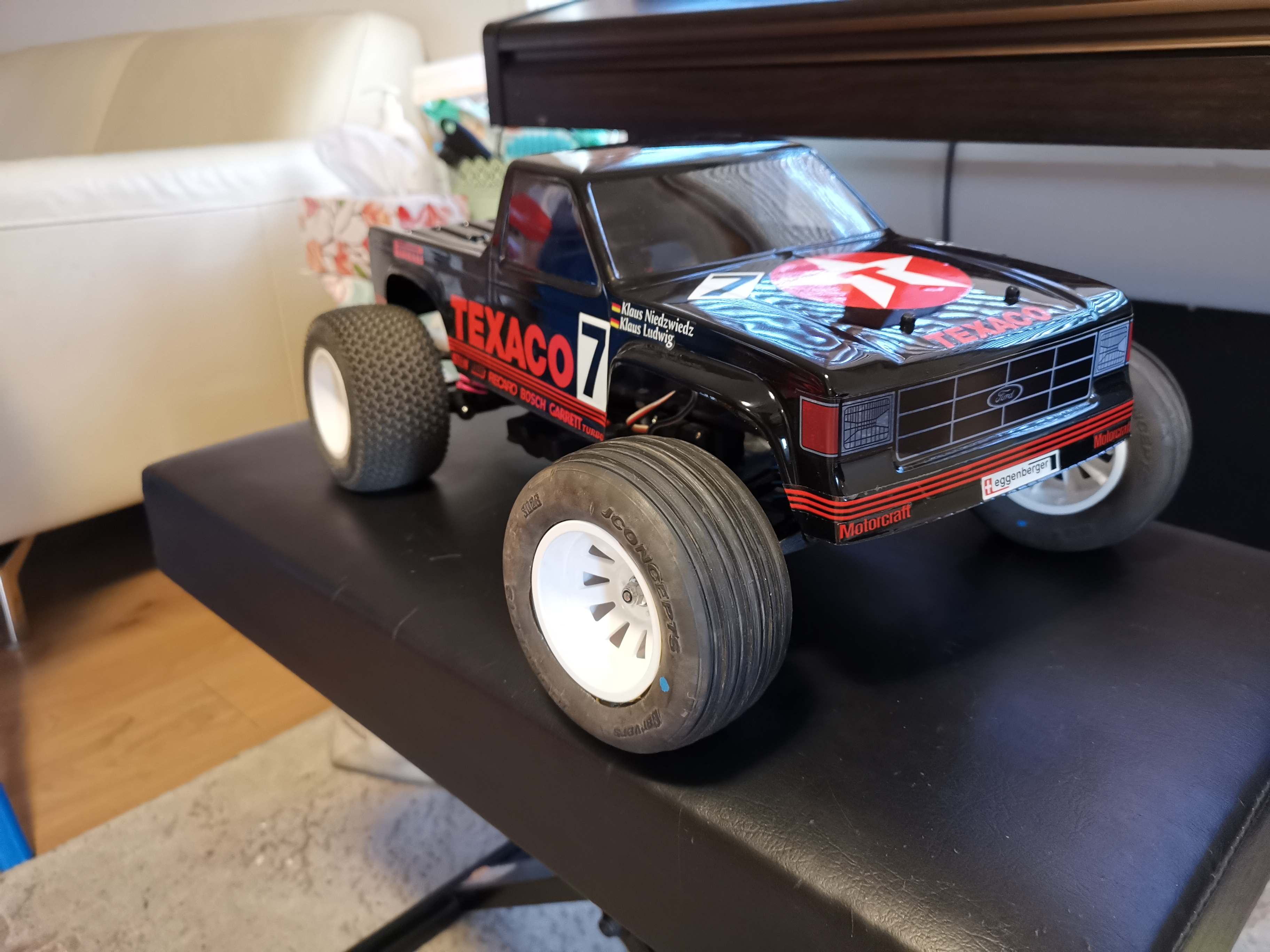

Great to see another Outlaw truck being worked on! I've done some work on mine with a bit more to come
I built it along side my rere Ultima that was fitted to an ultima ii chassis
My outlaw is a bit of a mish mash, i fitted a triumph belt drive gearbox to it, some rtr Losi shocks, tamiya Blitzer front knuckles so i could fit blitzer rims that i already had mounted with tyres. I've always love the Texaco Sierras from the 80's so i did the body up like that
I've got a few more things i'll be working on over the next few months, as you say, the kelron chassis has no strength on its own, I'm going to try to use some 90 degree aluminum stock bolted along the chassis to provide strength and a channel for the battery to fit and hopefully then not need the top deck except for a small one at the front to brace the steering posts etc. The other thing i want to do is hex convert the front end using optima hubs/knuckles
XLR8
Posts: 3318
Has thanked: 1684 times
Been thanked: 1180 times
Post by XLR8 »
Your truck looks great Delorean, thanks for posting the pics. Seeing the black paint and Texaco livery reminds me of the Robert Yates’ T-Birds that Davey Allison drove bitd.
My Outlaw won’t look that nice unfortunately as I’m trying to work with the original, well used and abused body and just make it a decent looking runner. I’ve found with these resto projects that if I give in and paint-up a new body, I’m reluctant to get it in the dirt and the vehicle just ends up setting on the shelf. I don’t want that to happen with this one so I will trade some appearance for utility.
Speaking of the body, I have all the breaks and cracks reinforced so it no longer sounds like a crumpled potato chip bag while it’s being handled. It’s very strong and solid now and I just have a few holes to fill and it’s ready for paint. Where would we be today without Shoe Goo, dry wall tape and JB weld?? :D

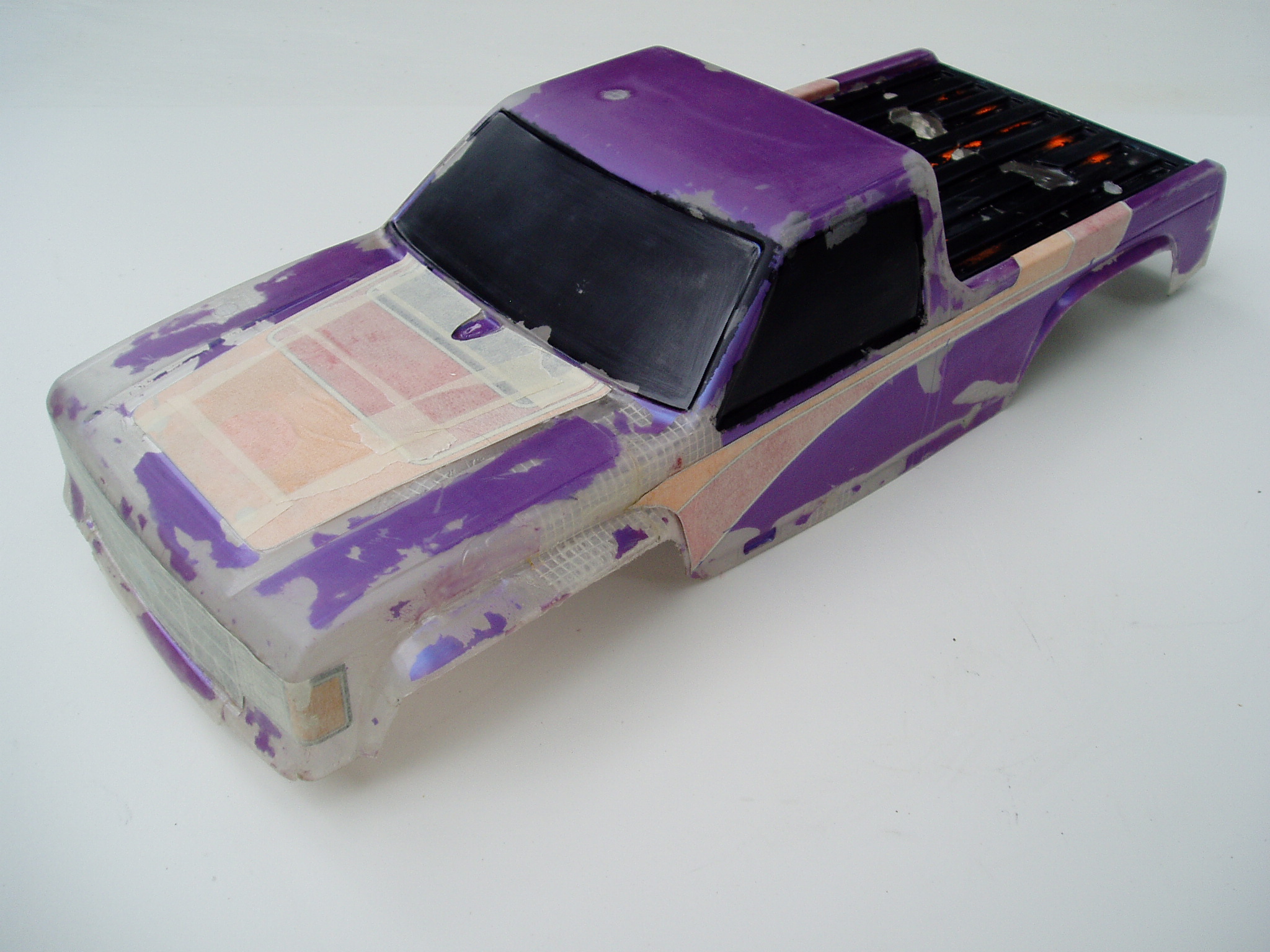

All cleaned-up, patched-up, scuffed-up, taped-up and ready for paint.
Frankenstein's monster truck.
I've wet-sanded the outer surfaces with 600 and the plan is to apply some white polycarbonate paint as a bonding agent, then gray primer and finally, the white and black Krylon (or whatever I have on hand). I'm substituting black for blue on the box-art model.
The original owner trimmed away the two oval shaped mounting recesses for the body posts at the rear of the bed so I've Shoe Goo'd a lexan patch in that area. Looking at the manual, I can see why he thought those areas were to be removed - it could be a little confusing to someone new to the hobby.
It appears to have been painted with pearl purple and I happen to have an ancient bottle of Pactra poly paint in that color.
As it is, with areas of missing paint, it is affecting the colors in stripe decals.
So that the decals look more uniform, I'll apply a few coats of the purple in those areas with missing paint.
Probably not a big deal since this is a beater body but I have the paint so might as well use it.
Anyway, it's raining here again today so the most I can hope for is to apply primer.
I probably should wait for a dryer day before applying the final colors.
