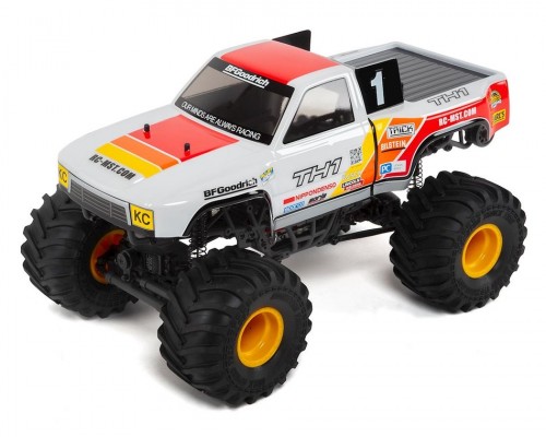

I assume you have seen the (modern) MST Toyota monster truck...but just in case.....its pretty cool but a weird blend.

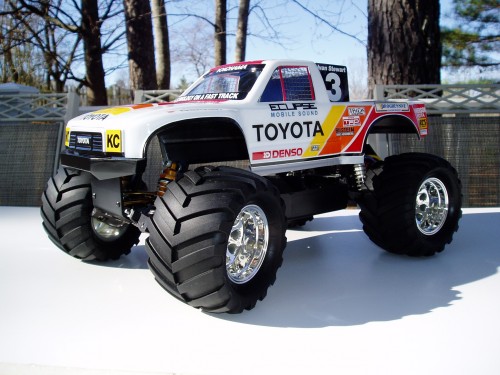

Thanks everyone for commenting. I regret not posting this earlier as it would have saved time and money and I might have gone a different direction. However, I started this quest a few months ago so I’m just posting work that has already been completed.
A while back, I was browsing the TBG and MCI websites; they’re reproducing the Tamiya Monster Racer and Prerunner body and corresponding decals so I order a set. When they arrived, much to my disappointment, it’s clear they’re not 1/10 scale – maybe closer to 1/12 or somewhere in between. Now there’s certainly nothing wrong with 12th scale but I really wanted to keep this build the same scale as the rest of the truck collection. Both models are listed by Tamiya as 1/10 scale and they clearly are not. By the way, I really don’t care for the way Tamiya plays with scale – it’s a bit deceptive.

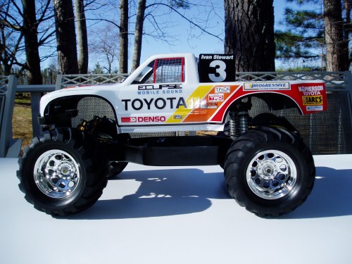

Anyway, I went ahead and painted and stickered the body and mounted it on a shortened RC10 with HPI wheels and Lunch Box tires. I didn’t set out to build a monster truck but I had the wheels and tires so I figured why not. I can always change them later.
The front suspension plate and bumper are scratch made, everything else is standard RC10. The front body mount is incorporated into the bumper. Body pins are only needed in the rear.
Maybe if it had smaller tires, it would look better – I donno.

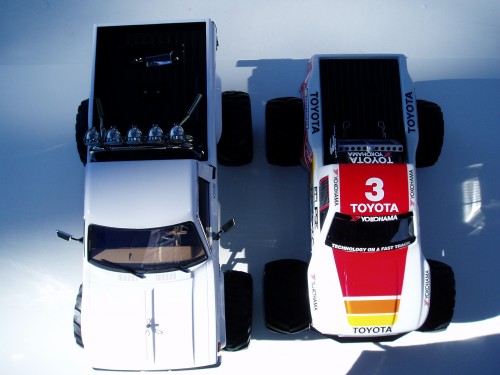

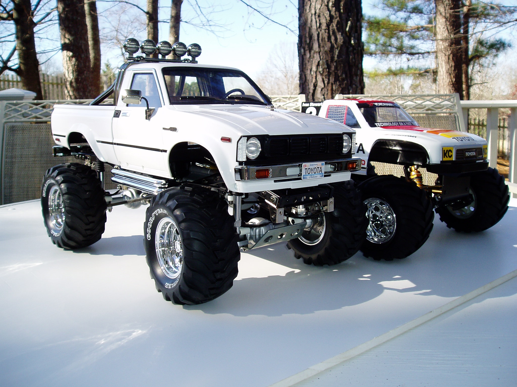

Here’s the truck next to a Bruiser clone which, I believe, is 1/10 scale.

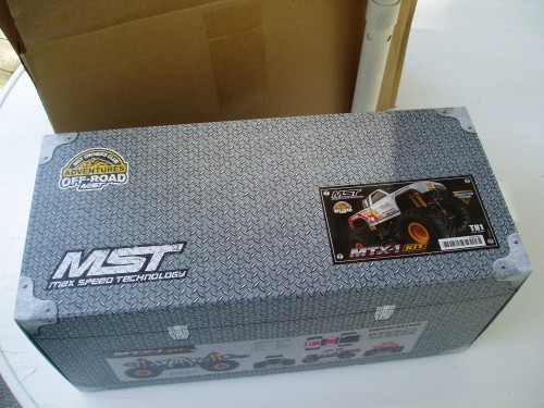

So, MST; there is so much to say about this kit that I’ll want to break this into multiple posts.
There isn’t much info on the web about MST and I found nothing about it posted on this message board. I became aware of the brand from watching Matteo’s videos; he’s built a few MST trail truck kits on his channel and posted running videos for some of their RTR’s. Anyway, I happened upon this MTX-1 kit while browsing Amain hobbies one day. This is the TH-1 kit (Toyota Hilux) but a C10 Chevy look-alike version is available as well and costs a bit less (maybe because it includes fewer decals?). I don’t believe either kit is licensed by Toyota or GM.

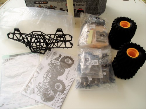

Here’s the contents of the box.
Tires come pre-mounted (not glued). The chassis sides are identical (symmetrical front to back). All materials appear to be very high quality.

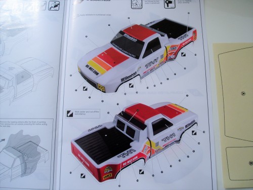

Decals and window masks are also very high quality and are pre-cut. I don’t care for the “TH-1” and “rc-mst.com” logos and QR code but I have a way to deal with them.
As we’ve come to expect from modern RC kits, the build manual is fully illustrated and is well organized.
The separate body finish manual includes color illustrations – I’ve never seen this before with any RC kit.

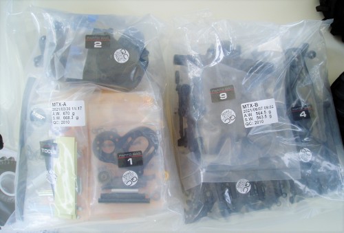

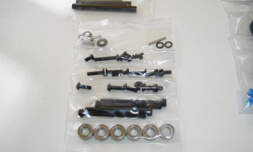

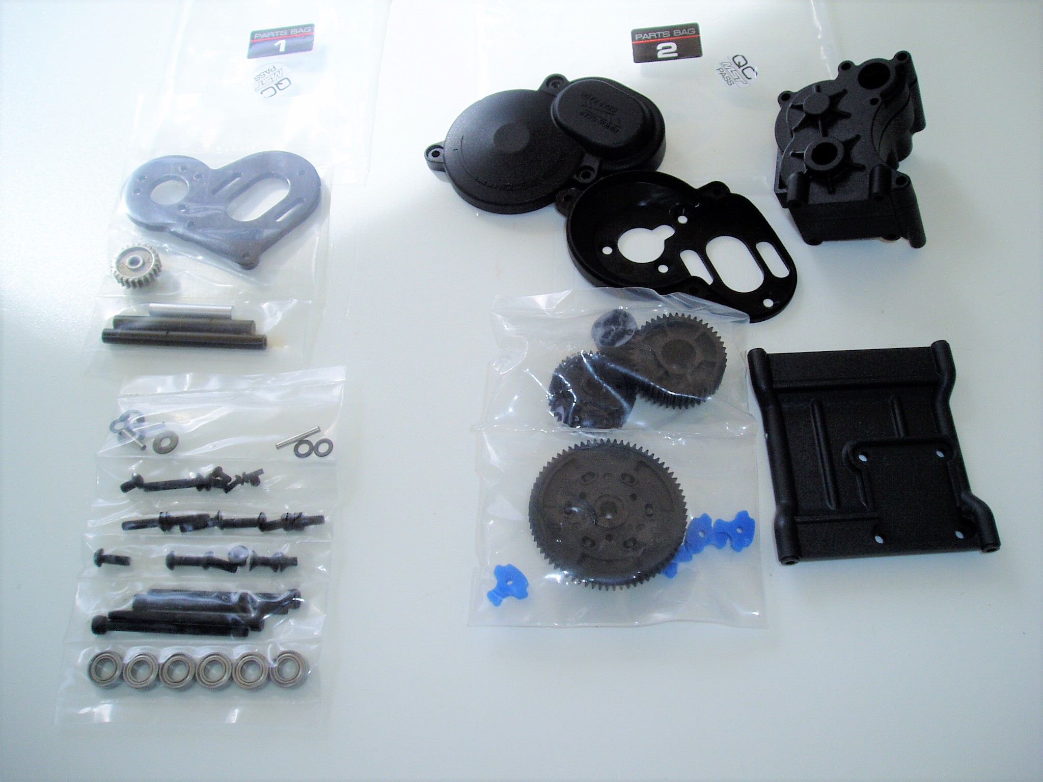

As you would expect, each bag number coincides with a build step in the manual. Most of the larger molded parts have been removed from their sprues so there isn’t a lot to throw away when you’re finished. I really wish all manufacturers would do that.
All hardware needed to complete each step is bagged in this manner so it’s easy to find what you need. Gmade for instance, bags all like screw sizes together so you’re forced to hunt through a pile of bags to find the exact screw you’re after. I watched Matt from the Scale Builder’s Guild assemble the Gmade Buffalo during a live stream and after two plus hours of flipping through endless bags of screws, he was getting so angry that I fully expected him to drop-kick the thing. Clearly, he was not having fun. However, for those of us watching the stream, it was hilarious. :lol:
The kit doesn’t include a slipper clutch but it uses a cushion system for the spur gear. I recognize this system; old motorcycles use a similar system in the rear wheel sprocket to cushion drive line shock during gear changes.
Transmission gears are plastic while all axle gears are metal. The receiver box also uses that blue silicone rubber material for its seals. If assembled correctly, the receiver box should be completely water proof.
