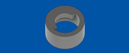

Looks like you've lost part of the bearing seat for the sprocket output , the same thing happened on one of my gearboxes , I designed a fix pictured below , happy to share the STL .
Can't wait to see another Samurai back on the road :D

Dadio wrote: Sat Dec 11, 2021 11:43 am Looks like you've lost part of the bearing seat for the sprocket output , the same thing happened on one of my gearboxes , I designed a fix pictured below , happy to share the STL .
Well, I guess this will be helpful :-)
