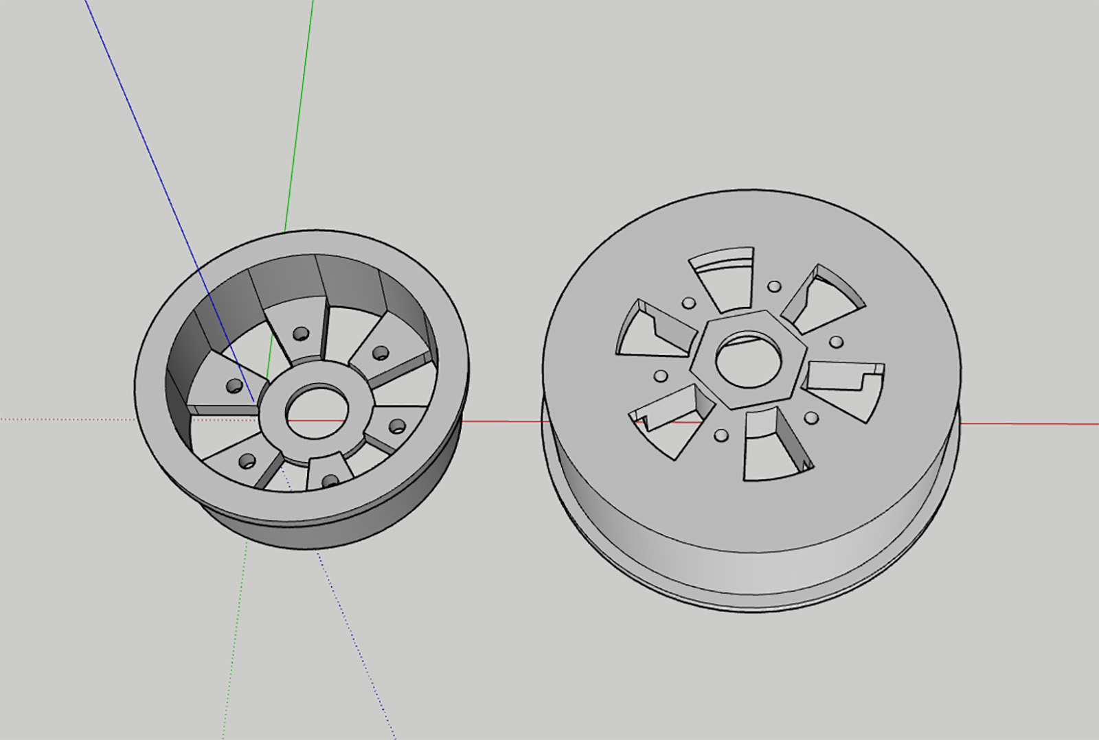

Got into the wheel creation for awhile, and I have to say that I love the design that eventually came from just goofing around, but ultimately, I am having major printing issues. :( The only color filament I have that would work is some "silver" ABS that I have used successfully in the past, but it has been awhile since I have messed with ABS (and ABS settings) and this filament has been sitting for just as long (in a sealed 5 gallon bucket with a passive mini dehumidifier in it). I am close to getting a good initial layer down, but after a few layers, it turns to hot garbage real quick. I have taken some wholesale changes at slicer settings, but nothing is really changing with the prints. I will stick the filament in a real dehydrator overnight and see if it is just a moisture thing. If not, I may need to wait on some new filament.
