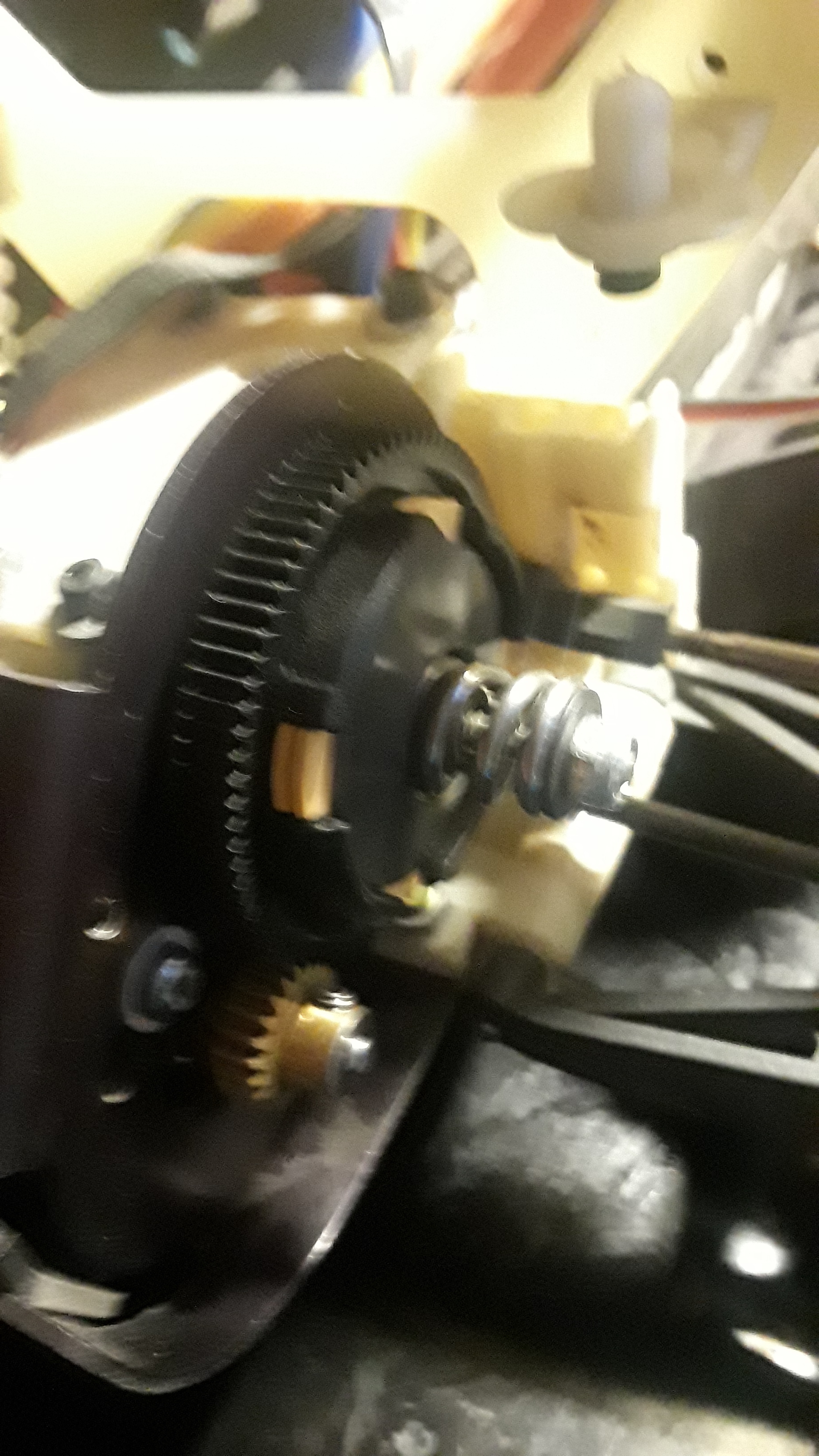

Those are actually vintage MIP CVDS. I remembered having them in the 90's and they were about $20 more than their original price on Ebay in mint condition but since I was already familiar with them I just bit the bullet. Also, got lucky today and checked the ole grandpa RC shop 30 minutes outa town and they actually had a B4 VTS left in stock and some 2.2" street tires at half price clearance so big score today. I installed the VTS and it's smooth as silk. Gonna go into my RC10GTE project that's in the mail.
Needless to say I've conquered the VTS issue. I know to put it into the GT I'll need to shave off a bit of the B4 top shaft at the back end.

You shouldn't need to shave anything to fit a VTS slipper in a GT

Yeah realized I needed to add small spacers on each side to prevent side to side movement.RC10th wrote: ↑Sun Nov 21, 2021 12:58 am You shouldn't need to shave anything to fit a VTS slipper in a GT

I had Bezerk Rc turn down the Mip b4 shaft in 2015. It bolted straight to the re re worlds stealth

I just saw that I never responded. It took a while to actually take things apart and hook it up.
The short answer is that it return slipper function to a vintage stealth. I would say eliminates the need for a b4 top shaft upgrade on a mild setup.
I put this in my older t2 runner that I had not upgraded to the AVID triad like all my other runners. I was running the stock rulon pad that was likely original to the truck. I had the older pad fully locked down just to get it to run. Any amount of slack in the spring was too much.
I installed the new pad in accordance to the directions and it worked. It was a very tight install and I had to center it, tighten the slipper nut all the way down for it to seat in then back off the slipper nut.
I could run it in a very loose if I wanted to. That was something I simply couldn't do before. The old slipper bad was binary on or off. I settled on tightened it down to the point where I could no longer do wheelie flips.
The new pad it pretty darn thick compared to the older pads and I think that helps with adjustment. I am certain that after so many years of being flattened that the stock slipper spring is no longer what it should be.
This was in a rc10t2 with stock size wheels running a 13t brushed motor that is geared way down. Crawler esc with forward/reverse and no break. I run mostly on grass and concrete. The slipper doesn't do much at all on the concrete, the tires break away before the slipper starts. On the grass the difference is noticeable as it reduces the height of wheelies.
It's not nearly as nice as my b4 topshaft/AVID triad slipper upgrade, but it doesn't need to be. It's really reduced the wear I was getting on my spur gears and that's enough for me. I'm not racing so I haven't noticed a performance difference.
I would say that in addition to selling the pad kidagain should try and source a slipper spring as well.
