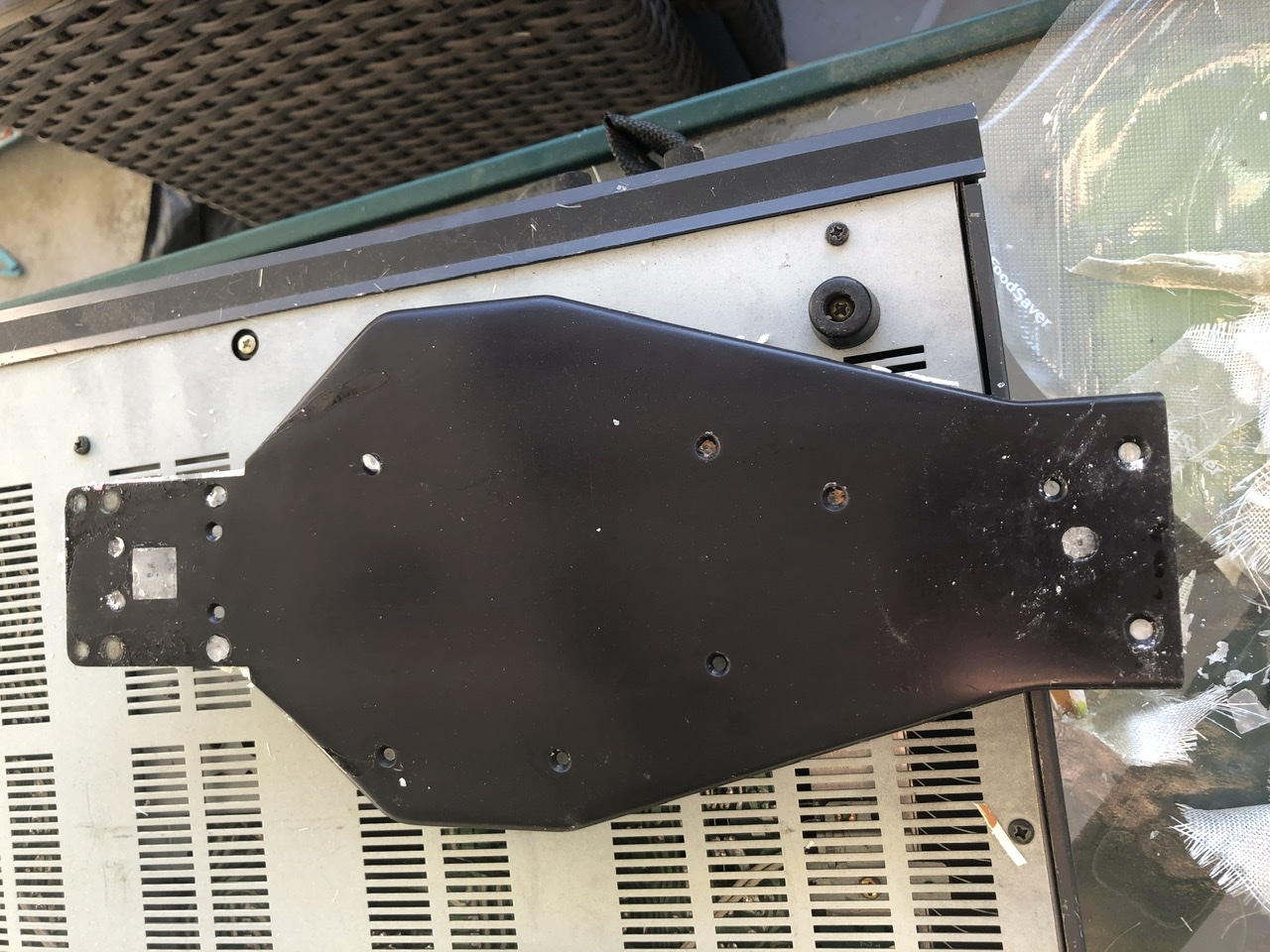

So one of the projects I have wanted to try is making a carbon fiber chassis. This will have 2 steps: making a mold then making the part.
I had in the past tried creating a 'buck' for molding. I simply lack the skill and workspace to make an accurate enough piece.

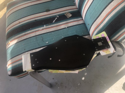

I am going to make a cast mold directly from a chassis. I bought a very good condition t2 tub as my base. The t2 tub has an angled bottom and doesn't have many acute curves. I think that this will help when I actually cast a part.
For my prep I cleaned the chassis with rubbing alcohol. Then applied tape behind each screw hole. I then made flanges from paper along each edge. After the flanges were attached I applied melted paraffin wax to every hole and crevice. My goal is to eliminate any place where resin can go and get stuck. I had a heck of a time in the little area where the rear bulkhead attaches to the chassis.

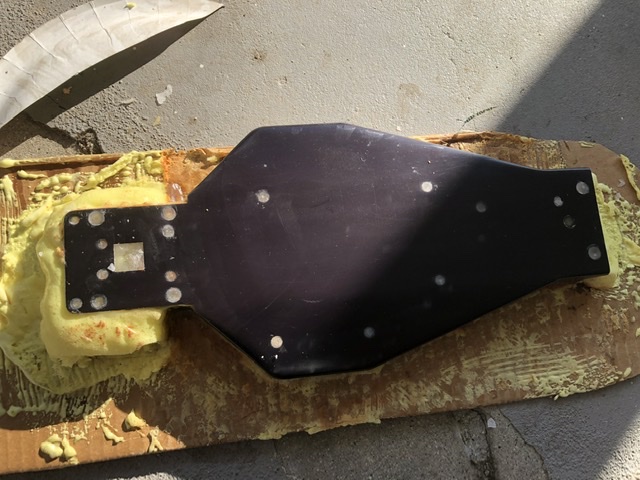

I looked like this at that point I then applied a parafilm epoxy mold release. This prevents the resin from adhering to the part I am molding. Although this is for epoxy I have tested this with Fiberglass resin. I decided to use a polyester resin designed for fiberglass. I am using a combination of fiberglass cloth and chopped mat. I had made some initial molds out of fiberglass cloth and wasn't able to get them thick enough. I purchased fiberglass chopped mat to make a thicker mold with less layers, but they special binders in chopped mat require using fiberglass resin.

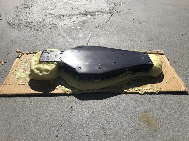

I planned to do a normal setup.
I precut 3 sheets of fiber glass with some slices in it to go around curves and angles.
I prepped the resin for 2 batches. An initial 1oz for a first pass and 2 oz started 5 minutes later for the end of the layup. I added the stated ratio of hardener and stirred for 1 minute on each batch.
used a small paint brush to apply the resin directly to the chassis and added the glass on top. I learned that to avoid air bubbles stipple or blot the resin onto the cloth. This let me push out the air bubbles from underneath the cloth. I then applied the second layer. The cloth wasn't cut well enough and I had to cut relief cuts for the 2nd and third layers. I used about .75 OZ per layer. I think I can expect about the same if I was using epoxy.

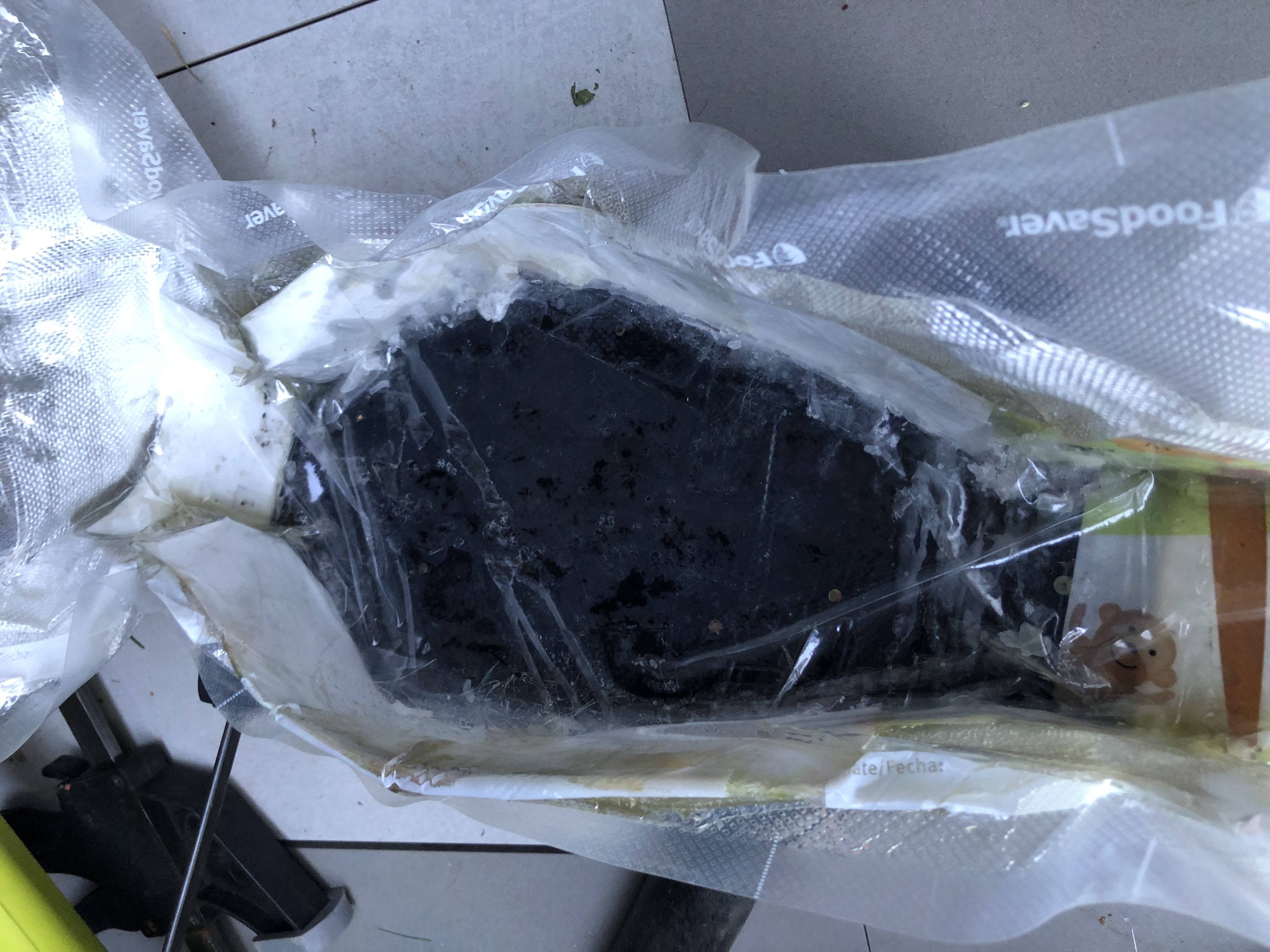

Everything was ok until I applied the chopped mat. The chopped mat was less flexible so it pulled out the previous layer of glass cloth. To emergency repair this I quickly made a vacuum bag and placed the piece inside. I planned on an open air layup, so it wasn’t prepped properly to go in a bag. I hadn't made a piece this big before, so I had a hard time getting it in the bag. I then removed the air. I noticed that even though the flanges were made of paper they held up under the pull of the vacuum.
At this point my gloves broke and I am covered in unset epoxy and fiberglass strands from the chopped mat.
I need to use a bigger bag next time, if I still have one. The sides started to pull away from the part of the mold where the tabs for the rear bulk head are. I used a set of clamps to pin that part down.
I waited a couple of hours and removed the part from the bag so it could finish curing. The bag pulled away cleanly so that was a good sign. The resin wasn't hard yet so I took the scissors to trim off some of the excess fiberglass. I then peeled off the paper flanges from the inside.
I'll wait till morning to make a full evaluation, but it looks like a pretty good first effort. The wax prevented the resin from seeping into screw holes and there were no gaps. The mold feels pretty thick at this point and when I knock on it, there is a solid sound coming from it.
I'm going to let it cure overnight before I try and remove the chassis from the mold.
So far it seems promising.

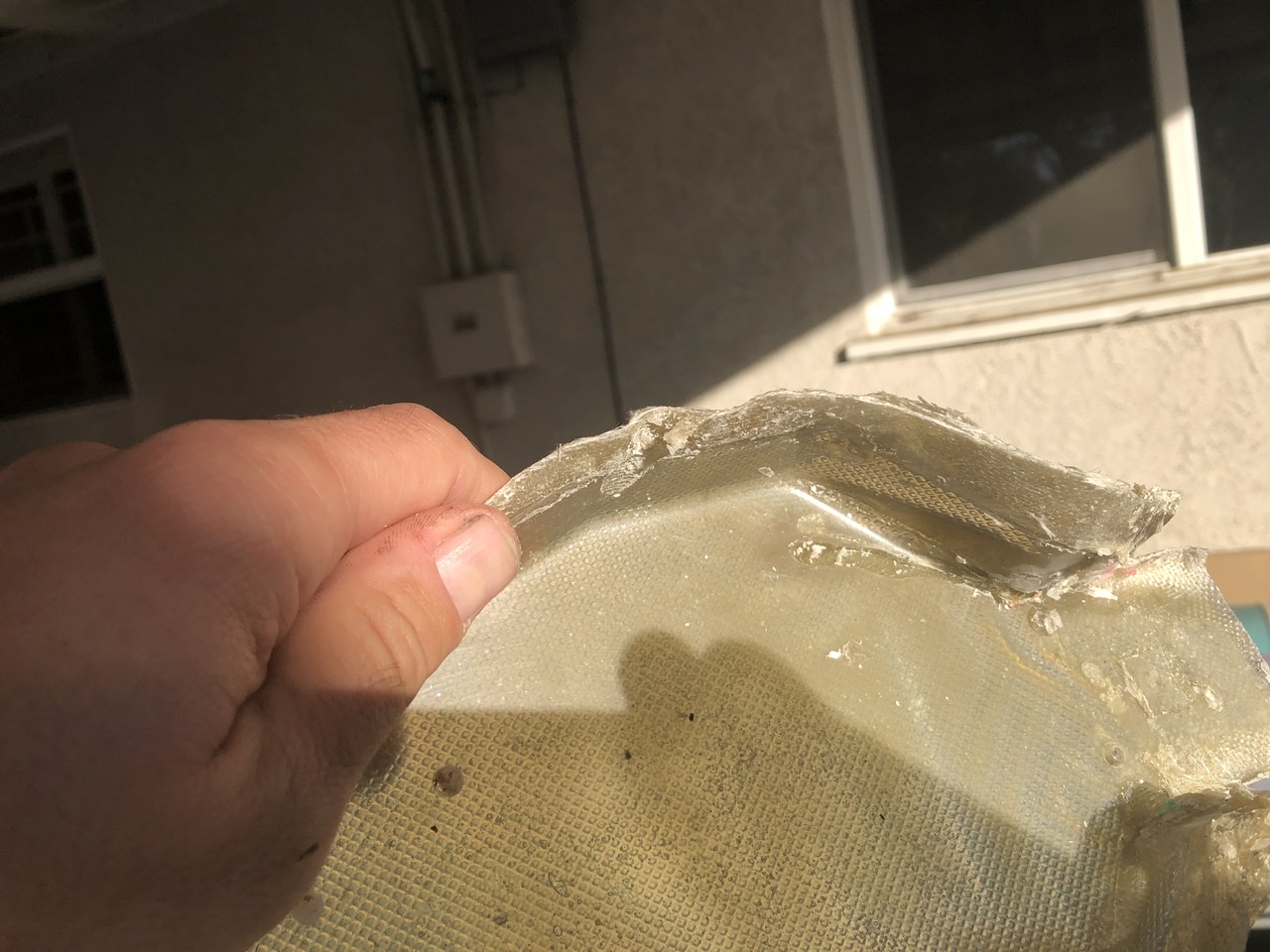

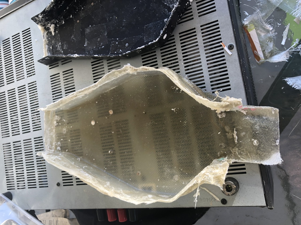

A successful failure!
The parts remolded correctly and the chassis is not damaged.
Some things worked and some didn’t. Where the resin contacts the chassis all is smooth. No fabric is visible at all from the mold side.
The wax in the holes look like it mostly worked. I was able to scrape the wax plugs off the mold with a fingernail and it was mostly flat. There were voids in the mold. These seemed to be due to bunching fabric, as well the tail of the mold wasn’t flat due to wrinkles in the fabric.
The mold was also about 1/16 thick and should be around 1/4” thick to cast a 3mm part.
The flanges moved inwards and that would make cst parts harder to demold.
