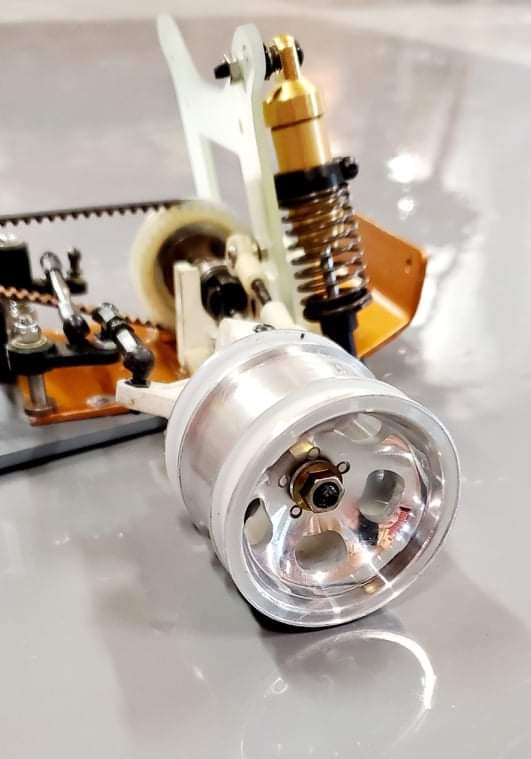

I would like to use these 1.6" wheels....I only have two, F!

coxbros1 wrote: Fri Jan 21, 2022 4:44 pm I would like to use these 1.6" wheels....I only have two, F!
https://www.amainhobbies.com/kyosho-beetle-5spoke-rear-wheels-2-chrome-kyosch004sc/p1222905
They use a serrated drive washer.

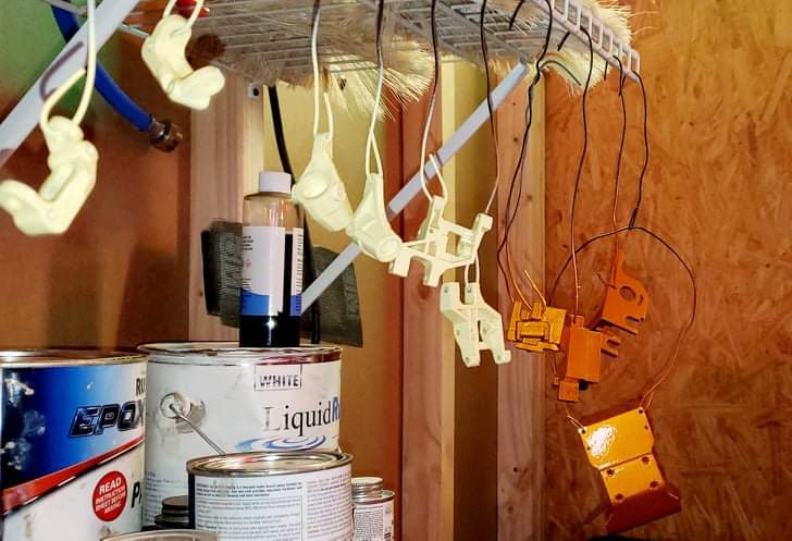

That's an interesting battery location. Is that for more weight on the front wheels? It seemed like you had a good spot reserved on the right side. Maybe there will be 2 batteries!
It looks like you might have a sources of paint that's similar to RC10 gold annodize color. Is that true? Any details?

Yes on the paint....I did and rc10 restored with it last year, I will dig up the link...actually i am ditching that battery too for a more streamlined approach....stay tuned!

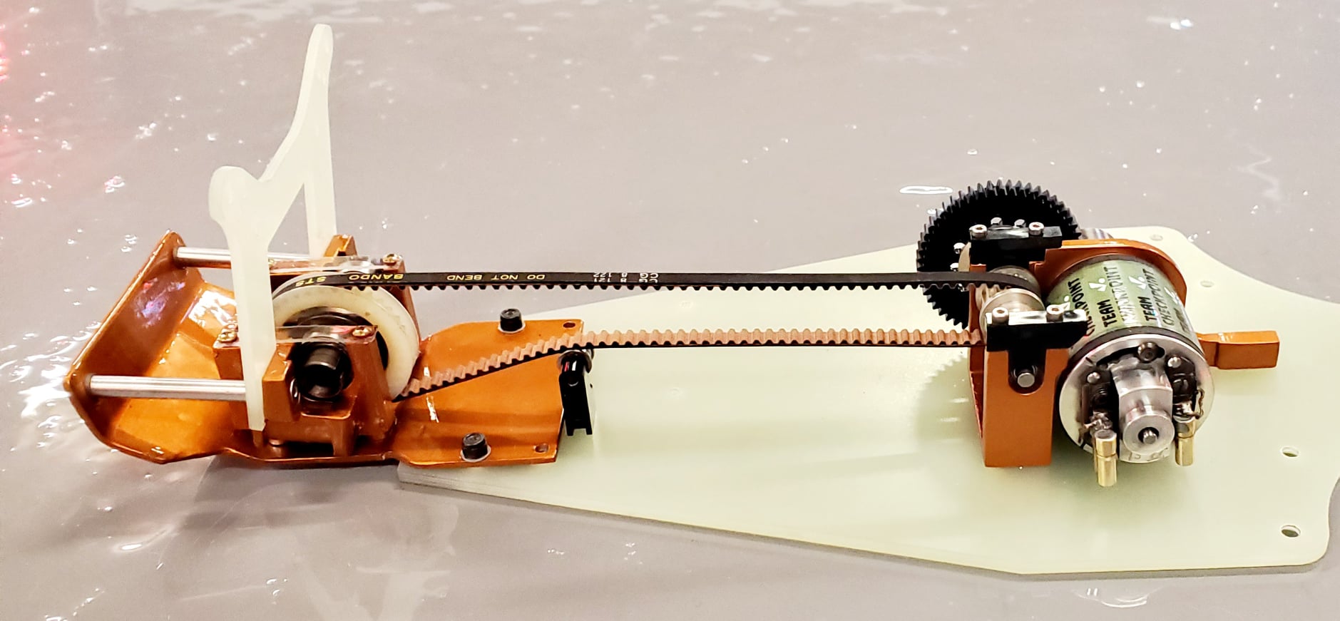

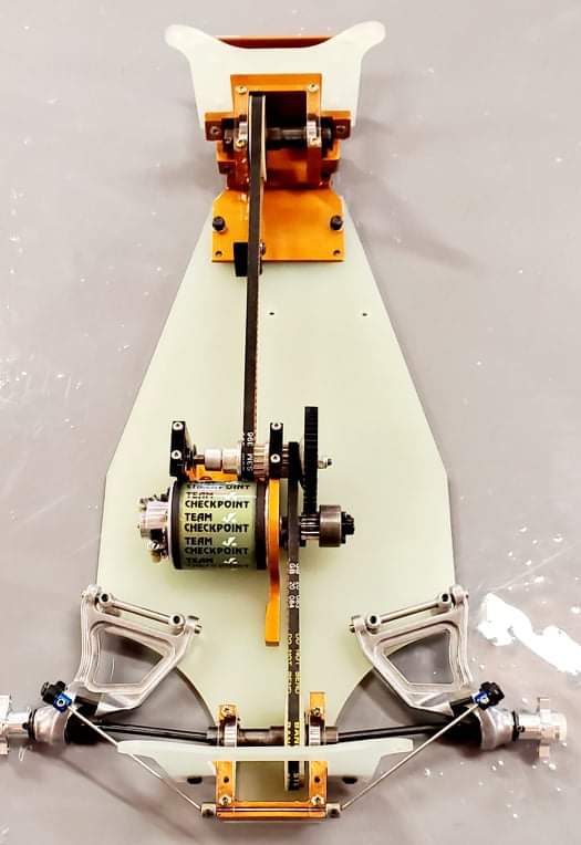

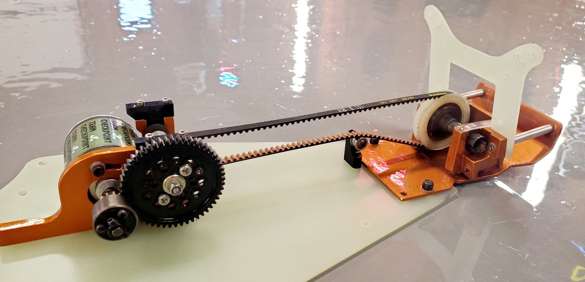

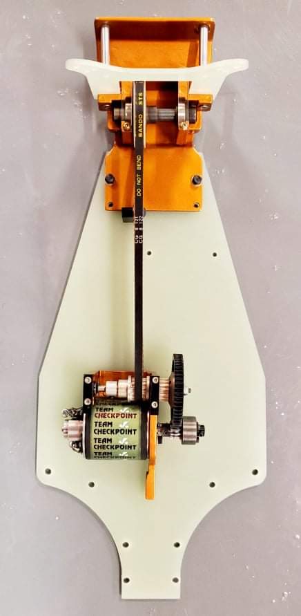

Starting to take shape now....the battery will go sideways in front of the motor mount under the belt, it won't hang off chassis at all and is only15mm tall which clears the belt...don't have it yet....2000mah 2s 50c. The dogbones are ordered...65mm rear, 61mm front Fabbed up some nose tubes....can't have an rc10 without those :lol:

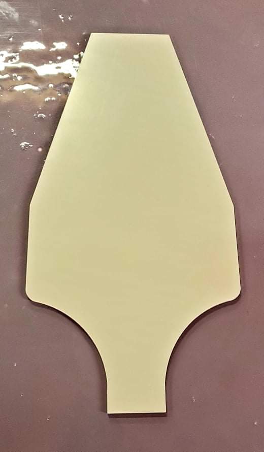

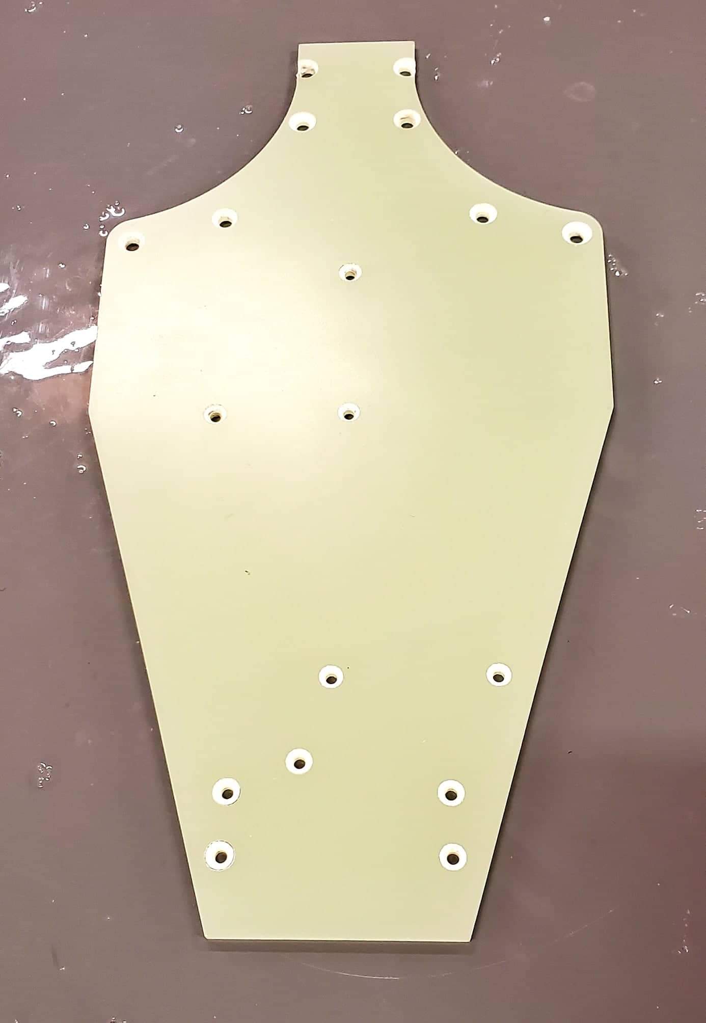

Post by coxbros1 »

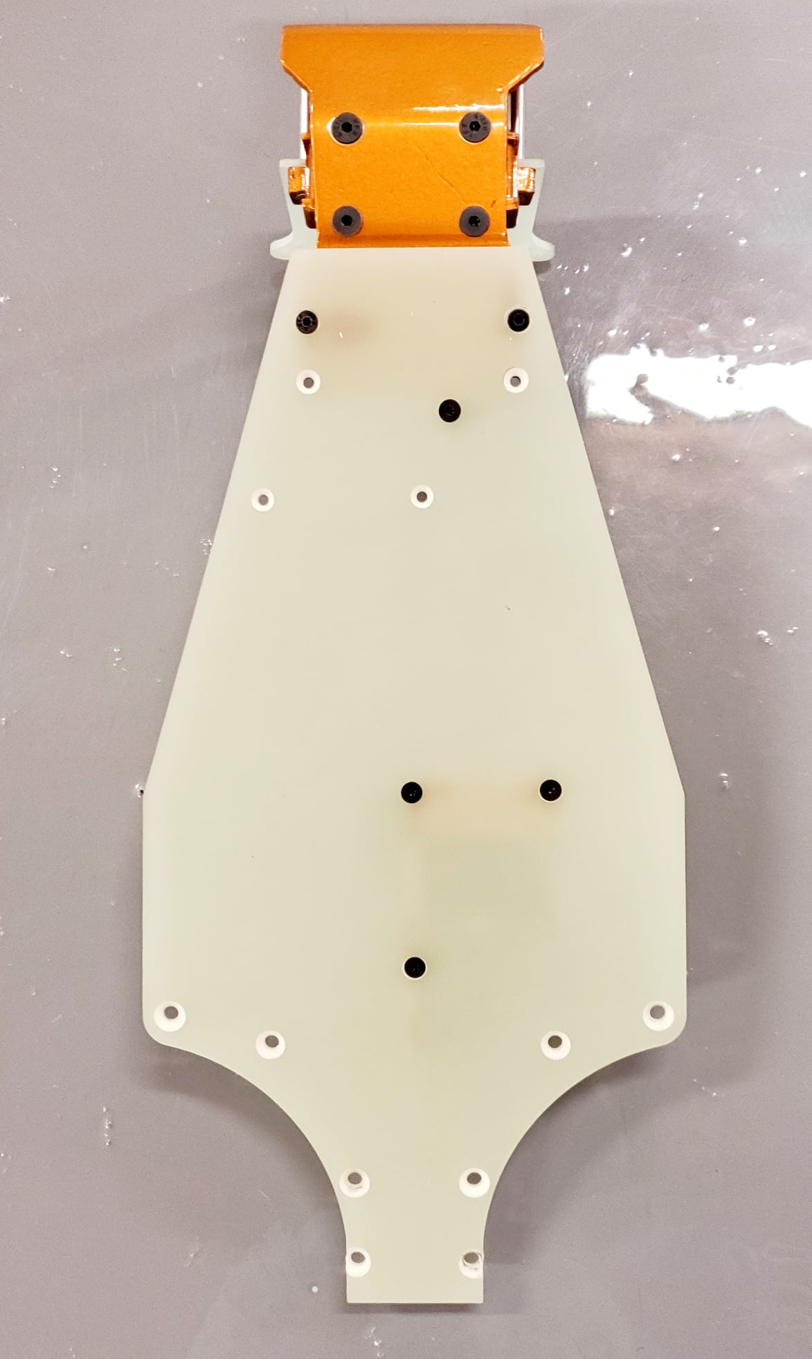

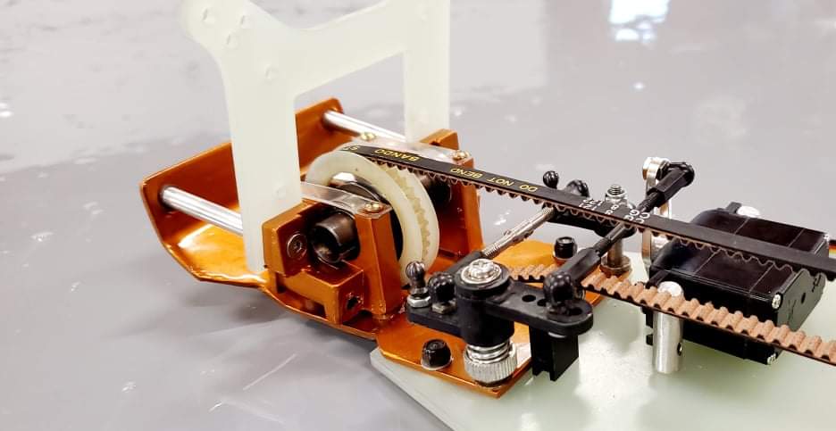

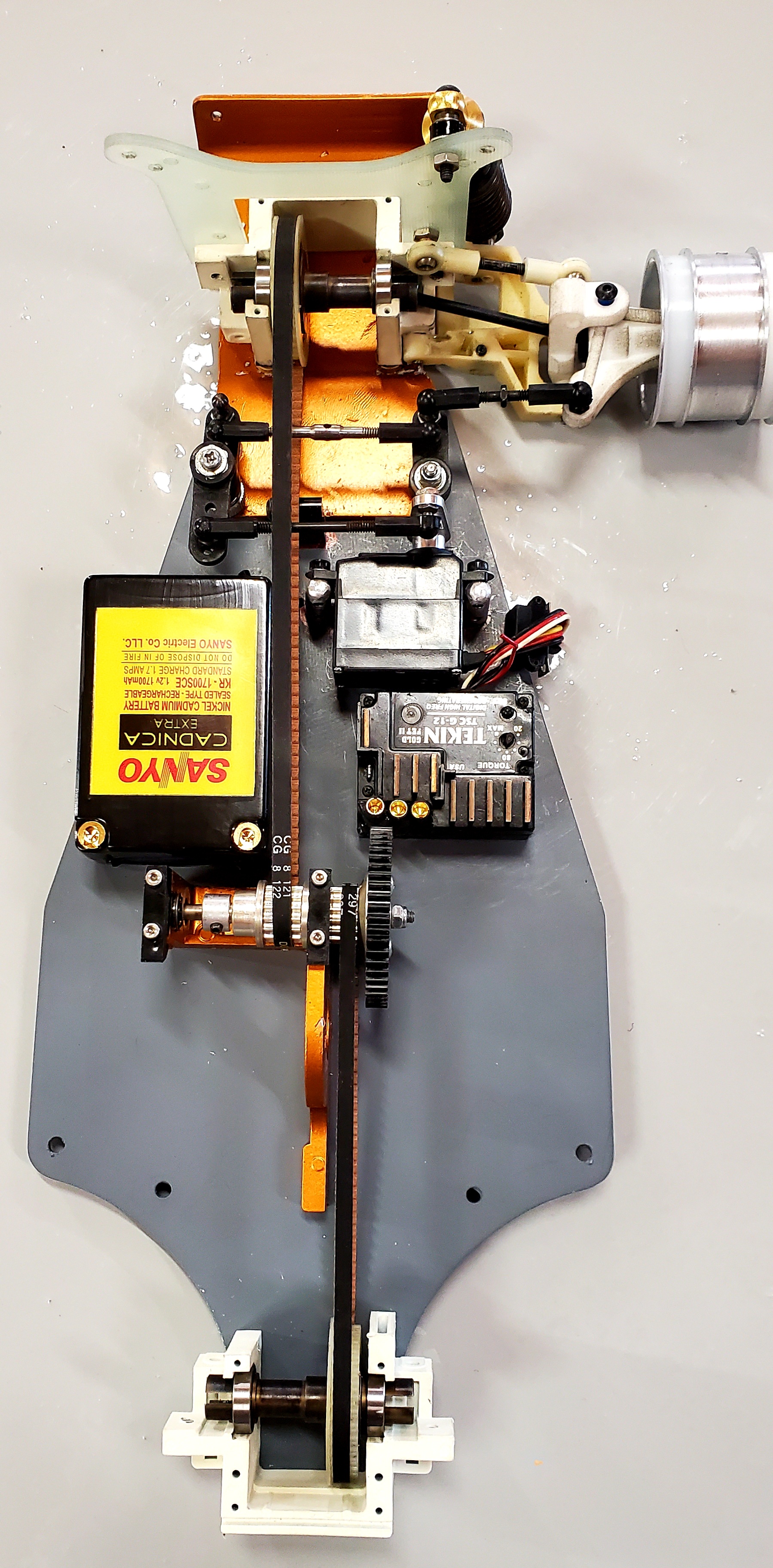

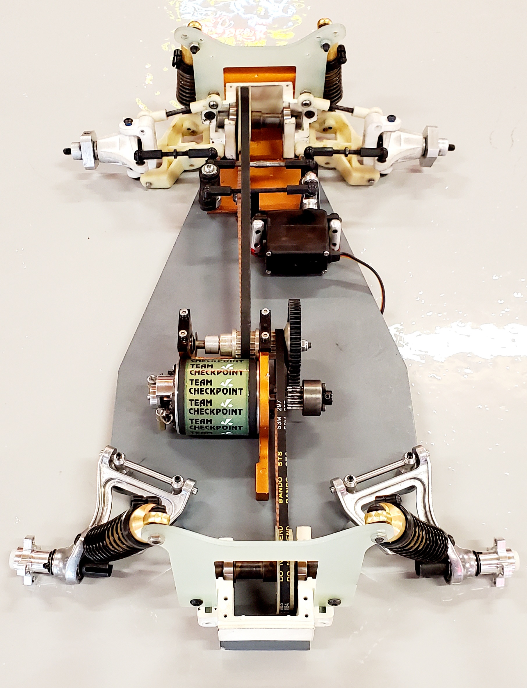

Starting the assembly with a fresh Picasso custom cut from Malar at Factory Works

Re: Concept 4:10

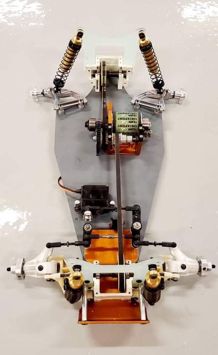

Processing nicely, processing very very nicely.

This is so badass
