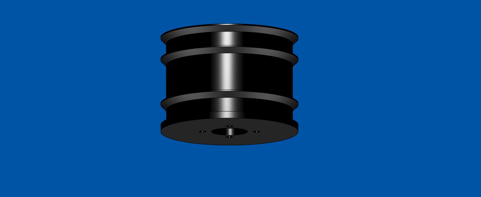

Decided to restart my Fusion360 project from scratch yesterday night, to do it properly this time...
I do have now a model which allows me to play with the internal diameter of the tyre I want to put on the rim, the width of the rim, and the number of spokes. The spoke will enlarge with the diameter and will reduce when the number of the spokes increases. This may still require some fine tuning to find the right proportion, but at least it's a start. I still need to find a way to add rings for the modern tires, and as well some différent possibilities for the driver (which is currently a friction based driver, but it would be better to allow for an ex driver in some cases...
Here is a sample of the possibilities at this stage, for the front wheel...
I still need to take care of the rear wheel properly (but I have to redo it fully as I completely messed up my initial project doing so beginner's mistakes, and secondly because the hub driver needs more thinking to be able to handle an hex driver (not for the Samurai, but for other purposes) :-)

It seems I'm getting faster at it :)
I now have the front and the rear wheels done.
I've slightly modified the rear driver area as I'd like to be able to handle hex driver for some purposes but beside this it looks like a Samurai wheel in the original dimensions. I've indexed the rear hub on the front hub size. Which means that the front size inflation leads the rear hub size. The rear wheel size is to be set with it's own parameter, and don't impact the hub size.
Few things remain to do, but it is already good for now, and won't require redesign of anything when I will change the slots internal/external diameter to allow some proportionality so it scales better. And for the additional ring, it will be done later on (but that is very easy to do compare to what I've done until now :-) ).
Maybe I should consider catching up some sleep :-)
(Maybe I should also consider doing a 2WD Front Narrow rim with seats for ball bearings as well)

Well... A bit of reasearch, and a new feature appears :).
Conditional parameters don't exist in Fusion 360, and it is not even possible to enter a parametric value with a 0. Had to find a way. A bit of search showed there is an interesting function: Sign(x) is answering 0 if x is a negative value. I decided to see if I can create rings for modern tires based on a parameter set to 1 if modern tires or -1 if original tires.... And it worked after a few tries.
Here is my wheel when the parameter is set to 1 for modern tires
And here is the wheel when the parameter is set to -1
And it's not perfect as there is a warning left in the case of the parameter being -1...
*EDIT* I had to change the rear extrusion to .1+Sign(ModernTire)*3.5, do a +.1 extrusion and a -(.1+sign(modernTire)*3.5) extrusion to get it right...

There was a last step to do on those wheel design work: be able to set the right type of driver for the stl I want to print. It was relatively easy to do, as soon as you understand what you can do with the sign(x) function.
With the Hex driven parameter set to -1, it is the Marui Samurai original friction driver which will be used. And with the same parameter set to 1, it is going to be hex driver. There is warning, but it's not really an issue in this context, as I do not make anything after that in this area (precedence has some importance in the history for this).
You can see the parameters in the screenshot if you are going thru a similar model project for a multi-purpose wheel set :-)
And yes, that was fun, I spent a lot of time on this, but I can certainly say I have quite a good idea on how to use parameters in Fusion 360. Yes it may take a bit more time than to do directly on the sketches, but it is really rewarding at the end :-). Have fun.

To print the tire support rings without support is pretty easy , just put a chamfer on the lower side as in the picture , as its 45 degrees its less than the 50 degrees overhang that most printers can cope with without support , holds the tire just as well .
its a very easy trick .
Those wheels look really nice in that filament :D , silk filaments do usually have dreadful layer adhesion though so its going to be interesting to see if they hold up to driving , they probably will , I've printed wheels for several cars in PLA and never had a failure .

Dadio wrote: Sun Feb 06, 2022 4:30 am To print the tire support rings without support is pretty easy , just put a chamfer on the lower side as in the picture , as its 45 degrees its less than the 50 degrees overhang that most printers can cope with without support , holds the tire just as well .
Thanks :)
I did not thought about applying this when doing the design (I was maybe too focus on getting the parametric thing working :-) )... This is part of the things I intend to modify. I also want to modify the spoke reinforcement and reduce the size of the external ring, and few adjustment on the parameters for the axle diameter and the driver diameter... And slicing will be revised: the target was to test and not the quality of the print.
And for the Silk Silver PLA+, it looks nice. Not sure how they will work out on the field. That's part of the things I want to try. And in any case, if the model work, I can also get it printed in Nylon (SLS or MJF) and eventually painted thru the online printing service (both Weerg and Materialise are proposing options for this).
