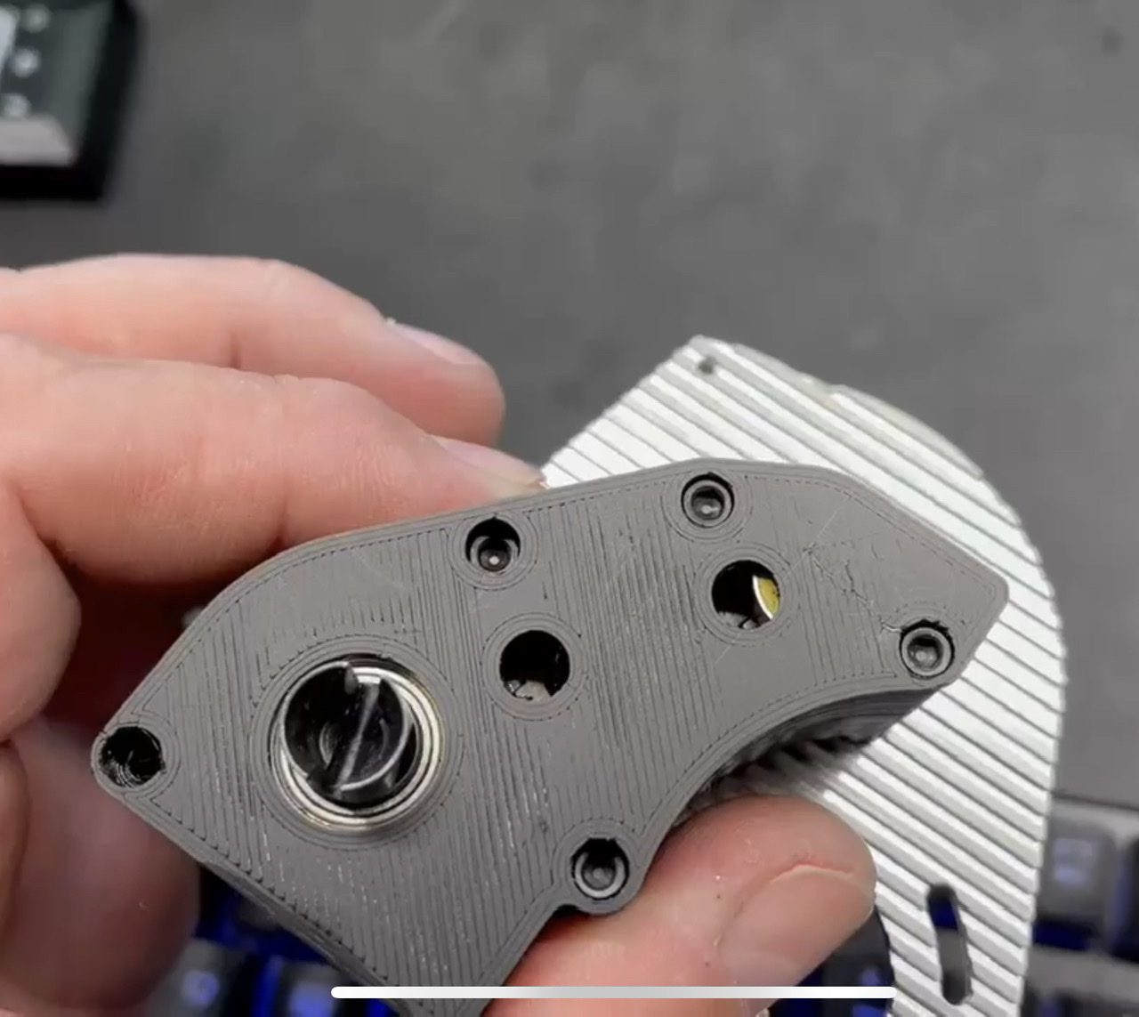

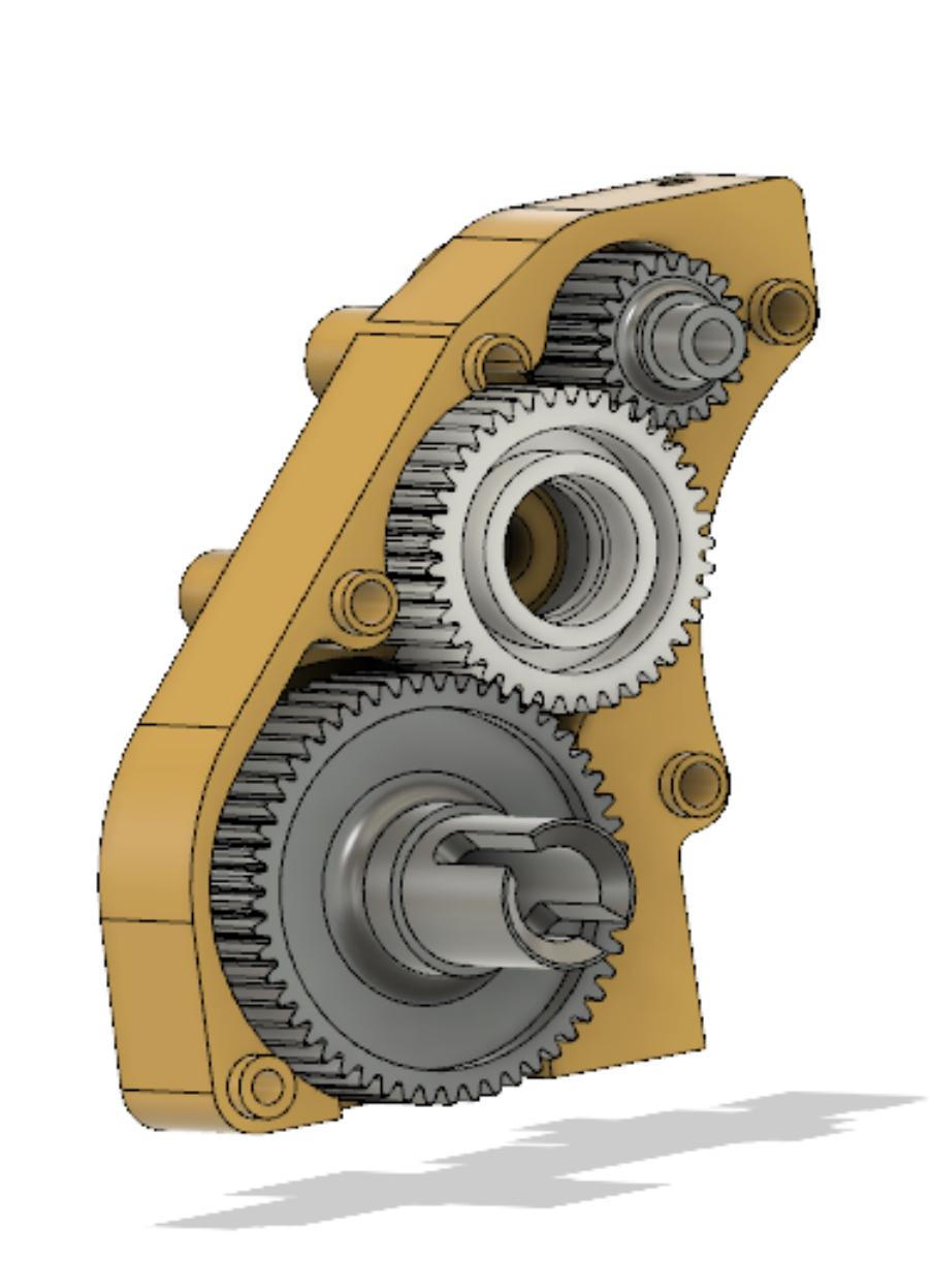

While waiting for a few pieces I sat down and re-envisioned the lethal weapon. Parts are getting low, and belts don’t like modern brushless power. The drawing is a b6.3 transmission stuffed inside a lethal weapon footprint, slipper adjustment hanging out the left side. The print shown is the dr10 version with the traditional slipper adjustment.
Checking the internal mesh with some holes in the print.

Is that going to fit an RC10?

Technically it could, but the fitment is the same as the original lethal weapon so you would need to drill the holes, lose the motor plate to chassis connection, and would use the special trans brace. Unfortunately the stealth screw holes are right where the huge diff would sit. The lethal weapon ended up being the perfect size for this.
Really I was doing it for the reproduction A&L prototype

I guess i forgot to post the test prints. One for DR10 based trans internals and one for B6 internals
