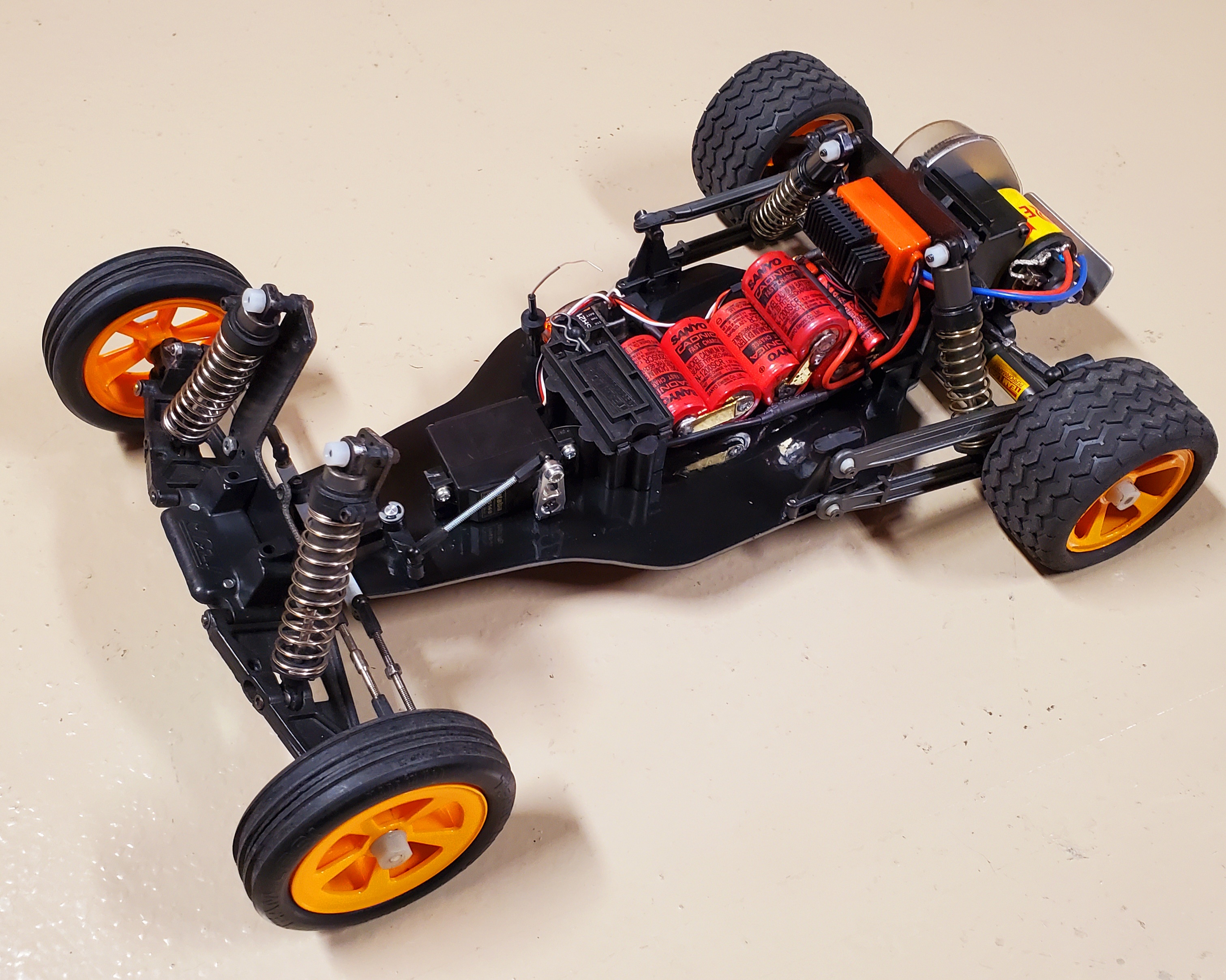

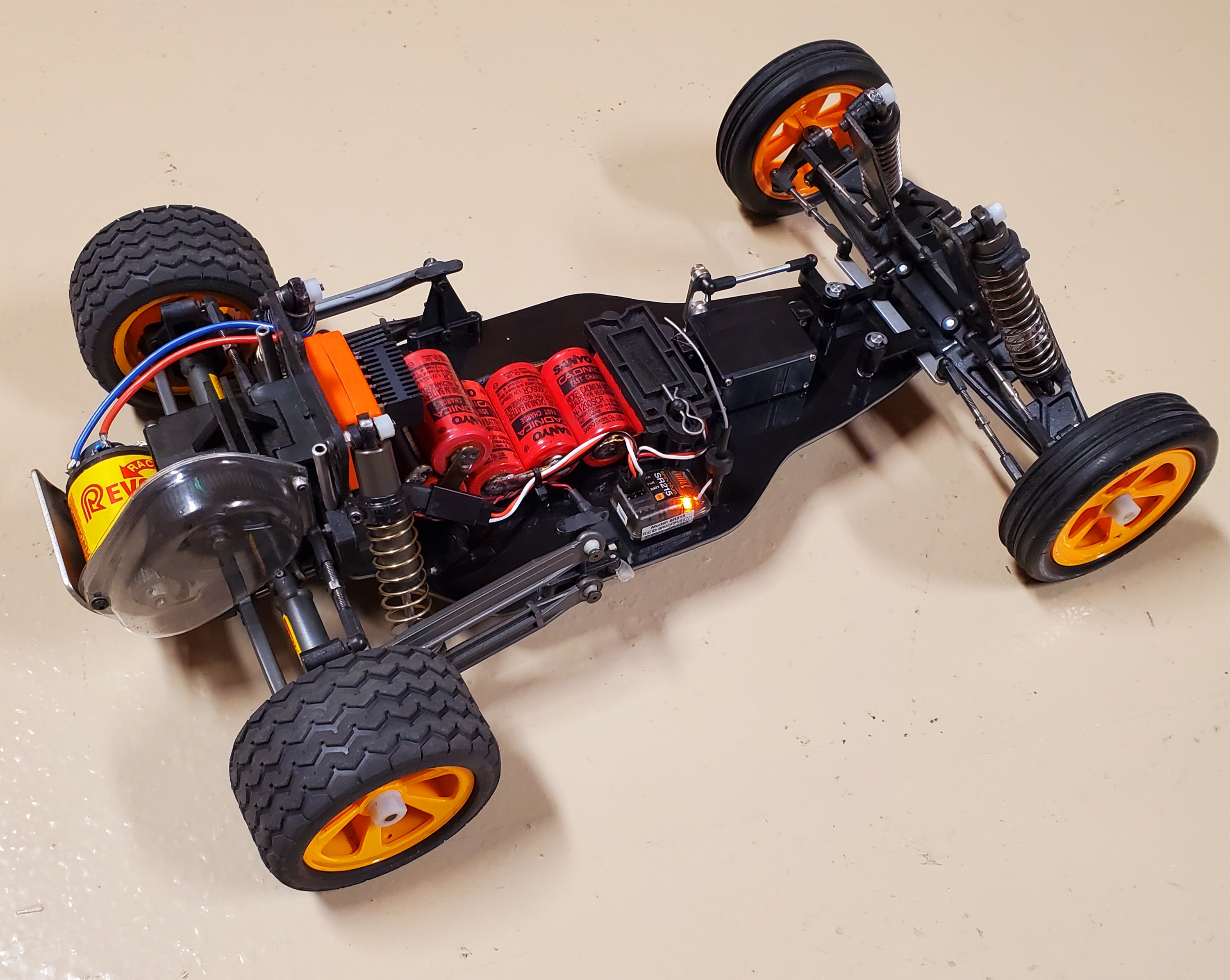

Updated this car with vintage electronics/battery (except receiver)...even S148 on the servo

What paint did you use on the chassis? Looks sweet and I’m
Redoing mine.

WriteDean wrote: Sat Jun 04, 2022 6:34 am What paint did you use on the chassis? Looks sweet and I’m
Redoing mine.
Filled gaps and holes with jb weld. Sanded it it all smooth. Painted it with black rustoleum or equivalent spray balm and cleared it with cheap automotive clearcoat from ebay.

Made some battery changes....put a 7 cell unit in and rebuilt the motor...it's had a rough life on the shelf!...when Thumbs came down last weekend it was slow...pulled motor, only cranking 19k rpm...cut the comm, new brushes, etc...30.5k rpm now at @3.75 amps
