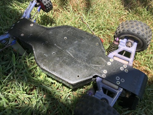

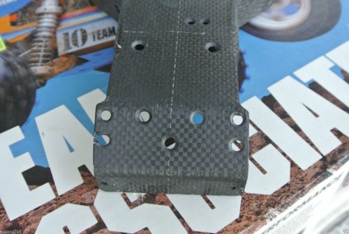

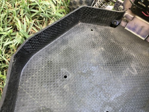

Does anyone have a professionally made rc10/rc10t carbon fiber tub chassis they can take close up pictures of?
I'm trying to see of there are fabric joins in the corner of the chassis or if the shape was slightly altered on the front, back and the draft of the sides.

Thanks. This helps me in understanding what is possible.
I have a way to go, but I am closer than I thought.
