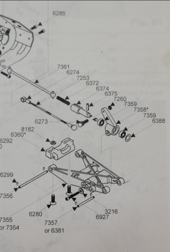

Re: what rear arm mounts came with the rc10t?
This is what mine shows. I believe those are 1.5° mounts and 3° carriers, but that seems excessive.
I don't like using 3° mounts on a truck, due to the control arms length. To me, it looks odd.

Thanks. I wasn't sure if somewhere along the way there was an update.juicedcoupe wrote: ↑Wed Oct 05, 2022 10:48 pm This is what mine shows. I believe those are 1.5° mounts and 3° carriers, but that seems excessive.

RC10T standard kit parts are...
4.5 degrees total rear toe-in per side.
6360 1.5 degree rear arm mount
7358 3 degree rear hubs
What Chris's setup says...
3 degrees total rear toe-in per side.
7363 3 degree rear arm mount
7365 0 degree rear hubs

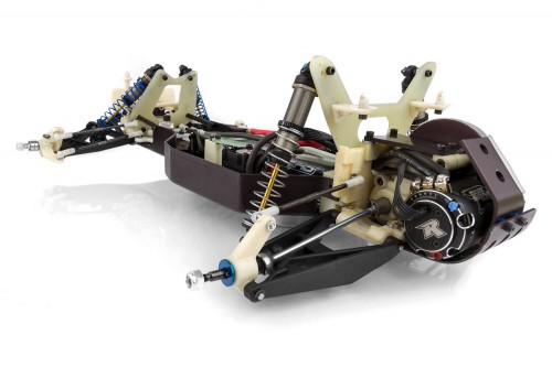

But...Pictures of the rear end and top view show 3 degree rear hubs, and 1.5 rear mounts, on long wheelbase. The pictures are definitely not whats written on the setup sheet.
https://www.reedyrace.com/ae/spotlight/pages/RC10T_Van/index.html

If you look really close, the car setup and hardware changes slightly in every picture... I assume that liberties were taken for the photo shoot. I'll assume that the suspension setup would have been left alone.Mark Westerfield wrote: ↑Thu Oct 06, 2022 5:57 am RC10T standard kit parts are...
The setup sheet lists the toe in at 3 and the hub at 0. The car was using the mounts came with the kit. but given the rolling changes on associated sets I am not sure what that would even mean.
I think I have 6366 and 6360 on the truck now which would meet the 3 degrees setup.
