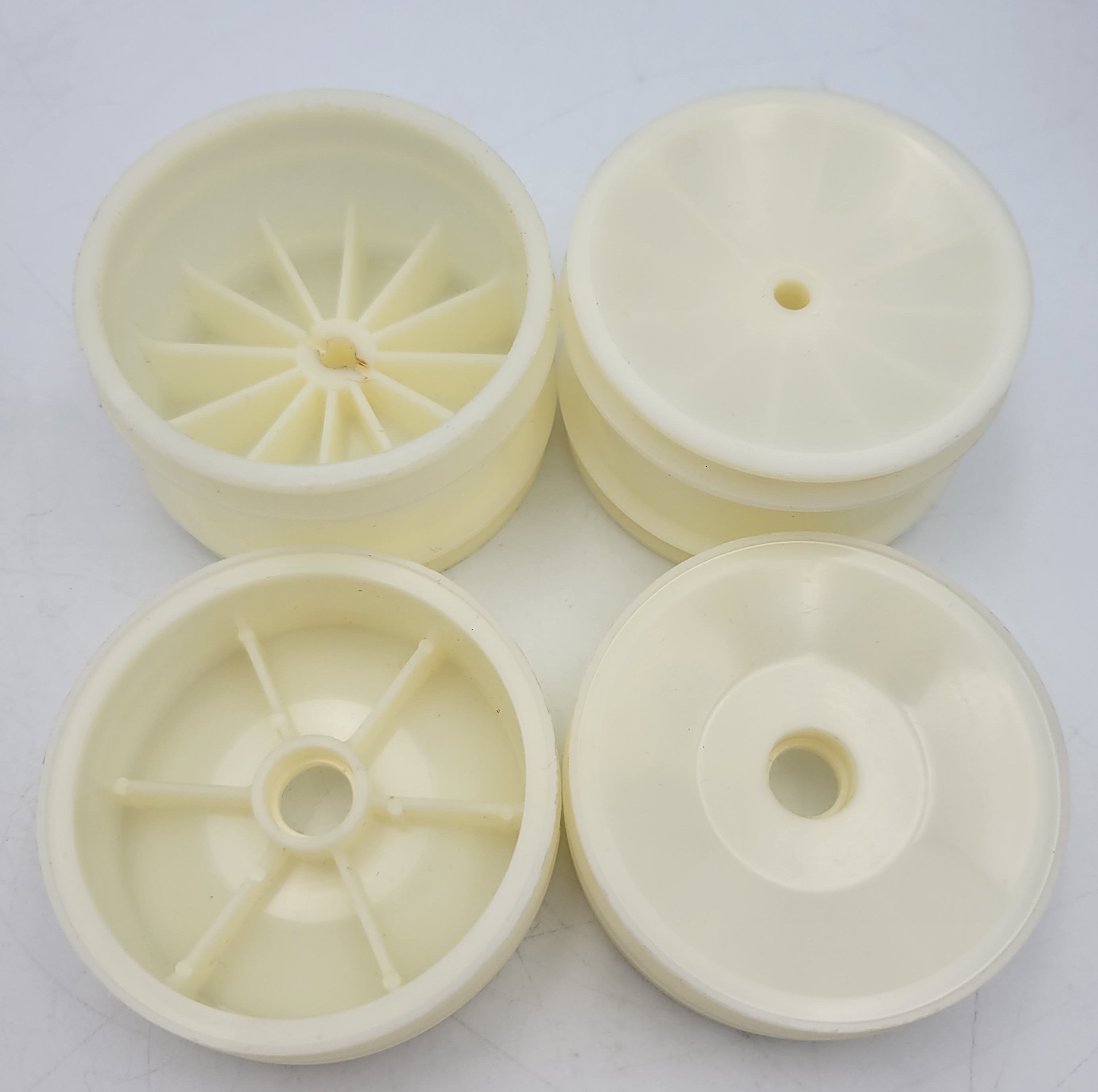

I have these wheels that came with the donor. I believe they are Traxxas? I was thinking of dying them black. Thoughts?

Thanks for the confirmation on the JC wheels!
Those wheels you have there look like older Bandit rears and TRX-3/TCP fronts. I've dyed sets of the TRX-3 style wheels and they take it great. Those rears appear to be nylon as well so it should be no problem dying them. I don't have any dyehard advice on the dying, but slow and low to medium high. Some say just below a boil and dont let the parts sit directly on the bottom. I've always just tossed them around occasionally at a simmer. And I don't measure the dye. It's darn near the whole packet/bottle and just enough water to cover the parts. And obviously as long as you want really. Sometimes I've ended up with a purpleish hue in the right light when I didn't leave them in long enough. And if you scuff or scrape/bend the rim bead running or racing there will be like a dark blue/indigo kind of appearing.
*edit* all of the above assuming you are dying them black.

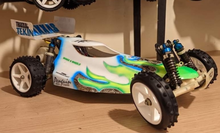

The donor car came with this painted body. It's quite nice, but unfortunately not my favorite colors. I will be painting up a new body for it. I added the new Penguin wing.

Small world. Not sure if your whole car was mine but I owned that body for sure 5 years ago or so and lots of your car looks familiar. I got the car from another friend of mine who no longer posts here. He did a few parking lot races with it, I sat it on my shelf and it went to ebay when TRX1's sold for practically nothing.

^ RCveteran - Yeah the guy I bought it from said it had gone back and forth a few times. It was very well built. I really like the paintwork, but the colors aren't a great match for the car now.
I threw on the white wheels, and I think they need to be dyed black. I think I will also order a set of JC 5 spoke wheels.
