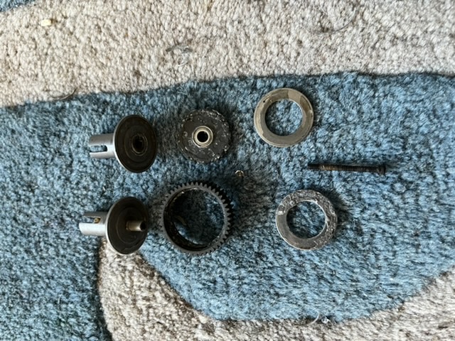

On one of my recent ebay buys was a t3 that I just started stripping down. For the most part everything looked good. When I got down to the diff I was happy the out drives looked to be in good shape. Then I realized that it wasn't grease leaking out of the diff.
It appears that the diff was filled with epoxy then tightened down to the point it began to ooze from the gap between the gear and the outdrives.
I was going to just dunk this in acetone, but I was worried that the epoxy won't get the the internals.
Does anyone have tips?
It seems fire could be a good way to go. Are diffs overrated?

I'd soak it in acetone to remove the outdrives, then replace the gear, rings, and balls.

If the outdrives are good, they are worth saving. I'd probably try heat, maybe like a toaster oven around 350degrees f. The diff gear and everything except the outdrive will likely be trash.
Any higher temp and you will impact the heat treating.
You should be able to heat, take out of the oven and twist apart.

Thanks for reminding me about the heat treatment. I was considering setting the whole thing on fire.jwscab wrote: ↑Fri Jan 20, 2023 8:55 am If the outdrives are good, they are worth saving. I'd probably try heat, maybe like a toaster oven around 350degrees f. The diff gear and everything except the outdrive will likely be trash.

Re: Solid epoxy diff. Do you really need a working diff?
This was my original thought. I wasn't sure if there was something better.juicedcoupe wrote: ↑Thu Jan 19, 2023 7:42 pm I'd soak it in acetone to remove the outdrives, then replace the gear, rings, and balls.
A soak in acetone did the trick. The jbweld softened right up.
It came apart as normal.
I also got to see why it was like this. It looks like the center of the diff gear melted off the edge and the jb weld was added in place of a new gear.
Looks like the rings may still be good but I am not sure I can salvage the bearings.
Suppose I should build this T3 now.
Thank you to everyone who offered up a solution.
