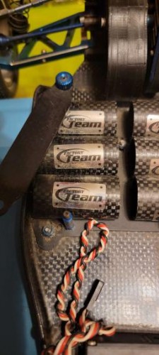

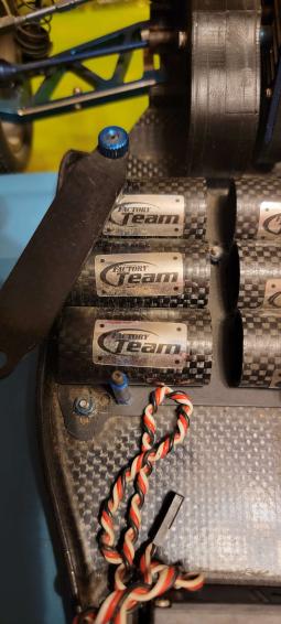

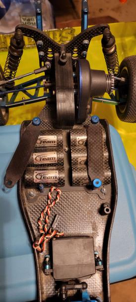

Here are the Team Associated cell place holders I mentioned previously. I don't know it you can still find them but they would not be very hard to make. cut some metal disks to glue on the ends and shrink wrap them as you see fit.
