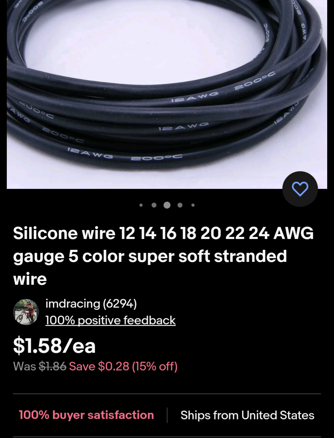

Has anyone had any luck finding similar diameter wiring to the novak 16 guage wires in the Novak Rooster ESCs? I have 2 with really short wiring. I could splice on but it wouldnt look very good. Other 16 guage wire aeems to be too thick for the case and i didnt want to bore thw casing out. Thanks!

I've bought 14awg from this seller, but there is also 16awg available.

Thanks! I am going to try them I looked them up amd saw thry also have blue and yellow which should be perfect.Frankentruck wrote: ↑Tue Feb 14, 2023 4:13 pm I've bought 14awg from this seller, but there is also 16awg available.
