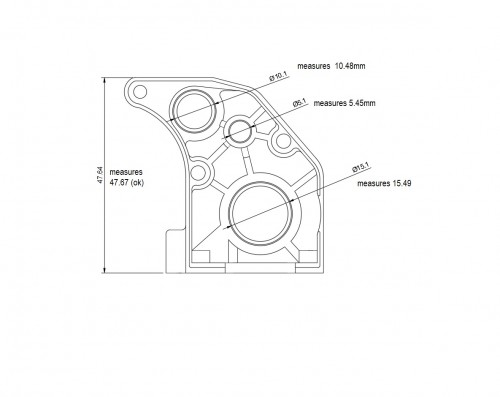

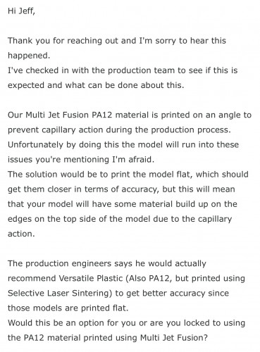

If you are hiring out the printing, you will need to print a gauge and see where it ends up. My attempt to use shapeways to print was around 5% out of spec instead of the .4-.5% they list but only on the holes, not the other measurements :roll: When I inquired they told me it was due to the process and to be expected. Their tolerance chart means nothing. The reprint in sls was also loose and I gave up on shapeways after throwing away $100 worth of prints.

From what you've posted and other have said, I believe there is a level of unpredictability regardless of which printer service one uses. Bearing bores require the highest level of precision (probably more than any other feature) so having a gauge made is probably the best route - although I feel there are no guarantees that the final print will be accurate and bearings will fit perfectly.
With the Mid cases I had printed a while back, I didn't allow for printing and the bearings simply would not fit and I ended up reaming the bores. Big hassle.

Just see this... I had various prints done myself, but never by Shapeways, and while I had some out of specs elements for bearing cages in SLS, it never happened with my prints in MJF from Weerg, i.materialise and JLCPCB). And the parts I got from @optimaforever for my Samurai and the Sogun are the same : not a single issue in measurements for MJF. I had a chat with him the time I saw the SLS tolerances issue for the red parts on my Nichimo, and he stated SLS is less precise, and therefore when targeted for SLS he was adjusting the diameters accordingly...
That being said, the main reason for choosing SLS veersus MJF was the possibility of white parts to be able to dye them properly, and this is no longer needed as White MJF parts are now possible... I don't know for Shapeways (I'm not using their services as they are by far the most expensive), but I can't see reason why you would prefer SLS over MJF at this stage...

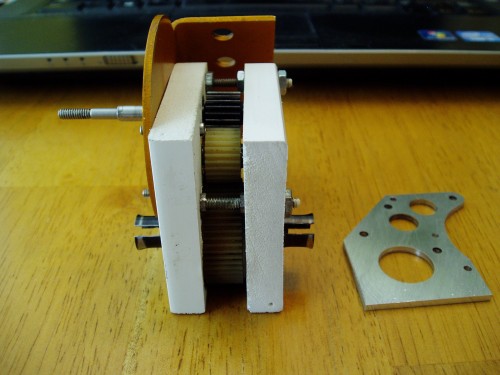

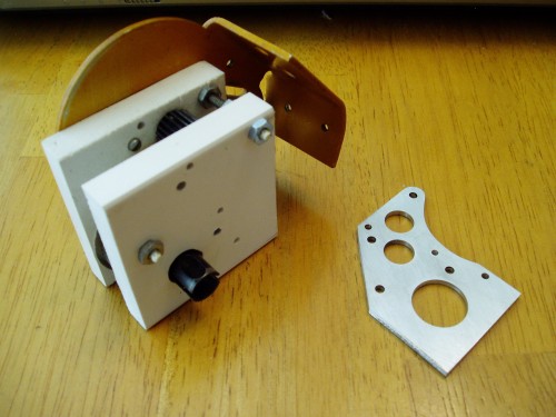

Hey Jeff, can you use your CNC router to make a pair of side plates similar to what I’ve done here?
I’m assuming that your router is far more accurate than any 3D print.
The plates will provide a way to check your design (critical features like gear circles, bore diameters, screw hole spacing, etc.) and allow you to make needed corrections before sending your design to the molder. When the production molds are finished, the molder can send you pre-production inspection samples for you to verify they have accurately captured your design. If the inspection samples reveal some inaccuracy, the molder is obligated to make corrections – they shouldn’t charge you for their mistakes.
Anyway, it's just a suggestion to help you move your project to completion. I really want a set of your cases. :D

I've managed to locate a spare printed idler pulley from the Mid (Polyamide MJF from iMaterialize).
The bearing bore measures ~7.9mm for an 8mm bearing so maybe I'll use 0.1mm allowance for my cases.
In any event, when the prints arrive, I will carefully measure the bores and document that for future reference - something I should have done before.
