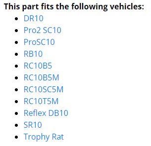

I'm using SC10 caster and steering blocks for a custom build and I'm having some trouble finding hinge pins - or rod material to make them.
Apparently AE changed from 1/8" to 0.110" diameter sometime prior to the B4? Anyway, the set is numbered 9622 and 9621 and AE has discontinued them (of course they have :roll: ). I need just 6 pins for my project (arm inner and outer and steering).
There is 91394 but I don't know the diameter. They are shown for:
hinge pin set.JPG (20.98 KiB) Viewed 1583 times
I'm guessing these are B5 era pins and perhaps they are metric?
Anyway, I'm looking for advice before I give up and ream the holes to 3mm.
thanks.

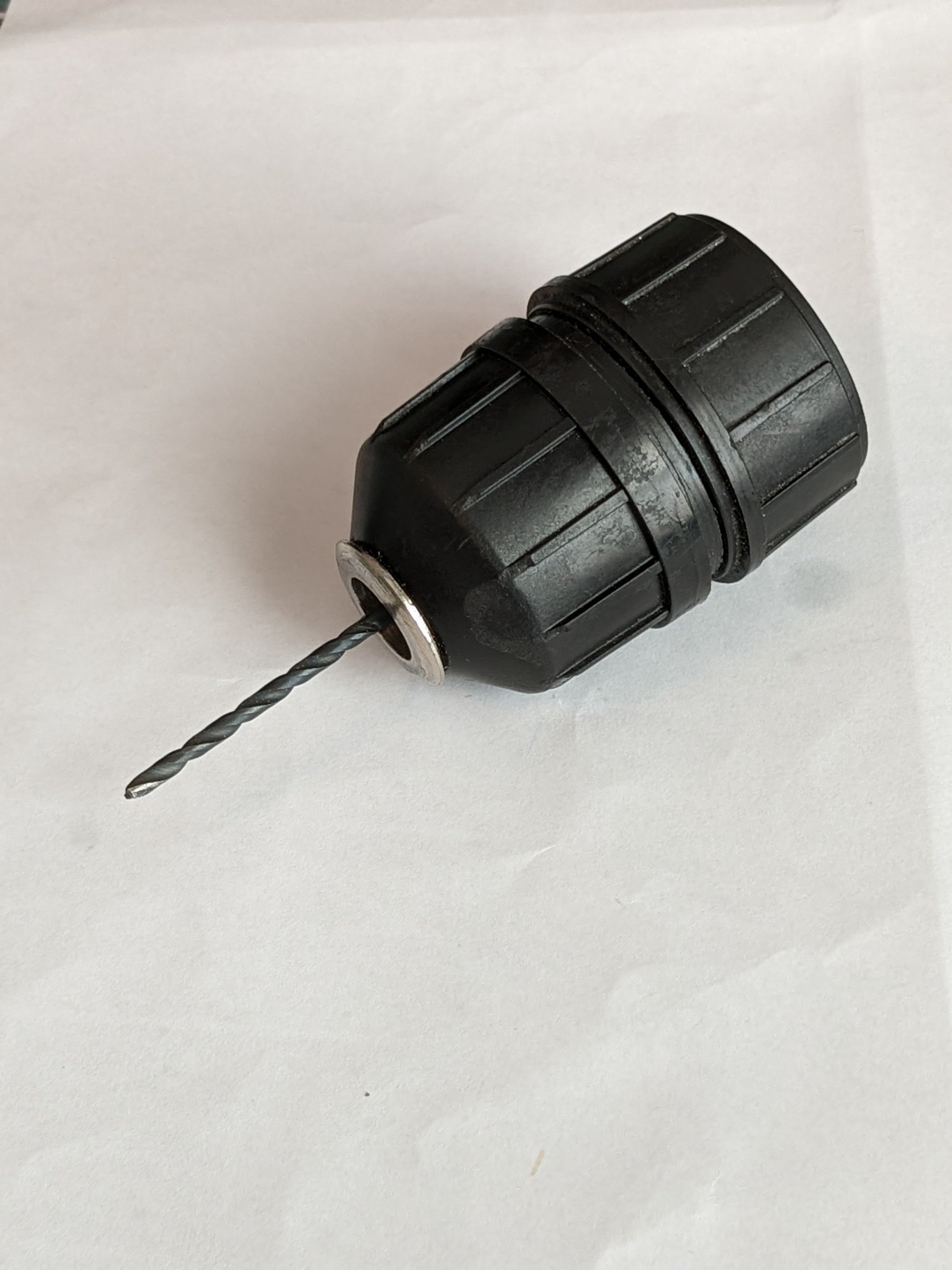

This is a SC10 c-hub on my DS.
All i did was take a 1/8" drill bit, attach it to a vice grip, and SLOWLY turned it through the hole.
Afterwards i would push/pull the drill bit without turning through a few times to smooth it out.
The hinge pin slid through easily without slop.
Don't use a power drill. i ruined a set that way.

LoboNYC wrote: Thu Feb 23, 2023 8:31 am All i did was take a 1/8" drill bit, attach it to a vice grip, and SLOWLY turned it through the hole.
Save yourself a little trouble.
https://www.amazon.com/General-Tools-93-Adjustable-Vise/dp/B000COYPG4/ref=mp_s_a_1_16?crid=DT7EPHJ49AB&keywords=general+tools+handle&qid=1677166181&sprefix=general+tools%2Caps%2C8468&sr=8-16
Also works good with smaller taps and reamers.
Posts: 3808
Has thanked: 2604 times
Been thanked: 2977 times
Re: AE Hinge pins
This is my preferred tool for holding drill bits and other round things. It's open ended and allows pass through.

I agree, both of those tools would be very helpful. Thanks for posting links.
The small drill chuck in my mini lathe can be removed by pulling a pin so I'll use it for hand drilling.
