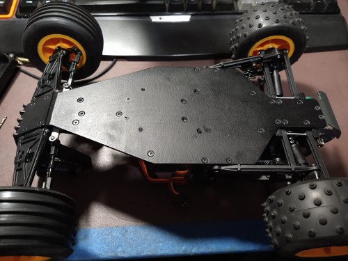

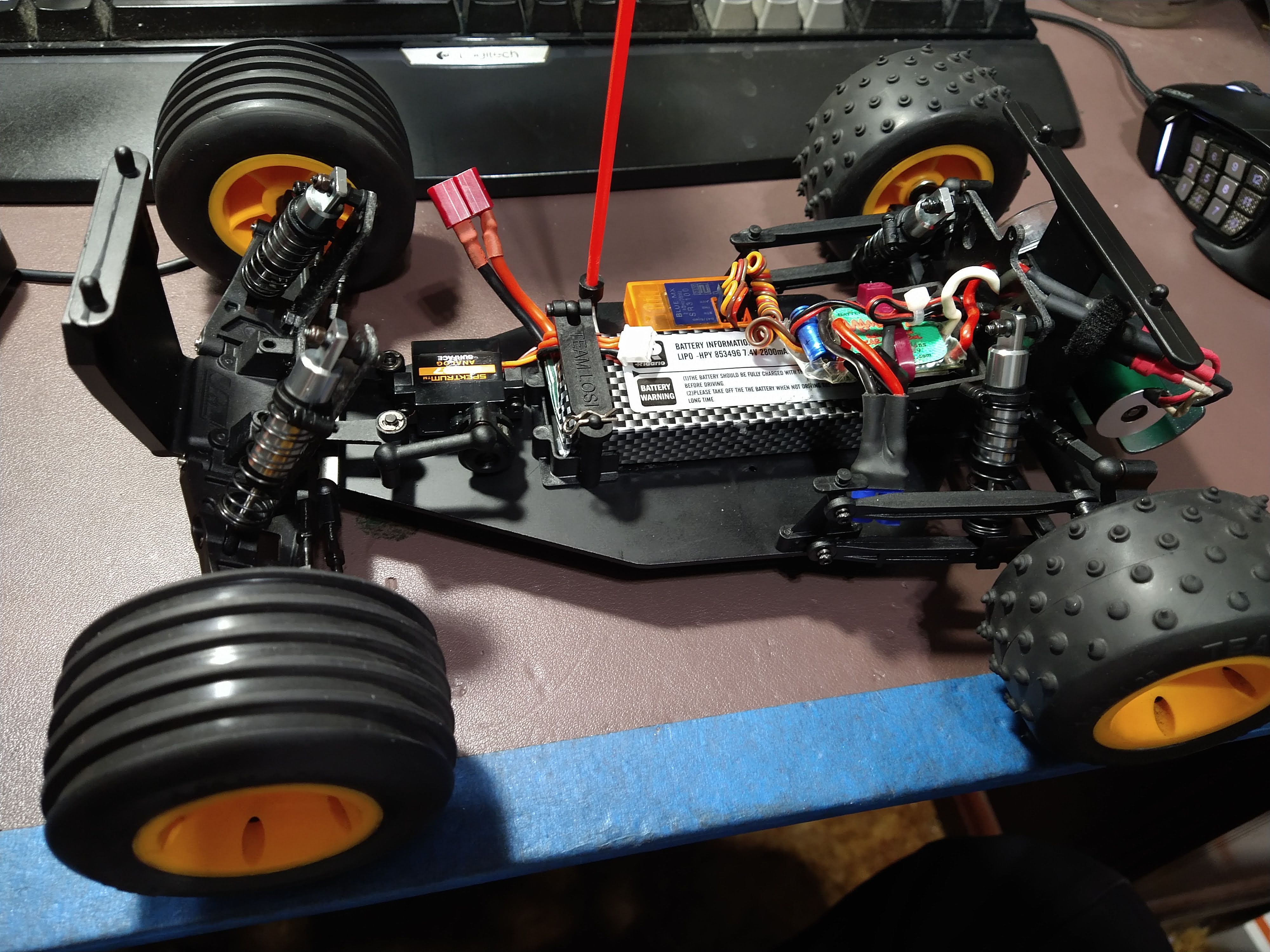

The side guards cut from a old mini JRX2 body

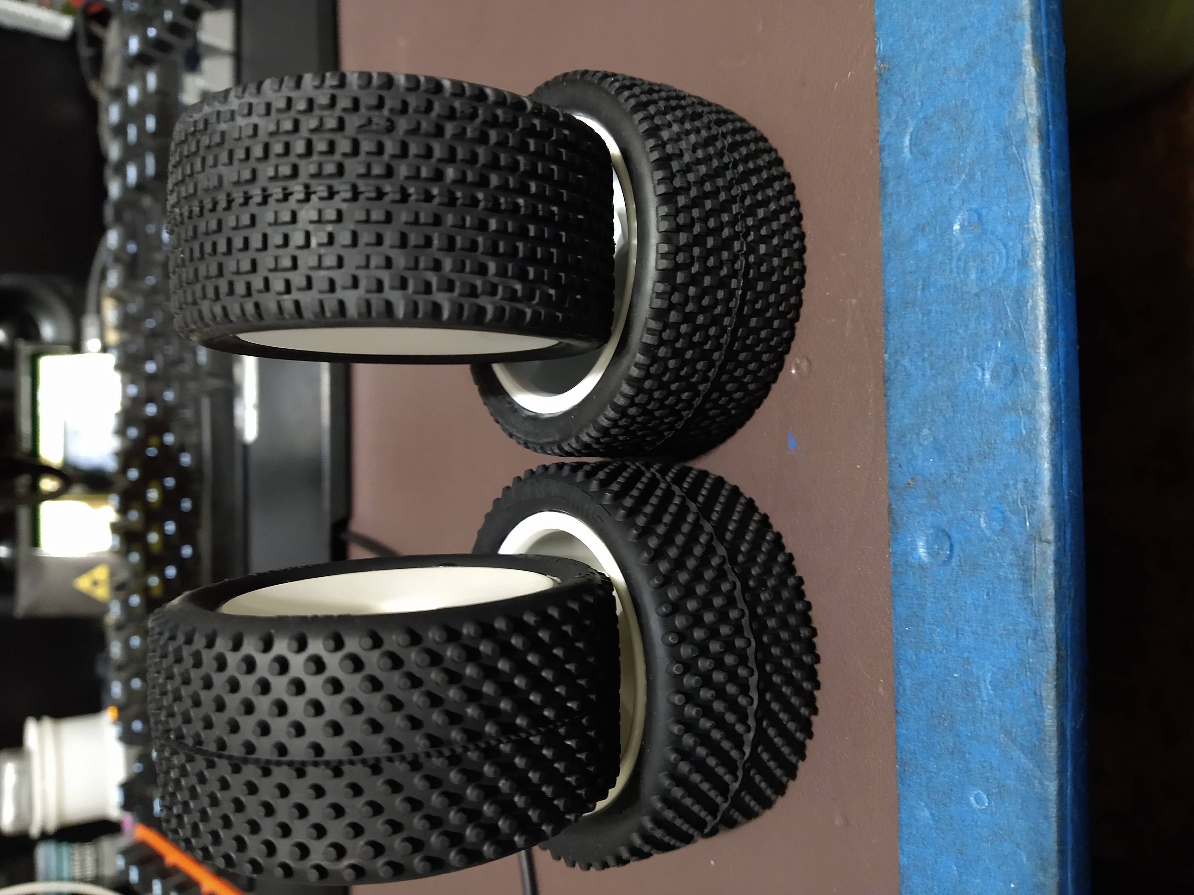

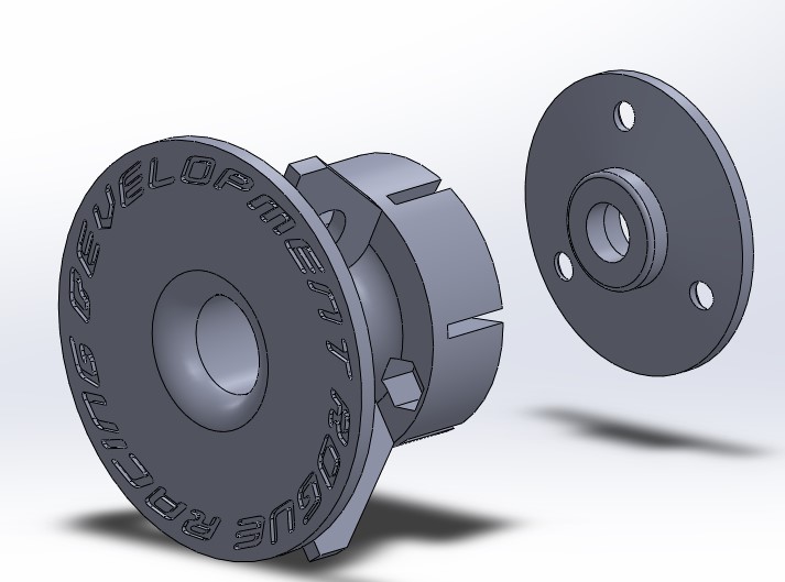

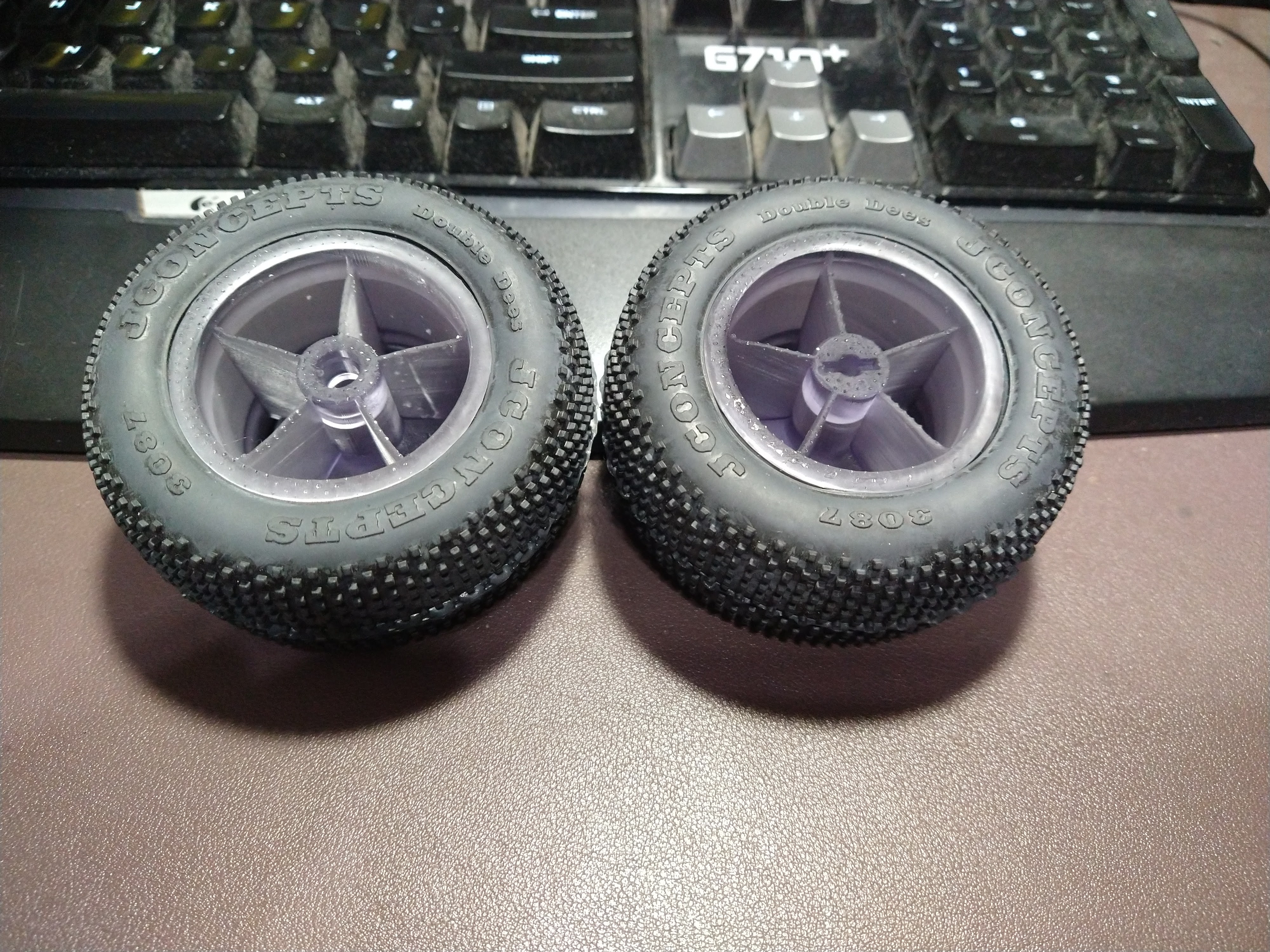

I decided to scale down and adjust the offset of the wheel design I originally made for my XXX-NT electric conversion for the Mini JRXT
These are the stock size I have a model made to properly fit these tires as well but haven't printed it yet.
Also have one to fit standard front 2.2 buggy tires as well but not sure how goofy that'll look. I need to get ahold a pair of LC Racing BHC-1 wheels to get measurements as those would be a pretty good size tire to use.
This a frustrating size truck to get tires for.

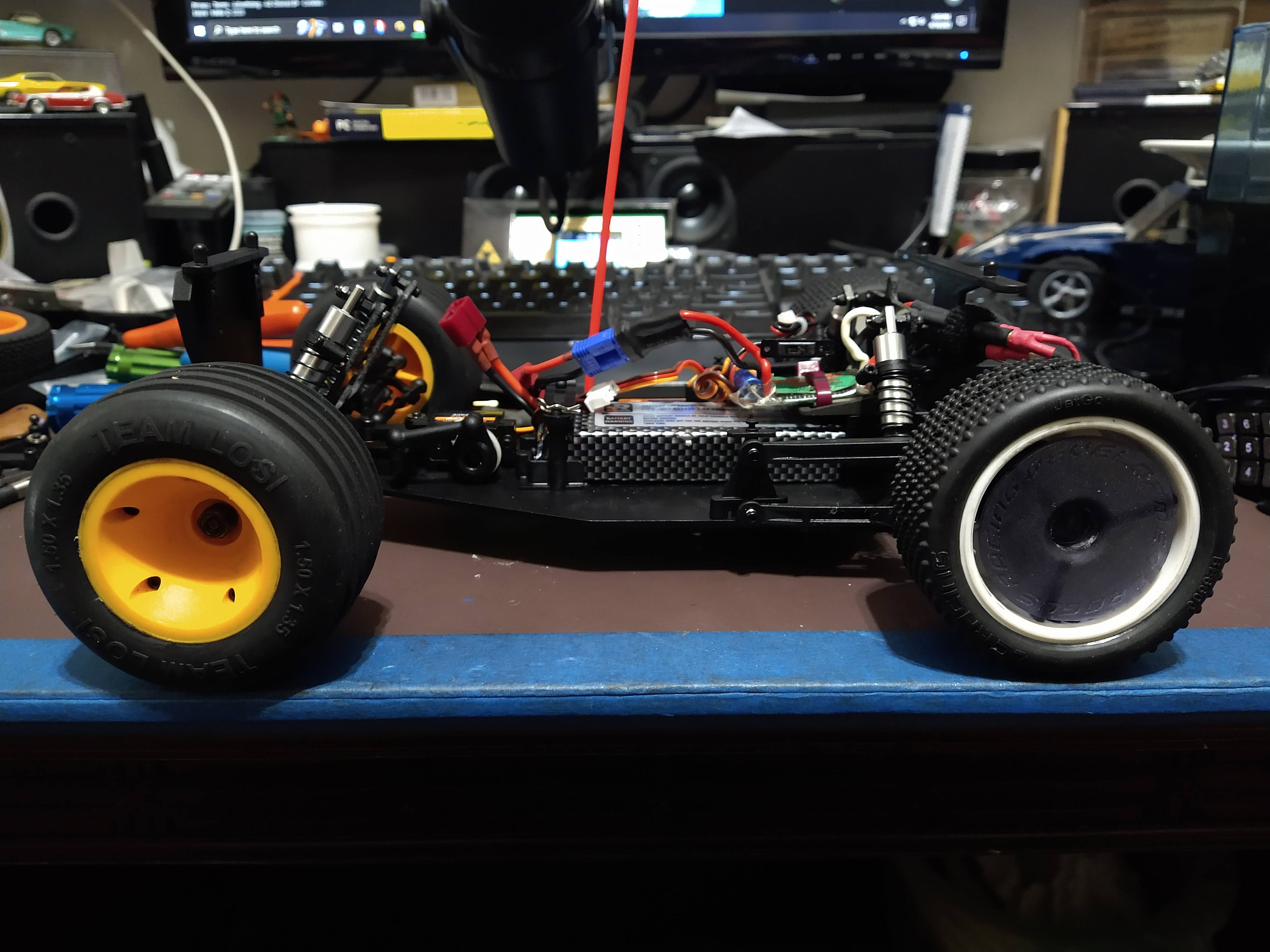

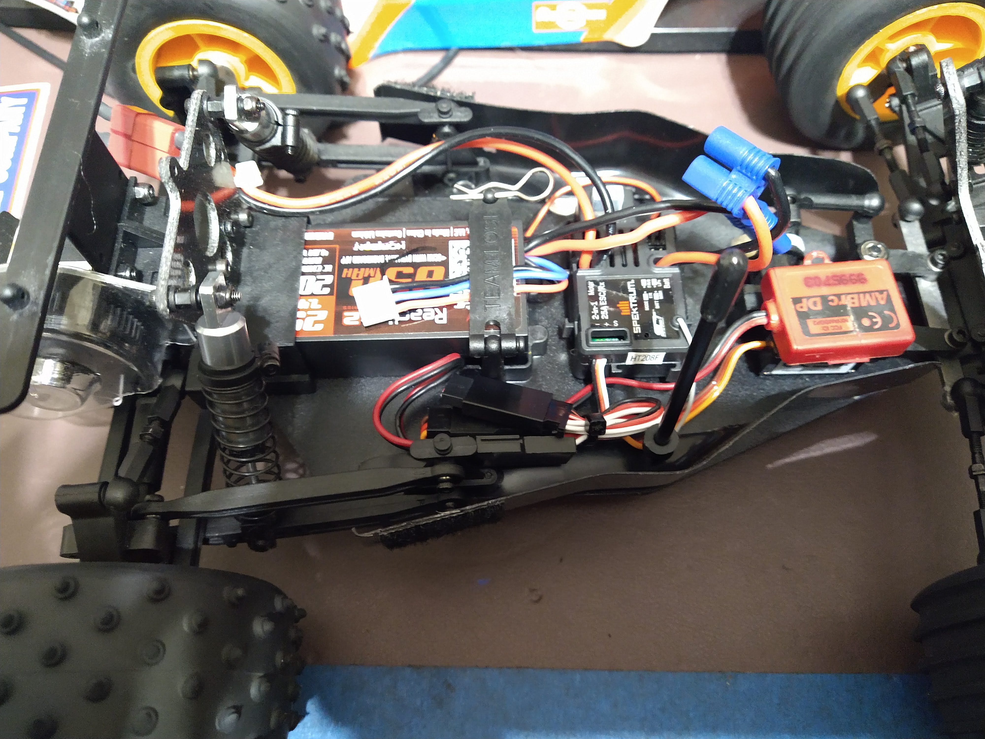

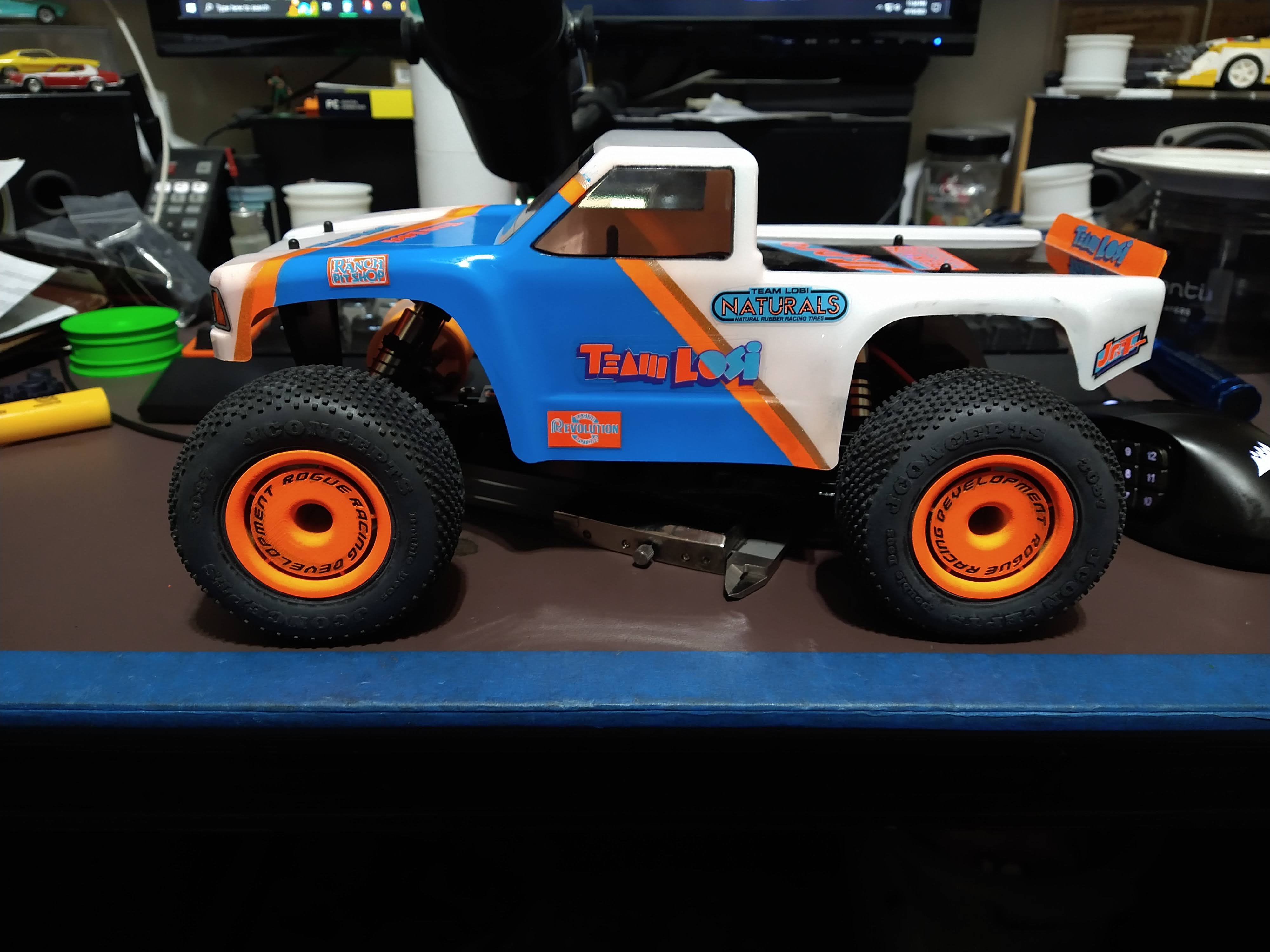

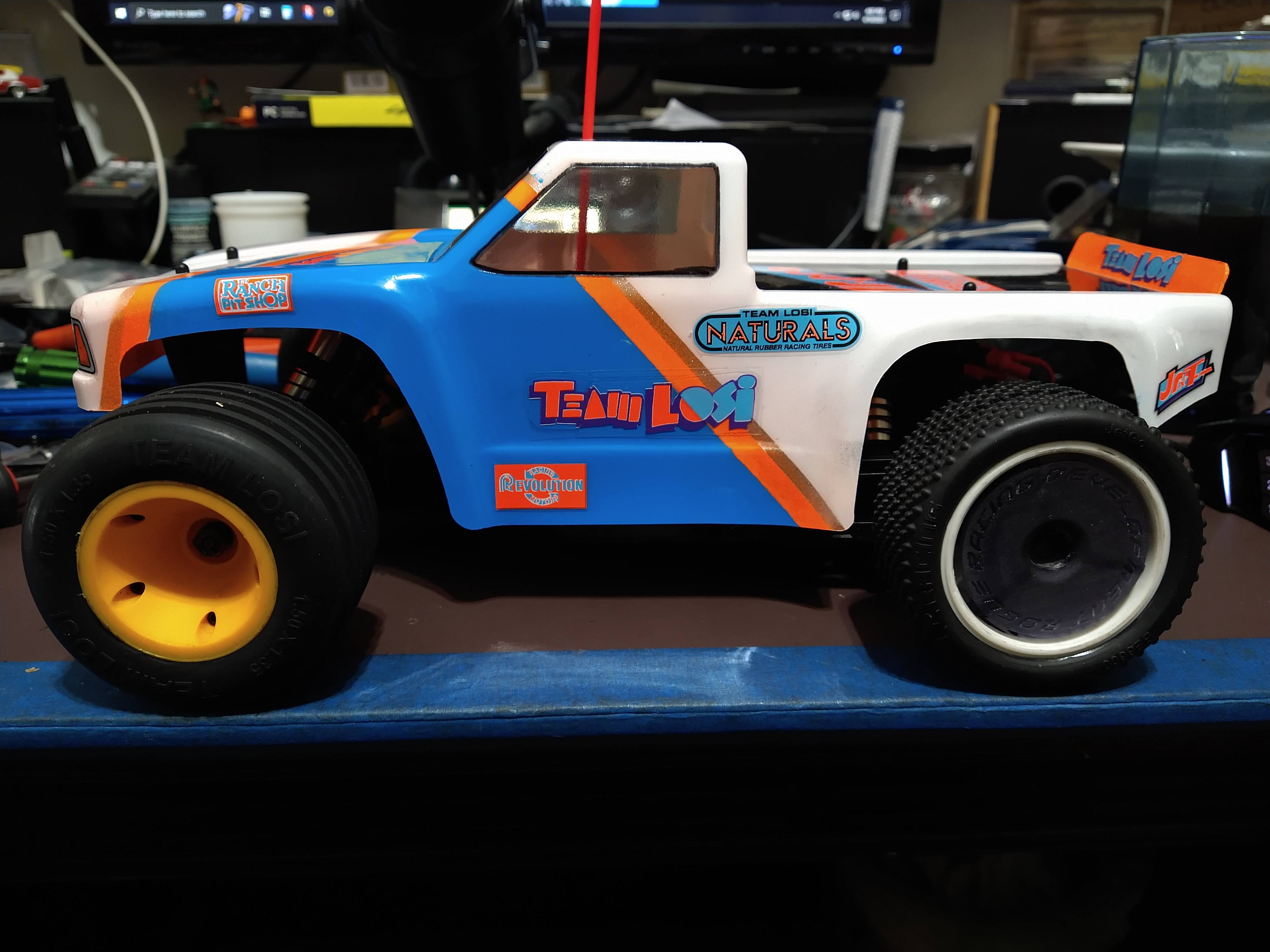

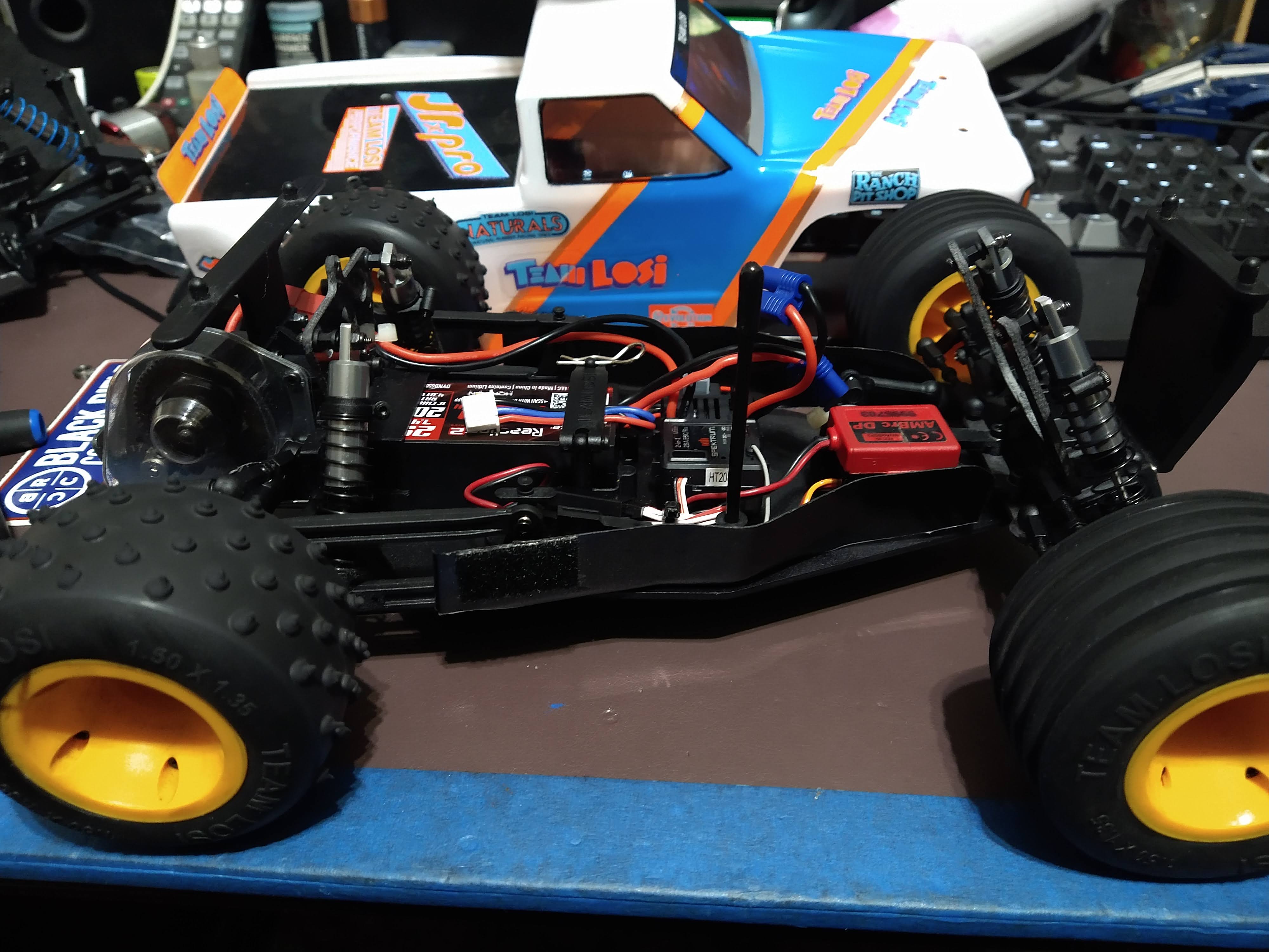

So a few updates on my madness with these minis. I decided to finally take apart the 2nd JRXT and make it into a mod version.
Moved the battery hold down 44mm forward and fitted a larger battery that was out of my Rlaarlo AM-X12. This actually looks more scale. Tossed in my old Mamba 25 setup. Might change it later but I feel this chassis is stable enough to handle it. Also went though the front end as per usual and got rid of the slop. Rebuilt the transmission, replaced the motor plate with a non serialized JRX2 one. Diff grease I'm using a new type of grease that I've found and it's been working well on my other minis. Using some Nye Nyogel 767A which is a motion control grease but seems to work well in these little gear diffs. I also drilled and tapped another screw to the rear of the motor plate to hopefully decrease the chance of it getting bent to the side if it takes a hit.

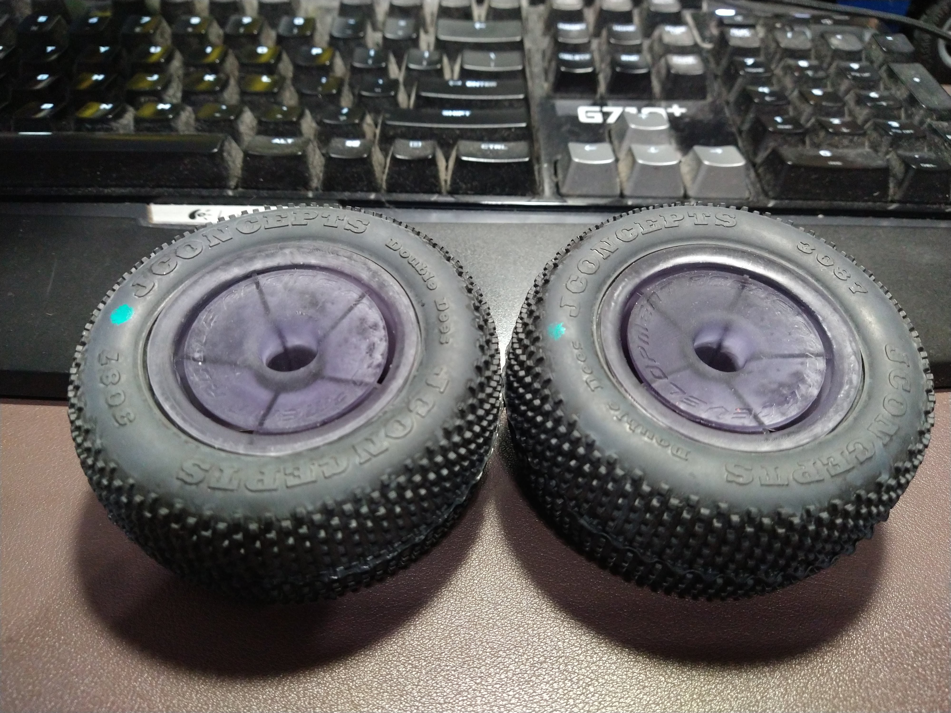

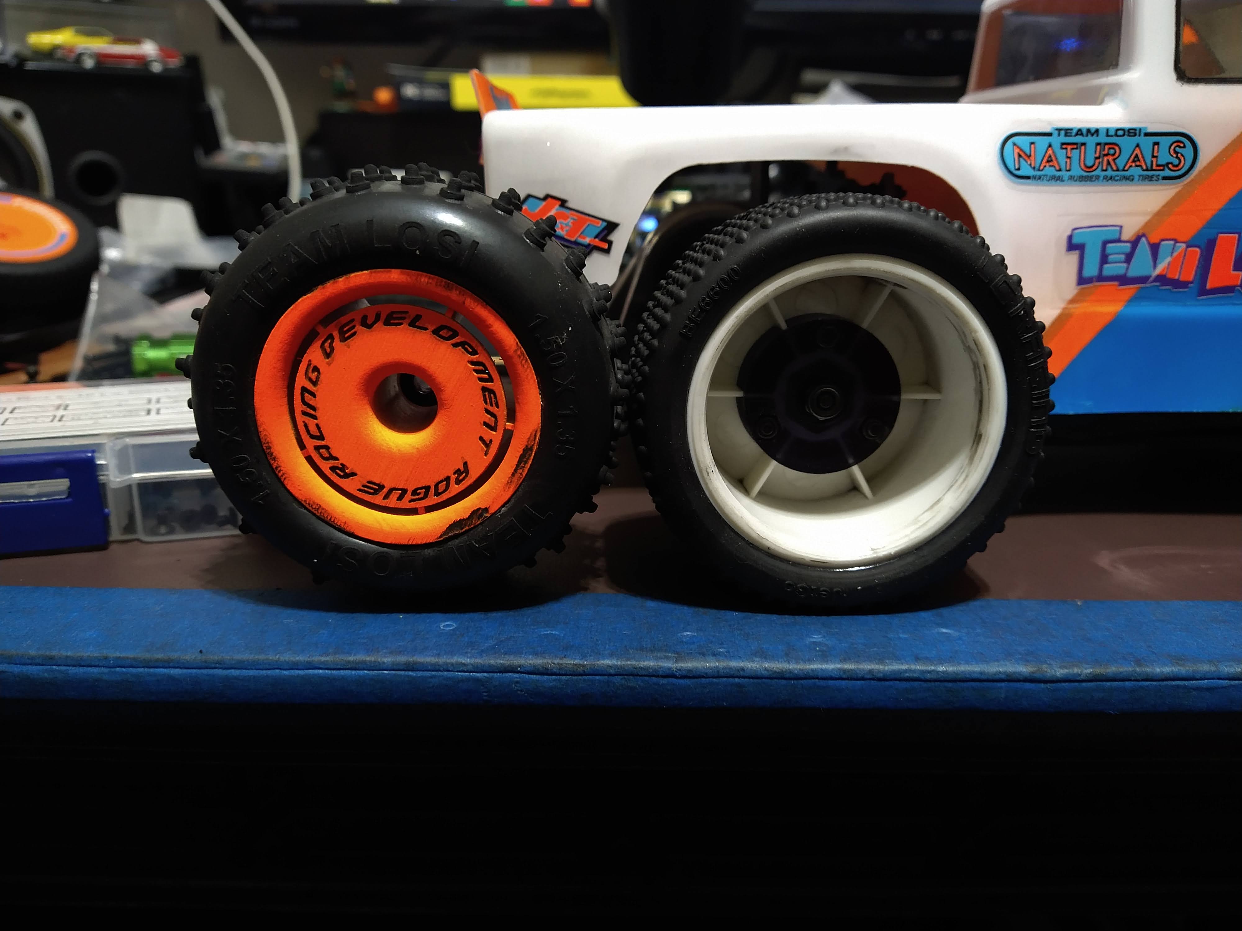

I printed out the 1/7" version of my wheels so I can run JC Double Dees if I run on dirt. But also I decided to try something a bit different. LC Racing came out with a 1/14 scale buggy, the BHC-1. It's tires are roughly the same outside diameter and width of the Mini JRXT tires and are of a firmer compound and more suited to carpet. There are basically wider Touring car wheels with mini spike tires. These are also the same size and wheel many other chinese mini buggies use, like the WLToys and Rlaarlo. could be a good source of cheap tires rather than eating up the cool Losi step pins which seem to be on backorder everywhere.

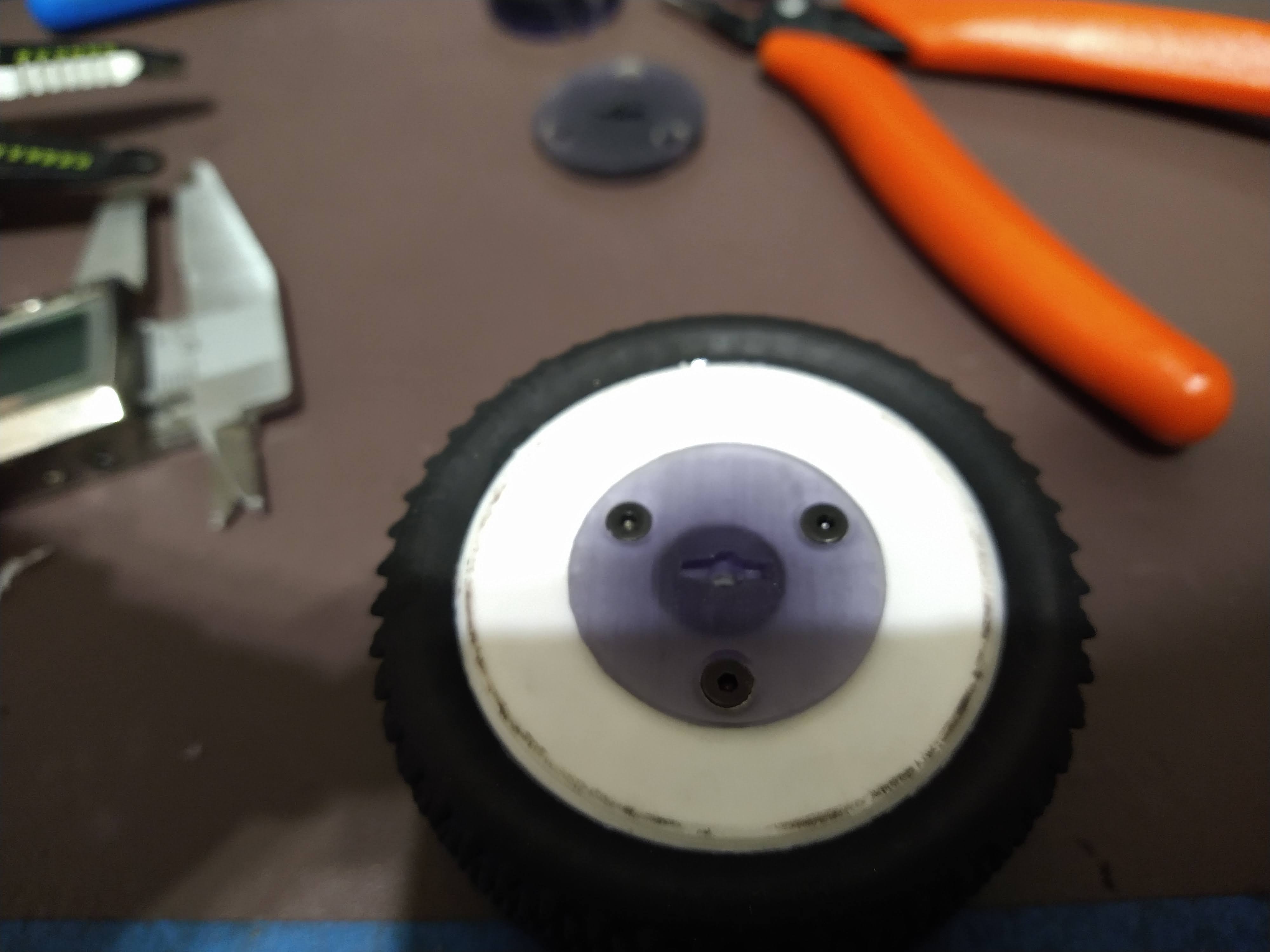

Rather than making new wheels to fit these tires which would require me debead them, I took a different approach. The JRXT has very little backspacing of about 4mm, normal hex adapters are out of the question for modern wheels.
So I made adapters to reverse mount them, keeping the backspacing close to stock. It's a 2 piece hub. I use this bare hub as a drill guide to drill 3 holes into the wheel for the 3x m2.5 screws to go through the back plate into the front plate's 3 captured nuts. I decided to make the front plate with a face similar to my other wheel design. The result is pretty cool, and might look better if I paint it. I also have a set for fronts but I need to fix some printing calibration issues as it was printing the bearing areas oval.
I'll try to swing by the track to give the rears a test and maybe even the Doublee Dees setup too since they've made a small dirt course out behind the big track at my LHS.

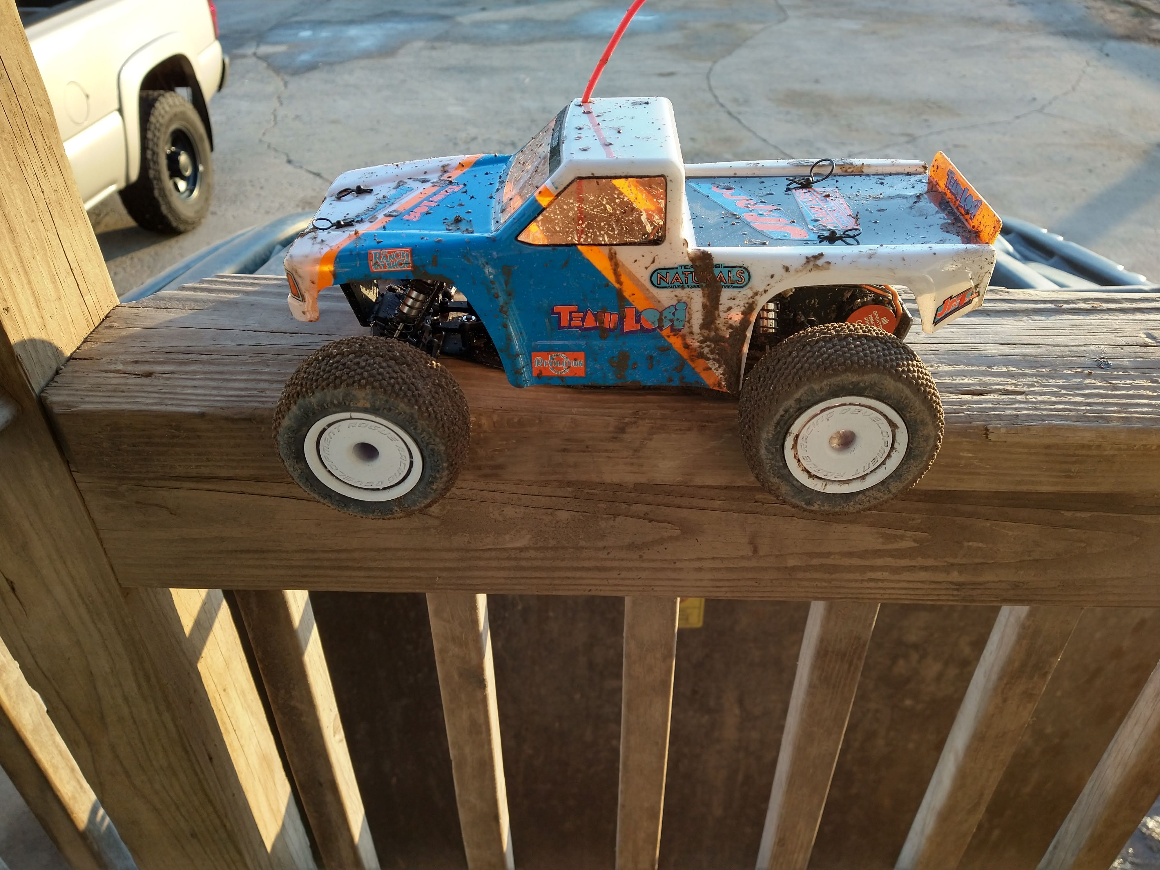

Test Day!
Truck side: I ended up ditching the Mamba 25 system and bought a Spektrum 2in1. The mamba had the same cogging issues as before, I thought it would be tolerable with this bigger truck but nah. Spektrum system works well though.
Wheels/tires:
Went well. The LC Jetgo rears grip well on the grey carpet and there wasn't any issue with the adapters other than I need to make the hole the nut goes down into a bit larger some the drivers don't rub on the wheel when I go to tighten or loosen the wheel nuts. I'm debating on making the decorative part seperate to improve printing. The stuck fronts grip almost too well though and can get a bit tippy on tight corners. Definitely have to run glue on the sidewalls.
Also found out that LC has another tire that looks a lot like a JC Swagger in the same size so I'll be trying those out front, sadly they aren't wedged like the Swagger but I'll see how they do. Couldn't try it on the Turf track as it was too wet. I did, however, try the Double Dees with my conversion wheel on some flat dirt. Super fun! Traction was great was able to even pull wheelies. I didn't really get to take it off any dirt jumps though as there was too much water around them and the one jump that wasn't is made to send Bashers into the stratosphere which I don't really want to subject this too. So far it seems pretty successful. I do thing I'll add more and ticker webbing on the wheels though to keep the wheels from deforming.
Truck looks proper.
Now I have to clean this.
Wheels/tires:
Truck looks proper.

So finally got around to posting up one of my projects, wheel adapters to put the more plentiful and easier to find LC Racing wheels onto the Mini JRXT.

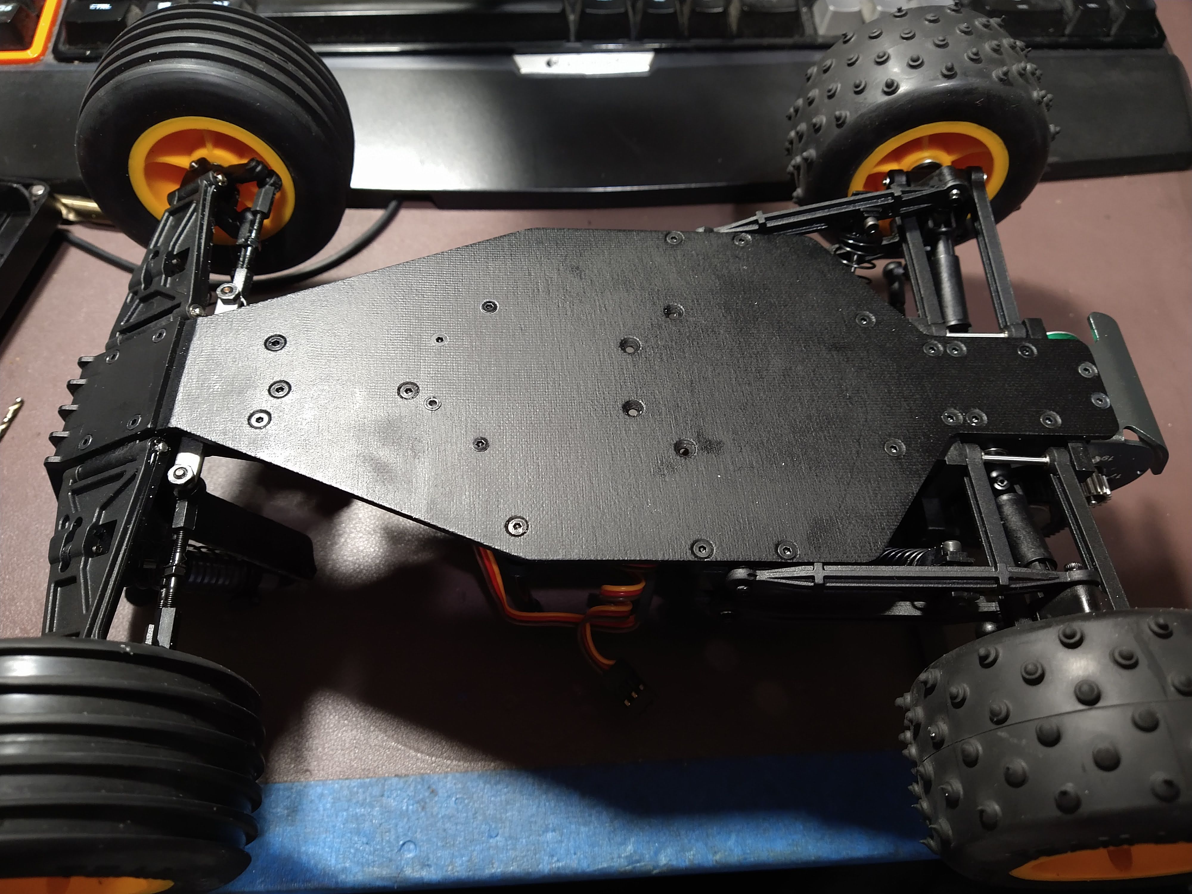

2157 just arrived, time to get to work. lol
I am amazed I got so close on the dimensions, the chassis is almost perfectly right right length but the flat sides are a bit longer that what I ended up with. This could be my error or it could be the designers that shrunk the design for the mini jrxt adjusted the original shape for their needs.
