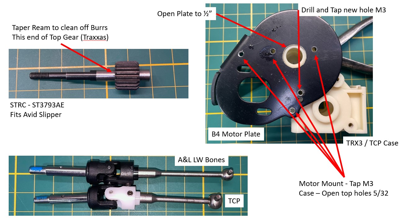

I will just add this here for what I did.

why the a&l axles? They look quite a bit longer: don’t they bind up in the diff outdrives?

Yes they are too long. I need to machine them down.

Those appear to be our bones for the lethal weapon conversion not the standard bone conversion. Pretty bad example as it makes it look like our parts are wrong when they have been used for years and inspired the Traxxas parts

When I ordered I thought all you had was the lethal weapon bones left? If you have Trx1 bones I can just order those.
“The bones for a standard TRX-1 are gone, but we do have some left for the lethal weapon conversions (slightly longer). ”. This was at the end of January.
At least at the time that is what I was told.

Correct, the TRX1 bones are gone.
However you are representing the lethal weapon bones as the ones we sold for trx1 though, and that is very misleading. It would be like complaining that you had to buy a 4 door car because there were no 2 door models left on the car lot and for some reason the car has a longer wheelbase. Yeah, the bones are too long because they are for a different application, not because they were made wrong or sold as the right ones

Sorry I was not clear. I will edit my picture.
I have never seen A&L trx1 bones, not even ran across them on eBay. Regardless my only option is to machine the bones down from the LW and this looks like it would be most people’s best option for a build unless someone chimes in on some other option. And this is exactly what I am doing getting what is available and making it work for me and I am not complaining about it.
Picture updated
Picture updated
