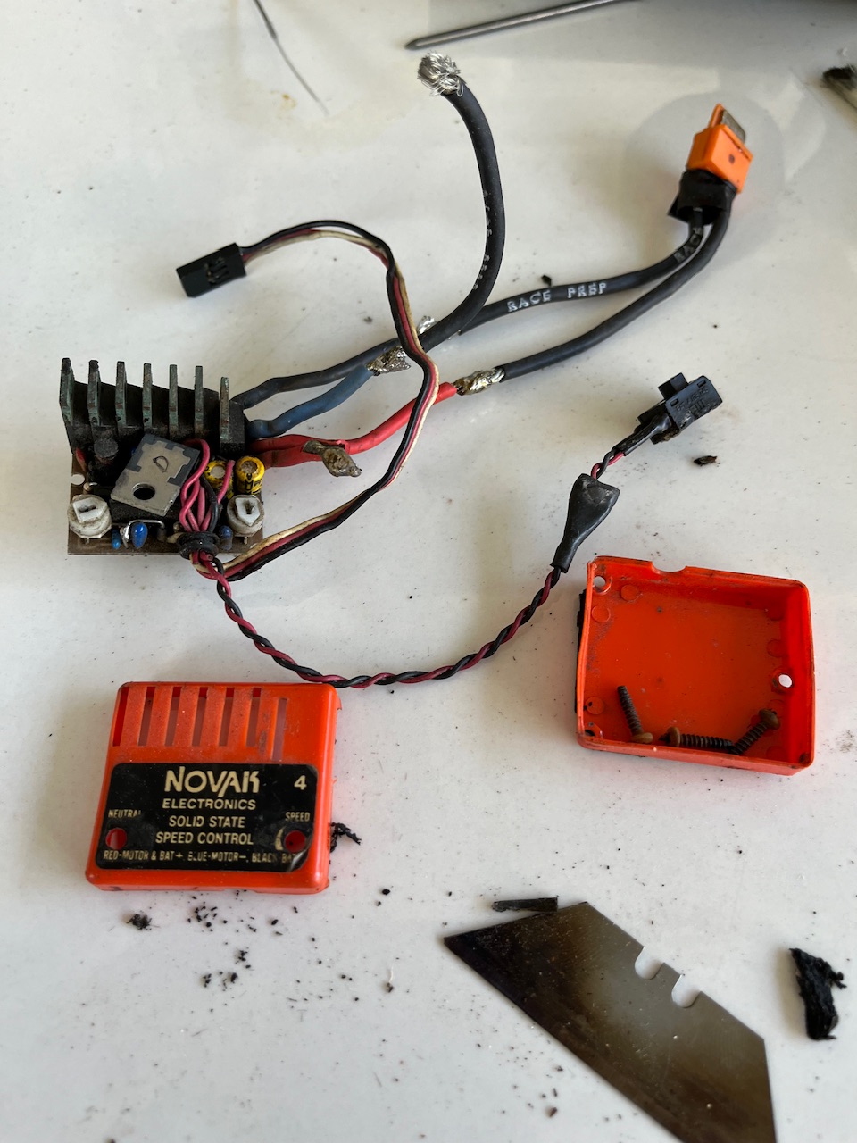

Hello all,
For my 6 gear build I picked up 2 Novak 4s with the idea of making 1 that works.
I only have basic soldering experience.
What tools should I look into getting? What would be helpful.
I was going to get an soldering iron https://pine64.com/product/pinecil-smart-mini-portable-soldering-iron/
Is there a schematic for the nec4?
I was hoping to just order up parts in advance, such as like FETs, resistors and capacitors.
How transferable are FETs if I replace all of the FETs with the same kind could I use a different replacement part ?
I'm not looking to improve the performance, I just want chance to have a reliably functioning unit for stock motors.
I did a quick look and see 2 Fets that seem appropriate for a NESC4. Would the FETS from a T4 be a possible replacement as well?
Look at this thread https://www.rc10talk.com/viewtopic.php?t=48211
It seems that FETS that can work
BUZ11 it is for a Novak 1 Can that work in a 4 without modification.
if it is something else BUZ71 or BUZ10(discontinued with no stock)

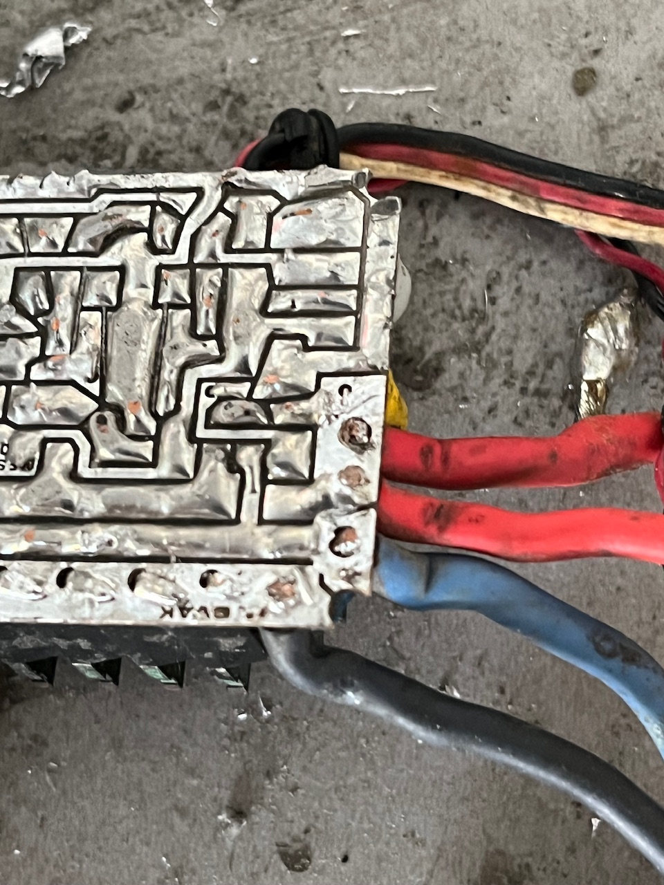

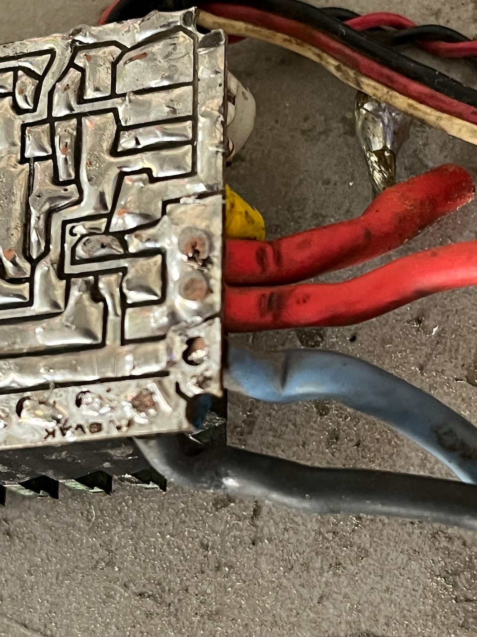

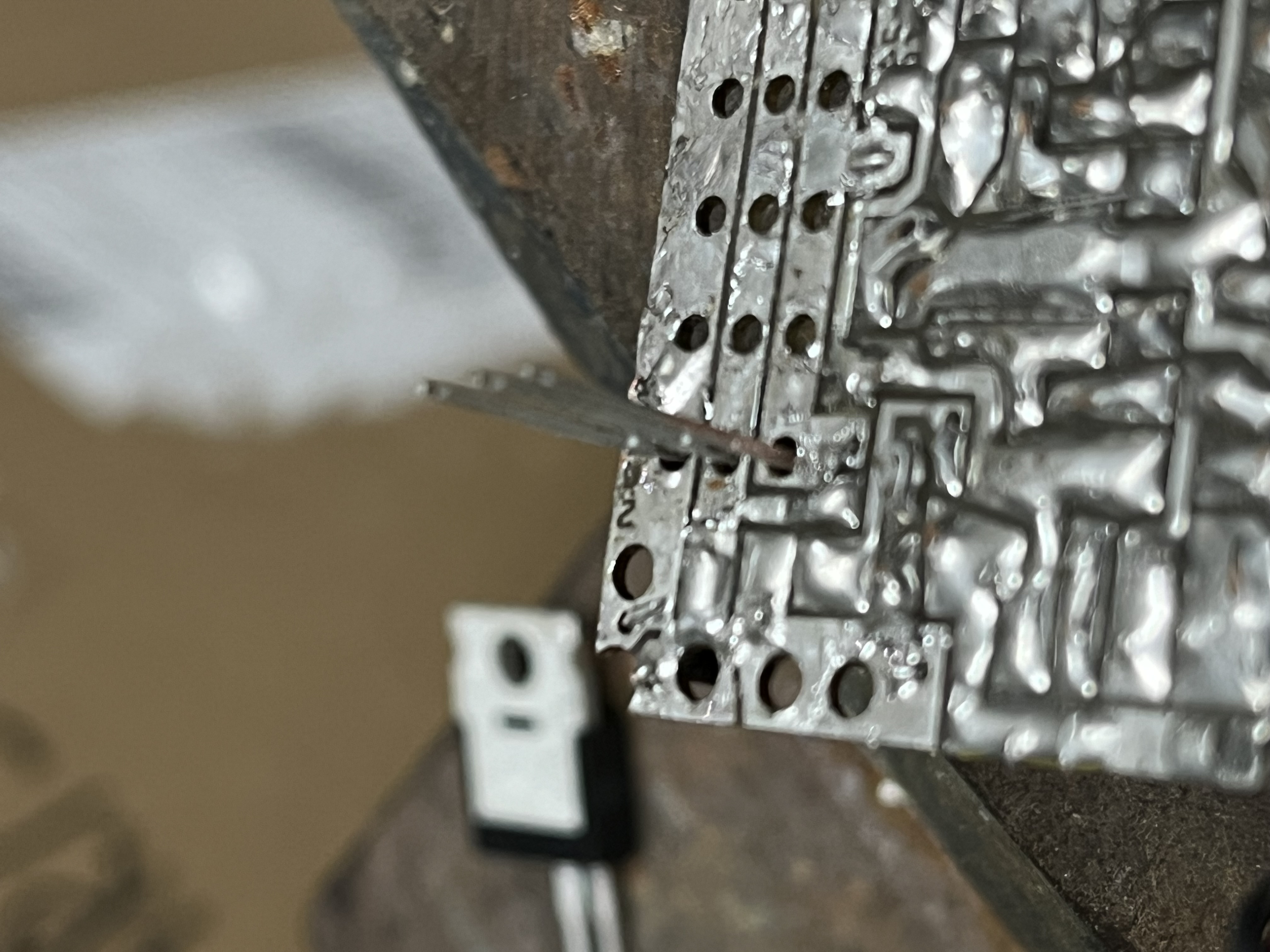

Finally getting around to trying this. I also picked up a 3rd Novak 4.
I stated with one with showed vary little signs of life.
I have buz-11a fets on order from china.
The wire is thinner than any I have around. It seems to be sightly bigger than 1/16" . It looks like that would be 14gauge wire.
The solder sucker is a great tool to have for rc. I started out cleaning up blobs of solder on motor that came in lots.
The tabs are folder over on the board and that is making it hard for me to pull off the fets. I got one out. I think I may be able to replace the fets but the middle of the board is a jumble to my eyes.

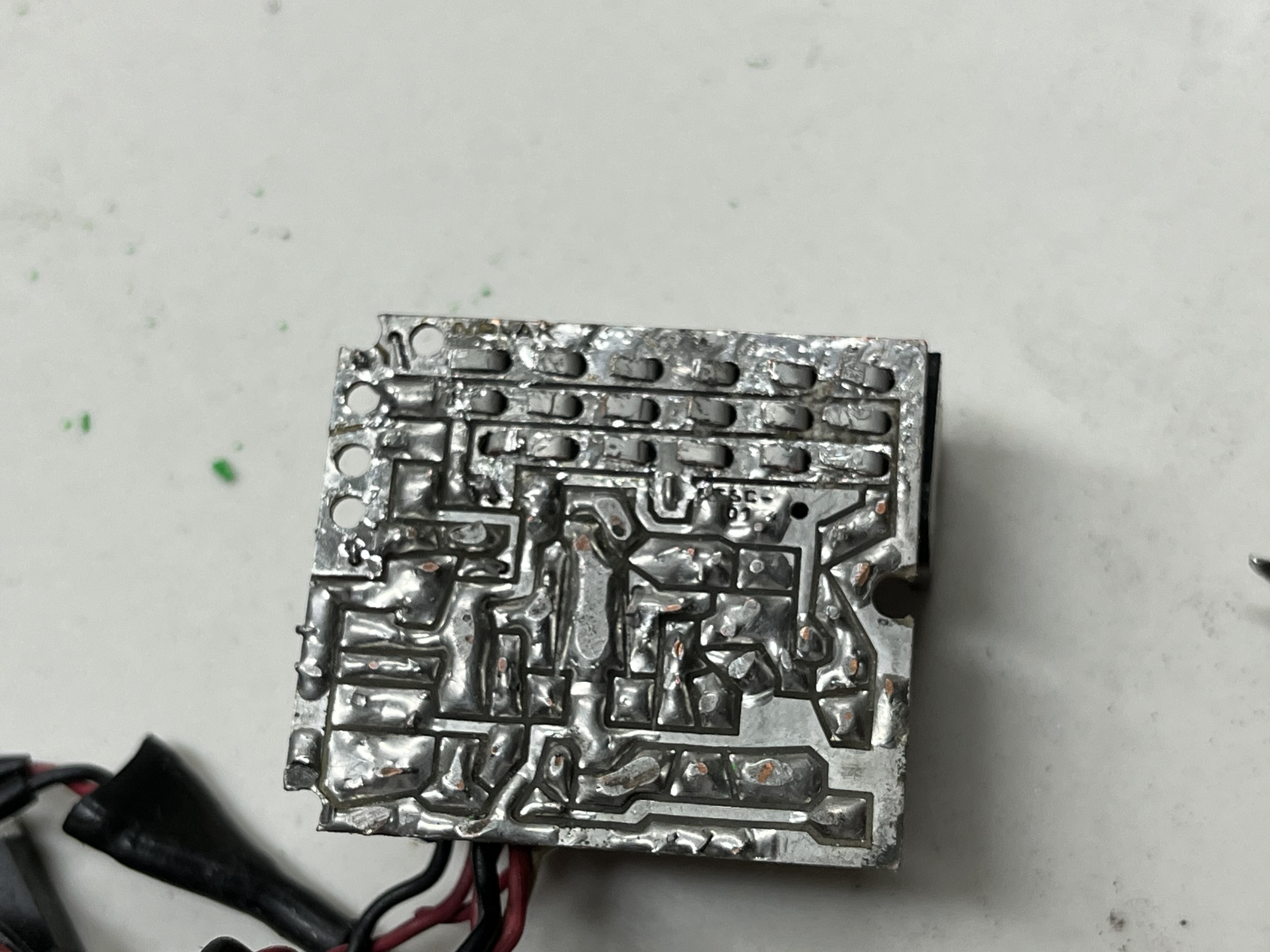

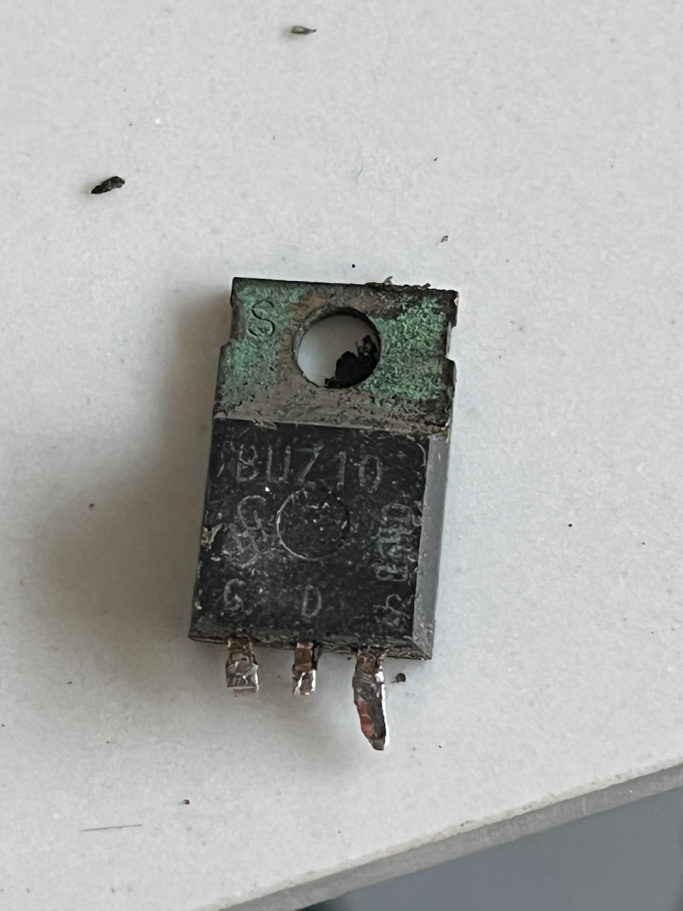

- Posts: 1874
- Has thanked: 1243 times
- Been thanked: 639 times
Re: Repairing Novak 4 esc _ what tools and what parts?
My desoldering ribbon arrived today and I removed the remaining fets. I tore one of the traces but fortunately at the end of the row.
I’m not exactly sure what I’m doing but I tested all the fets that come off with a dmm diode test
They all measured around the same forward voltage of 5.0 expect for one that measured 2.2. I hope that was what was causing problems for the esc.

So the replacement fets showed up last night. Compared to what I took out they behave quite differently so there is some hope that this can fix the esc.
One problem is that the leads on the new fets are the wrong size The width increases as it get closer to the body. The original ones were a snug fit to the board.
Did I get the wrong package? Is there a way to spec parts with the same width lead from top to bottom?
The leads bent over after being mounted to the circut traces. I think the wider leads could cause shorts.
- Posts: 1290
- Has thanked: 1782 times
- Been thanked: 859 times
I did a cross reference and yours are correct- BUZ11 replaces BUZ10A.
I don't think the leads will be a problem if installed with the correct amount of solder. It won't short unless the solder is globbed on. Before installing the case and applying power, measure for a short between the pins to verify they are not shorted. If you are saying they get "wider sooner", you could very carefully trim them down to size. Or you could put a couple for very small bends in the leads so they rest at the proper height to be level with the others. Honestly, though, I don't think they will be a problem if installed with the correct amount of solder. You can always remove and reapply the solder if you do get a short. If it does take multiple attempts, be sure to let the FETs cool between attempts.
Sorry if this is elementary stuff you already know.

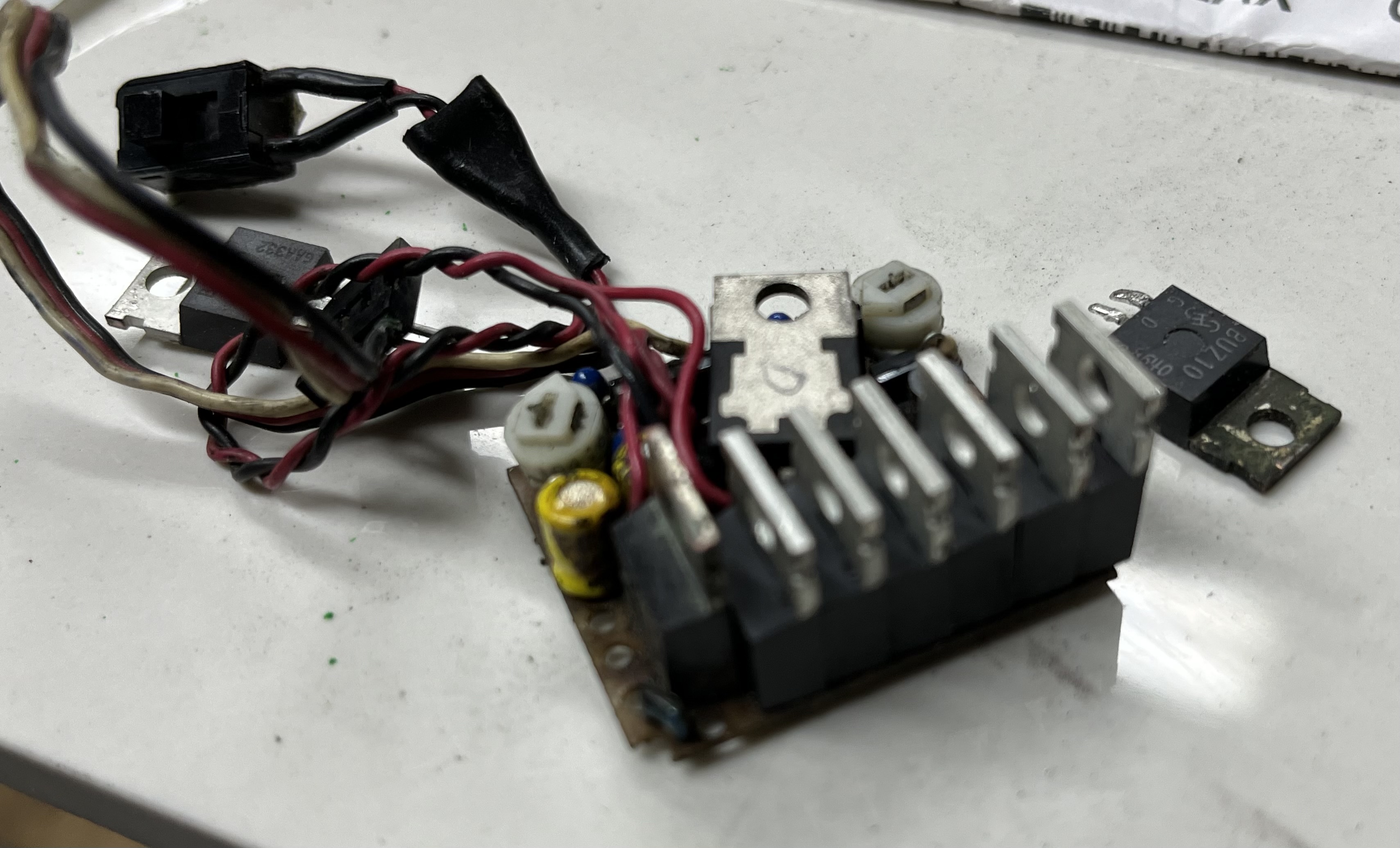

- Posts: 1874
My first attempt using a knife to shave the pin didn’t work
I used an Emory board to file down the legs and they fit easily Folded over the leads. Did the ground plane pins facing the wrong way. Some of the pins looked as if they would cause trouble, so I trimmed them a bit shorter.
It looks pretty good from the other side. I really need to replace that brake diode while I’m at it.
Thinking about using 16ga wire to make it easier to route the wires though the case
