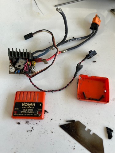

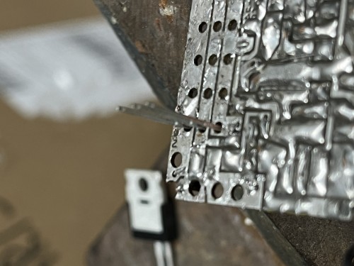

Finally getting around to trying this. I also picked up a 3rd Novak 4.
I stated with one with showed vary little signs of life.
I have buz-11a fets on order from china.
The wire is thinner than any I have around. It seems to be sightly bigger than 1/16" . It looks like that would be 14gauge wire.
The solder sucker is a great tool to have for rc. I started out cleaning up blobs of solder on motor that came in lots.

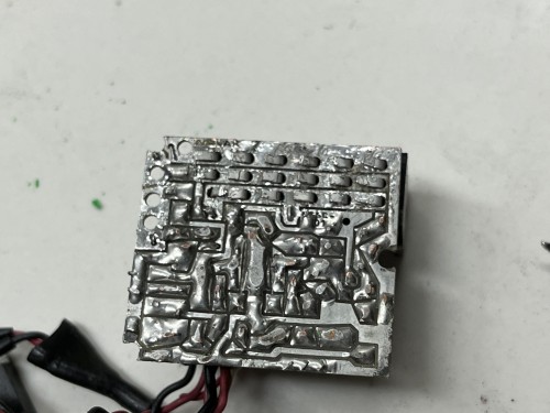

The tabs are folder over on the board and that is making it hard for me to pull off the fets. I got one out. I think I may be able to replace the fets but the middle of the board is a jumble to my eyes.

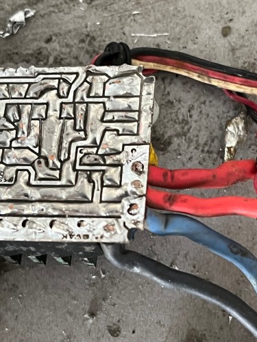

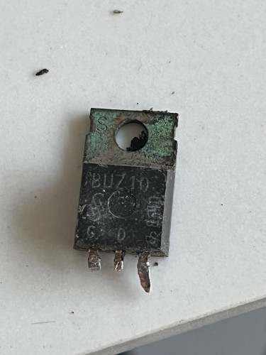

My desoldering ribbon arrived today and I removed the remaining fets. I tore one of the traces but fortunately at the end of the row.
I’m not exactly sure what I’m doing but I tested all the fets that come off with a dmm diode test
They all measured around the same forward voltage of 5.0 expect for one that measured 2.2. I hope that was what was causing problems for the esc.

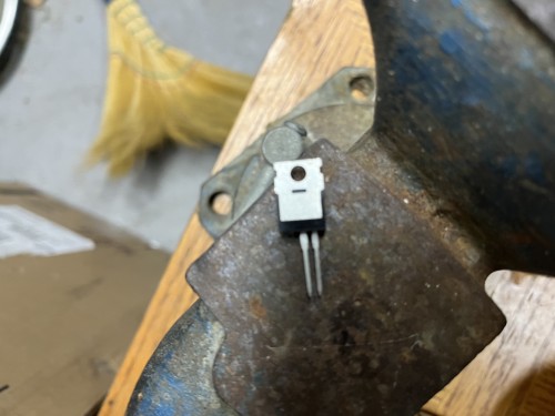

So the replacement fets showed up last night. Compared to what I took out they behave quite differently so there is some hope that this can fix the esc.
One problem is that the leads on the new fets are the wrong size
The width increases as it get closer to the body. The original ones were a snug fit to the board.
Did I get the wrong package? Is there a way to spec parts with the same width lead from top to bottom?
The leads bent over after being mounted to the circut traces. I think the wider leads could cause shorts.

I did a cross reference and yours are correct- BUZ11 replaces BUZ10A.
I don't think the leads will be a problem if installed with the correct amount of solder. It won't short unless the solder is globbed on. Before installing the case and applying power, measure for a short between the pins to verify they are not shorted. If you are saying they get "wider sooner", you could very carefully trim them down to size. Or you could put a couple for very small bends in the leads so they rest at the proper height to be level with the others. Honestly, though, I don't think they will be a problem if installed with the correct amount of solder. You can always remove and reapply the solder if you do get a short. If it does take multiple attempts, be sure to let the FETs cool between attempts.

1911Colt wrote: Wed May 15, 2024 1:47 pm Sorry if this is elementary stuff you already know.
I don't know much about any of this at all. Any help or notes are appreciated. Since the only challenge I have is with the width of the legs as it gets to base I guess I'll try and shave them down with a drywall knife.
Speaking of not knowing things. When I test the fets using the diode tester on my multimeter I can only test once before I have to short all of the leads. then I can retest. Does it matter if they are 'reset' or not when I install them?

You could also remove one of the other FETs and use it as a guide to trim the leads on the replacement. Make them a close match and put them back on the board to verify that the tops of the built in heatsinks are even.
The trick to soldering is to get the lead and the trace on the PCB ho enough to accept the sold. The solder should "flow" into the area around the lead on its own. If it drips in and forms a "ball", that means it wasn't hot enough to flow properly. Also, a good connection will be relatively shiny. If it looks gray and rough, it is a "cold" joint, which is another indication that the solder did not flow properly due to a lack of heat.
If you are near southern Indiana, swing by and I can help. :D I am not good at very many things, but I can solder pretty well thanks to my vocational school teacher and the US Air Force.

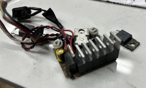

My first attempt using a knife to shave the pin didn’t work
I used an Emory board to file down the legs and they fit easily
Folded over the leads. Did the ground plane pins facing the wrong way. Some of the pins looked as if they would cause trouble, so I trimmed them a bit shorter.
It looks pretty good from the other side. I really need to replace that brake diode while I’m at it.
