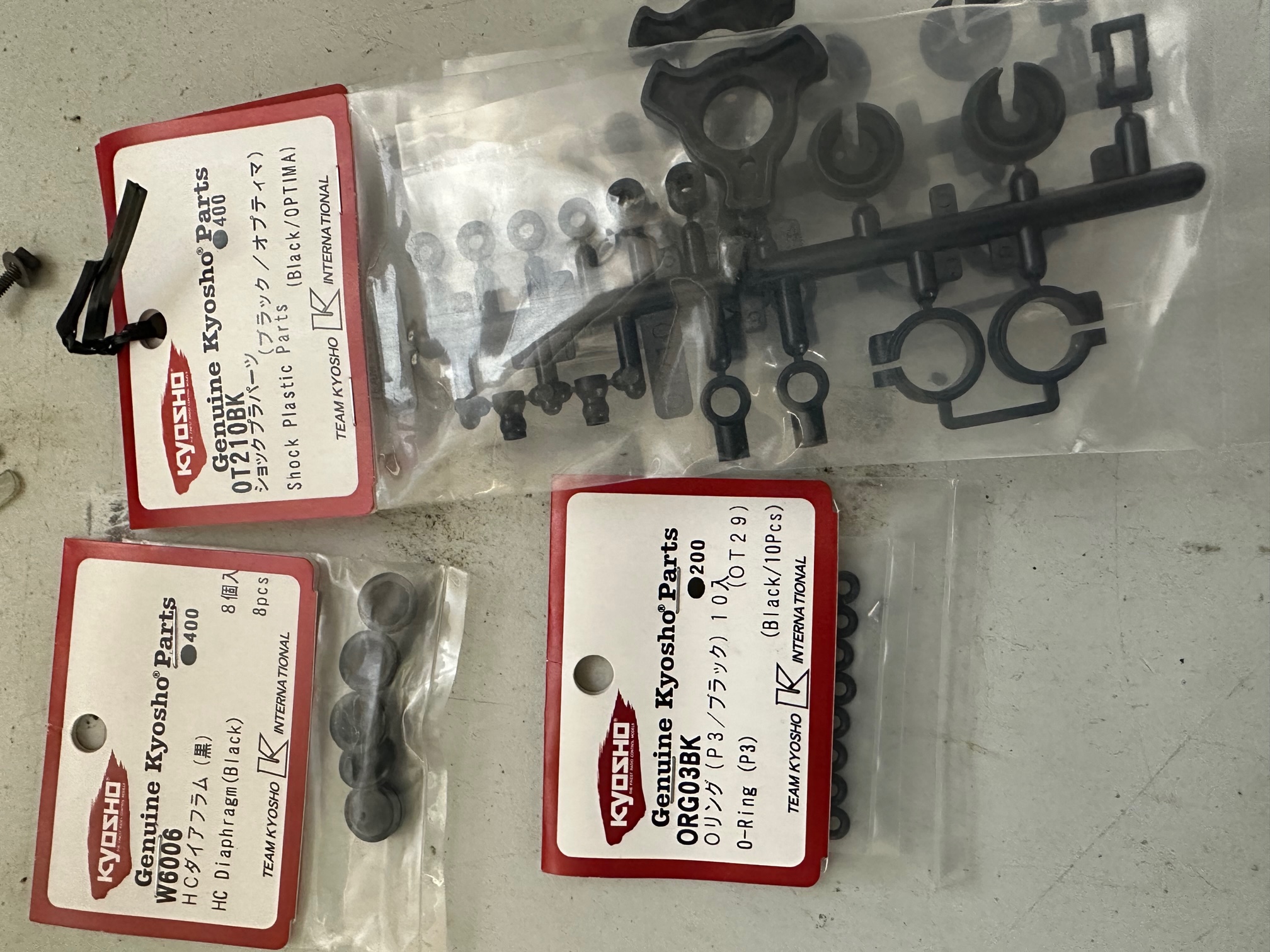

Re: Kyosho Gold Shock Parts? Where to Find New Ball Links and new Collars?
Yes the ot210bk work on the gold shocks
Ot210bk (bk for black)
Ot210r (R for red)
Replacement seals are org03bk
And diaphragms are w6006
At least that’s the part numbers I use to rebuild my golds
Ot210r (R for red)
