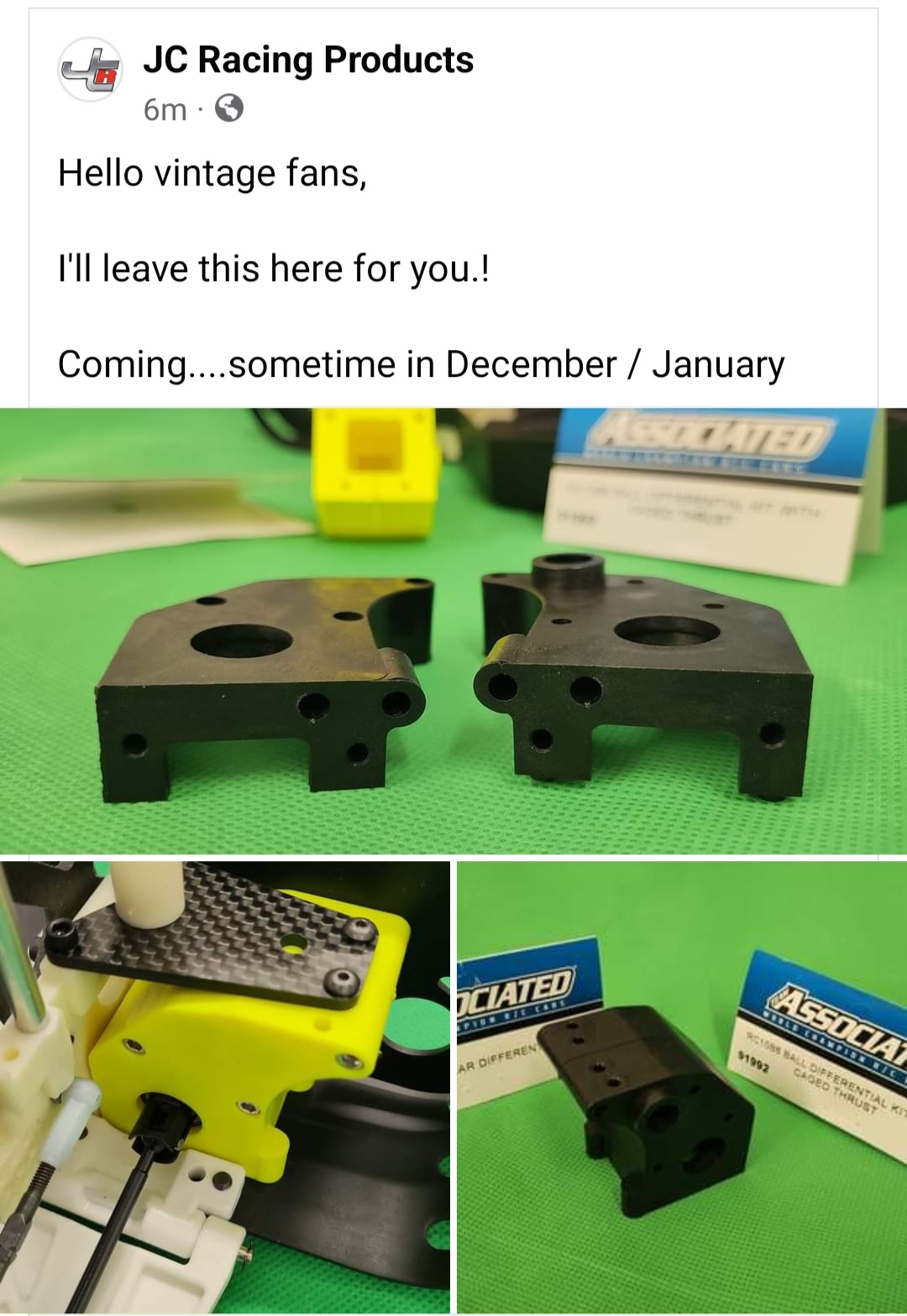

JC has molded the conversion box I created that uses a B6 ball or gear diff and a DR10/SR10/RB10 slipper. This case will allow the buyer to bolt it right into any RC10 as it has both stealth and 6 gear holes, and will fit either trans brace. Keep an eye on their website for these

I predict a lot of oldie RC10 and RC10T will be getting retrofits.

Hopefully they do yellow like in the picture to match the A&L steering

Yooo these are available now! Just ordered an ivory one! Ivory, white, black, yellow and blue available

here is a link to the page, they have listed all the required parts as well. https://www.jcracingproducts.co.uk/associated-rc10-transmission-case

Will the DR10 diff work in this case or only the b6? Which idler works?GoMachV wrote: ↑Wed Nov 15, 2023 1:28 pm JC has molded the conversion box I created that uses a B6 ball or gear diff and a DR10/SR10/RB10 slipper. This case will allow the buyer to bolt it right into any RC10 as it has both stealth and 6 gear holes, and will fit either trans brace. Keep an eye on their website for these![]()

The list on the website has all the part numbers but it's a 26t idler from the B6 series. You can use a dr10/rb10/sr10 diff but they are narrower so you will need about 1mm of shims per side. Unless you already have one it's more expensive to build so it's recommended to just use the B6 diff

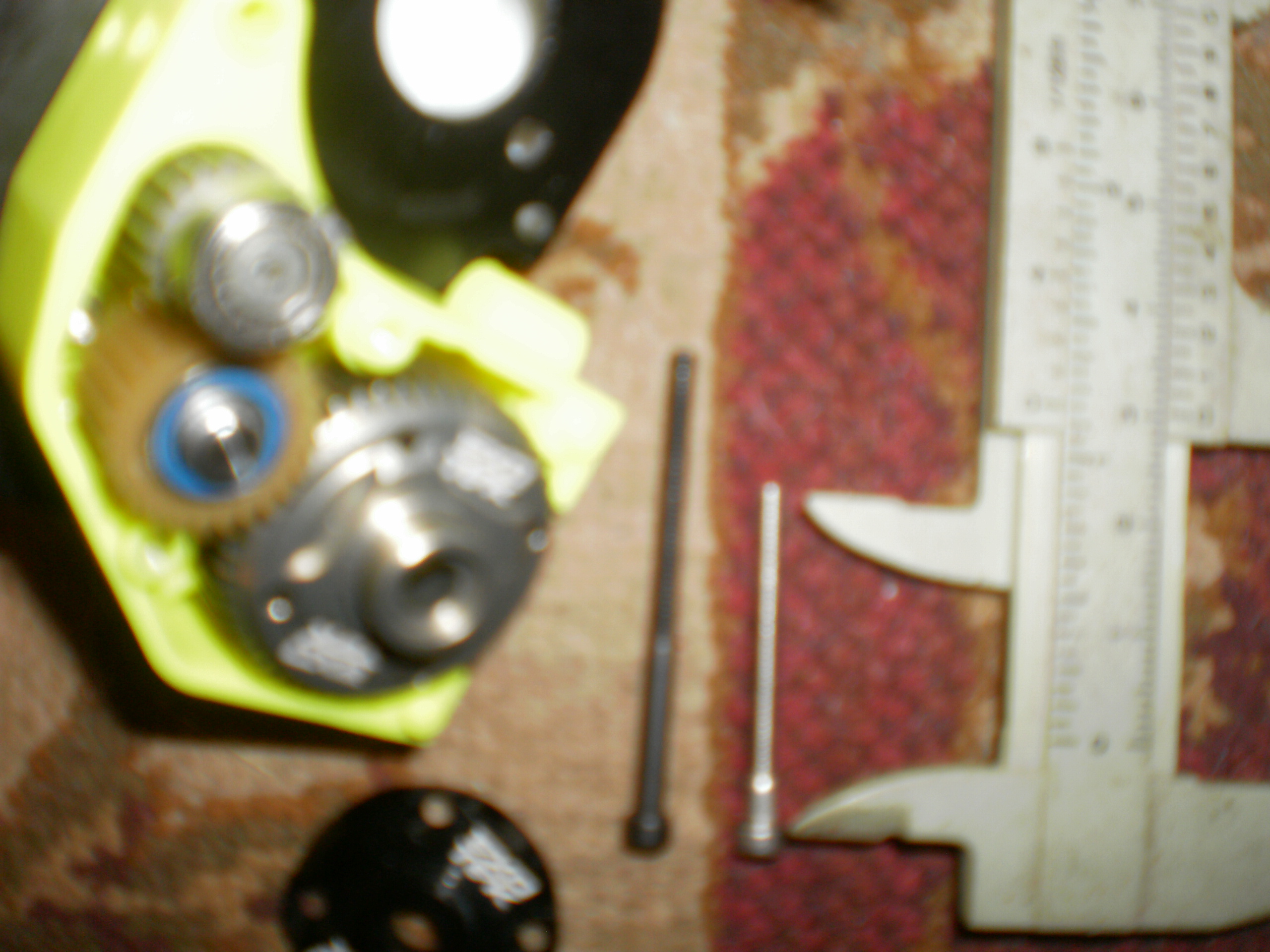

What is the length of the top case screw, the one that goes all the way through? I mistakenly assumed the stock screw would fit, but it is slightly too short. Kit screws fit everywhere else, though. Thanks!

Looks like 1 3/16" on my vernier, measured shank only, not the head. This leaves enough thread protruding (into the spur?) to fit a nut if necessary. The black screw in the pic is one I bought from Dubro and is 4/40. I'd just do that and cut it if you have all black screws.
