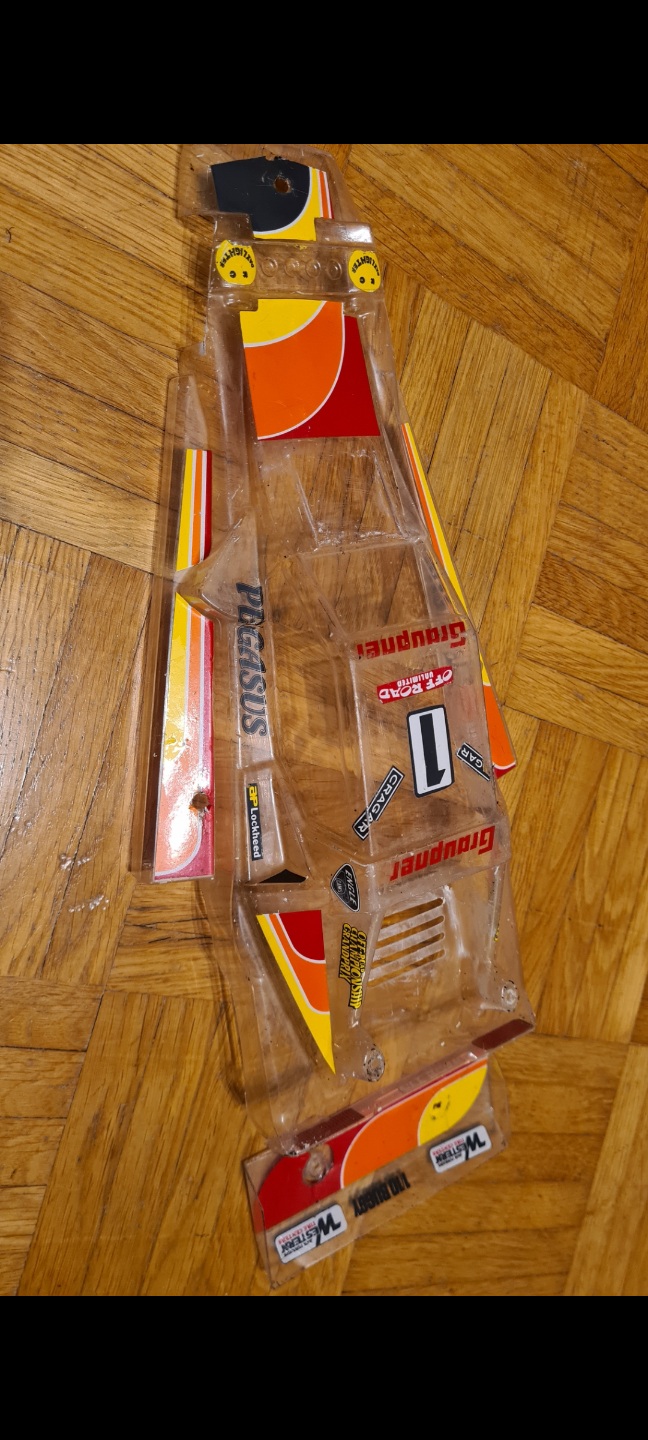

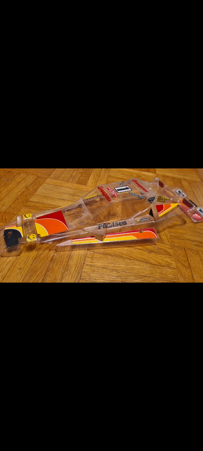

Not really sure if it was a Kyosho Pegasus or Cosmo which my neighbor had at the beginning of the 90s, but I remember it drove circles round my (already aged) ´79 Tamiya Roughrider (which I bought 2nd hand and lacking of available spareparts was in fragile condition..). So not that I ever admired this car, but interested how it´s built =) I shot one years ago for small bucks and forgot about it laying at the attic. Recently found it and hope it´s worth to restore:

SPA240WS wrote: Wed Dec 06, 2023 5:41 am Interesting! Thought Cox had the exclusive rights,like Graupner in Germany.
1st step:

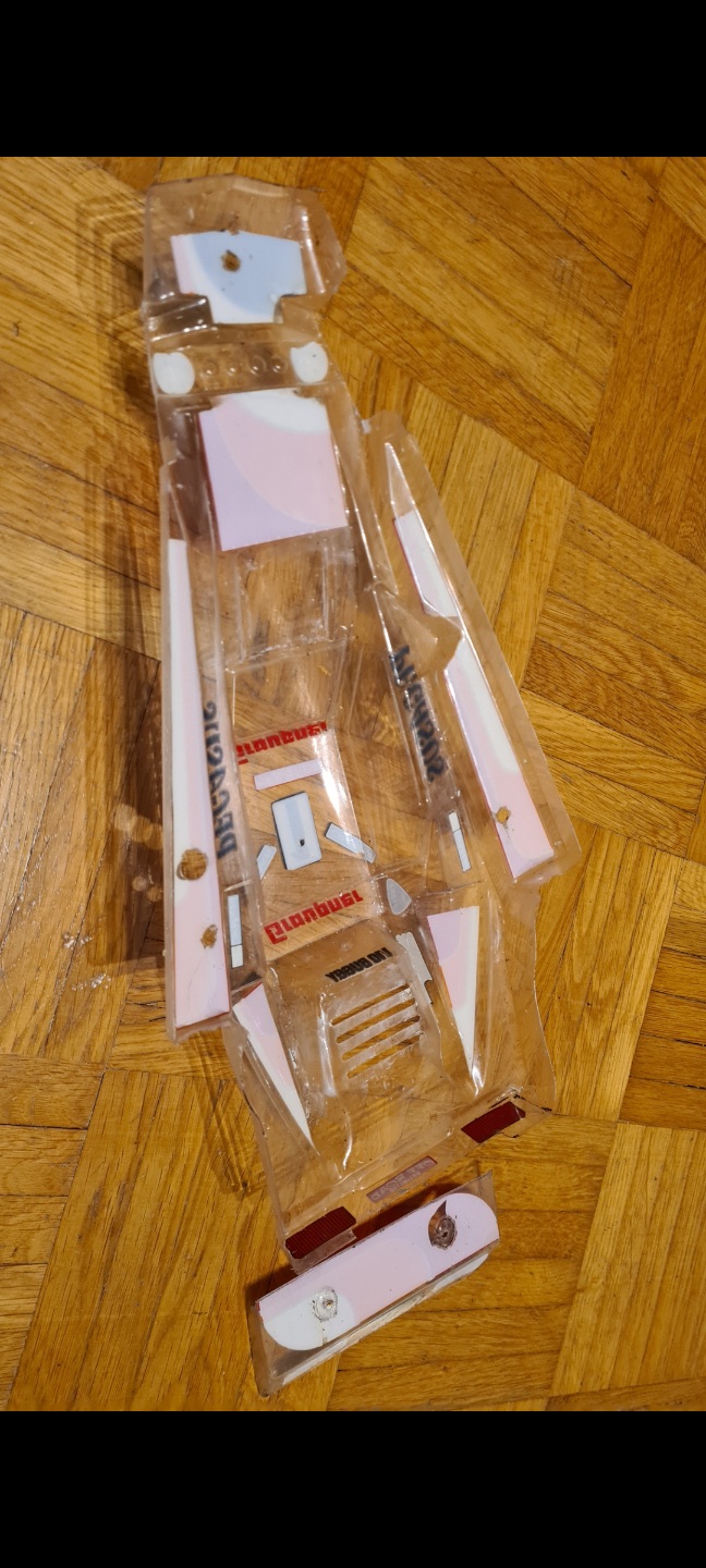

What are you using on the body? I have 1 I need to restore as well, would rather try and recover the original body if possible
If it's Old Skool, It's Kool
SPA240WS
Posts: 49
Joined: Wed Oct 18, 2023 4:10 am
Location: Germany
Has thanked: 20 times
Been thanked: 39 times
Re: Kyosho Pegasus - the Rough Rider contender
Post by SPA240WS »
Made good experience with Dowanol PM to "rescue" the old original body. A small amount on an old cloth and overnight in a plastic bag. Then just peel it off. The decals survived bit I already plotted a sheet of new and will replace the worn-out ones.

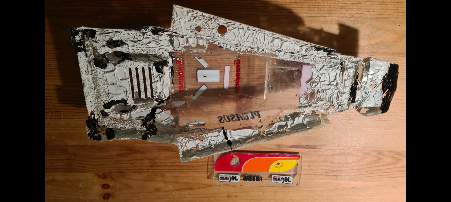

Driver got some paint + windows masking

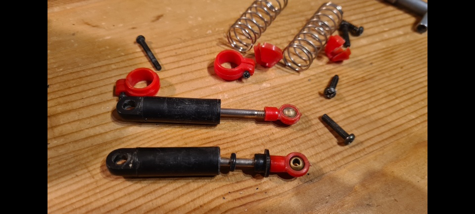

Found an original Mabuchi Motor (black plastic backplate), and tried the RC10 tip: the Sakura Gelly pen.. it works :)

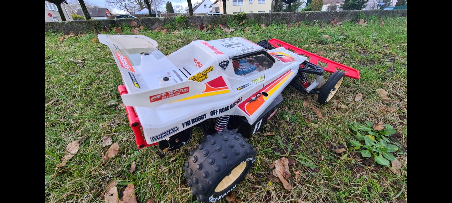

Found some hours to complete :)
First drive:
