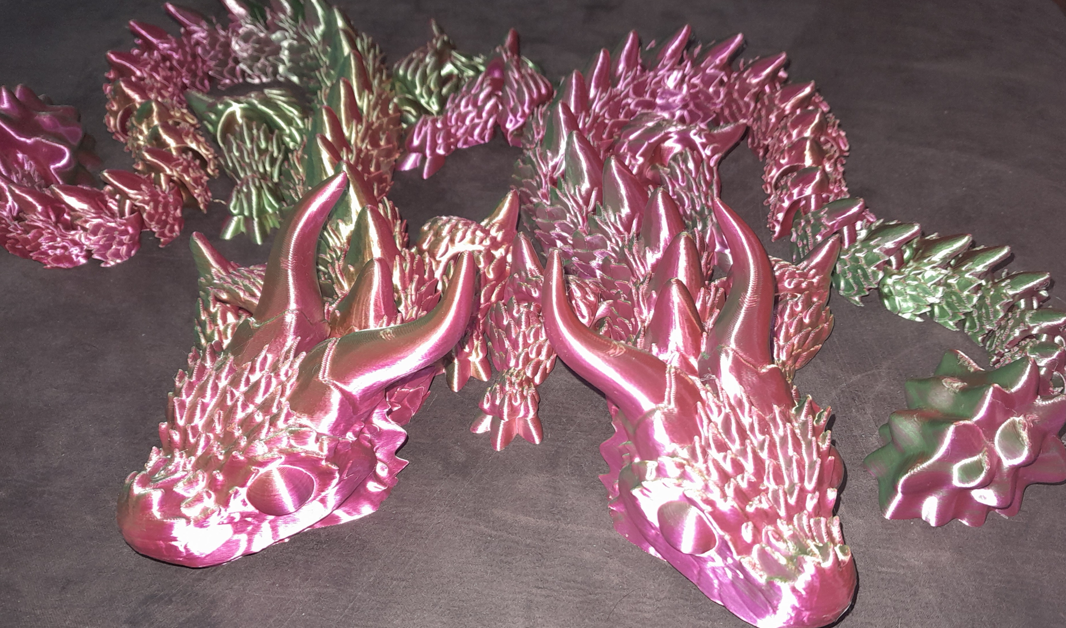

Totally off topic , I printed 4 of these dragons for my grandchildren and a friend saw them and ordered 2 more , its a three core filament that makes the model change colour depending on the angle you look at it .
