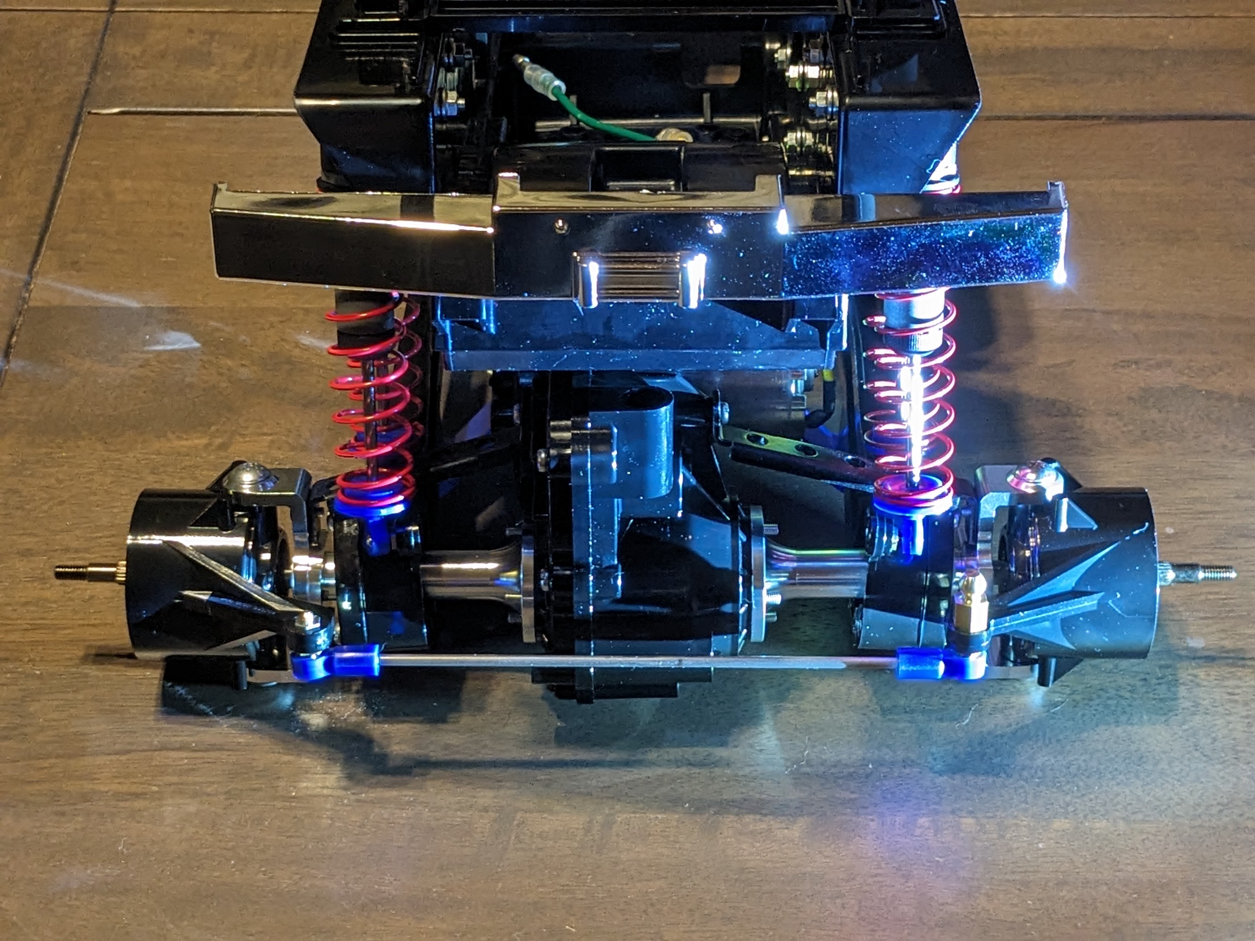

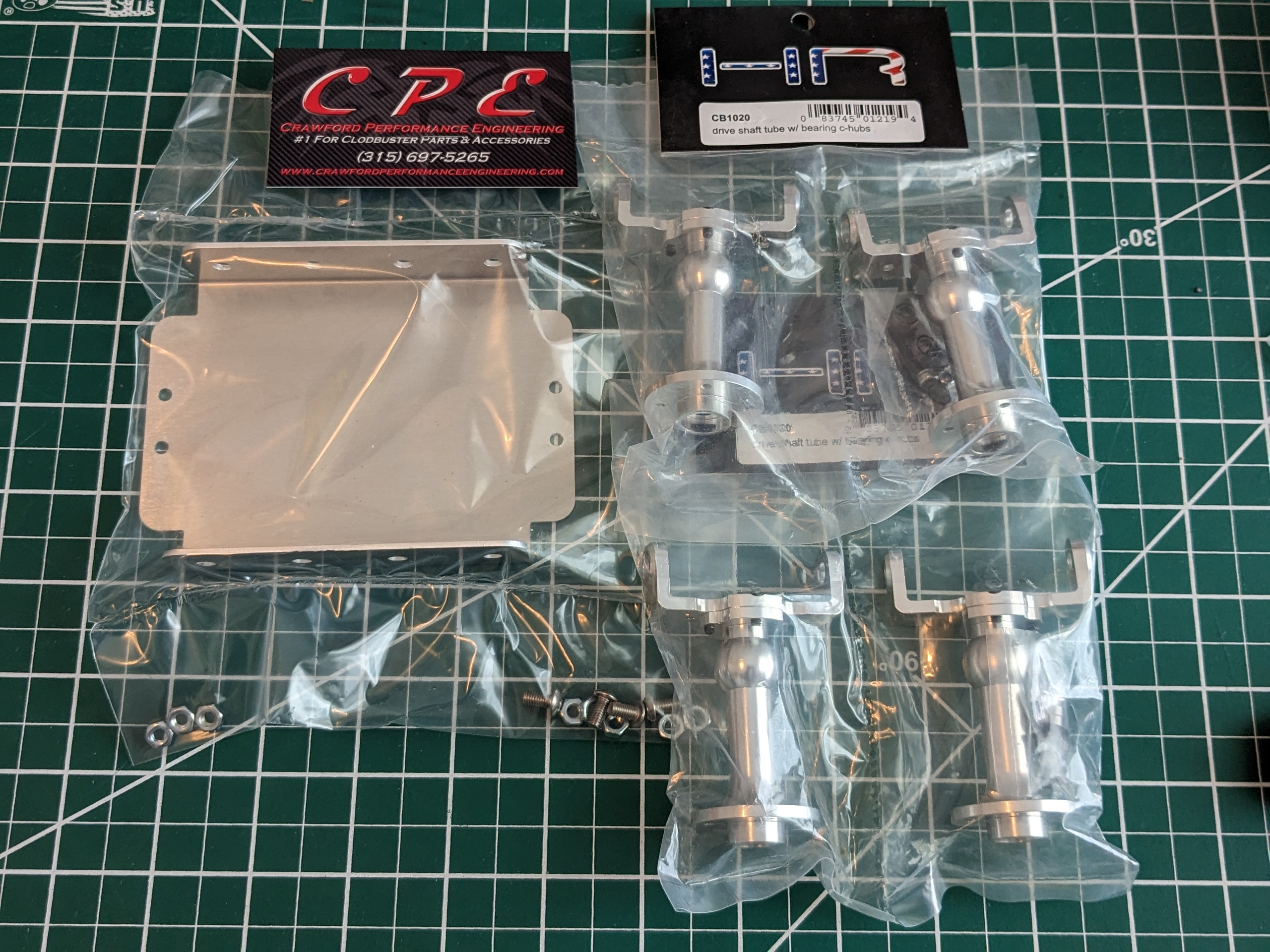

Re: Super Clod build with a few mods

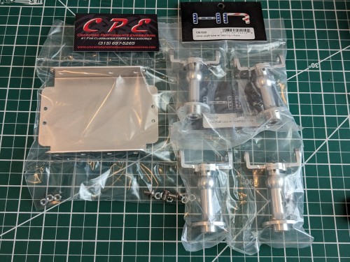

For now, I'm sticking with the plastic tub chassis. It will probably get some clearance trims for the steering servos. But this batch of goodies from Crawford Performance should get me going.
- Frankentruck
- Posts: 3810
- Location: Texas, USA
- Has thanked: 2605 times
- Been thanked: 2980 times

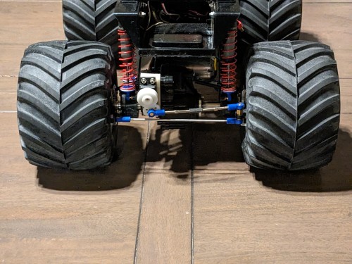

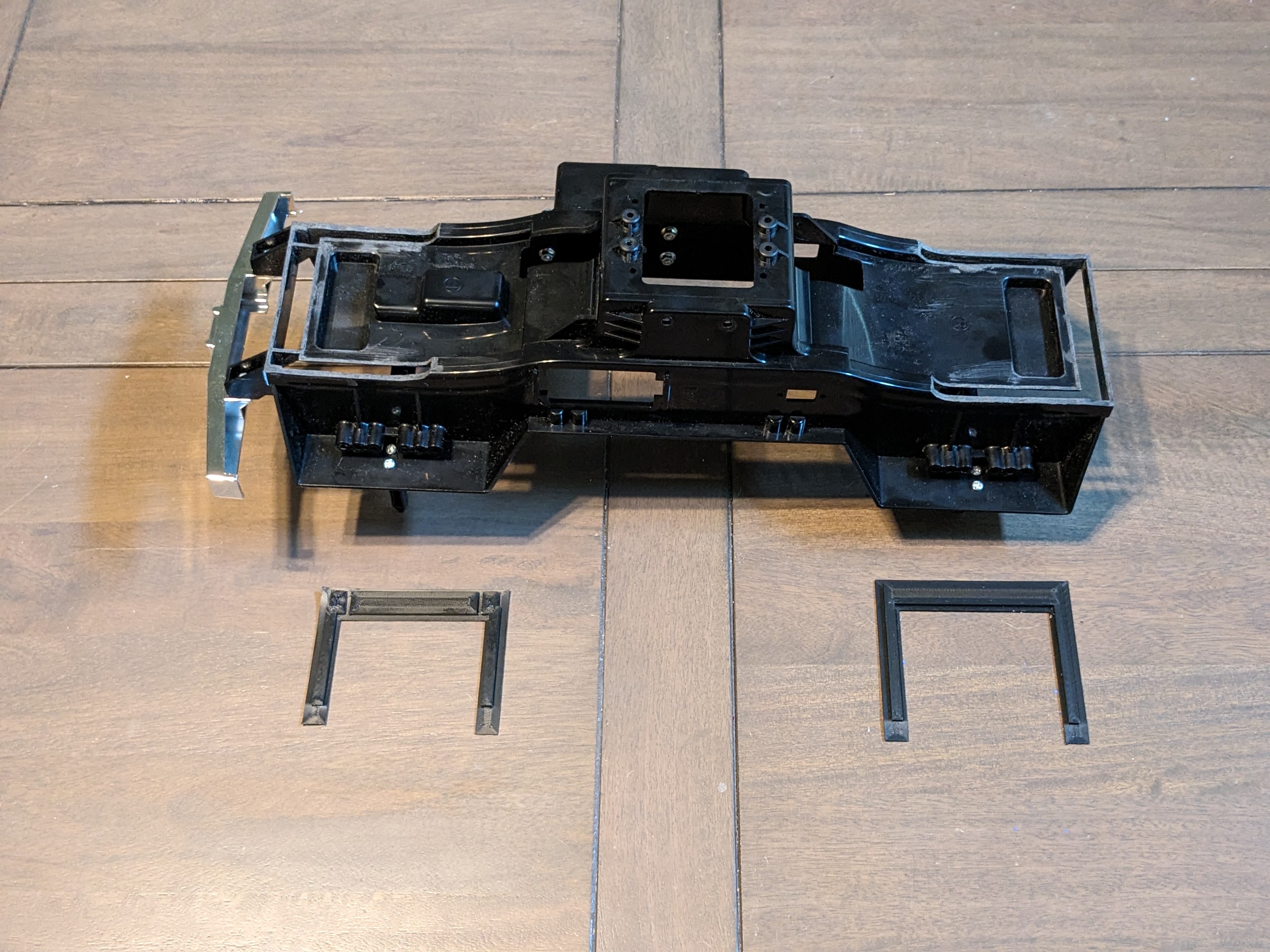

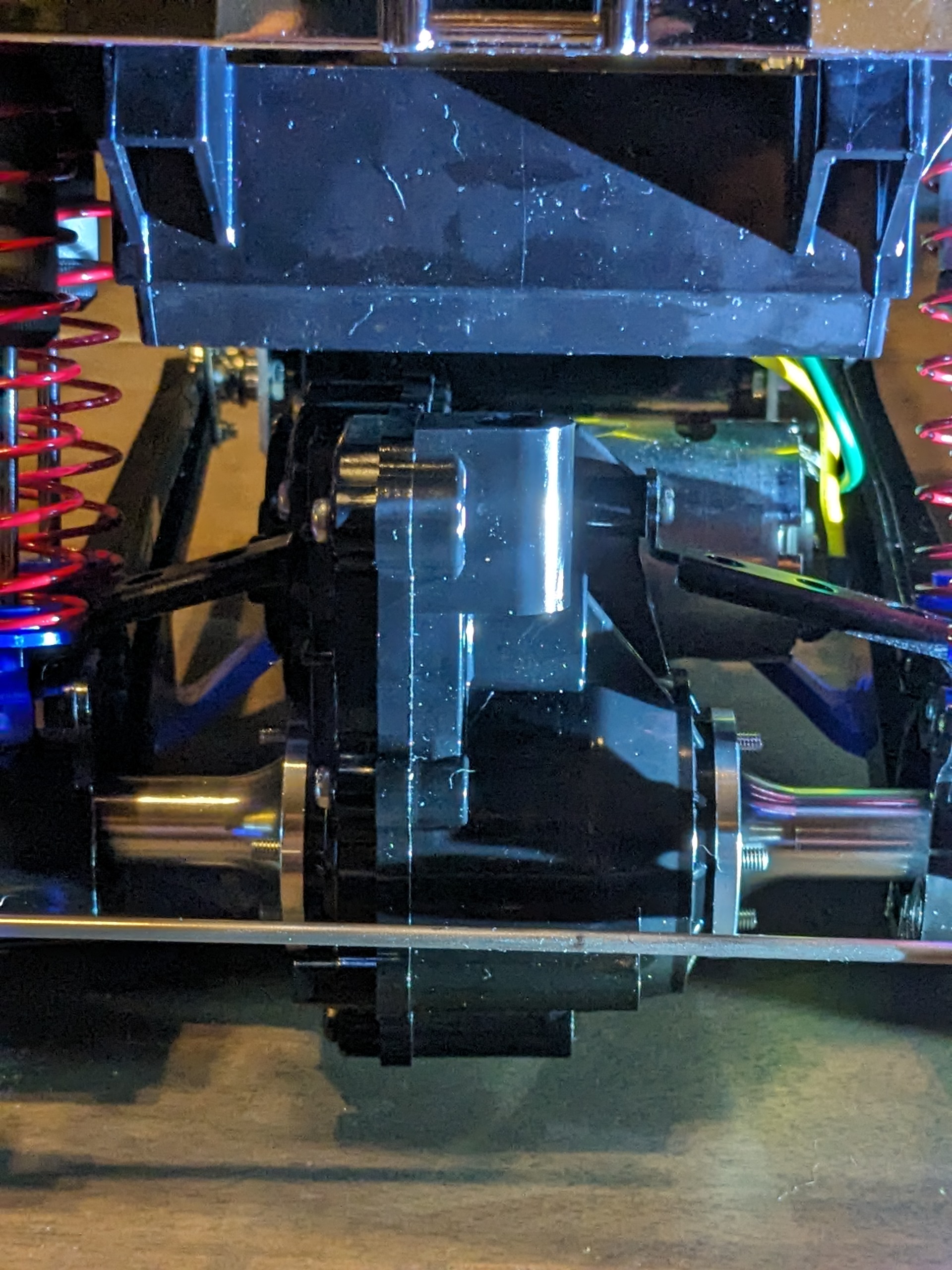

This is really terrible chassis clearance. Definitely time for a chassis hatchet job. That Time Warp chassis does look tempting, now that I've gotten a look at the lack of clearance. Tamiya really didn't do the Clod any favors with this chassis design.
I'm pretty sure stretching the wheelbase has created some of my chassis clearance issue.

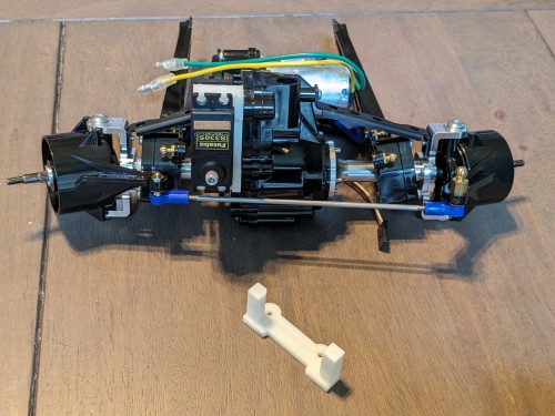

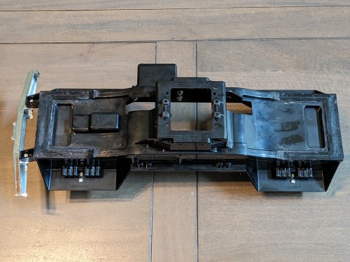

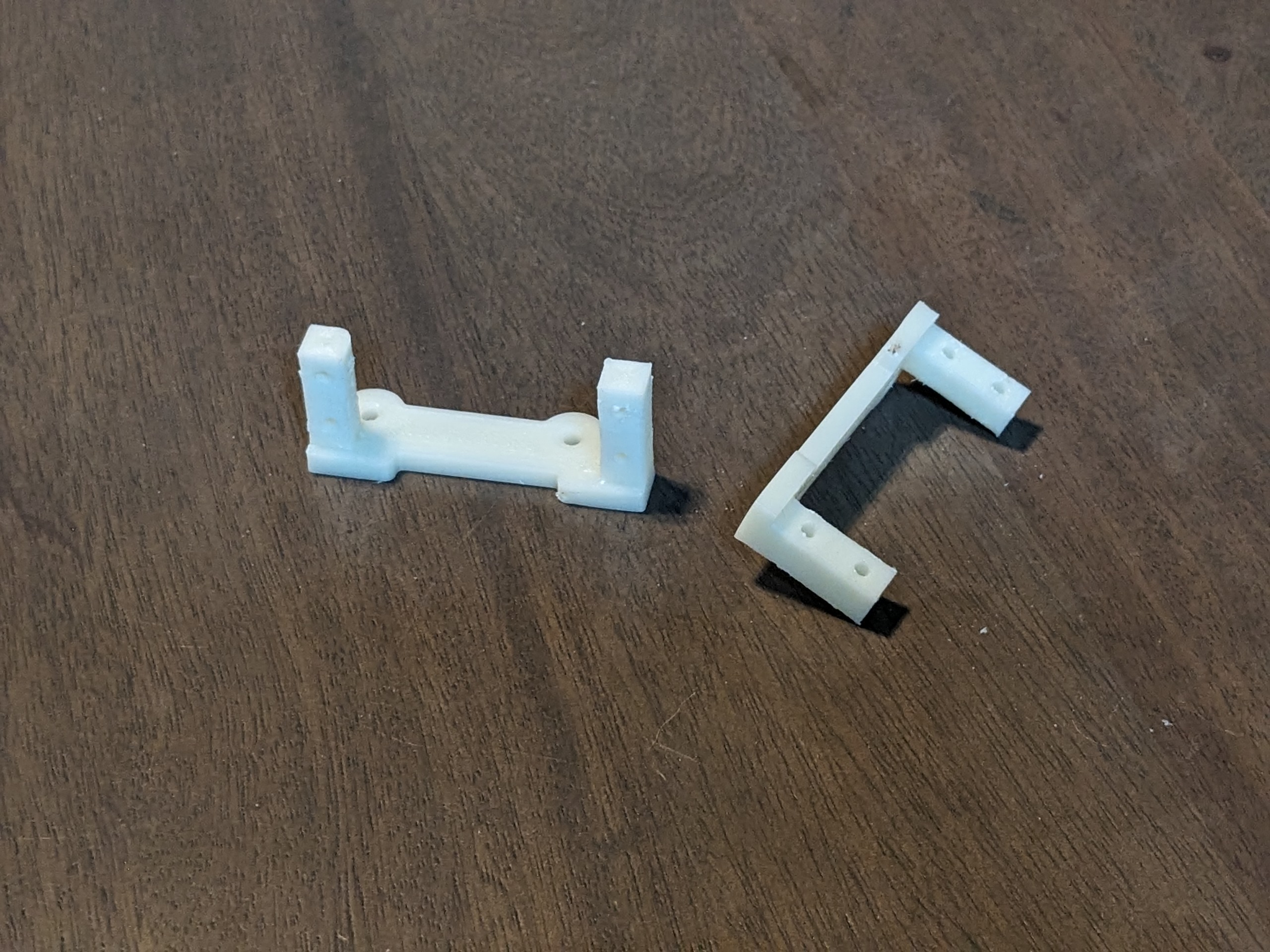

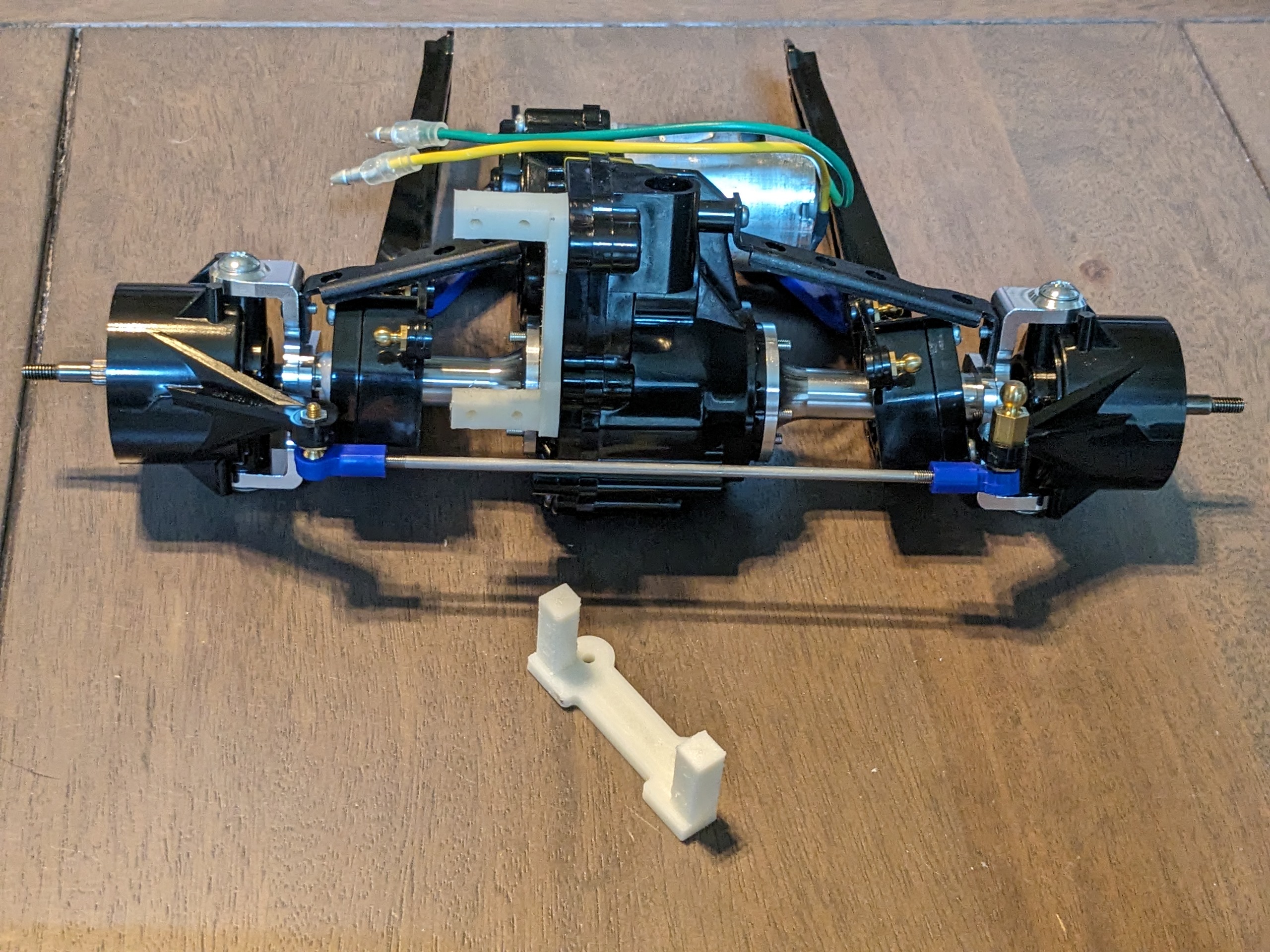

Finished trimming the chassis and made some ABS blanking plugs.
Then added some gearbox servo mounts.

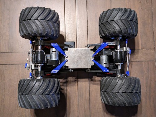

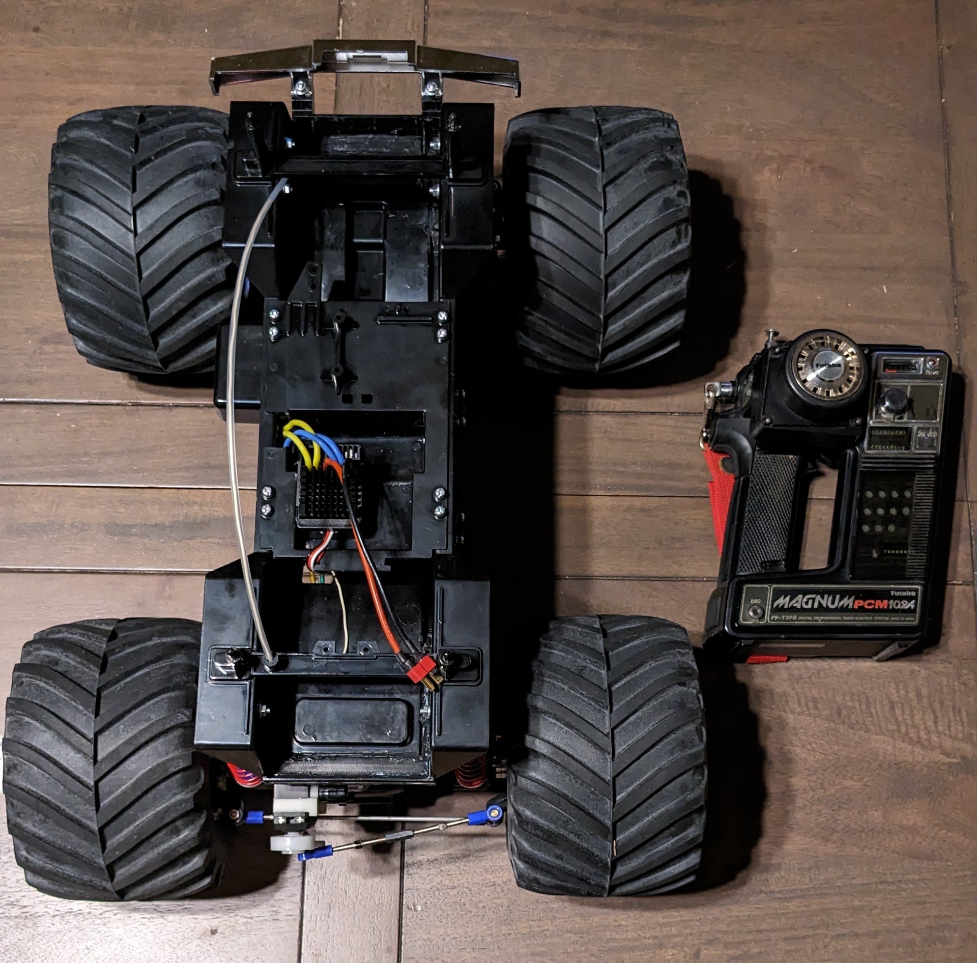

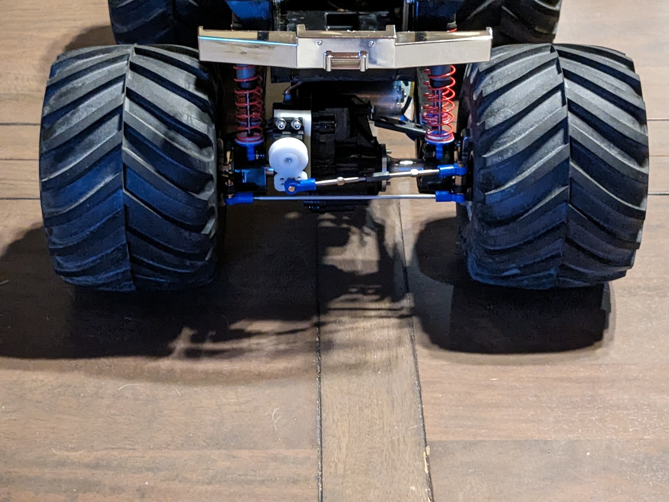

Added servo savers, linkage, and bolted everything together. The tires got some homemade foam fillers added before gluing them to the wheels.
All ready for the first trial run.
I might dial back the rear steer a little bit, but the 4WS is really cool! I can't see making it front steer only, at least on 2s and stock motors. I really want to keep it 8 shocks, but I might need to soften the shocks and oil a bit.

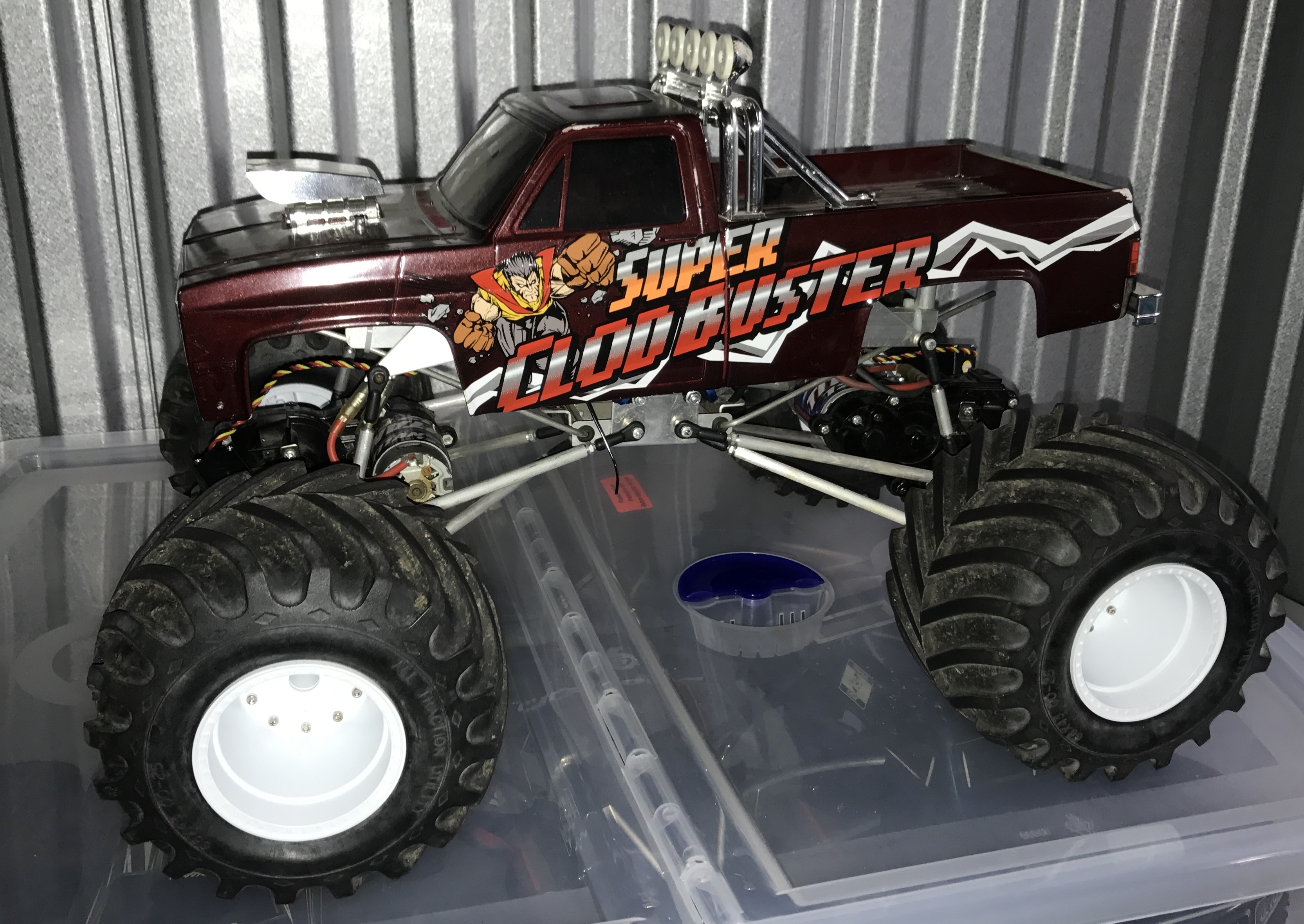

Body is getting painted.
