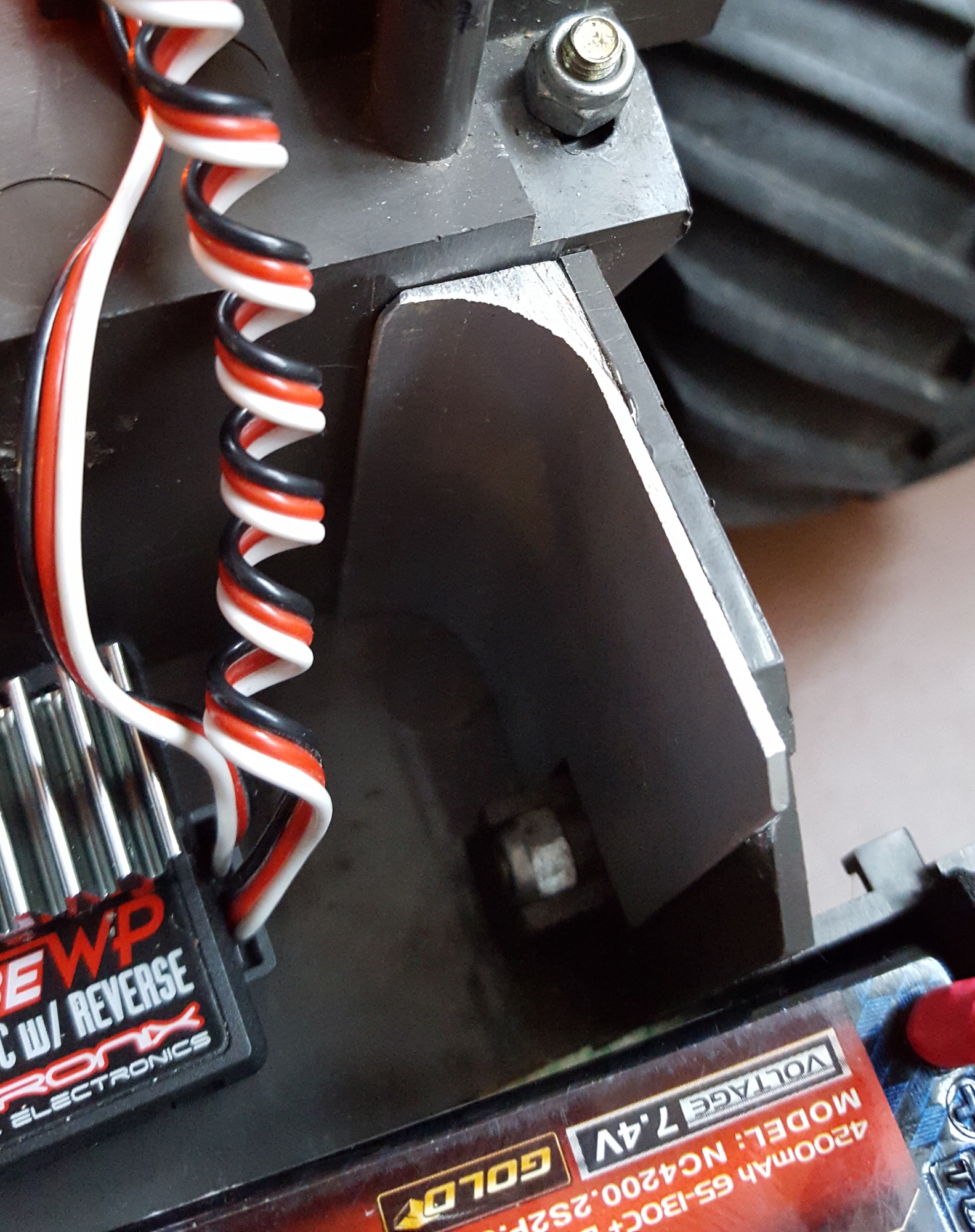

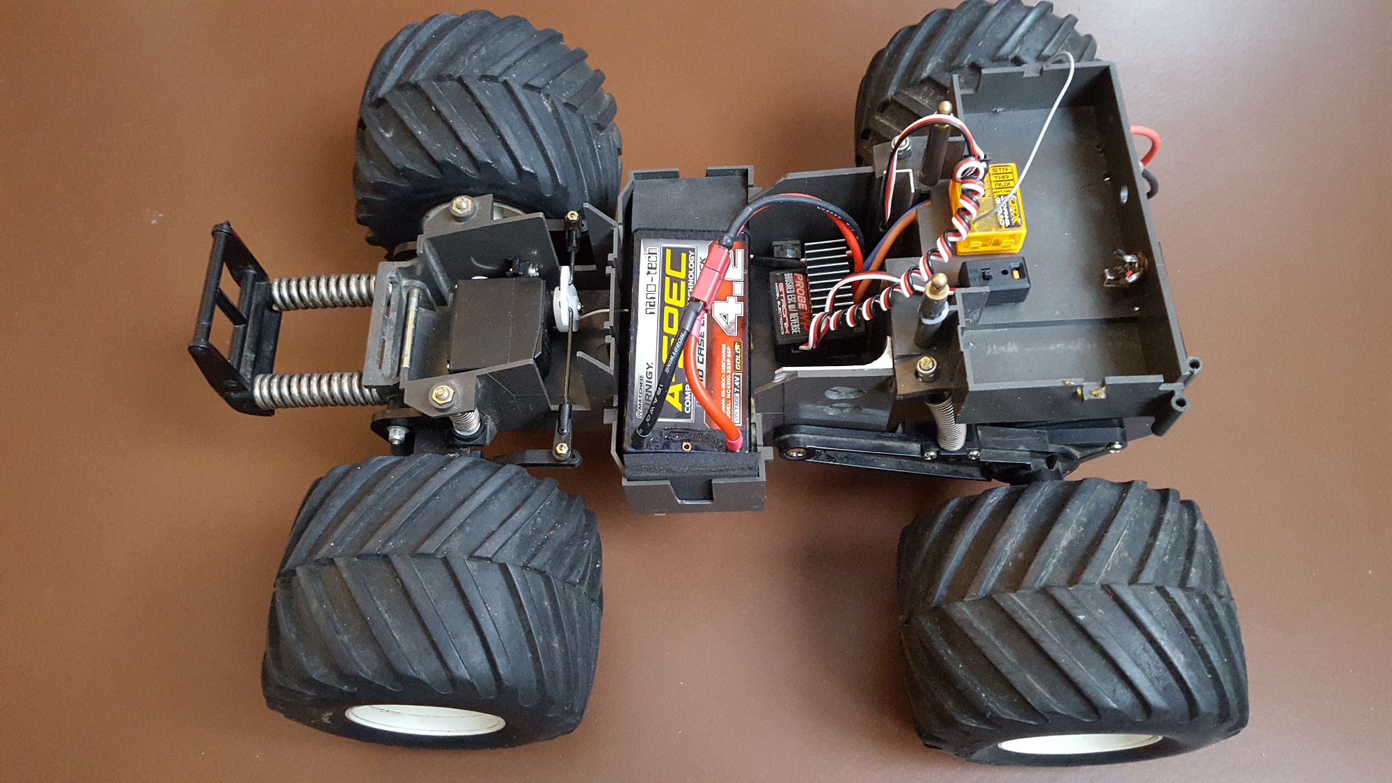

There is 2 versions of the chassis. The V1 was not intended for 7.2V stick packs (it was for 6V packs, so too tight for 134 mm packs) and the Big Bear exclusively used the V2 version of the chassis (V1 was for the first gen of the Super Wheelies). Here is the 134 mm lipo 4000 mAh stick pack in the original Big Bear chassis. This chassis was used as test bed for my Big Bear gear set, and it is an original chassis.
And for my printed chassis, there is slightly more room for the batteries in it. Beside the reinforcements here and there, it works with slightly larger batteries (I have a few 138mm packs and they are not working on many of the vintage cars, although they are stick packs, but they are working fine in my enhanced chassis).
Another comment, for the tires, the Big Bear works well with custom rims and Tamiya Lunchbox tires. They are the same diameter as original Big Bear tires, but the Big Bear tires are quite larger. The difference makes it more enjoyable to ride as per my experience...
